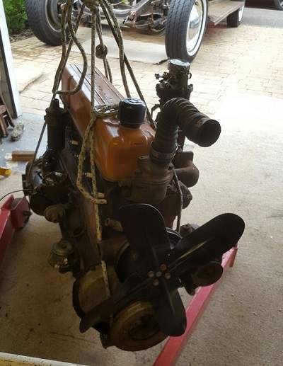

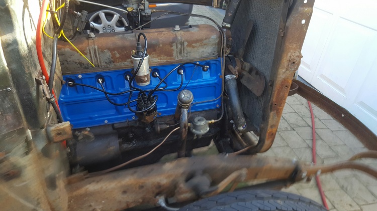

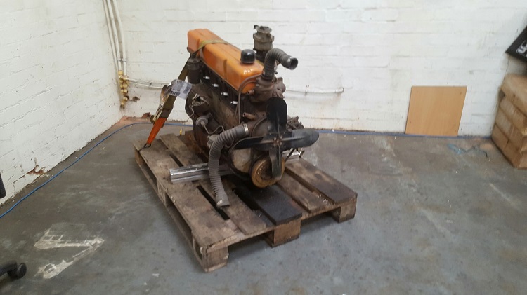

This turned up this morning.............
Seller was great.....drained it and strapped it on a pallet. It came out of a truck that was having a V8 fitted.
I located it late last year but one thing or another delayed it......not helped by me being a bit cba about it.
I had it picked up by a pallet network....it was ready for drop of next day but I wasn't. I've now had it dropped at work but it was only £35.
All I've got to do now is unbolt all the front panels on the truck.........

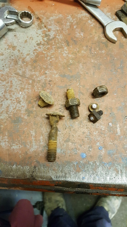

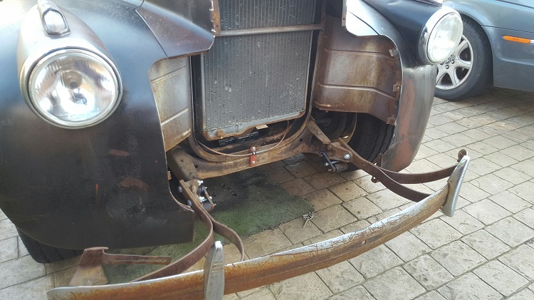

Last weekend I removed the grille. Took me all day to do this and look at how the wings would come off. Also spent quite a bit of time running die nuts down the exposed threads of any fixings. These are bloody useful little things - they are basically a die but are normal spanner size. Anything helps to avoid breaking off those boxed nuts. I'd like to get some for metric threads but not sure of the proper name.
This made wing removal quite easy - although bloody awkward to handle as there are bulky.
And I had to cut the loom - this will get joined with modern connectors.

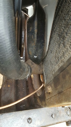

The wings bolt to the rad frame which in turn bolts to the front crossmember with two bolts. These had been loose and were nearly worn in half.

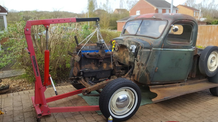

Then I realised the gearbox would need to come out first as it sits behind the crossmember and there is not enough room under the bulkhead to lift it high enough. That was a bugger as the brake and clutch pedals hang off it......as does the handbrake. Also the first part of the propshaft is enclosed.
Eventually all was undone and it lift out OK - having a sloping drive does not help on the way out though!
So now I've got loads of bits to swap over and a couple of things to overcome...... I think the ring gear is buggered.....and I know the water pump wont fit as it is too long - I think this can be bodgineered. You can buy ones to fit in the USA but by the time it gets here it would be £300.

I went for the 6 again because I don't need to go any faster but would like to run for longer. The old 216 was splash lube and ran fine..........I would have left it if it wasn't for the water going into the oil.
The 235 I'm fitting is the same external dimensions and you use the 216 bellhousing, flywheel and clutch. The main advantage is that it has pressure fed big ends and service bits like plugs and points are easier to get. And you can add an oil filter fairly easily.

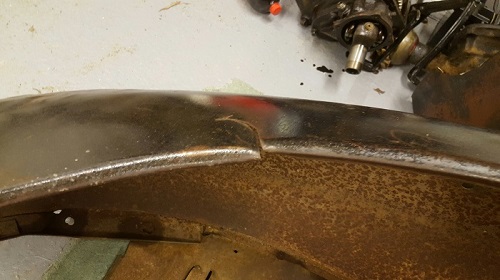

Will the panels are off I want to weld up a few little cracks and put some paint on the panel joint faces as that is where rot can quietly take hold

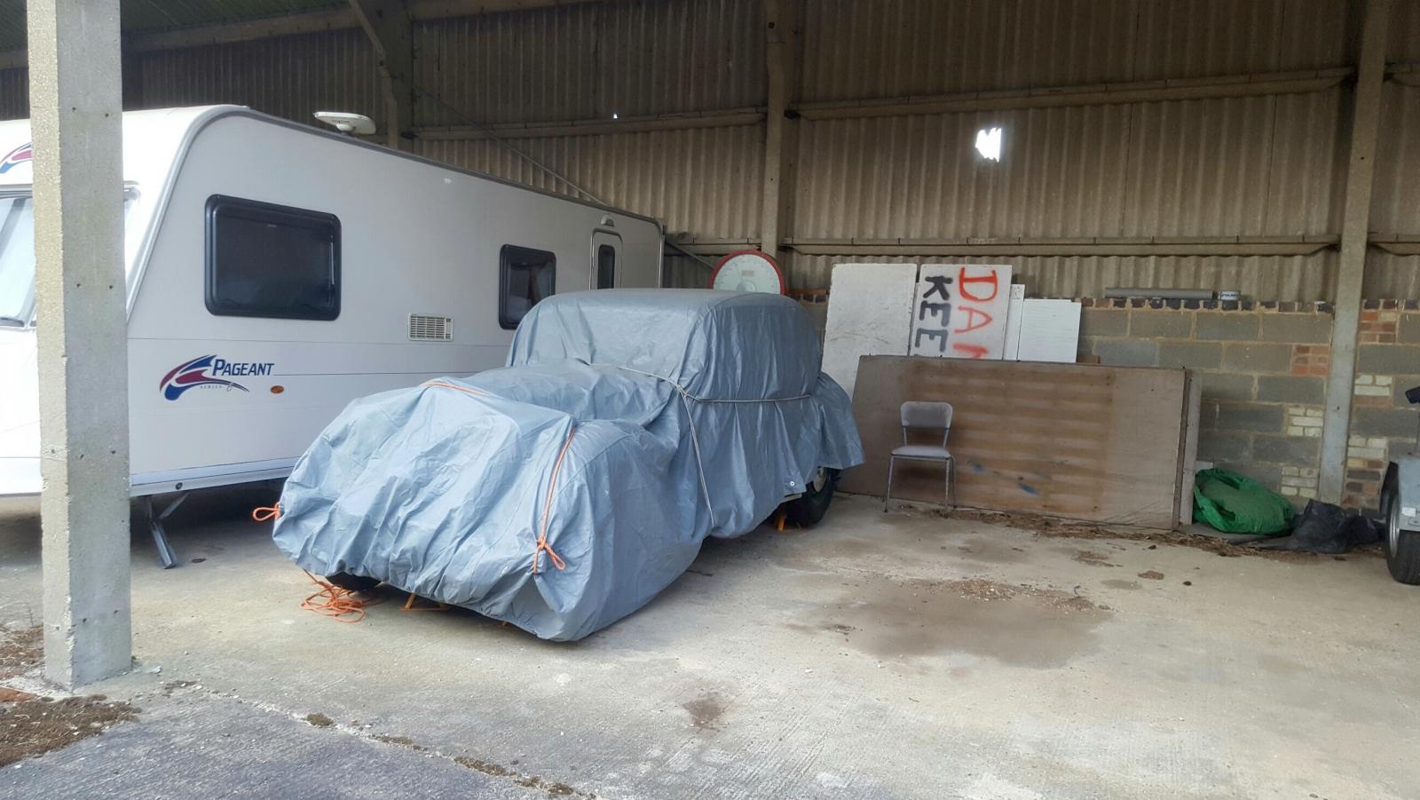

OMG barn find. Well I knew it was there........but don't they all.
I dropped it off last November with every intention of visiting a few times through winter but my brother in law died the next day so I never had the time...so covers off..
Because it had been a while I took my jump box and some tools.......but I hopped in and it fired straight up so I set off for home.....about 30 miles.
Stopped for a quick photo
Made it home fine although it does have a water leak from a hose which I'll have to do before using it.

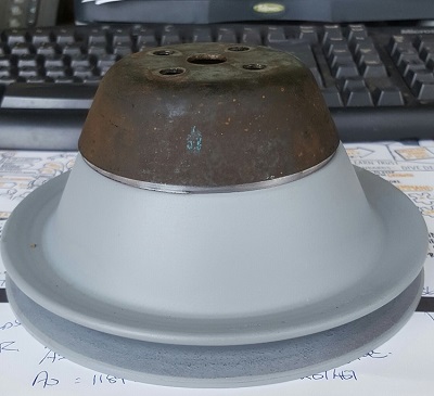

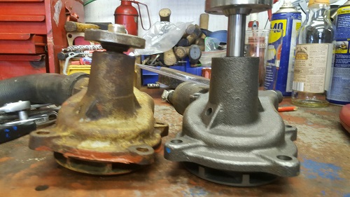

To fit in the behind the rad the water pump needs to be shorter. This is achieved by buying a new (expensive) water pump and matching pulley. Or you can modify yourself by cutting down the pump shaft and pulley.
So this:
Becomes this:
Then the pump boss needs pressing down the shaft. It has to go a long way……….

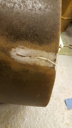

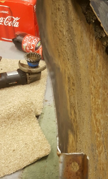

Then a few odd bits welding up cracks.
and a piece was missing from the wing where the grill fits
So piece welded in

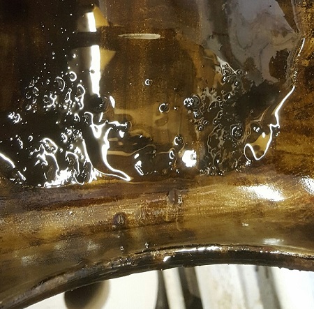

I gave all the edges a coat of owatrol oil and left it to dry.

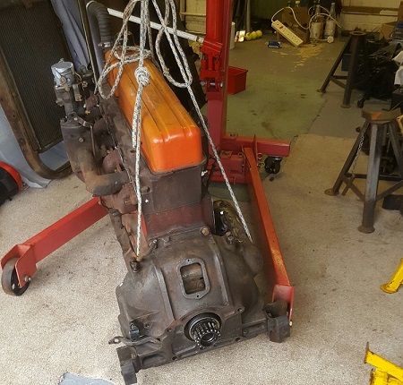

Then reassembled the bellhousing and clutch. Lining up the clutch was done by taking the input shaft out of the gearbox.
Pretty much ready to go in at this point…….

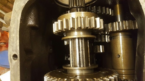

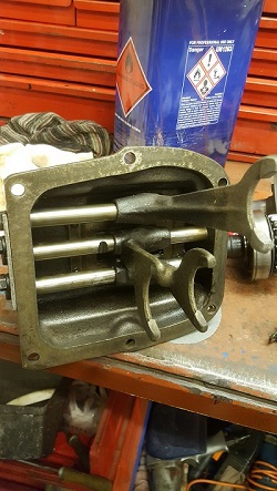

I gave the gearbox a good swill out and refitted the input shaft.
Refitting the selectors is quite fiddly so I opted to fit them with the box on the bench.

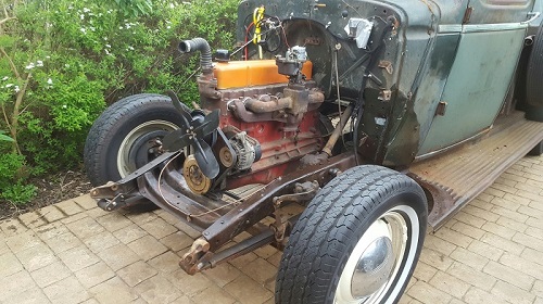

Saturday the engine was then dropped into the chassis
and I started to connect things back up while waiting for my daughter’s boyfriend to give me a lift in with the box.
Once that was done I refitted the prop, brake and clutch pedals and the cab floor.

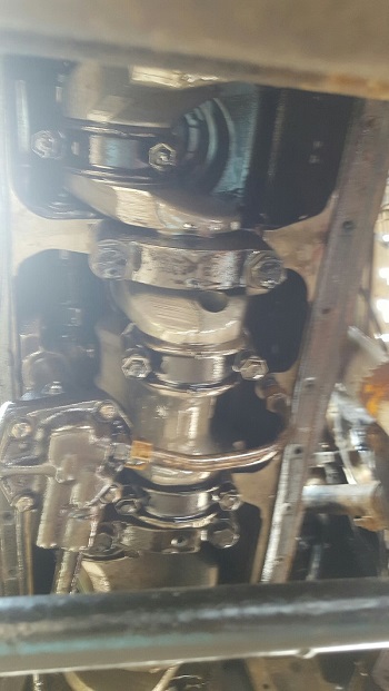

It now ran but had a knock......crank speed.

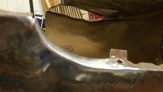

I let it ran for a bit while I listened.........and traced the knock to the sump. So sump removed and found this......
There was a dent in the sump so no2 big end was just touching the sump.....very slightly but it gave a good knock!
Anyway nice to see it was pretty clean inside
I bashed the sump out and refitted the sump and all OK so we got on with fitting the panels back on.

I had a bit of luck with a waterpump in that a local place had one in stock. It was the standard type so I had to cut the shaft down again....
It was a bugger to fit because the fan is pretty close to the rad........and I had spaced out the fan from the pulley with two washers so it proved impossible to line up the pulley and fan with the pump flange while holding two washers in the middle. In the end I made some studs and put those in the pump boss first - it made it very tight to get the pulley on but at least I could now get it assembled.
