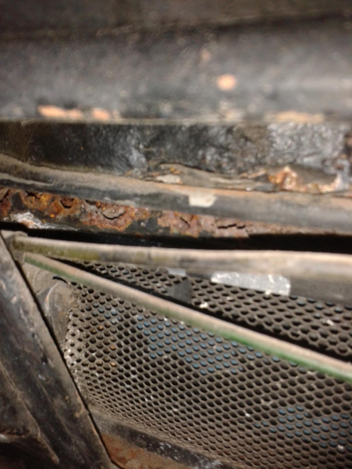

It's hard to get a photo without stripping out the dash.
Looking in end where heater controls usually are:
Bit in the middle:

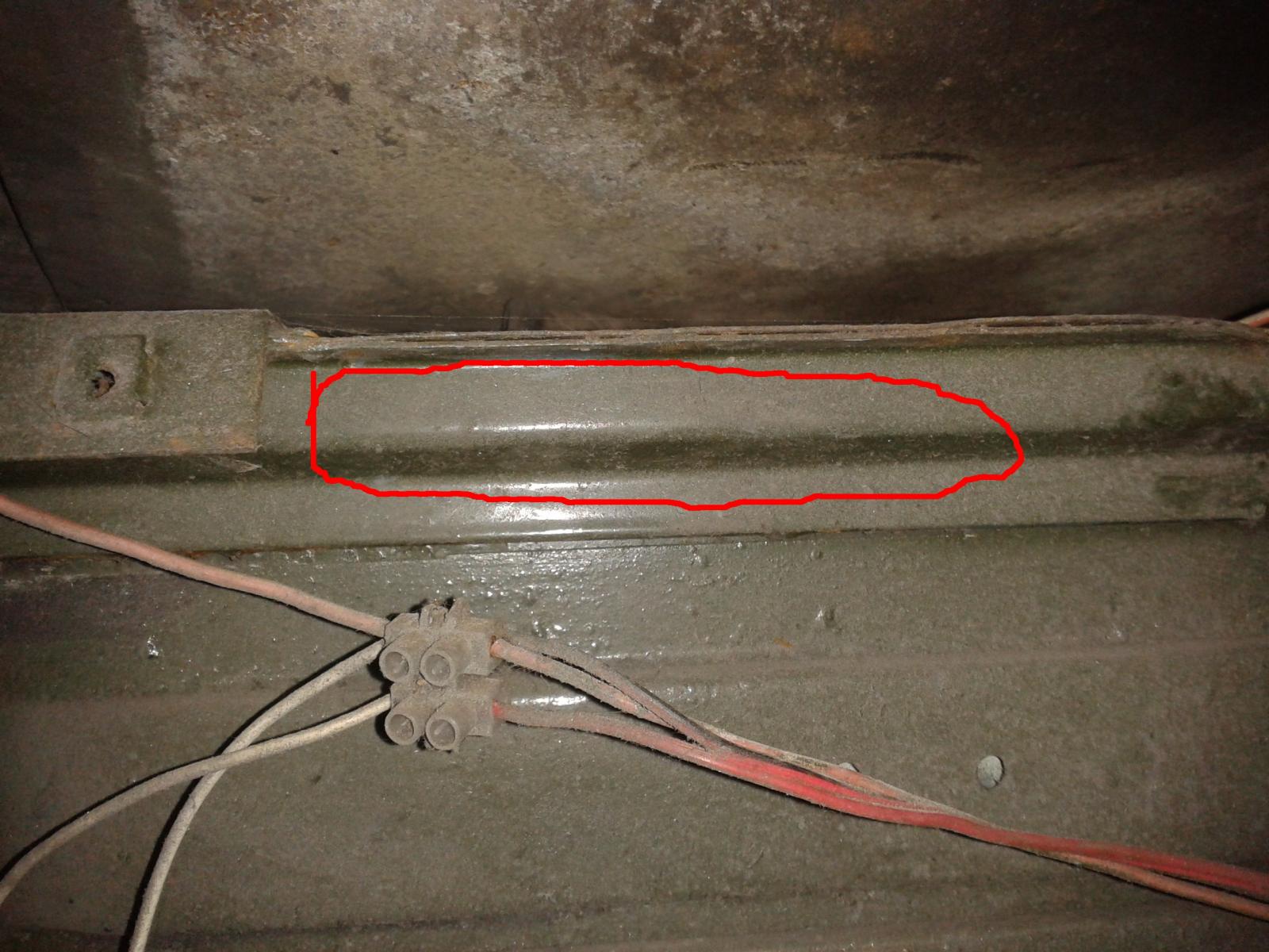

Using brain slightly and taking photo of series 2 bulkhead, I think it's this bit, but more like full width.
The ultimate plan is to fix the series 2 bulkhead (needs footwells + door pillars)  and swap it over later. Was hoping to get a few years out of the one that's on, as ball ache changing bulkheads. Surprisingly the top outside face of the series 3 one is still made of steel.
