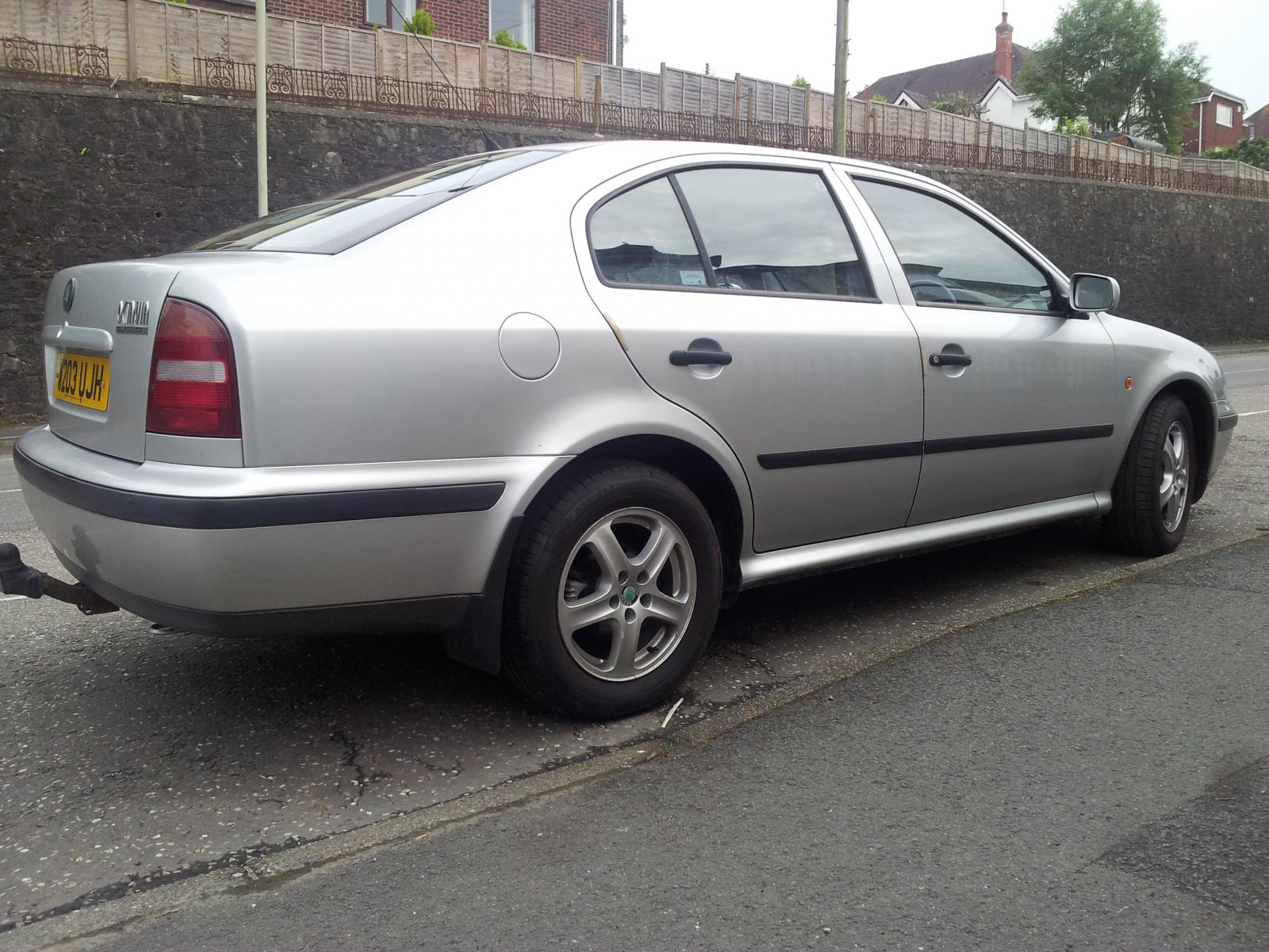

Skoda Octavia Tdi for sale £550
I find the seats absolutely fine - no comfort issues at all, in fact it's one of the reasons I like this car so much.  It's not quite up to Rover/Volvo standards (I'd like velour given the choice!) but it's absolutely fine to me and I am quite fussy with car seats.  I've not tried higher-spec models so can't say if Laurel & Hardy seats would be better or not.

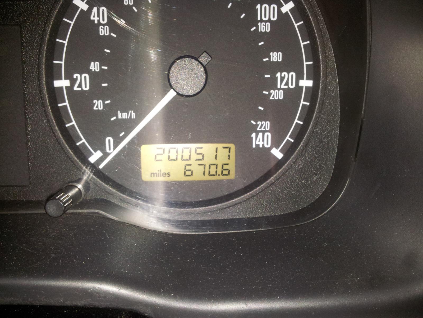

On the way to the airport last month, my friend pointed out that we'd missed an important milestone a couple of miles back.  That was a few hundred miles ago now, so have this instead.

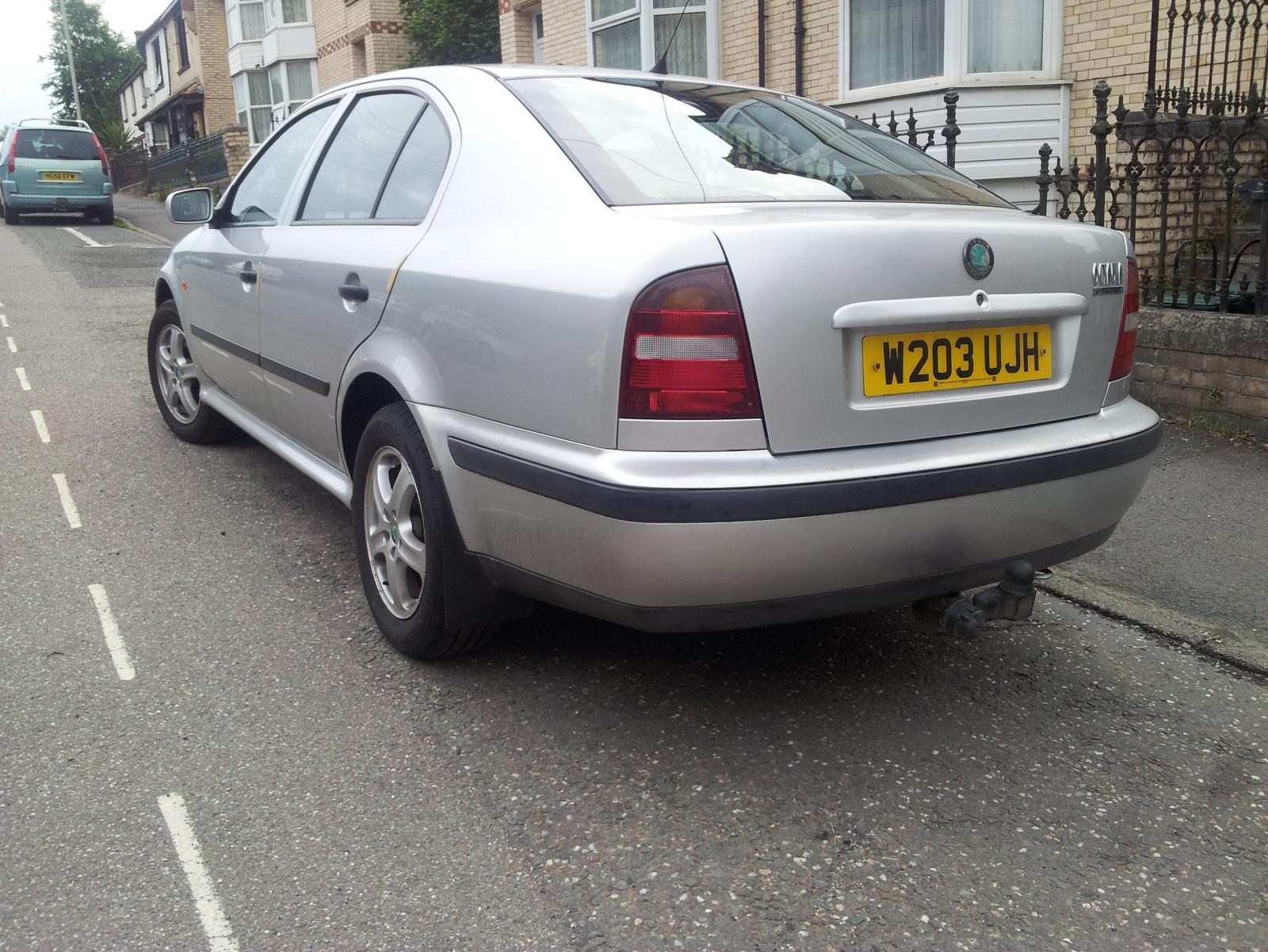

As of today, after a quick wipe off to get rid of the signwriting scrapings, she's looking a bit naked and plain again, a good wash and polish is needed to get rid of the little scratches and marks but it still looks pretty smart.

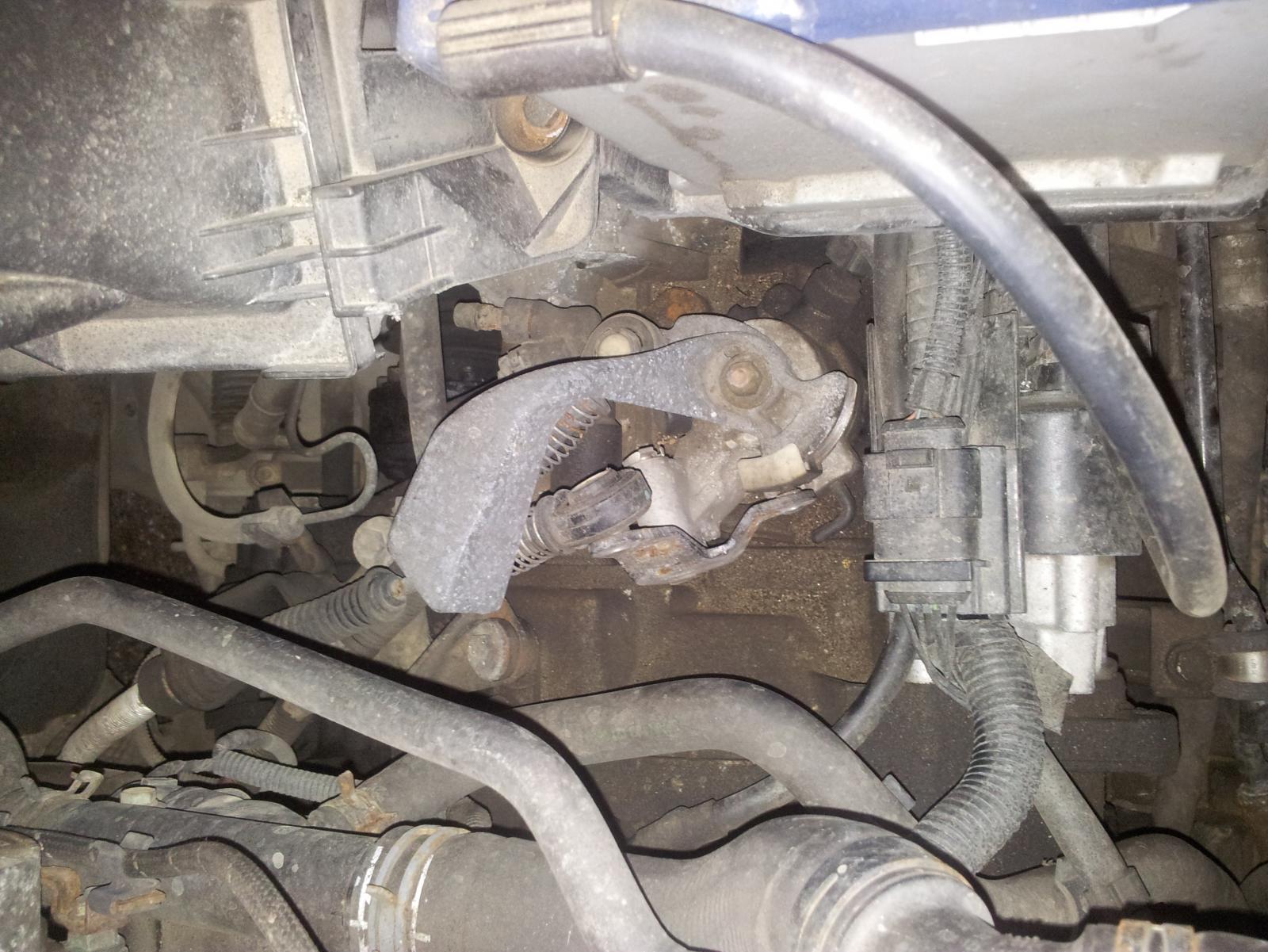

Stupid question time: what is this behind the starter motor?
It has a big arm on top which turns and also goes up and down, there's also a little tiny black lever on it which can be set either up or down and it has two large sprung cables attached to it.  Something to do with the air con?
Gear change linkage - up and down is the equivalent of side to side on the gearstick, turning is forward and back on the stick.
The 2 cables connect to the gear lever in the car.
Cheers, I did wonder, given its location, it just doesn't look like anything I'd expect a gear linkage to resemble!
