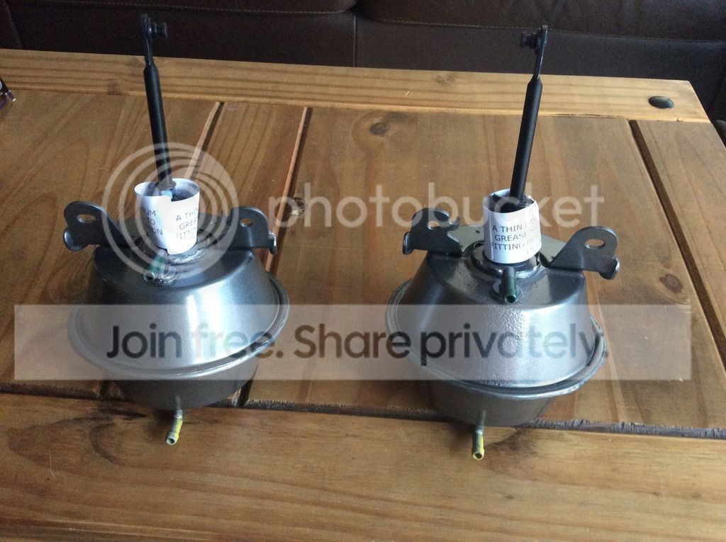

The reconditioned headlight actuators have arrived.
They look brilliant! Really well done and painted up nicely. Finally I'll have a pair of working headlight doors instead of just one and no more vacuum leaks.
Yes, they were expensive and yes, it's taken some time to get them but I'm really happy with them and let's face it, I couldn't really do anything else.
Just got to drop them off at the garage now for the guys to fit. Hopefully I'll be able to get a look at the state of the engine/car while I'm there.
They look cool. Weird but cool.
You can have the old ones for your mantelpiece if you want!
They are wierd little things. Only in America!
