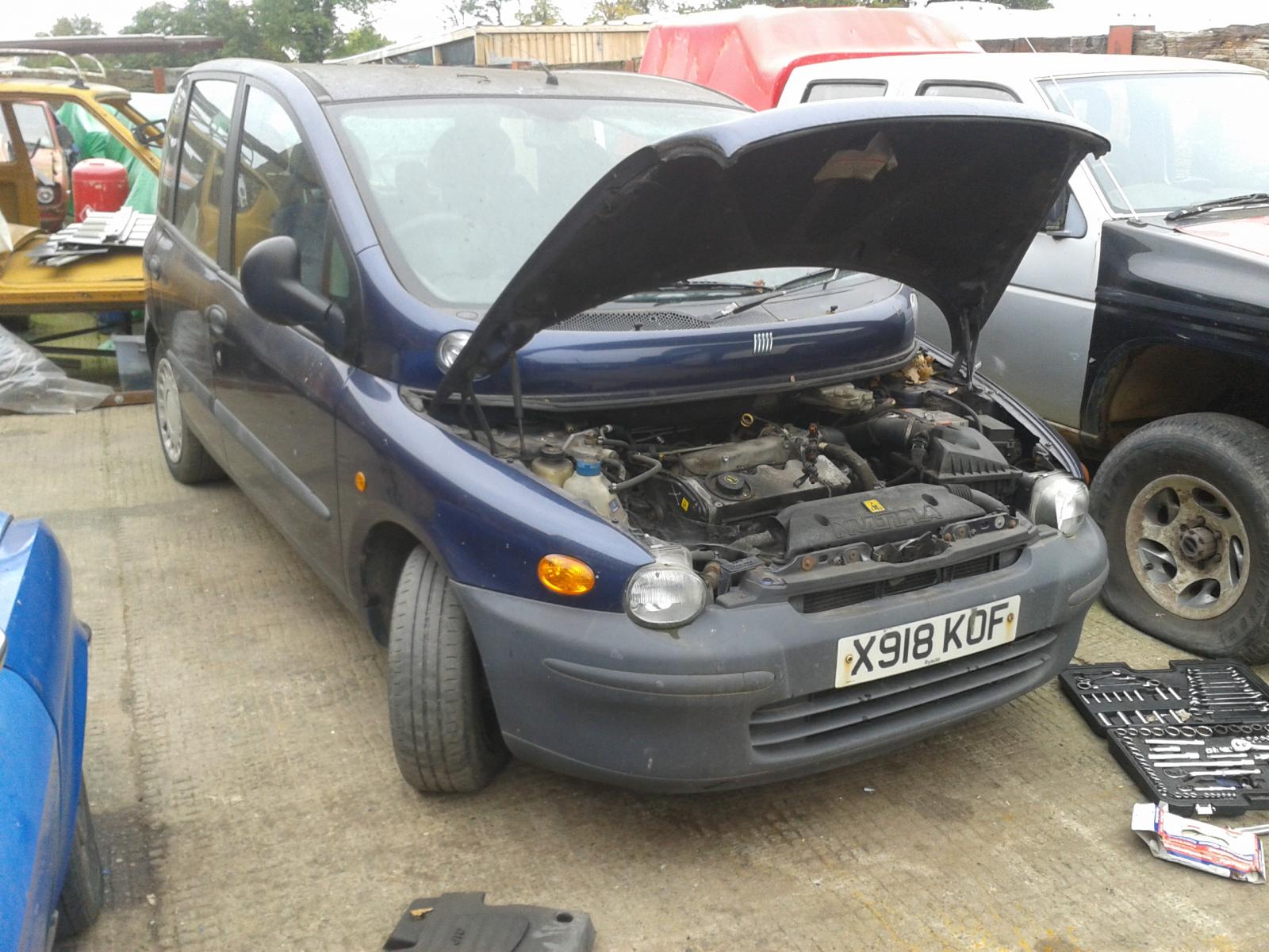

After taking the injectors to a specialist to be tested and then being told that it would be a week before I got them back (after the mofo said it would be next day on the phone) I decided to drag the Multipla back home so it could die on the driveway in dignity. Before I could do that I had a text from "JonCedric" formerly of RetroRides who told me he had manky Multipla in his field that he was going to weigh in next week, and would like any bits from it before it went? Naturally I begged the injectors from him and drove down today to extract them.
Three of the injectors came out fairly easily but the fourth just wouldn't budge. Without access to an extractor I was pretty stumped so I did what any hardcore shiter would do and used a crow bar with a scaffold tube extension. After 45 minutes of sheer mechanical carnage the injector was out, however the engine in the area around the injector was completely destroyed by my crowbar antics, I also bent the injector.
Back at the garage I stuck the injectors in and churned the engine over...... nothing.... a bit of easy start and off it went! Even the bent injector is working OK.
The guy at the garage looked amazed when it burst into life, as he was sure that the injector pump is borked. He's still convinced. We'l see. It felt good driving the Multipla away anyway.

Guess what? It won't start! Although the copper sealing washers are totally borked now and it's losing quite a bit of compression past the injectors. Will start on easy start.
Heres the new injectors, and the clunker they were removed from.
