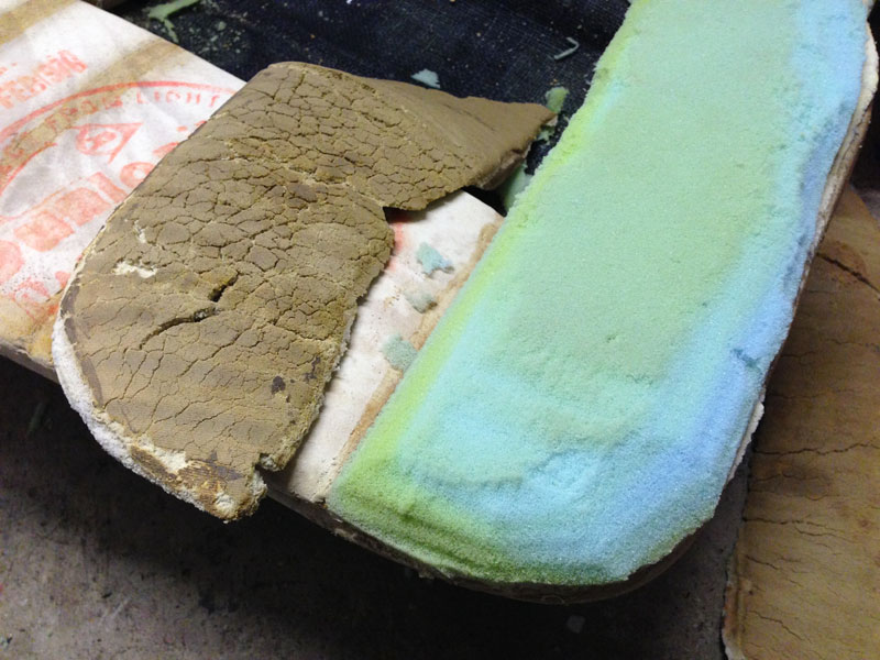

The orange upholstery is beautiful, but the fabric was holding a lot of dirt and made my interior smell all musty.
So I took the covers off and cleaned them. A lot.
This supercharged the orange.
The foam inside is stamped with warnings to keep away from sunlight. Because this is what happens to it when it's exposed to 40 years of sunlight through the covers:
It's a shame, because the bits underneath which haven't seen any light are lovely, all squishy. These seats must have been dreamy when they were new. Unfortunately none of the foam places I tried were able to replicate the Dunlopillo, so I had to replace the worst stuff with generic upholstery foam. Here's  a bit of my electric cutting knife sculpture, and the stuff it replaced.
The box sections were less fun. Cutting the foam to size is enjoyable, thanks to the meat carving knife sliding through it like a Stanley knife through warm Play-Doh. But getting it into the covers? The strips have to be wrapped in a bin bag and then, taped to a one of the car's door trims, dragged through the mesh channel on the back of the cover.
It's all worth it in the end. Compare the following photo to the cat one:
These rock hard parts are now lovely and squishy. Even better, the cabin smells cleaner and powdered foam doesn't puff out of the seats anymore!

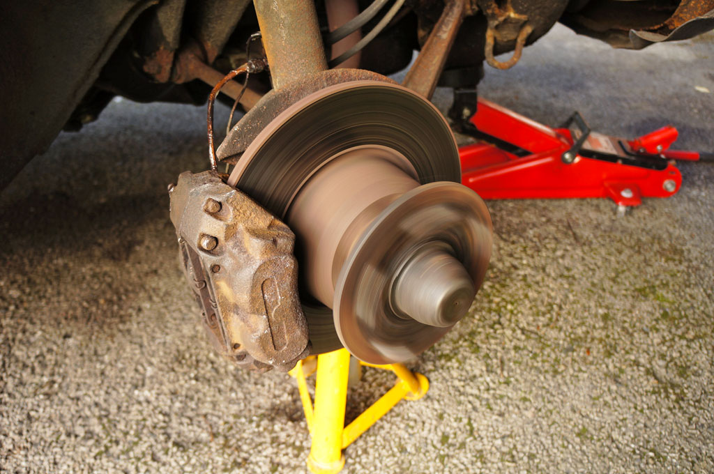

I had some concerns about the brakes. They worked well enough, and never felt unsafe. They passed MOTs without issue. But they were nothing special, and if the brake pedal was stamped the car felt like it was trying to go in four directions at once. I blamed the ancient pads. I was forced into action when one of those pads lost its friction material. A set of new pads was procured, but couldn't be installed as one of the pistons was seized in both calipers. That probably wasn't helping.
See the big piston? That's our culprit. The rubber parts which were supposed to protect it were in tatters. Replacement calipers were sourced from Junkman's recently deceased Haunted Rover (RIP) and fitted over the course of a fun afternoon in which nothing was seized or broke. Oh, wait, everything was seized and broke.
Now I feel silly for not fixing this sooner. Properly functioning P6 brakes are amazing. The car stops sharp and straight, it's wonderful.

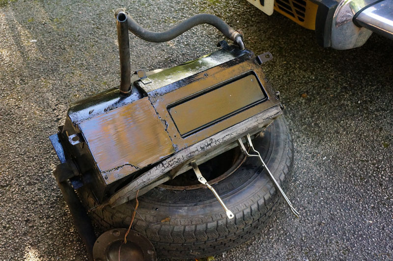

The heater worked once. I don't mean 'once upon a time', I mean once. It worked one time. I drove through one winter with no heater, and had no intention of repeating the experience. The first cold day we had recently told me it was time to start investigating the heater issue.
The P6's enormous heater is not controlled by a water valve. The matrix is constantly in play, with heat directed into the car by a system of three flaps. The first controls whether air may enter the heater box or not, the second controls whether that air may cross the matrix or not, and the third directs the resulting air between the footwells and the windscreen.
Since the car can't be driven with the heater box removed, a known good box was sourced from Junkman's recently deceased Haunted Rover (RIP). Known good, but with a couple of small issues - the foam on the flaps had disintegrated through age, and...
I briefly considered a complete strip down and rebuild of the heater, but reading the accounts of people who have suggests it's a massive job. So all I did was re-foam the flaps and weld it up in the 'ugly but functional' style.
Then, because learning from previous experience is a sign of weakness, I decided to swap the boxes over at 4pm one afternoon. After all, it's only taking one out and putting another in, right? That's what, an hour, tops?
I spent that long removing ONE hose clip which was as inaccessible as it was broken, and had to be cut off with a Dremel. Also, the throttle linkage has to be dis-assembled for the sake of a few millimetres of clearance. Then there's all the levers to thread into the cabin... At least there wasn't any scary rot hiding underneath the box. You'll notice it's night time, and I am outside, and I don't even have the new box installed yet.
In the end, replacement was a much simpler ordeal, and with a bit of trepidation I took the car for a spin. In no time at all the cabin was toasty warm. Wonderful.
As for the heater box I removed, I can't see what was wrong with it. Ironically, the physical box is in much better condition than the one I just installed. There isn't a trace of rust on it, and all the flaps appear to be working. Whatever. I'm warm now.

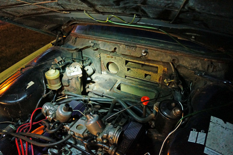

The petrol tank which came with the car was full of grit. This caused a great many fuel starvation breakdowns. After a catastrophic attempt to clean it out, I gave up and found another tank. This one worked pretty well, but still had a lot of rubbish in it. To catch it, I installed a diesel filter as well as a normal paper type. This is what the diesel filter caught:
and still the paper filter was getting clogged. But at least the car ran. It was still running this week, except it started losing power around 3,500 rpm. If I slowed down, it recovered. Felt a bit like fuel starvation. Wonder what could cause symptoms like that? Yeah, another blocked filter. It's a few months old.
For unrelated reasons, I sent the car to the Rover P6 Sanatorium with instructions to give it a good tune up. It's come back a new car. It feels perkier, it idles inaudibly, and if I knock it into neutral the idle doesn't rise by 1000 rpm. The throttle linkage has been completely rebuilt, destroying my cable tie and threaded rod masterpiece, but at least the gearbox kickdown works now. The gearbox got a bit of long deserved attention too - the jet black ATF has been swapped for some pink stuff, and the sump's been cleaned out. Lovely.
Also discovered during this tune up - despite two filters, the carbs were full of that sandy crap from the tank. It had to go. But where oh where was I going to find a proven good petrol tank?
A replacement tank was sourced from Junkman's recently deceased Haunted Rover (RIP). That car's fuel filter was never anything other than canary yellow, but since I had the opportunity I whipped the sender out to have a peek inside.
WOW! AMAZING. There was about a tablespoon full of loose dry stuff falling about in there, so I thought "what the hell" and duct taped the Dyson hose to the sender hole and shook the tank about about until it was empty. Perfect.

Might be stating the obvious but it looks like the fuel tank had been coated internally and now it's all coming off.
Looks like it. All four tanks I've looked inside have had that white coating. Plus flakes of the same. Also baffles, just to make cleaning them out as difficult as possible.

That grit in the tank is strange. It's usually bits of rust you find in the filters not half a granite quarry.
They all do that, sir.
So I wonder if its purely down to old age or something to do with the OMG ETHANOL in modern petrol?
