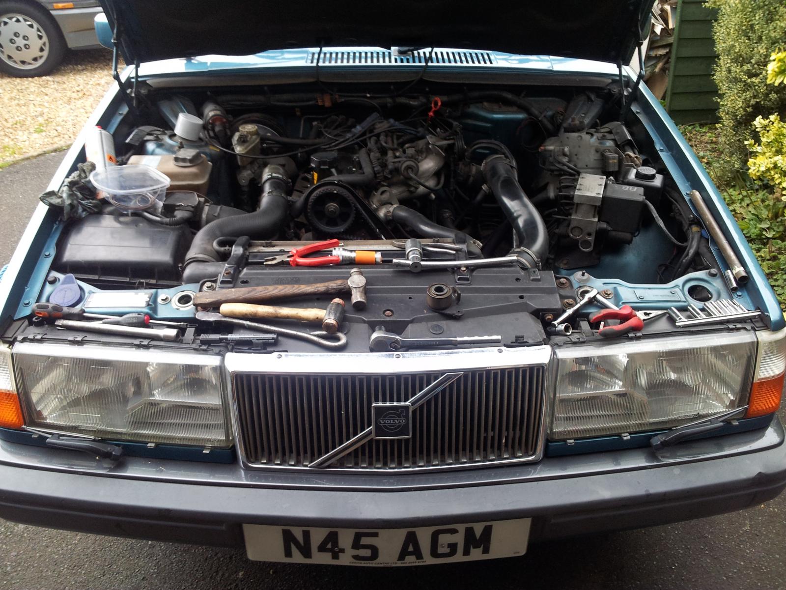

Big, big thanks today go to Philibusmo.  Without his not inconsiderable talents, not a lot would have been achieved today.
Since I've had this car, I've been aware that the front cam seal was leaking oil which was clearly visible spread over the front of the block.  I also had no idea how old the cambelt was and anyway it had almost certainly been contaminated with oil from the cam seal.  The leak was likely due to a blocked up crankcase ventilation system - at 136,000 miles this one was well overdue for a cleanup.
We started the stripdown and, after a bit of swearing, decided to let the pinging hot engine cool down a bit.  That time was usefully exercised changing the failed alternator on Phil's Supra - that seemed to go well enough although the Toyota now has other issues.
Back to the Volvo, the forums all suggested that, instead of buying an expensive cam-locking tool, the best option was to pull all the spark plugs, line up the engine to TDC, rotate it to 90deg TDC and then feed rope down the no.1 plug hole until no more would fit.  Phil found a perfectly-sized reel of nylon garden string which was fed into the cylinder using a length of old fuel pipe.  The engine was then turned on the crank until it locked on the bundle of string, allowing the bottom pulley to be undone - clever stuff.
The cam seal was persuaded out with the help of some small holes and long self-tapping screws and the new one tapped in.  It became clear during all this work that the seal had been leaking for some time, the engine block was caked in oily muck and the cambelt, whilst not perished or damaged, was stained with a light coating of oil along with the pulleys.
All cleaned up and back together along with a new power steering belt I found in the boot to replace the badly perished original.  Turned the key and found it still worked.  Time for a cup of tea.
The last job of the day was to quickly swap over the old crankcase ventilator with the new one sourced from a Volvo dealer and give the rest of it a clean.  Easy, right?
In theory, yes.  It was only held on with two bolts and the rubber pipes just pull off.  In reality, it was a profanity-laden nightmare of a job.  Metal pipes which form part of the turbo's air feed were bolted to the same bracket as the ventilator, all of which which was buried deep under the inlet manifold and coated in a caked-on layer of black muck.  It took the best part of two hours to get everything off, mostly thanks to the completely seized pipe union which took a massive amount of brute force, leverage and WD40 to shift, in turn requiring the removal of various wires and air intake pipes to provide room for the breaker bar.
The breather pipes turned out to be clogged almost solid with black muck and the breather box itself weighed almost twice as much as the new one.  Shiny new bits were bolted on and the remaining pipes were unclogged and given a thorough wash and brush up with white spirit and brake cleaner, all the disconnected cables,brackets and pipework were reassembled (with no bolts left over, bonus!) and we were finally finished.
Just time for Phil to experience the joy of a good turbo brick with a quick test drive before the sun set proving that the car was now running a little better and all was well, although not enough to convince Phil that he needs a Volvo in his life.

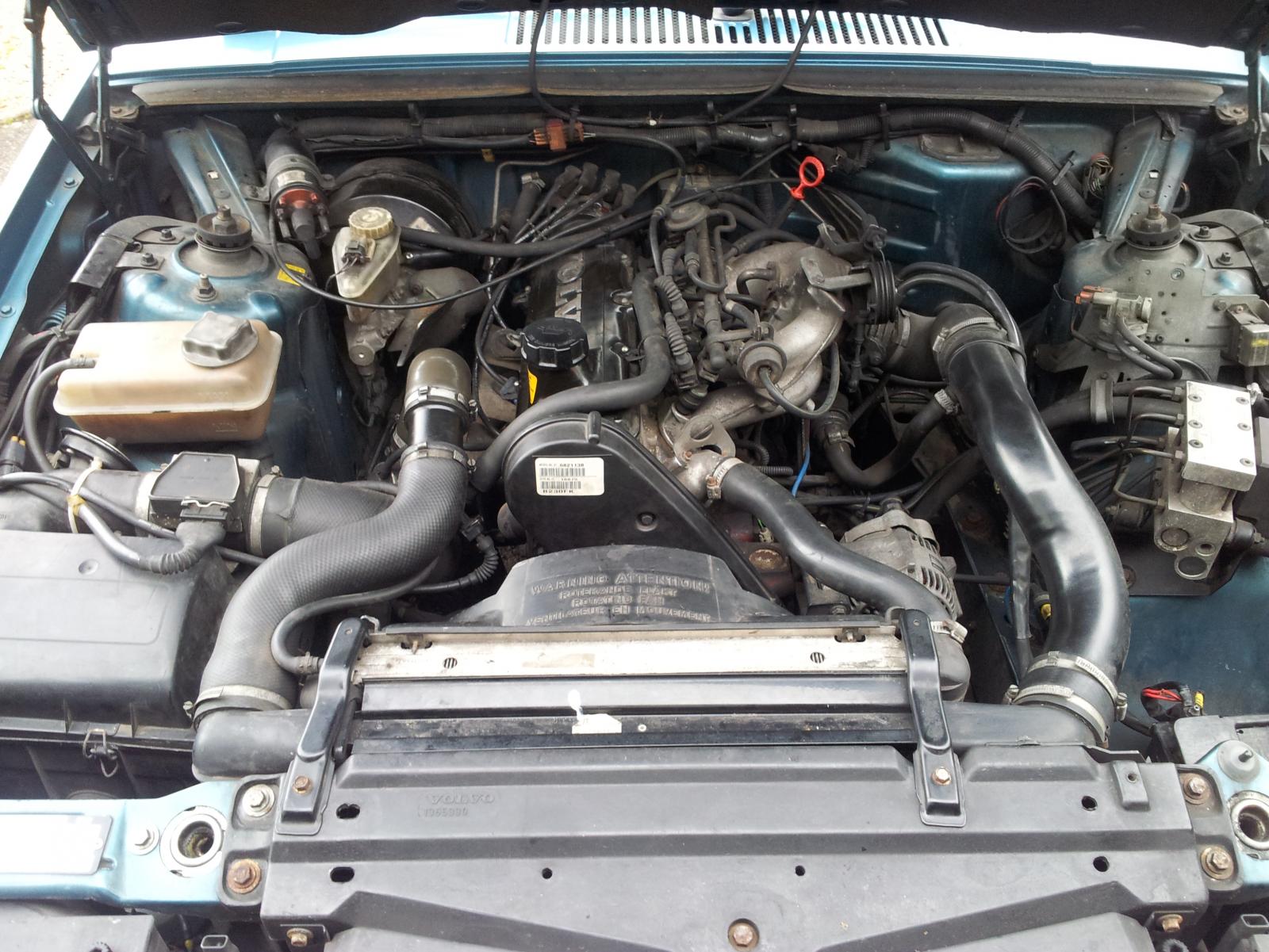

However, much oddness as a result.  I was reaching down from the top of the engine bay to try and unscrew the oil filter (tip: don't do this, there isn't room to get a good grip on it and also the exhaust manifold you'll repeatedly press your arm against is very hot, do it from underneath like you're supposed to) and I happened to discover a loose pair of connections, a metal bar protruding horizontally from the turbo area and a vertical rod which seemed like it was supposed to be fixed into the hole in the end of the bar.  With a bit of effort I reconnected them and when the oil change was done, I took it for a run.
Verdict: Well bugger me but I've been driving it around for the last 12 months with no turbo!
I had always thought it seemed a bit slow but put it down to being a big heavy car with a very low-pressure turbo.  Reconnecting that lever seems to have reactivated the turbo when I had no idea it wasn't working (this is the only 2.3 Volvo I've ever driven so didn't know they weren't meant to be like that).  The difference is amazing.  Alright, it's hardly doing sub-5 seconds 0-60 but it's gone from being a sluggish, heavy thing off the line to being quite lively.
On the downside, it does now stall when braking to a stop (e.g. pulling up outside my house).  No cough or splutter, it just turns off.  It'll restart again immediately and otherwise seems fine.  It always used to do that occasionally anyway but now it's almost every time which is a bit annoying.  I wonder if someone disconnected that lever for that reason?  The garage who did the oil change for me last year after I failed to get the seized sump plug off missed it, as did the mechanic who sold me the car a year ago.  It seems likely, from what I've read, to be either the idle control valve needing a clean (it does idle a little unsteadily) or a vacuum leak somewhere.  I'll have to try and work out what's amiss fairly soon though.
Does anyone have an idea of the mechanism I'm talking about?  This is my first turbo car so I'm fairly ignorant about exactly how the turbo's various pipes and connections work, although I understand more or less its function.
Despite the stalling issue, I'm delighted, it's made it so much nicer to drive, plus, given that my credibility as a man got a serious blow when I was forced to hand the sibling's i10 over to a professional to change the clutch as (a) I couldn't get the driveshaft out of the gearbox and (B) had no spare time I feel vindicated that I've fixed something that at least 2 garages have missed, albeit by accident.
Wonder if it's like my SLK and the clogged PCV system has also fouled some sort of MAF-like thing. The rod is a wastegate control?
Maybe - I wouldn't rule something like that out.  I'm not convinced the PCV system is actually completely clean despite last year's work, it mists a little oil from the filler cap and about 6 months ago blew the dipstick out on a vigorous run.  I put a tin of Wynns Super Charge in it which turned the oil black but seemed to help a lot.  Obviously that went out with the old oil tonight so I do want to try and clean the PCV pipes out again when I get time.
Thanks Richard, wastegate it is.  I could only feel it and not really see much but it's definitely this:
