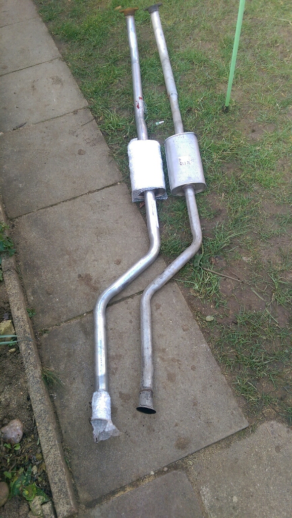

Well, yesterday I got the exhaust fitted! Having done the job 3 times before it didn't take long, and soon I had the old one laying next to the new one
The new one went on a treat, and I used my new fixing fit to secure it, which resulted in a much better fitment. Also, top tip is to sellotape all the bits together, poke that onto the bolt (the bolt puncturing the sellotape holds it all on) then wind the nut on! The exhaust cant get too hot as the tape from back in August when I last did it was still very much there!
The exhaust also fits to the backbox correctly, and the backbox now doesnt sit at a funny angle. I could fit and bolt the clamp on one handed, before this required me to lay under the car and bearhug the exhaust and backbox together.
Job jobbed, ALL TEH NOIZE HAZ GONE! I went to the tip on Sunday, in blissful silence! No more banging as I lift off to drop a gear to turn a corner, no more suicide rattle when cruising at 45 in 5th, no banging as I lift off a bit at speed (basically ANY engine movement was heard via the exhaust.)

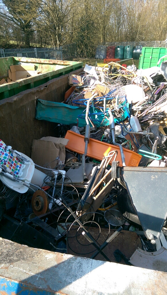

Whilst at the tip, I threw the old exhaust in the scrap skip, and also binned the cat part I bought in error last year, had a clearout from behind the shed, even asked the elderly neighbors next door if they had anything as they were out in their garden, got some chairs and an old washing airer gone for them

O yea, what was really fun was throwing my mates old octavia brake discs through that bbq that's front-right of the shot. A massive lob made it fold the BBQ in half.
Shame there wasn't a toilet or sink in there...

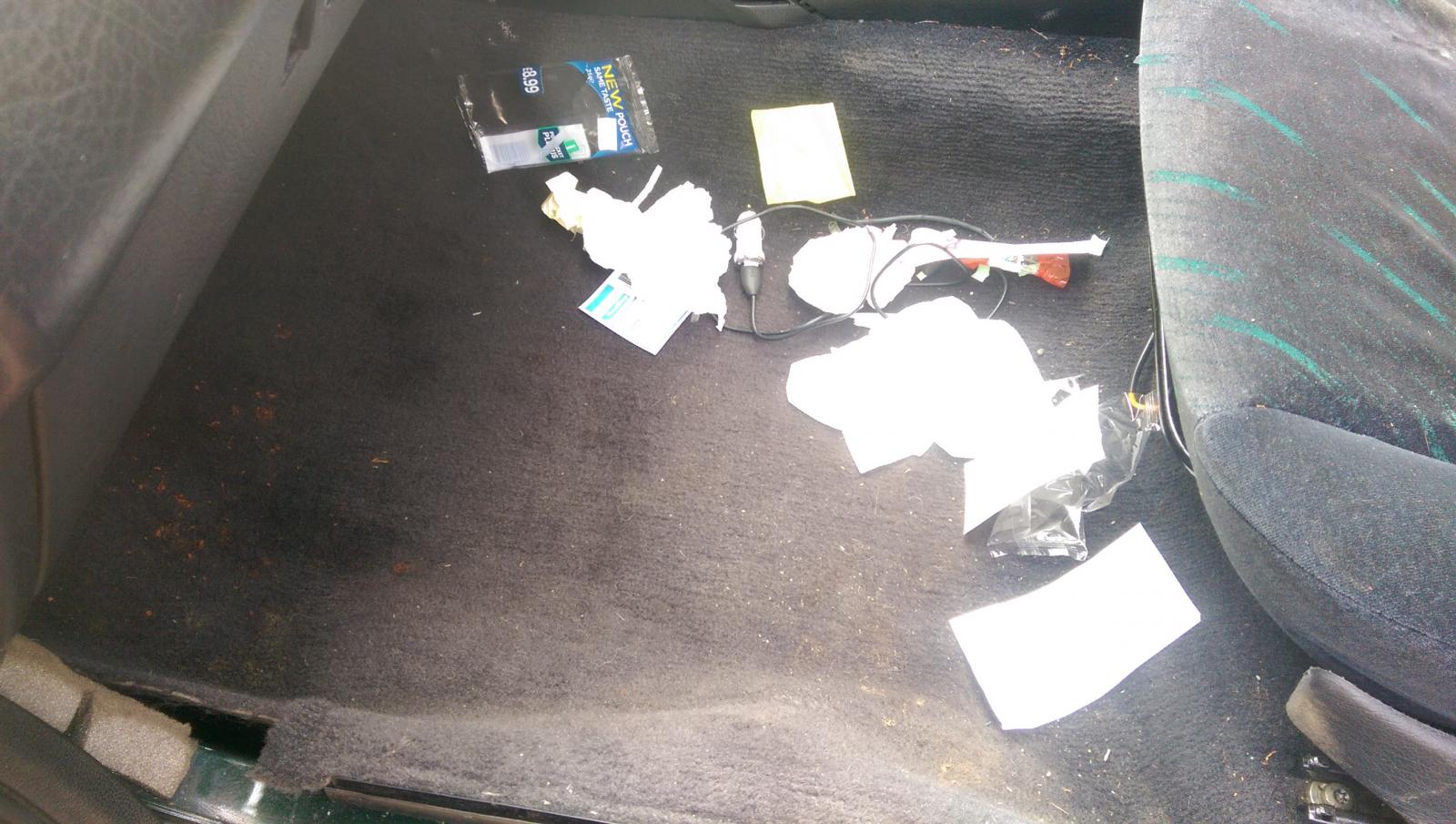

it was a bit of a skip. First thing was to fire up the wet vac and dry the carpets out
This is the cleanest footwell of the whole car!

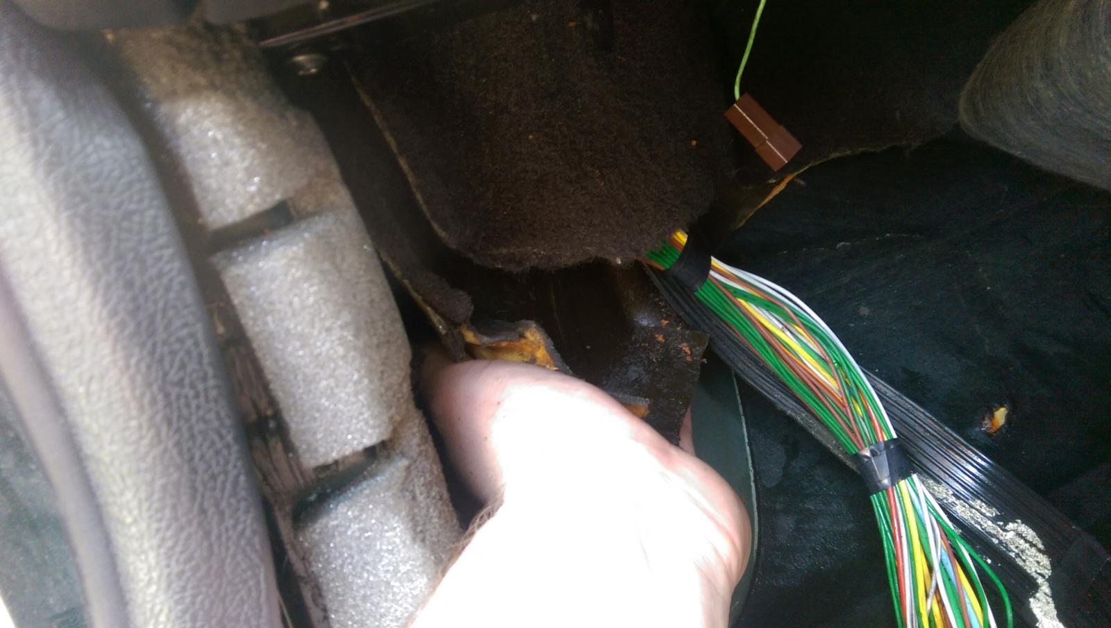

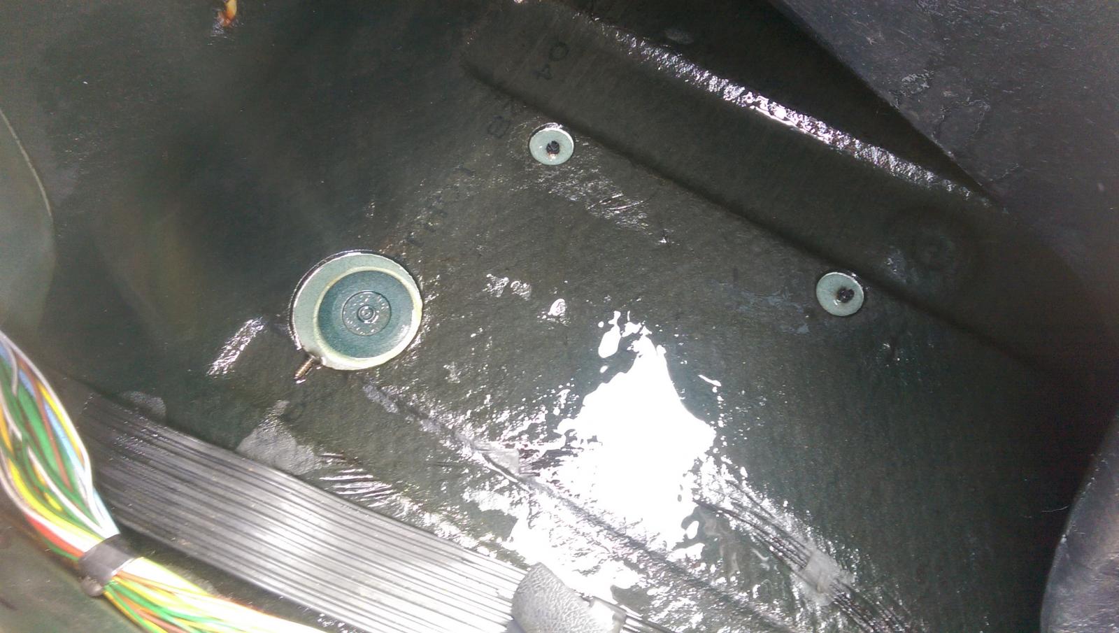

Was a bit damp under the front carpet too, but with the sound deadening removed it just sits there, not coming through the carpet
Luckily I left access easy to pull it up and dry out underneath
Up here does seem a bit damp

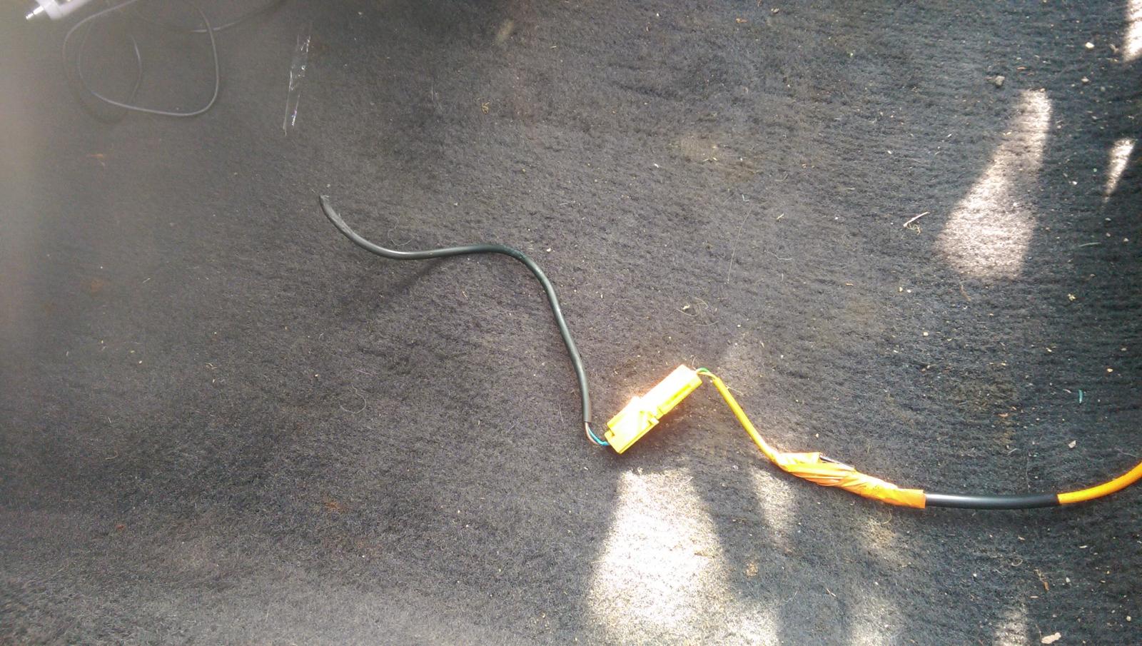

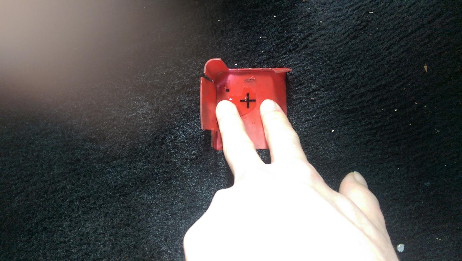

Sadly I seem to have chopped the cable for the seat belt pre tensioner, must crimp that back together at some point. Took the connector off and tucked the wire up out the way to avoid any further damage

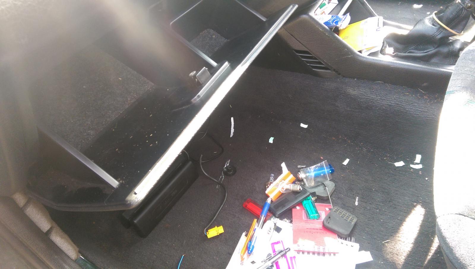

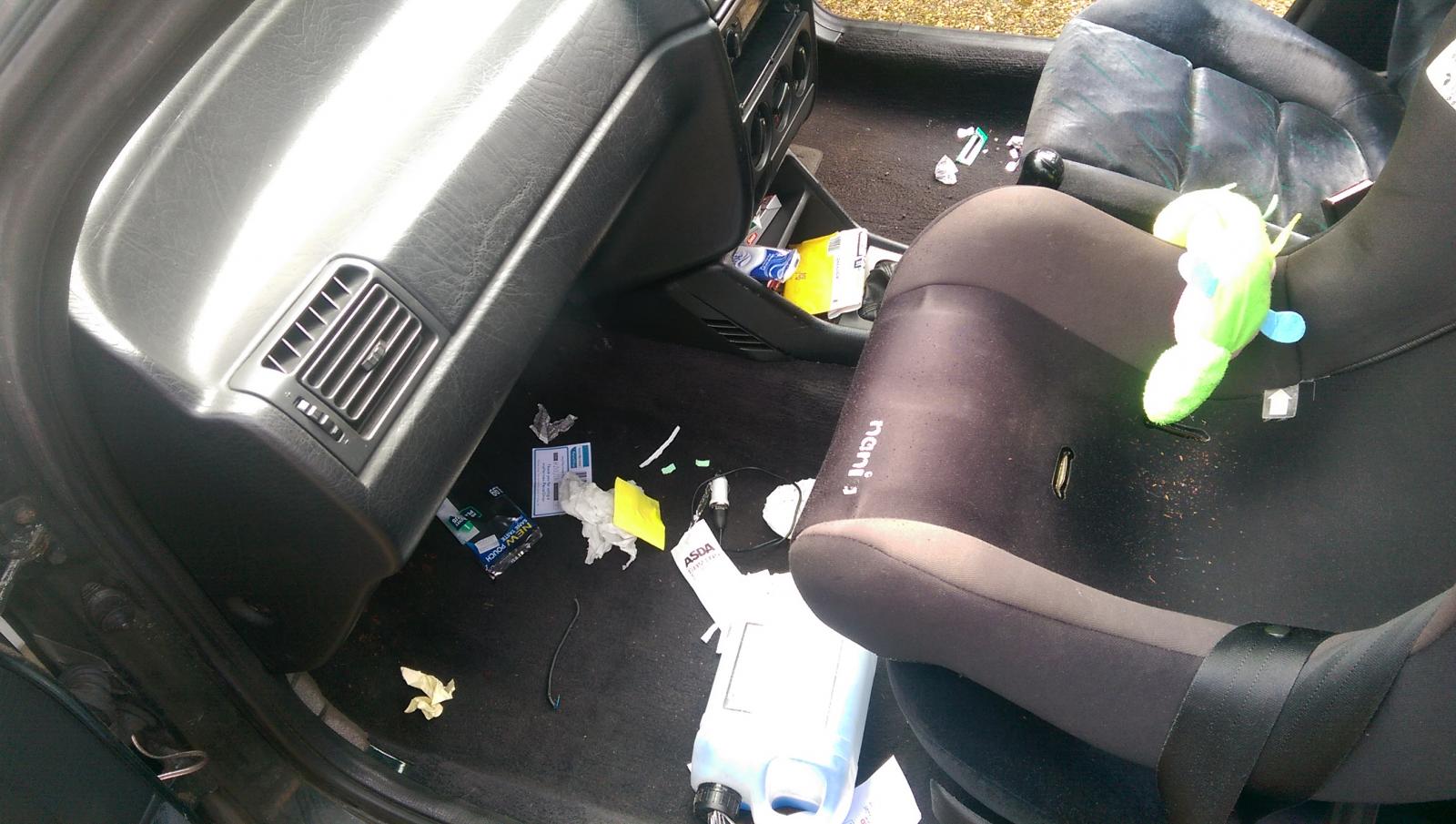

Decided to empty the glove box out, and tidy it up as the shit in it rattles when the clutch is in a certain position

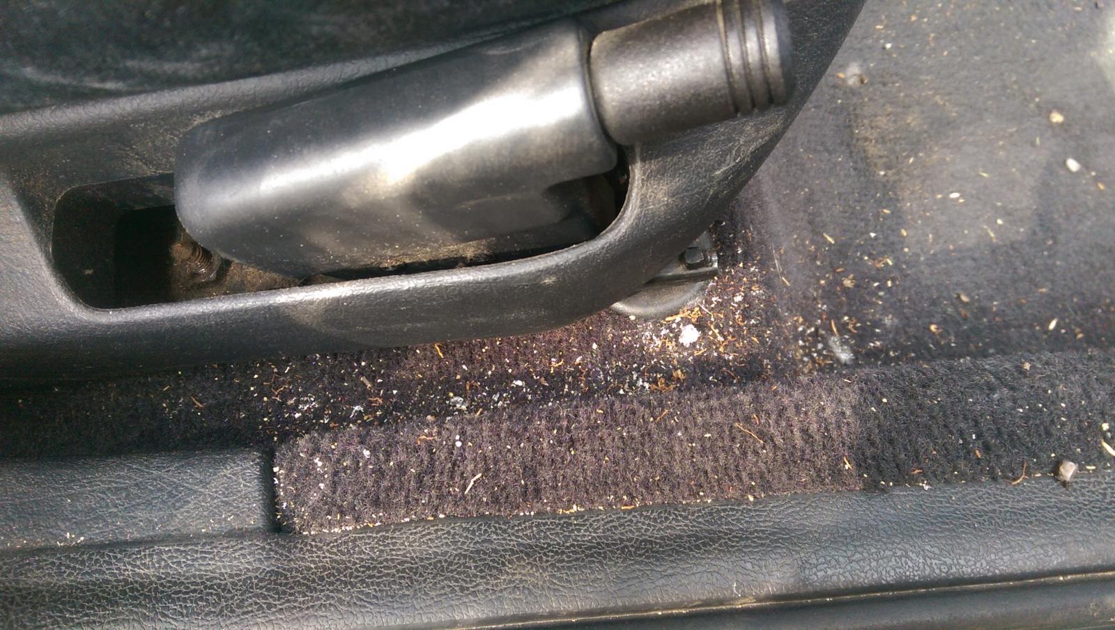

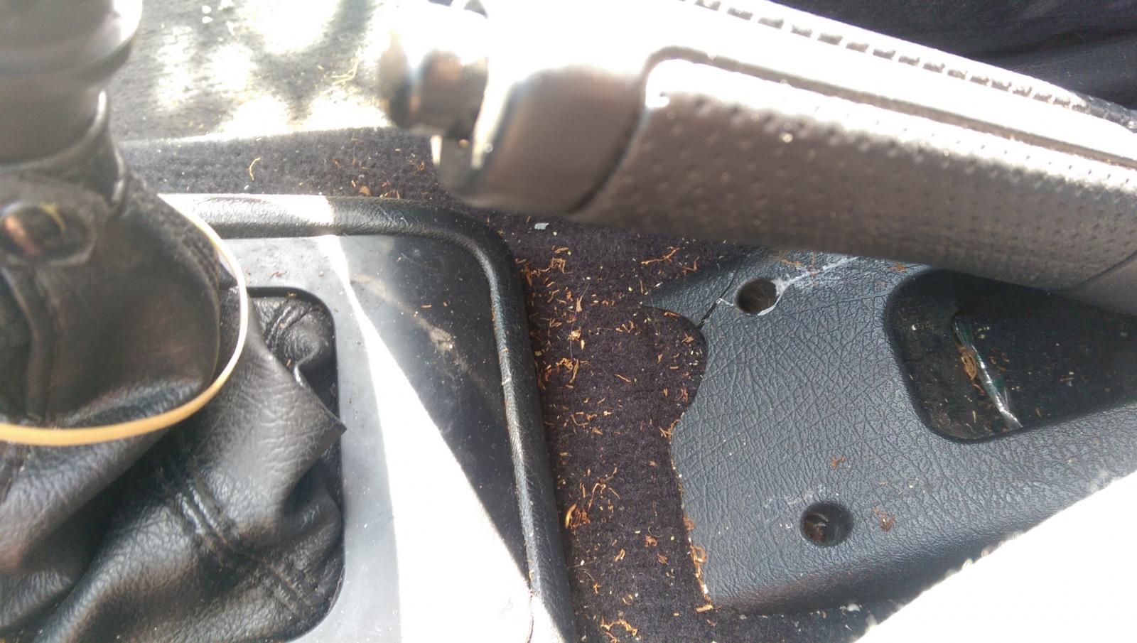

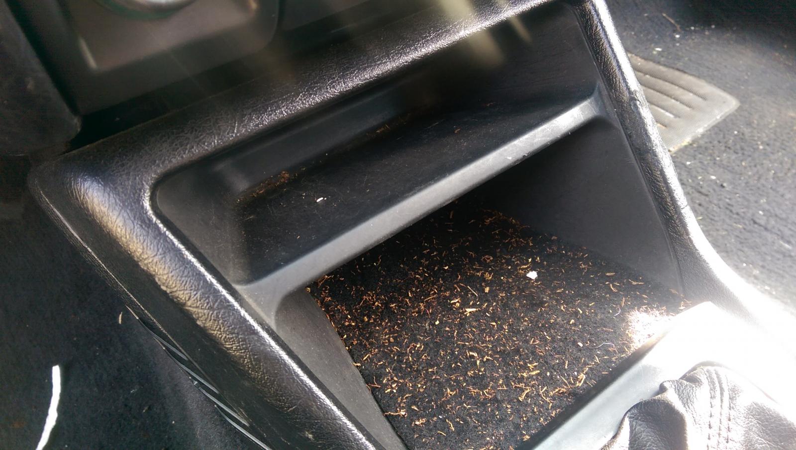

Centre console was a bit baccy-tastic
Radio was dusty
I do roll far too many rollies whilst sat in traffic...
However a good going over with Henry sorted it out

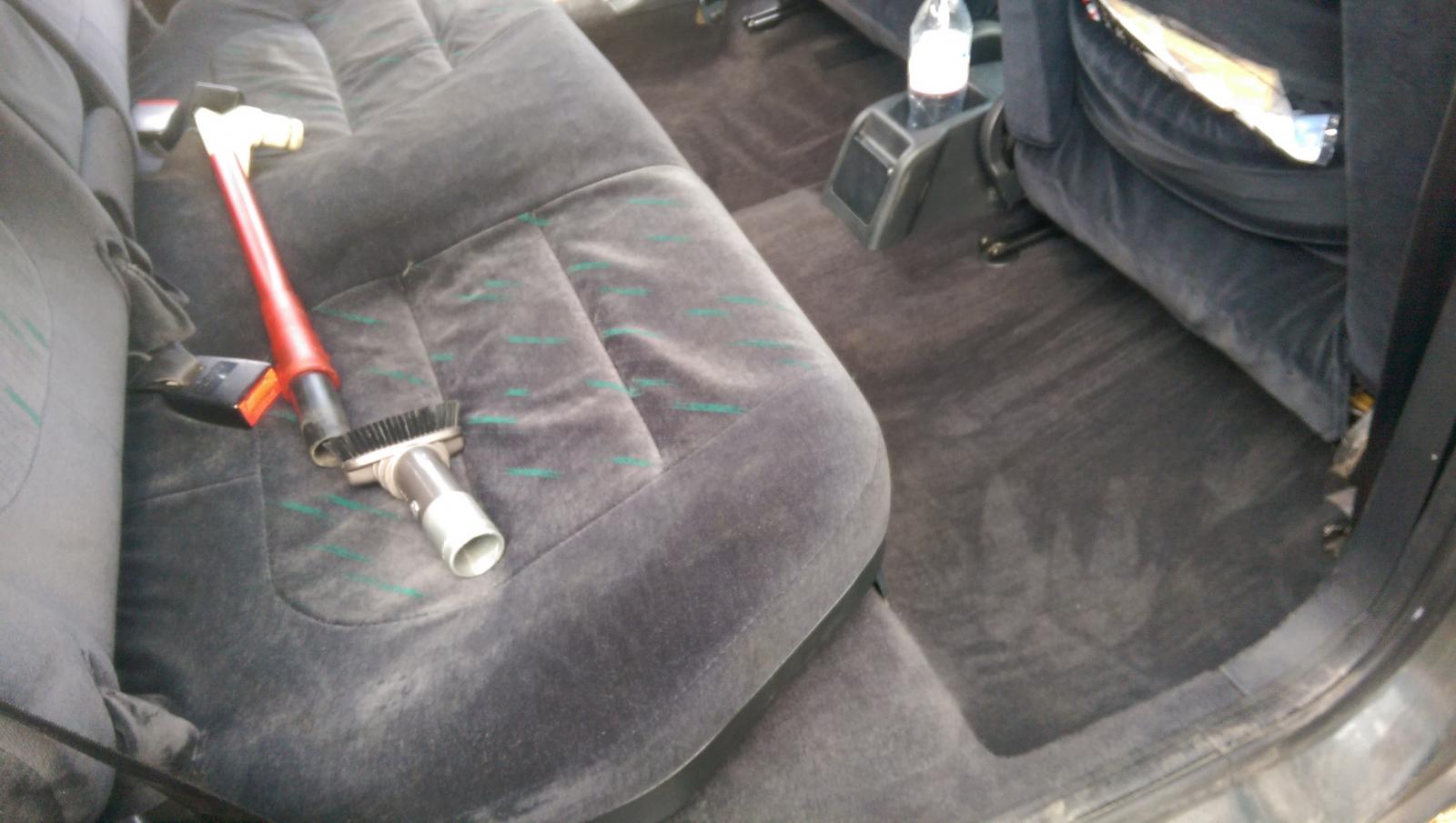

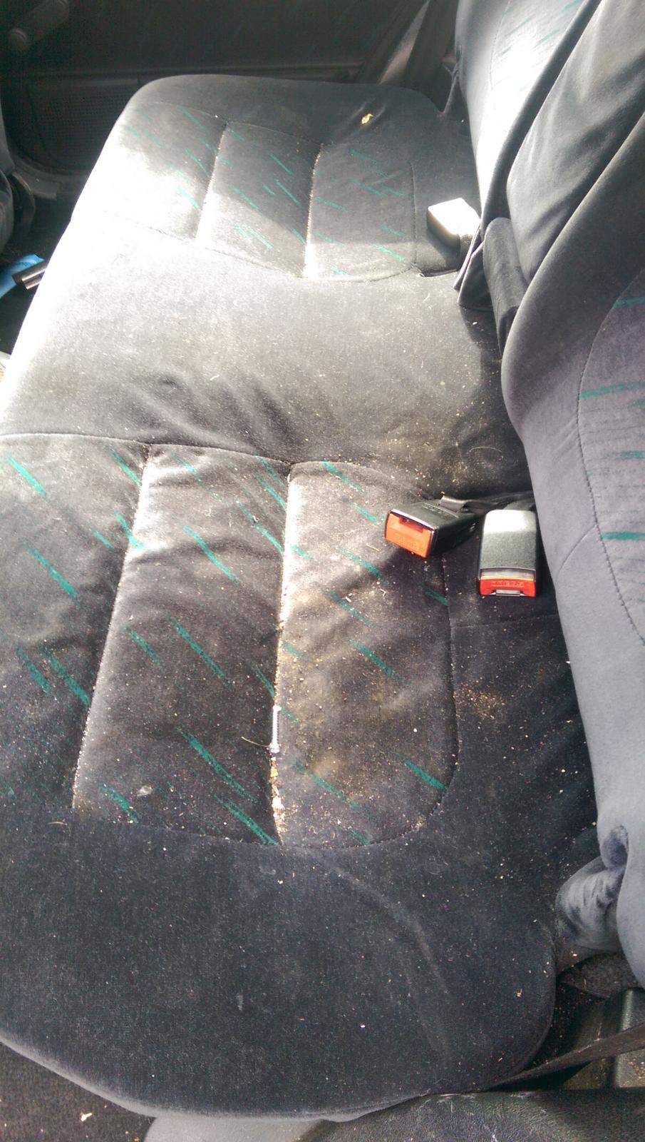

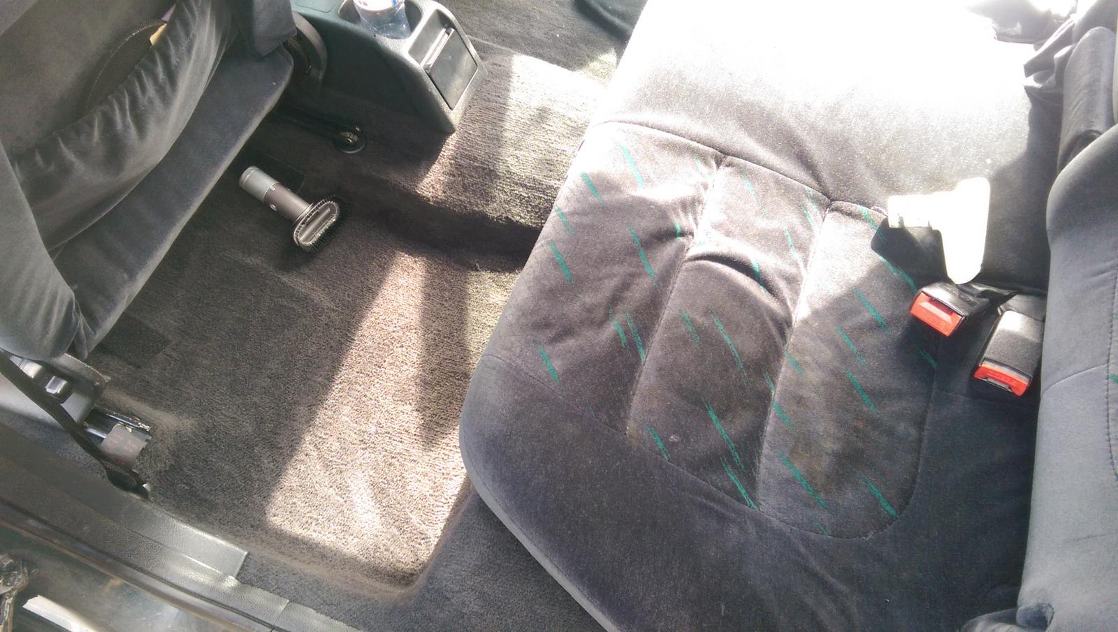

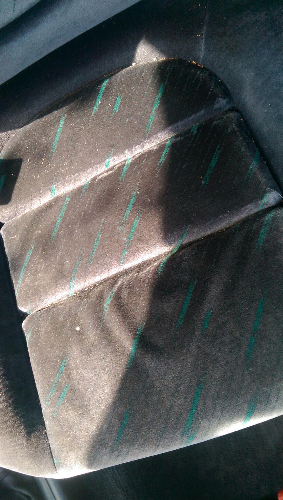

These seats are pain, as the covers pull around with the suction, and there's so many nooks and crannies. One full of tiny tree bits from when I parked too close to a bush the other week...

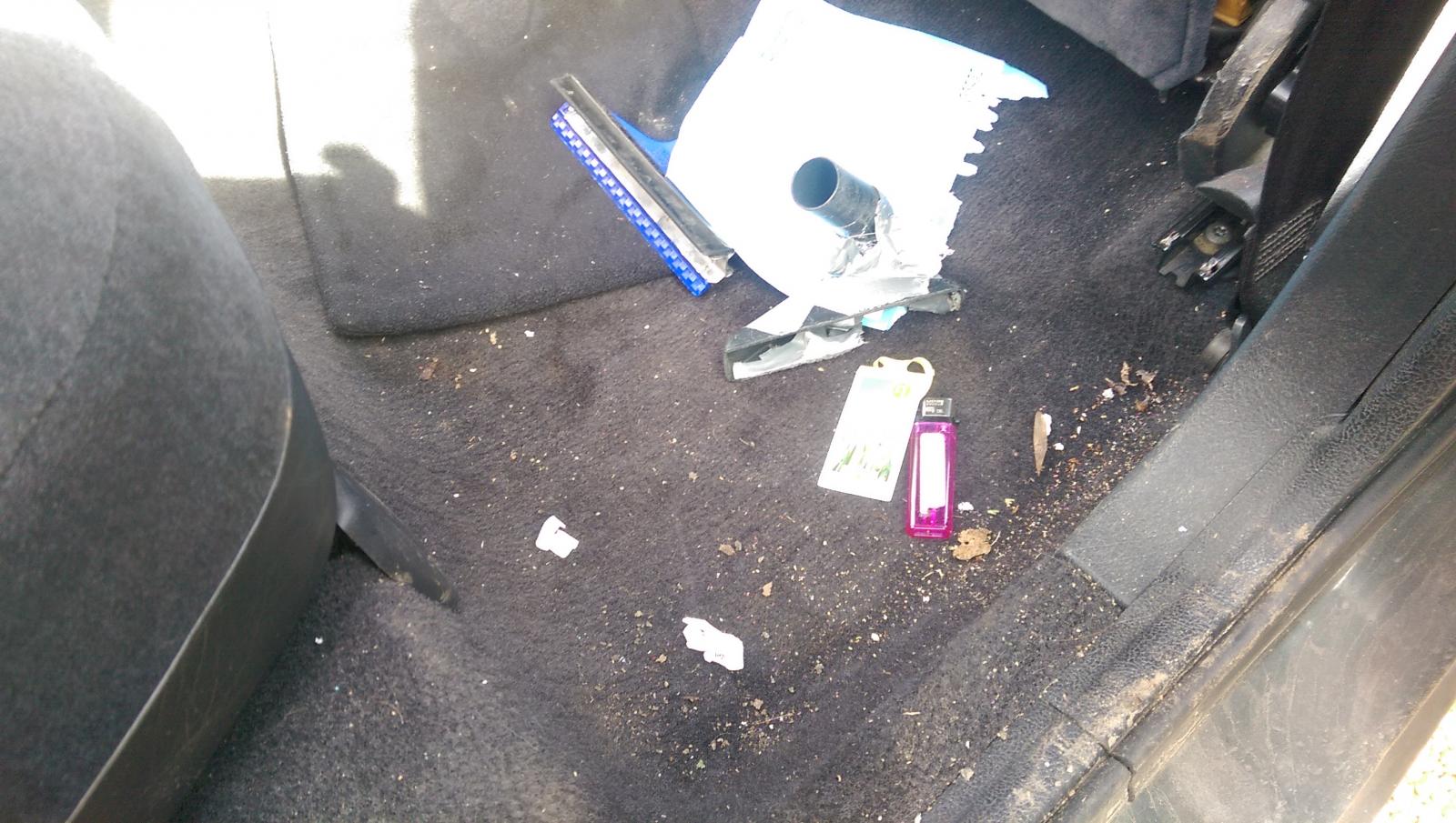

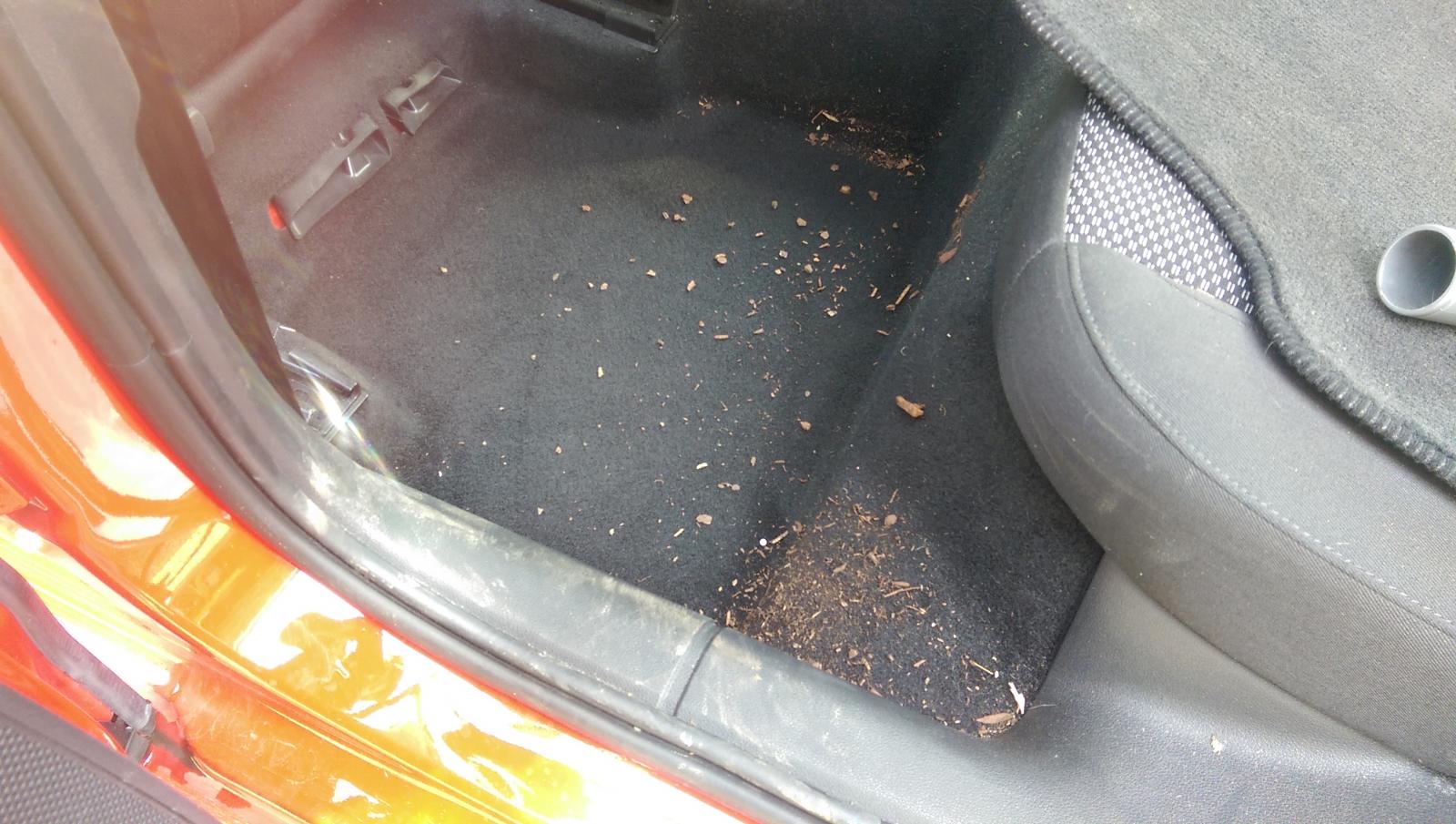

Rear bench was covered in the remains of the last tip run I did
More hot hoover action

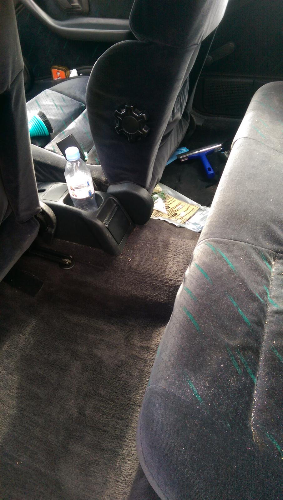

Behind the drivers seat was terrible. Remains of a Goblin gulper tool were found, and my scraper went back in the boot hopefully for the rest of the year now
However, a quick flick of my magic fairy wand
and it was clean again!
Dyson spot brush and the scabbard tool from a Hoover Dustmanager proved ace for the task

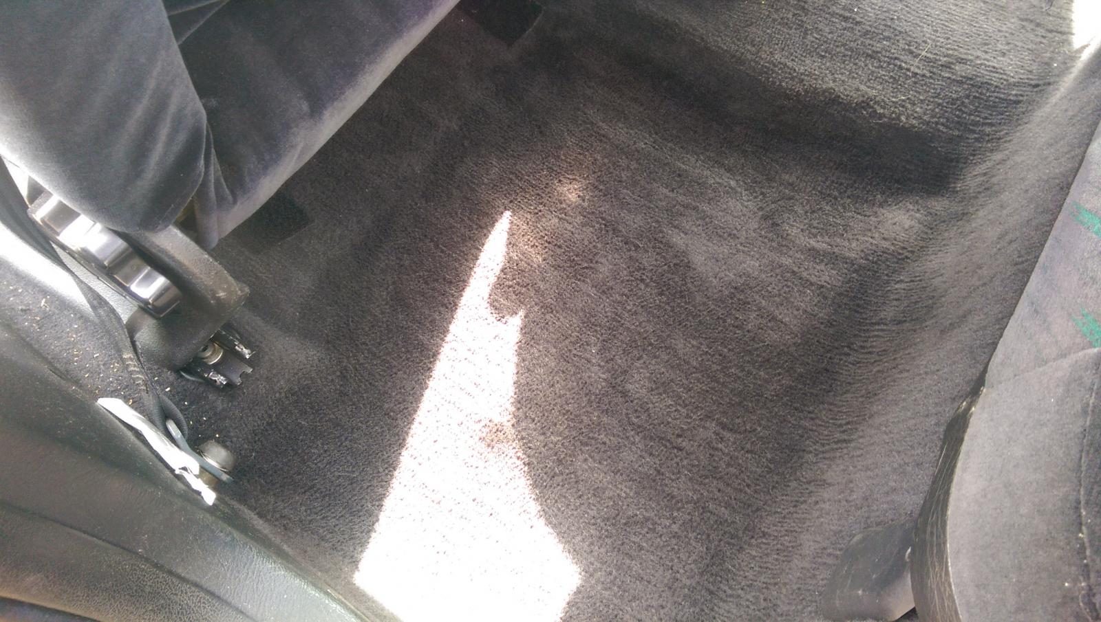

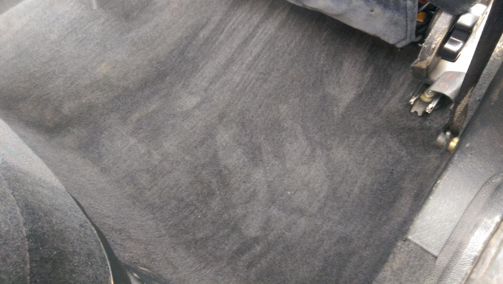

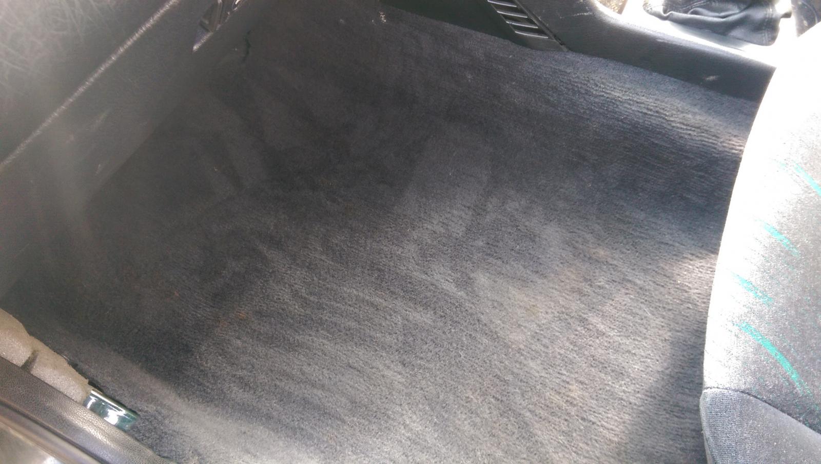

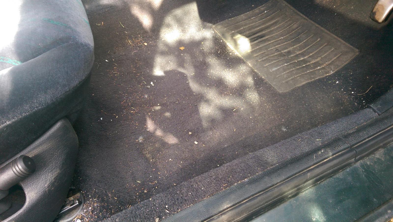

However, the drivers footwell see's the bulk of the crap, it's getting very ingrained too
Some considerable time later
and it all looked much much better. Dashboard got a good vac with a Dyson dusting brush

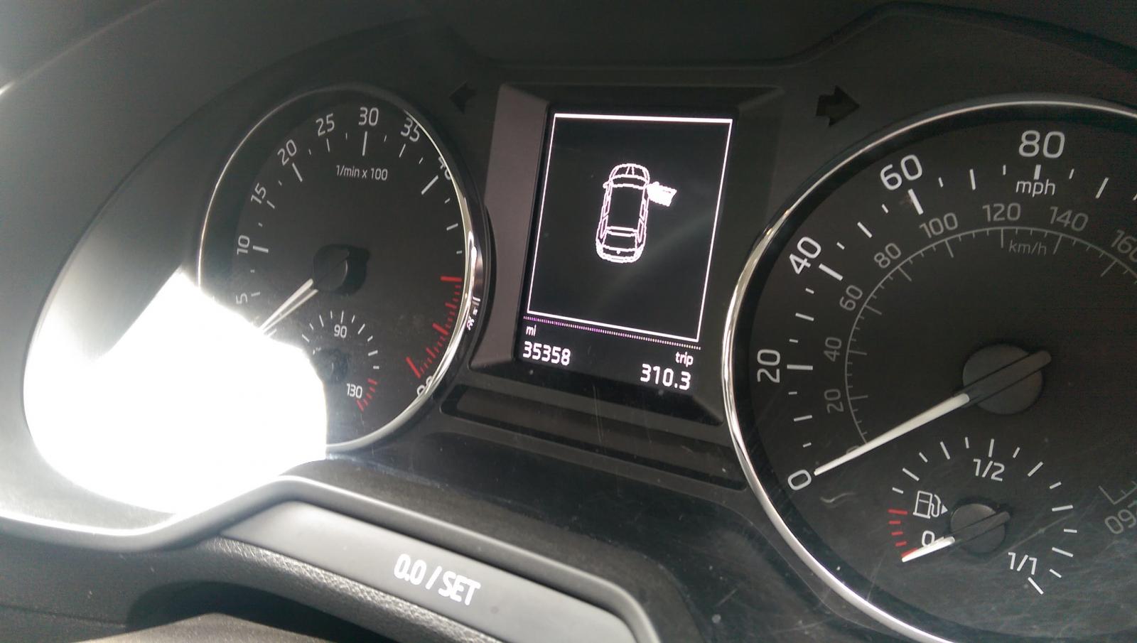

Mileage quoted for prosperity

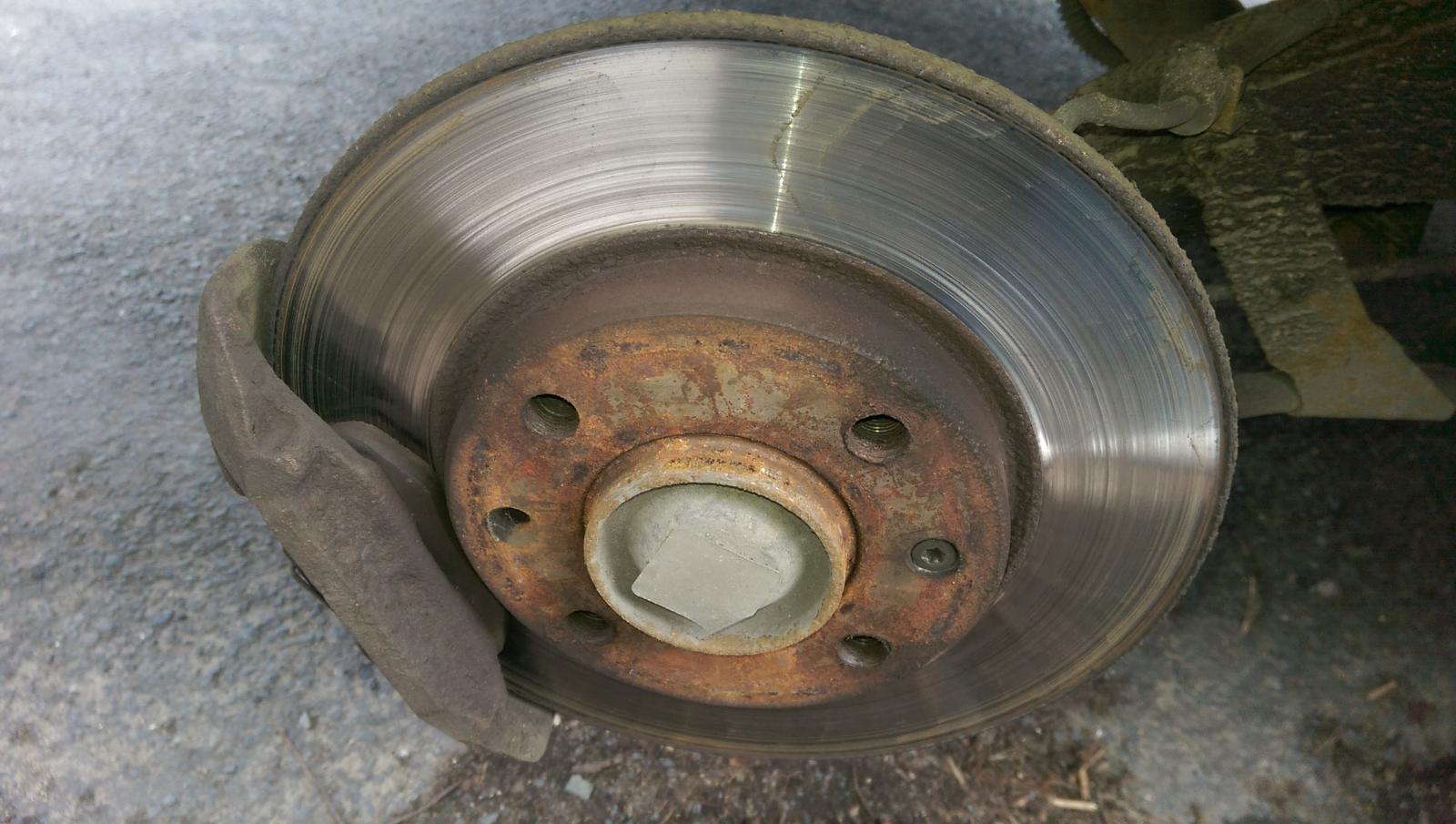

So, after the chap with the blocked Dyson eventually turned up, I got on with what I had planned for today, which is have the wheels off and see if anything is amiss and making the drone at 50mph, and to swap the wheels back to front.

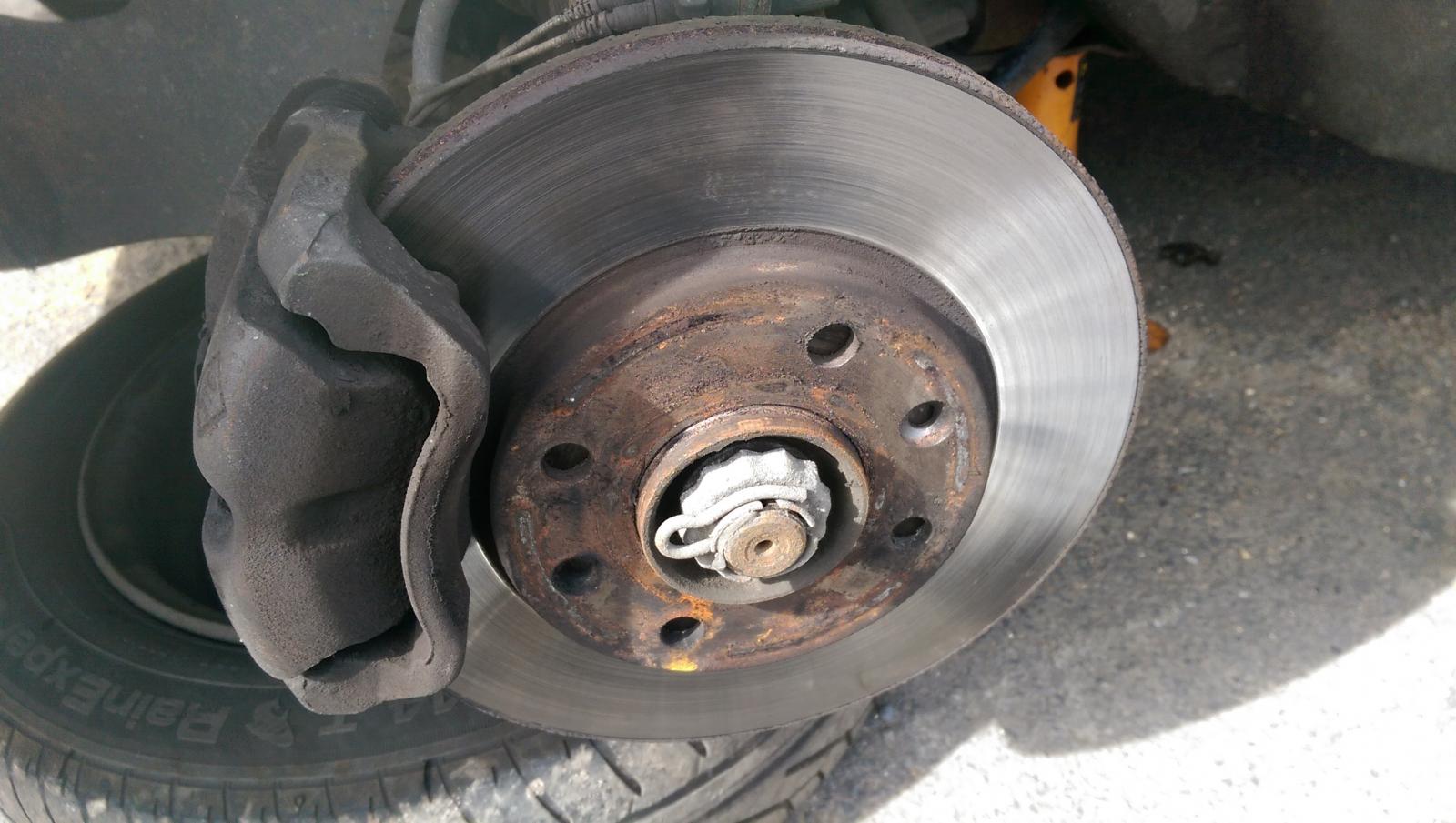

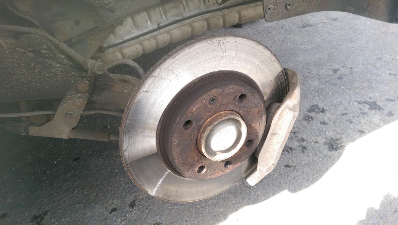

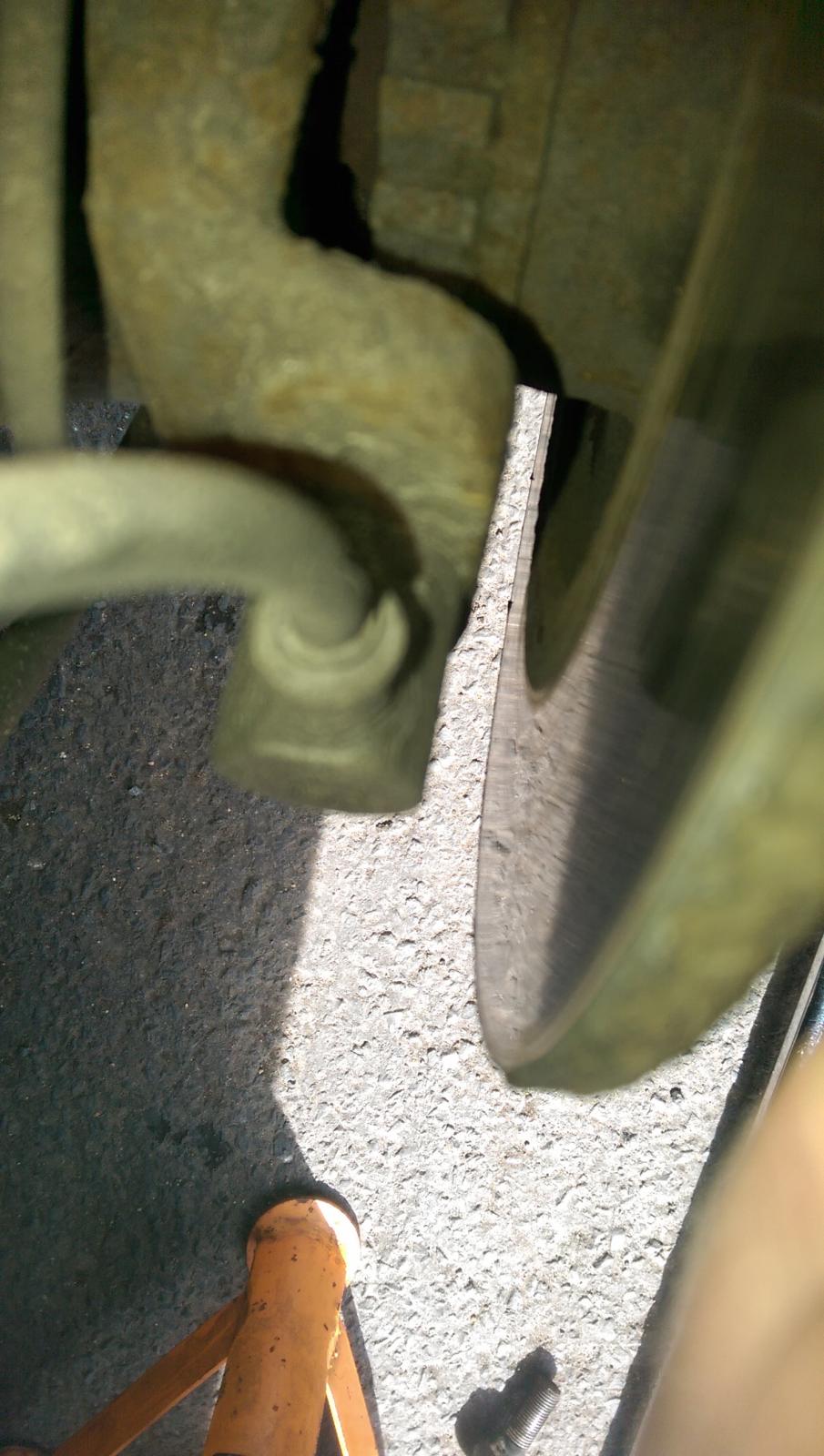

So, front passenger side off first

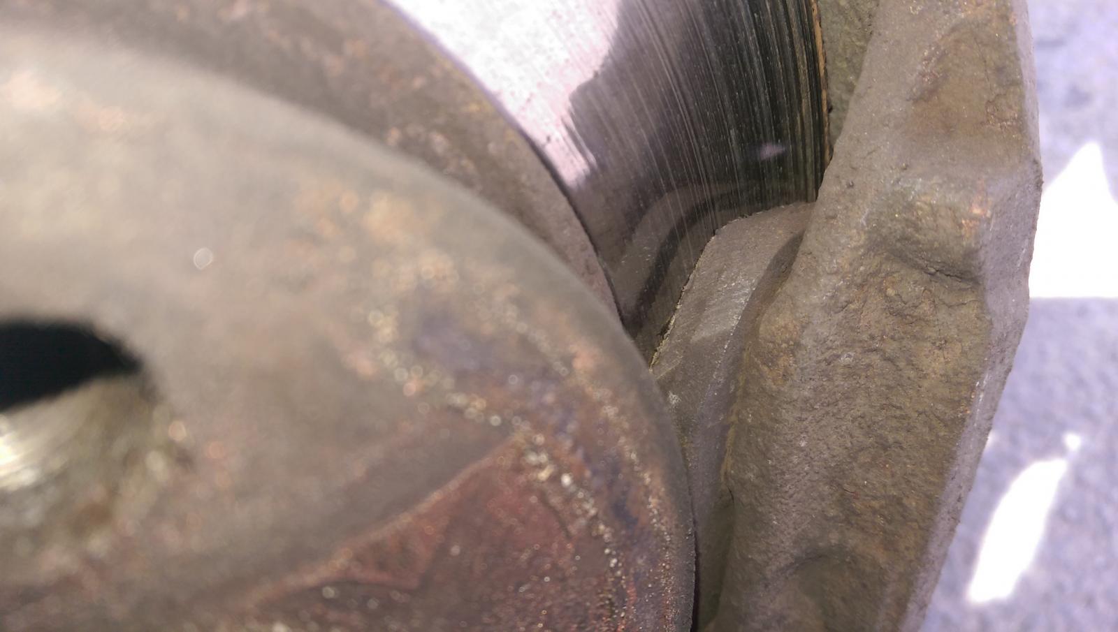

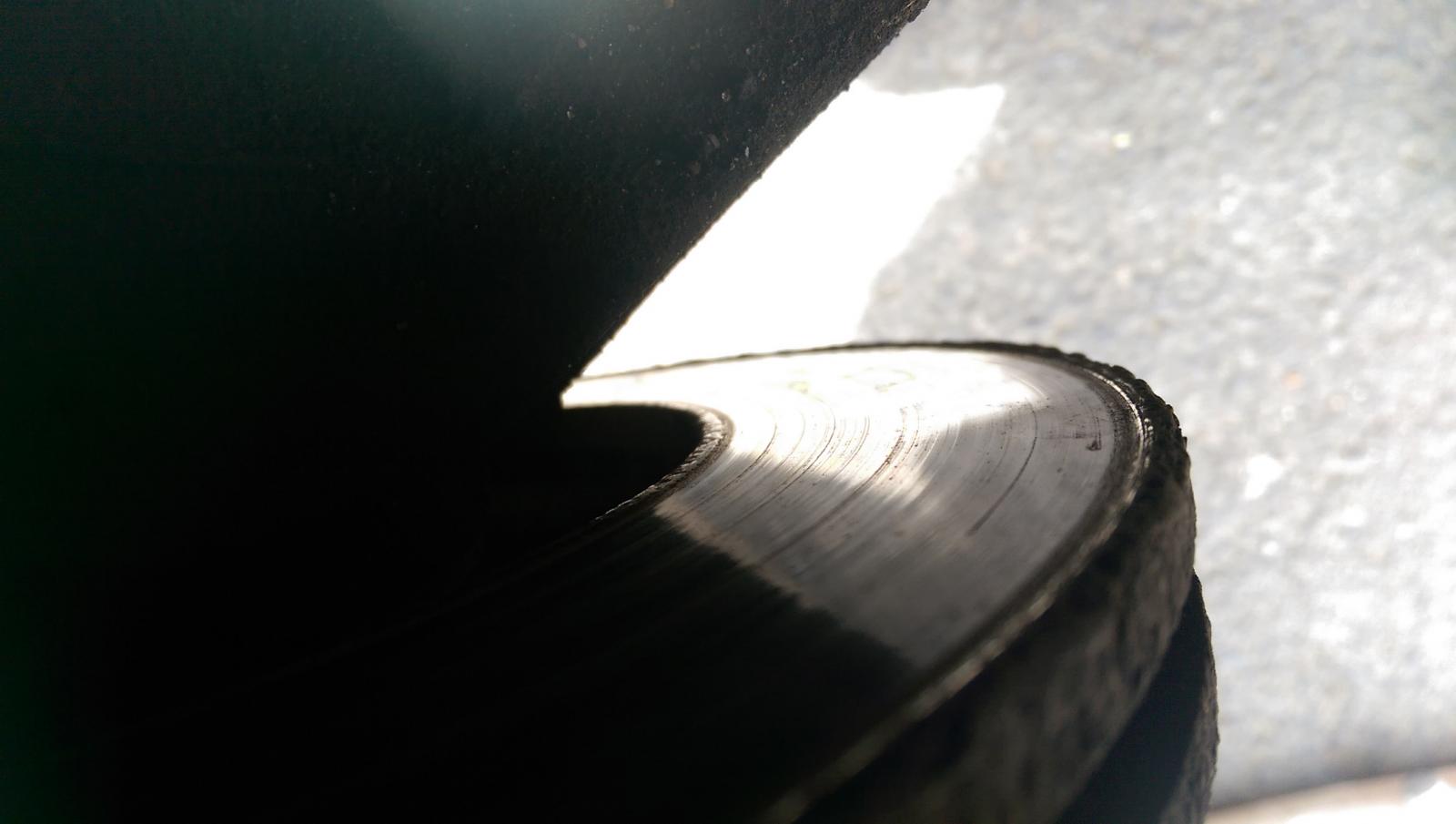

Discs look a bit smeggy

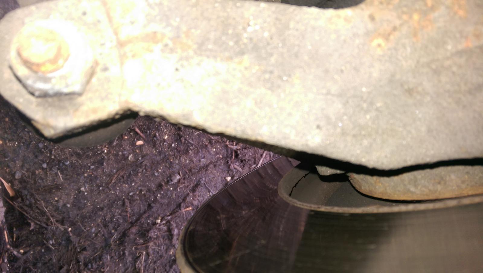

And the pads which have not worn in the entire time I've owned the car are starting to eat into the discs
Plenty of meat, but I'm suspicious of this...
But nothing to suggest anything too bad, and it brakes fine, so I jacked the rear up and took it's wheel off

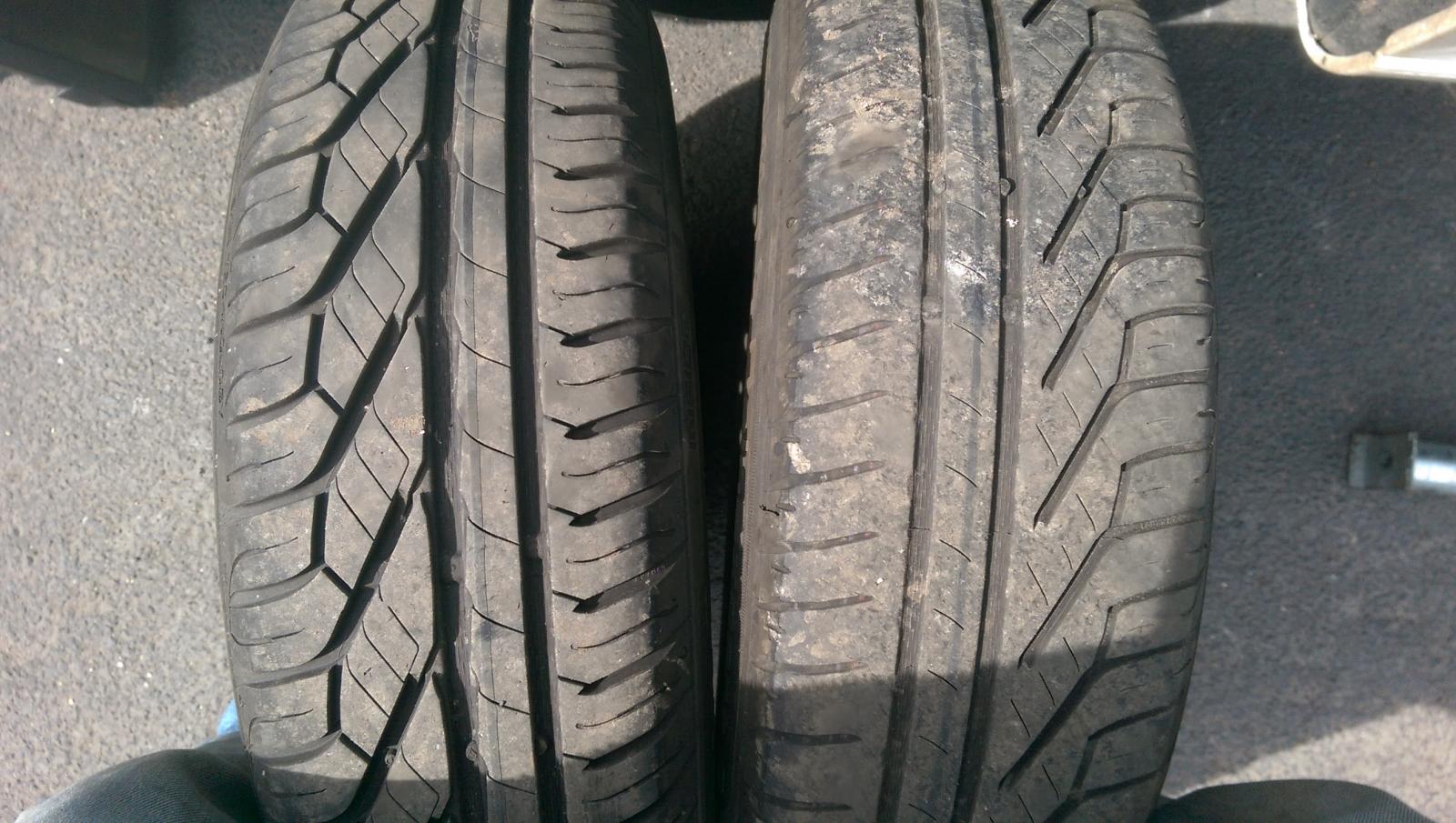

I just dug the email out from when I bought these, June 2015, so only 9 months to wear down to this. Methinks the rubber is a bit soft...

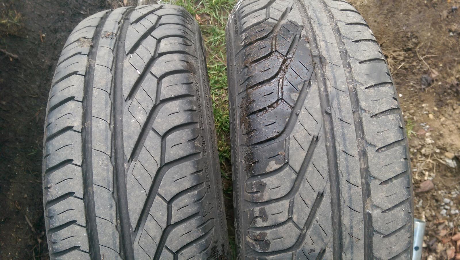

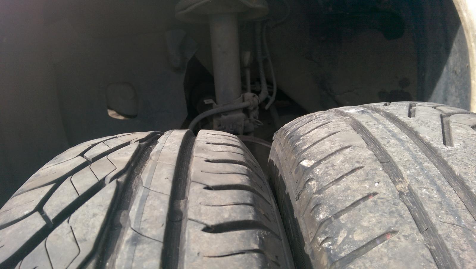

Front wheel on, I had a look at the rear just because
The rears are proper tired, but there's still some meat on the pads, and they worked fine on the MOT, the red bars on the brake test were even and true
Not lipped either
but due for replacement this year (I put it off last year)

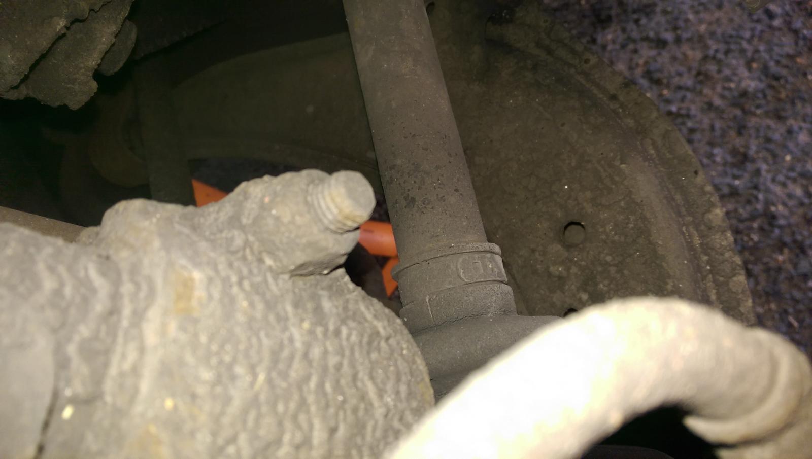

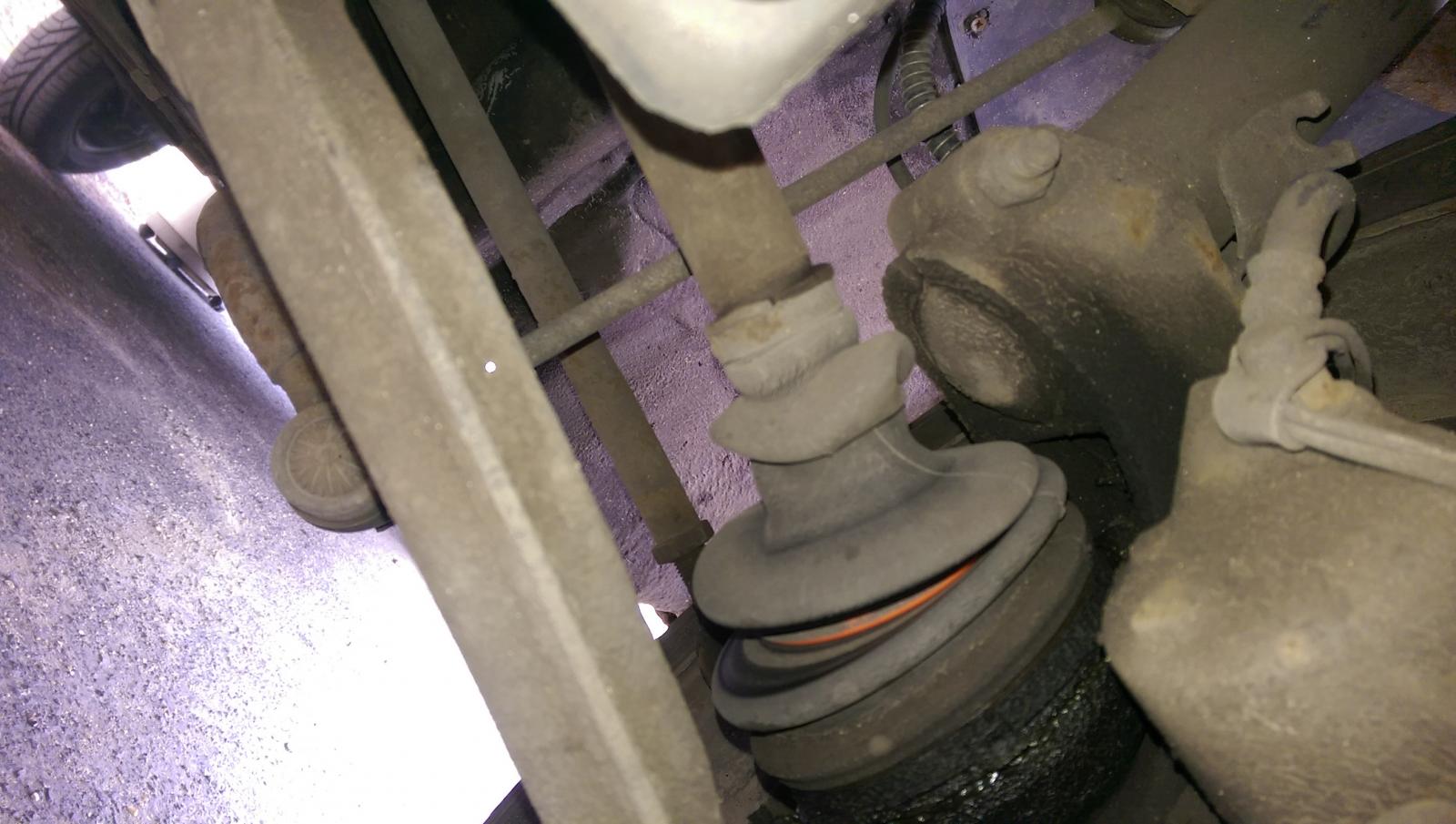

One thing I noticed when looking at the front was the drivers side CV joint boot looks like this
but the passenger side looks like this
Is this a problem?

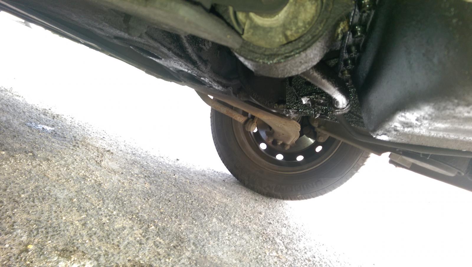

Also underneath, I note some oil where it should not be
Either way, passenger side done, drivers side now
Same story on this side, rock hard unwearing pads eating away at the discs slowly
Not quite as much of a lip though
More oilyness. It doesn't drip onto the road (well it does, over 2 years where I park is a bit oily, but day to day nothing. I probably should start to work out where it's coming from though, seems to be inbetween the engine and gearbox...
Drivers side front wasn't as worn as the passenger side, the tracking must have not been out as much

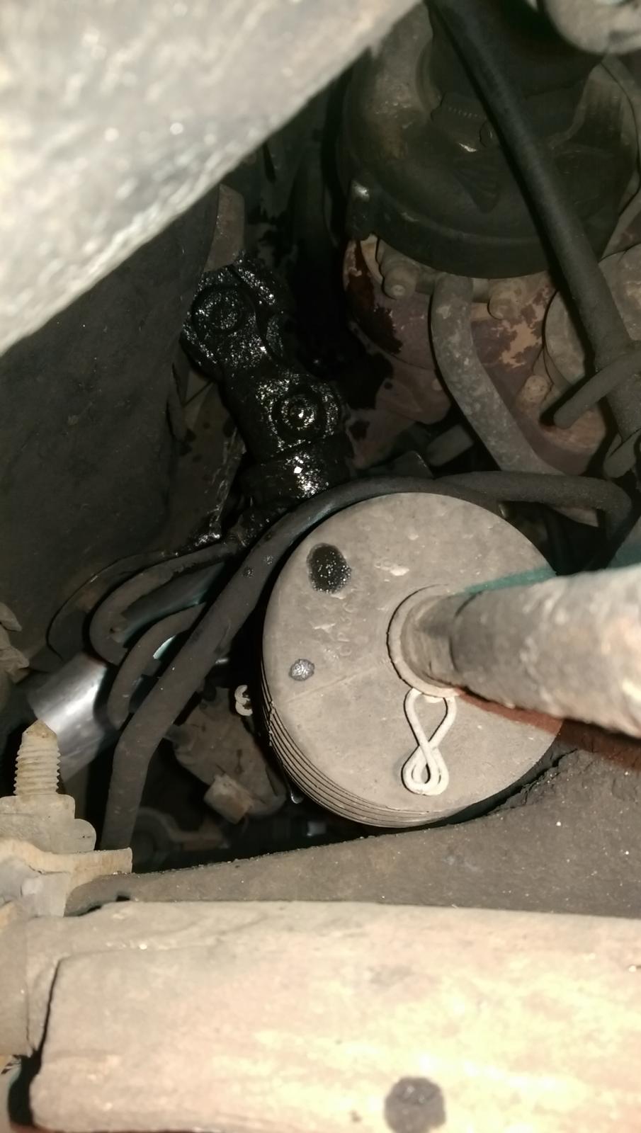

The last thing I did was spray some grease over the steering UJ, as reading lots of forum posts (mainly for Xantia's which is not much help here) saying it can dry out and cause issues. I sprayed it and hoped for the best.
After a test drive to amy's sisters after this, the steering is still quite heavy, the noise is still there but the steering feels a bit more 'precise'. It's odd to describe, when wobbling the wheel side to side at speed, I can feel it alot more than I could. I also got shitted up by a bloody bike, coming down the road, 2 bikes appear behind me. I'm going quite slow by now, as I'm approaching a junction, and remembering SF15 when a bike did this then came alongside me, when he suddenly hung back and started weaving over the road. I'm sure he was flashing too, but it could have just been his lights pivoting with the bike. Either way, radio off, and I was 1/4 miles away from my destination so kept going, nothing felt odd, all looked ok when I stopped but FFS I thought the bike was trying to tell me something. He pulled into the shit pub by Breadvans so I'll never know!

Wonder if that oil leak is causing the drone?
XUDs leak a bit of oil, I wouldn't worry about it.
