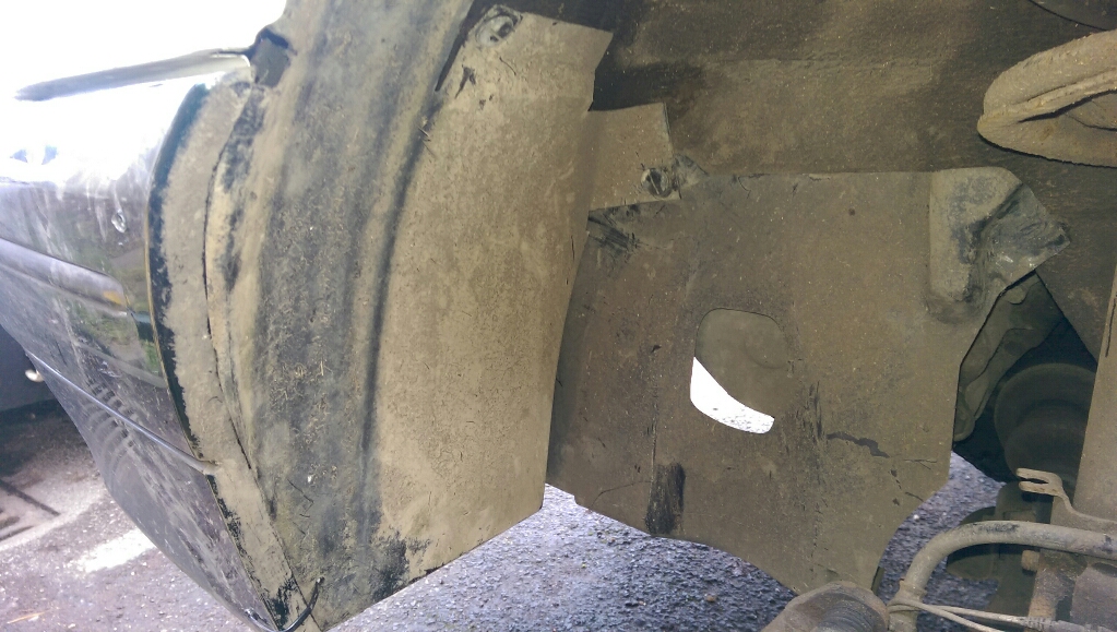

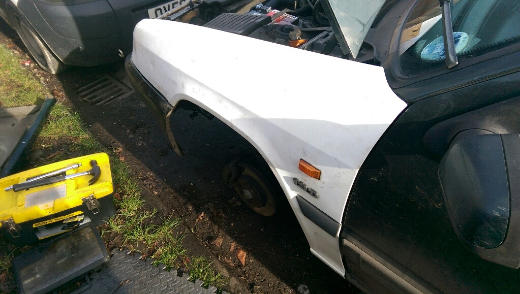

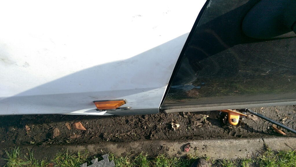

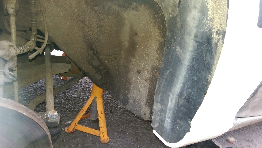

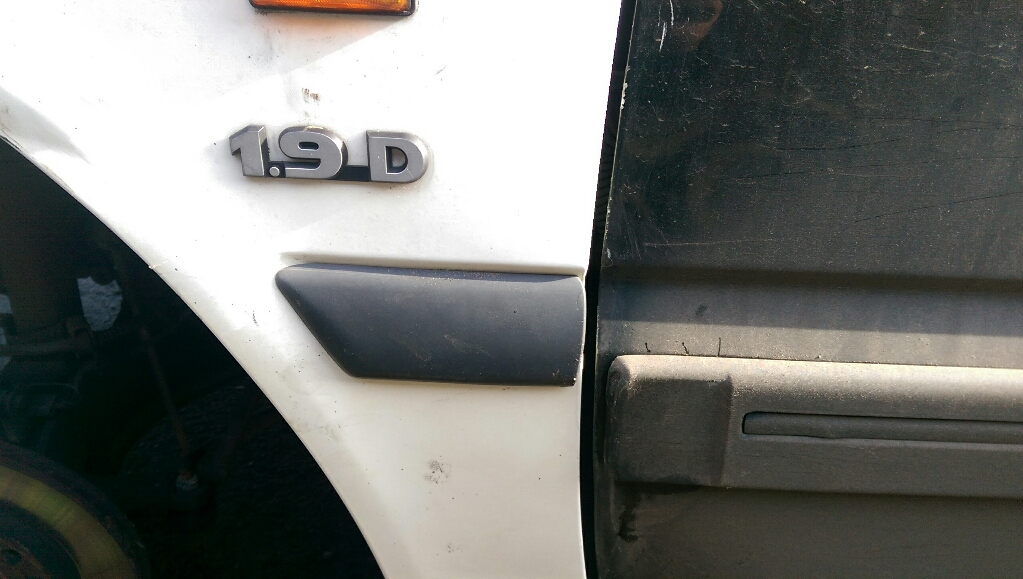

beko1987 Posted February 14, 2016 Author Posted February 14, 2016 Well, the sun came out this morning, so I popped out to have a look at the wing and arch liner. Old one came off easily, and after a bit of hammering to the mount for the wing which got a bit bent it seems, the new one went on a treat Panel gaps that would make a new car proud The trim almost lines up... Looks a bit pikey, but sod it, it fits! The new arch liner went back in much better too, now it can be held in with the wing as it should Only had to use one cable tie too to bring the bottom of the front bumper in to meet the arch liner, the clip that sits down there is broken and missing, I removed the remains of it whilst there. Even better, I fitted the bolt that's been missing since I got it, which brings the front of the wing vaguely in line with the indicator We shall see tomorrow if that helps. Other stuff I did that I didnt take any pictures of include: Noticing that with one hub straight, the other side isn't... must get the tracking done on payday, this might be part of the drone I have, and why the inner of the tyres are wearing faster than the rest One of the aux pulleys is greasy! With the wheels off and the car up on stands, the steering is light as anything. I sprayed some carb cleaner on the pulley to try and get rid of the grease, and did some more with the car running and the brief drive up the road I did does indicate lighter steering. May pop a new aux belt on soon, and clean all the pulleys up with it off. I'm hoping I just dribbled some power steering fluid down there by accident, rather than something leaking onto the pulley, but I can keep an eye on that. The front passenger brake disk is warped I think. Spinning the wheel by hand, it just slightly chafes on something every revolution. Again, could explain the drone at speed. New front discs and pads may/should dial that out hopefully. Rear and front footwell are wet again, wet vac fitted in the boot, will do that at mums one lunchtime in the week, CBA with that now! All in all, a productive day! CGSB, UltraWomble, scdan4 and 3 others 6
