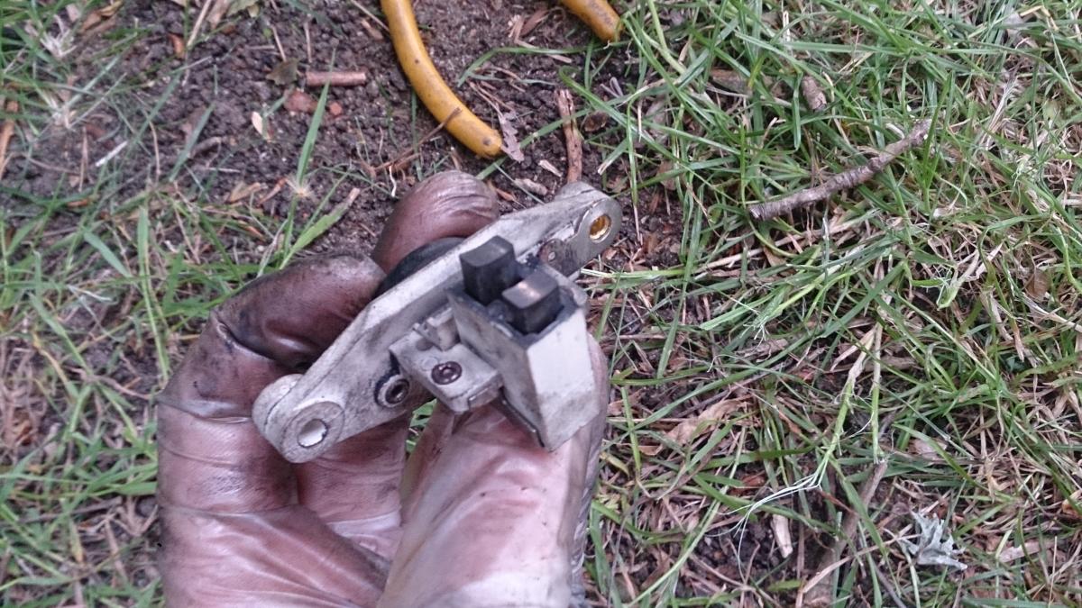

...where might be the best place to pick up a Bosch voltage regulator for an alternator? The brushes are worn on the one on the van, and I don't have a soldering iron with me so was thinking of replacing the whole unit. For now I'm hoping that stretching the spring and cleaning up the slip ring will give me a bit more life.

This is what I have - brushes are removable with soldering. Later Bosch with plastic cover need drilling out IIRC. Good point about buying soldering iron!

If you refit that with just the one screw, on the earth tag end, with it pushed up closer to the commutator, you'll get loads more miles from it, and elongating the holes would be icing on the cake.

Thanks for that guys. I did move the unit over as far as the holes would allow so got an extra mm or so but didn't think of elongating the holes :oops: That said, it is charging now so hopefully will do for a while.
Bit pissed off that a 'brand new' alternator would look like that after less than 21k miles though - ironically changed for reliability!
300 miles later it seems to be ok, so maybe replacement can wait until we get back. Panic over (he says hopefully).
