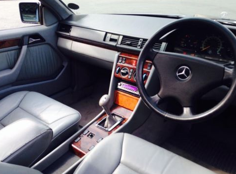

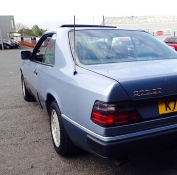

Bit of an oddity my good mate picked up yestady - an oil drinking 124 Coupe. Bit of a footballers wives car back in the early 90s with a pez straight six perhaps, but now with the legendary OM603 purring under the bonnet on free fuel, a silver 'D' stuck on the boot with some bathroom sealant and with almost a quarter century maturing, this is definitely not one for millionaires. It's even got conventional rear springs, so it's simpler than my old clockwork trainset.
Inter-galactic gearing not ideal with an engine which doesn't get into its stride until the needle's between 3 and 4, but the ride is good, I suspect the rear springs are softer than the saloons, which always felt harsh after the Citroen-suspension of the estates (and many coupes). The screen is more raked than other 124s and the roof lower, so should be good for cruising at an easy 110-120 across the Fatherland. Even the roof and seatbelt handers work.
He paid a grand, which I think is quite a bit, but most things are working and overall it's straight and tidy with no rot. The new cheap rubber is a ballache, plus it would do well with a new set of Bilsteins, but I think he's chuffed enough to keep it.

I'd roll in that. Manuel Que? box only downside. A grand?? mustn't grumble
I didn't clock the hand shift.....Blimey I think I have only seen one manual W124 and didn't think any of the coupes were hand jobs.
Me neither, mercrocker. It's quite Ilkley the manual box was hefted in along with the engine when it was swapped. To my mind, it needs tan leather (or MB tex - grey leather rarely works) from an 80s 124 (better quality back then, like the rest of the car) and hand-wound windows - one has already stopped working, 124-style. About £15 for a new part, I think.
A ZF 4 speed box would be good - no Merc is complete without, unless it's a workhorse 2.5TD. The car would then make even more sense. It does have a bit of a personality-crisis atm, with the box, clutch and heavy flywheel effect, which just goes to emphasise that it's fuelled by oil. It can be less refined than a DMU leaving Leeds station, through the lower gears. The autos can make them appear as smooth as an Otto-wotto.

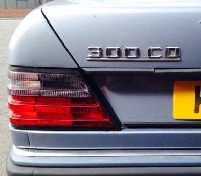

A wee update on this £1000 shite. It has gone wrong, that's the bad news. One in a very nasty way - matey ignored advice - and the next time in a good way, since it rust-proofed the rear half of the car.
Squeaky balljoint syndrome set in after about 6000 miles, only for the wheel to take on a very unusual camber on a roundabout one afternoon. I'd told him to leave it with me! After another 8000, the oil pressure sender sprung a considerable leak, which I blamed on matey's lack of mechanical sympathy and revving 7 litres of cold oil too high on cold starts.
The car's now losing no oil and the rest of it's due for more complete anti-corrosion activity before the winter sets in - I think he's covered the best part of 20,000 miles at well over 40mpg on his vegoil and often over 80mph. A little corrosion has taken place behind some osf wing filler in the usual place and the sunroof has suggested it's best not to play hide and seek with the sky, but other than that it's better than most modern crap. 130mph has been witnessed, according to twatnav. It drives really well, and is as simple as pie. No computers, no bollox. Even the hydraulic rear headrests work! His parent's Insignia was brand new a year ago and hasn't the same reliability, economy, comfort or satisfaction record.
