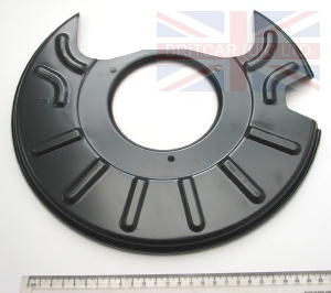

This is a disc shield: not essential for brake operation or for MOT BUT if rotten or loose would be a fail. No fail if not fitted.
This is a brake backplate: essential for MOT because it carries brake parts.
This is my interpretation. Any ideas? Have I been lucky with the MOT tester and cars without the tin thing?

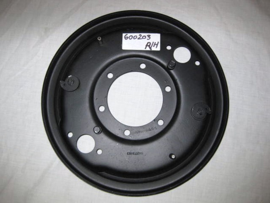

This is it the plate it's not just a plain pressing.
V%20V%20T%20I%20Metal%20Back%20Plate%20O
Aye - combined shit shield and backing plate....niiice. Notâ„¢
Dunno, essential bits.
Not met one of those combined doo-dahs before. Is it one of those arrangements with the little drum brake handbrake?
