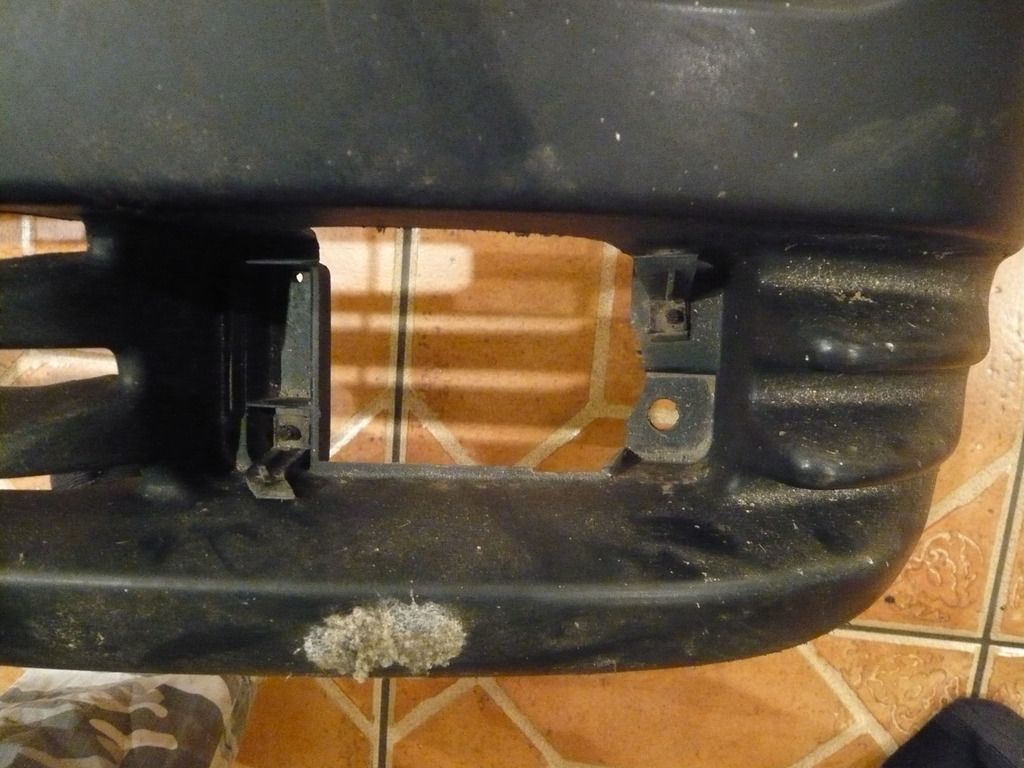

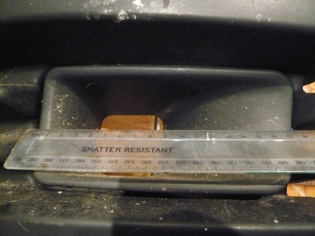

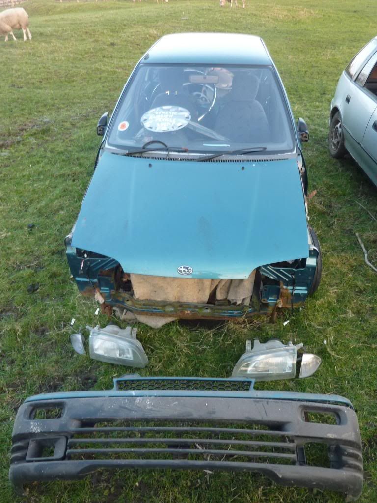

ruffgeezer Posted February 14, 2015 Posted February 14, 2015 Hey Joe, have you got a pair of front bumper vents going spare from your brace of crap baskets? I could do with someone who can measure them for me before I commit to a pair.

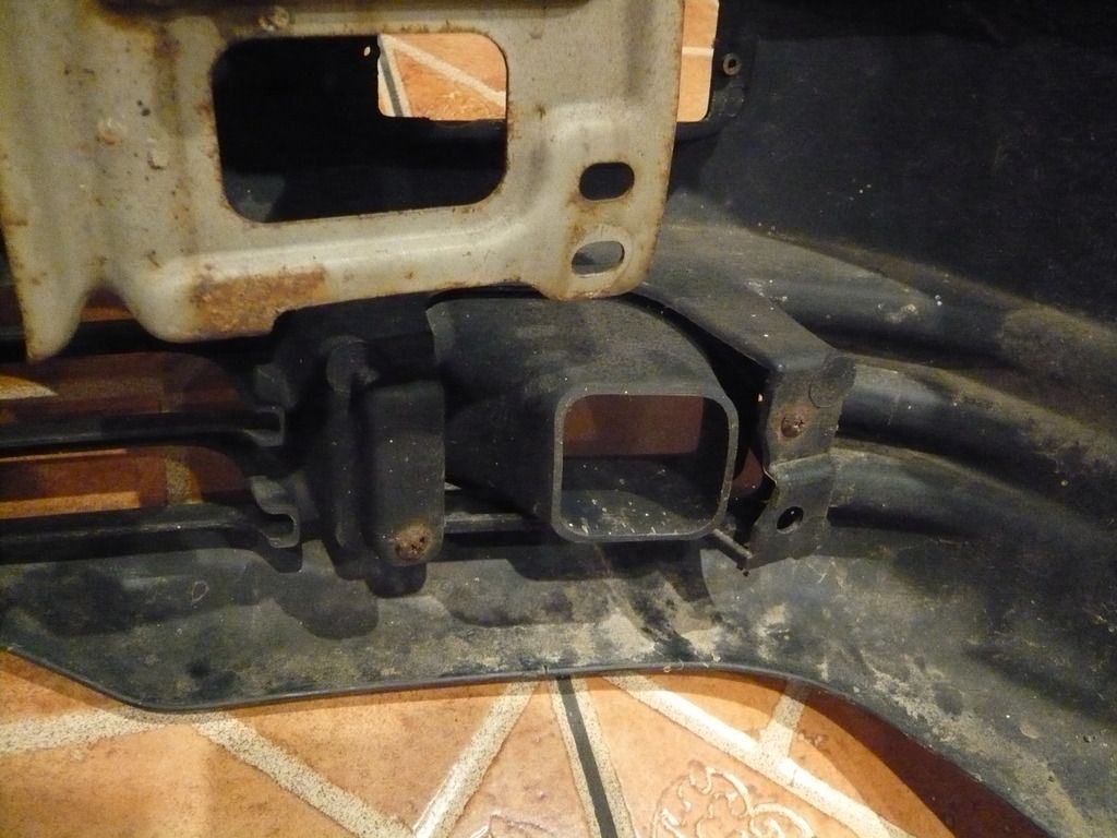

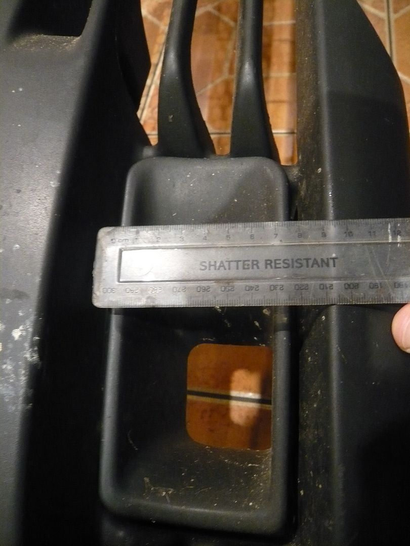

KruJoe Posted February 14, 2015 Author Posted February 14, 2015 Thanks for the bump Tim! I plan to dig this POS out from the back of the shed to resume activities this weekend. The prettier, earlier front end from the green one will be going on the silver car. I think I have the pair of vents, though one is off in that picture, I have no spare ones I'm afraid, and there was nothing mounted in the holes in the silver bumper, so I don't know if they'd be the same. Edit for measurements: 17cm long. 7.5cm wide. The vents look like they're not 'handed' but they are. And the two mounting points are staggered, not an even depth. Hope that helps. Yes, I brought it into the kitchen to photograph
ruffgeezer Posted February 14, 2015 Posted February 14, 2015 Welcome, I have a fresh bumper for the ax but no fogs in it, I'm sure there is a type of Swift vent that fits.

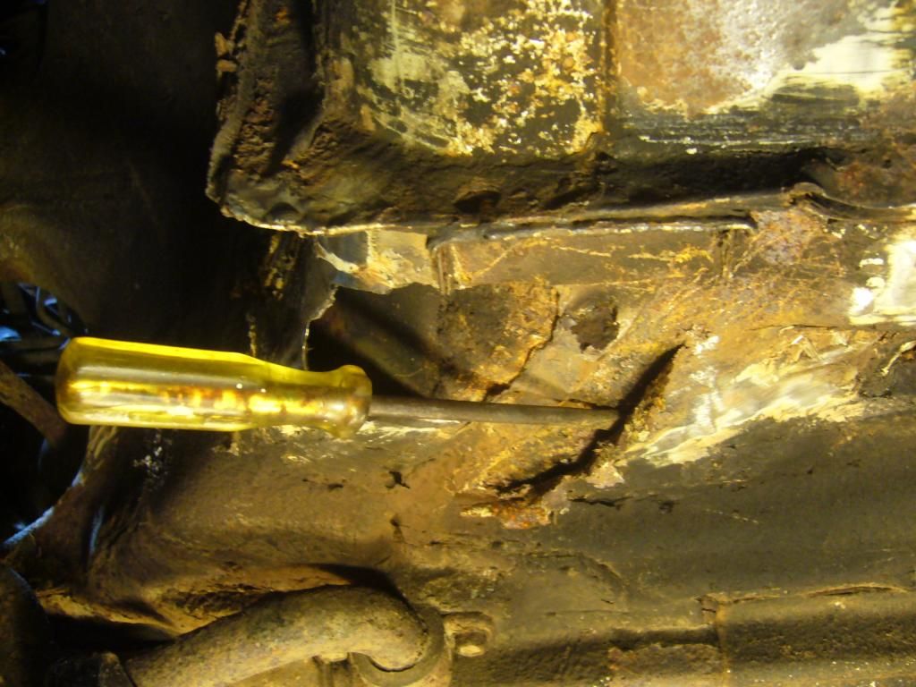

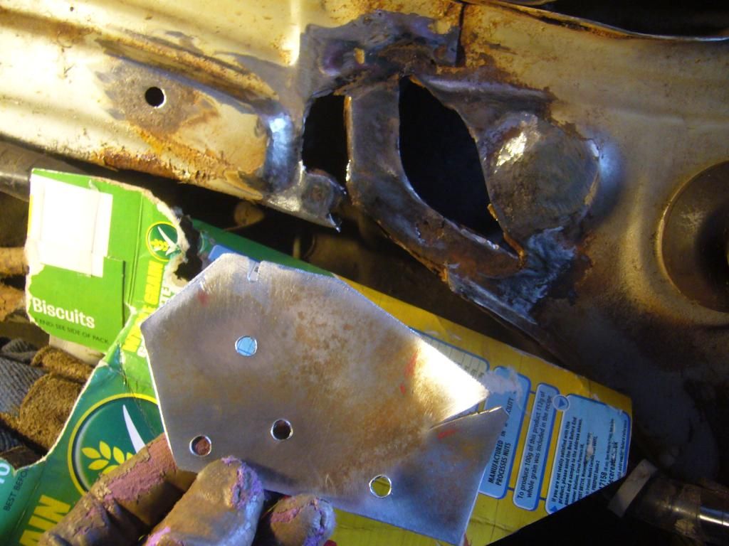

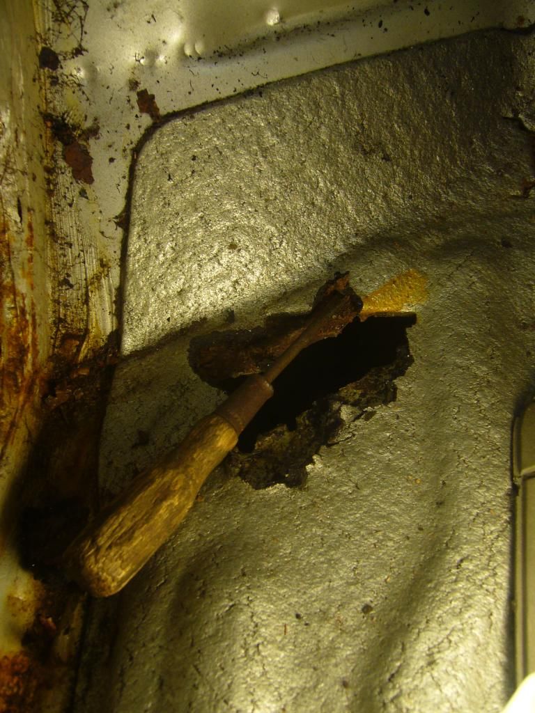

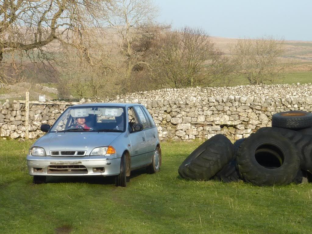

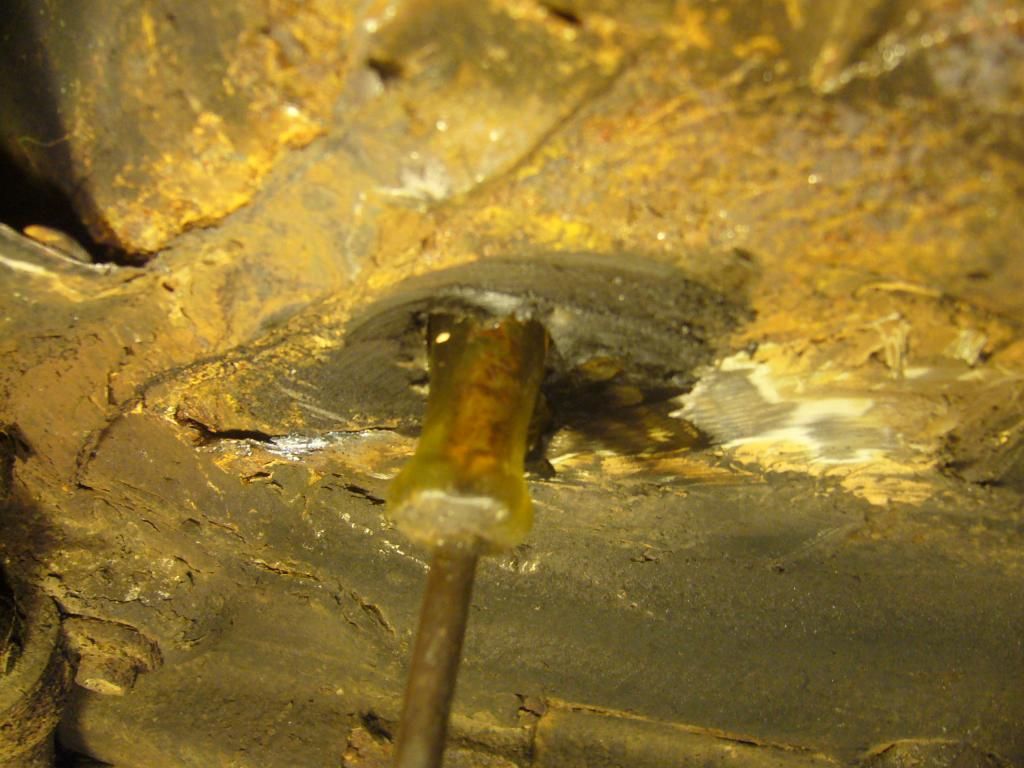

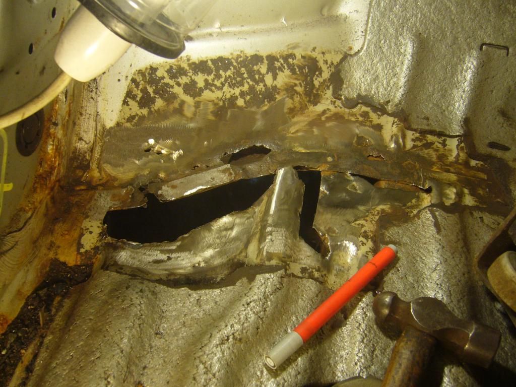

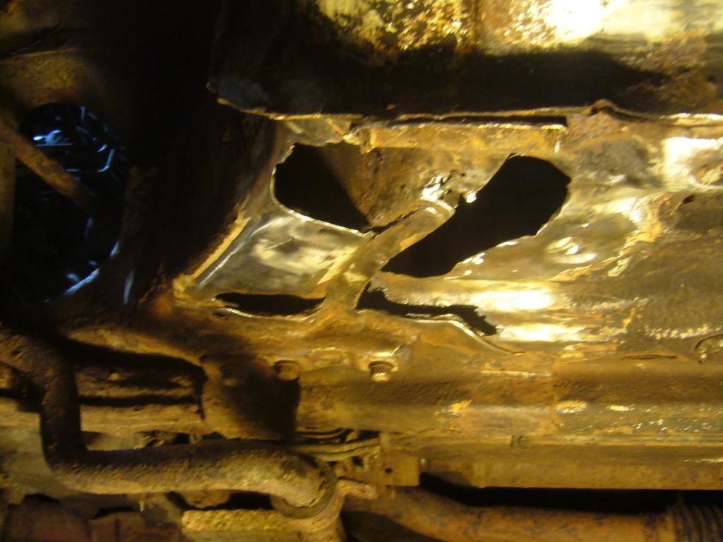

KruJoe Posted April 18, 2015 Author Posted April 18, 2015 Apologies for lack of updates folks, but progress has been made.As you may have read in this strange thread...http://autoshite.com/topic/20160-suzuki-swift-1989ishhelp/ Jings. How much time did the Justy spend in its Inverness registration area? The roads are very heavily salted up here.Is the silver one going to see the road again?The green bogie I bought in about 2008, it had been a kid's plaything on a farm atop a hill in bleakest North Yorkshire. It came with Reekie Forres (IV36) number plates. Shame I couldn't save it, it was too far gone even then.The silver wreck was also a field car, as you've seen in the thread. It WILL be on the road soon, though I've neglected the updates recently. As of this week, welding was completed (hopefully). Yes, it has been somewhat of a mission. I won't bore you with step by step, patch by patch, but has been had rather more than the Samara had during it's first weldathon. (That is currently in the middle of its third!) However, this example is fairly typical of how it's been going. The NSF corner of the floor. How it starts... not looking too bad: A bit of a scrub with the flapper left nothing but sound-deadening: Inside: Bollocks. All cleaned back: And then...Some nice-ish patchesStitched both sides where possible.Will's new welder has been a joy, once I've got my metal clean, and lighting right for me to see what's occurring.I haven't got a pic of this part at the next stage, but here's the OSR sill end patched up, painted with my phosphoric acid, and left to dry.After that, it's plenty of zinc primer and underseal.As I said, I've hopefully finished all the welding this week. There's still loads of tidying up, and re-assembly, but there's light at the end of the tunnel now. Bucketeer, Conrad D. Conelrad and Lacquer Peel 3

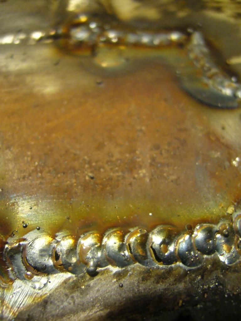

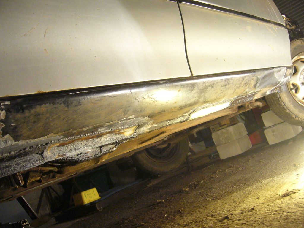

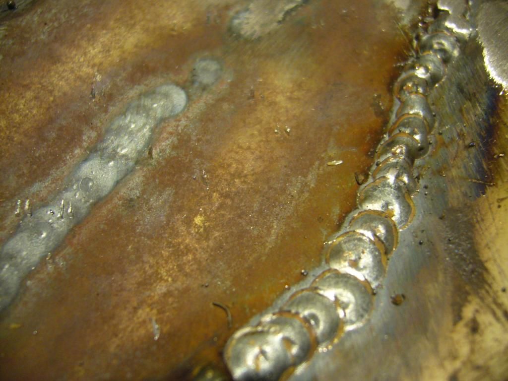

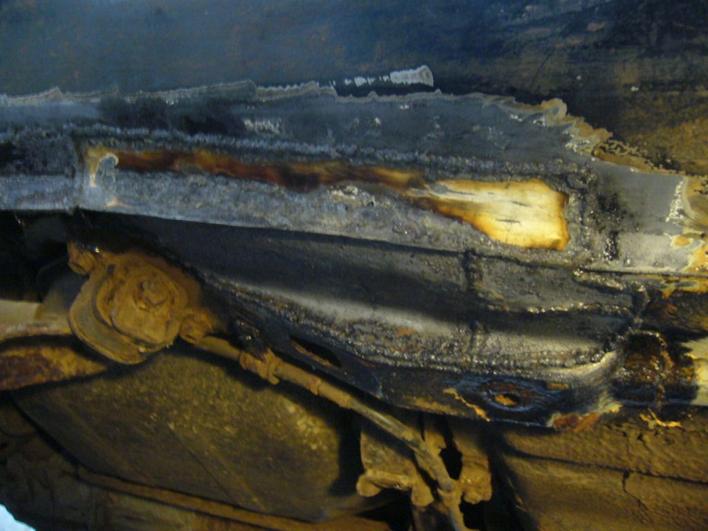

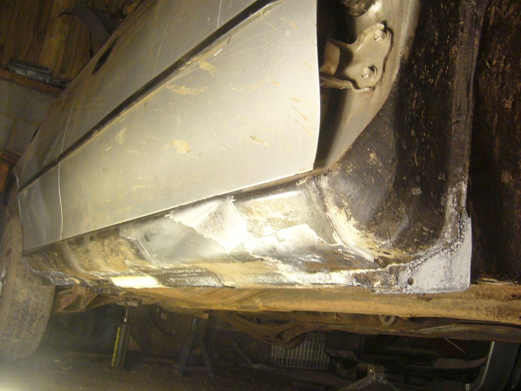

KruJoe Posted April 19, 2015 Author Posted April 19, 2015 I'll have a look tomorrow for those bits Matt. Mine are five doors, but I think the door parts you need may be the same. About airbags, yes, both Justys have airbags, but the earlier one seems to be a self-contained unit, so you could maybe fit one of them (no wires to a remote trigger). Dunno about the horn switch/wire system. There are several options there. I think yours is a later one so will have the post-face-lift dash in it. Can you please photograph the switch you need, then I can match it? Ta. This is definitely making me think my suzuki isn't that bad after all. Shame my welding shit (well for now) To be fair Shrimpy, this silver one had about the same rot in this area as you've shown there. This is the OS sill, after welding and acid. It has been patched about 80% of it's length. I've had to reconstruct the front corner of that seam too. Have you had the wings off yours? Maybe best not go looking for trouble, but the chassis rails above the wheel (normally hidden) are notorious. You're doing alright by the looks of things in your pics. If you post some close-up pics of your welds, some of the more experienced welders may be able to give you some pointers.The only thing I can say from what I see there is that maybe you'd get cleaner welds if you used the flapper or ground back a bit further to clean the metal on the car.I'm glad to see yours being saved, anyway.

AlabamaShrimp Posted April 20, 2015 Posted April 20, 2015 No the wings haven't come off mine and they aren't going to either! Tbh small bits of my welding look okish but a lot looks crap as my actual welding machine is utter wank
