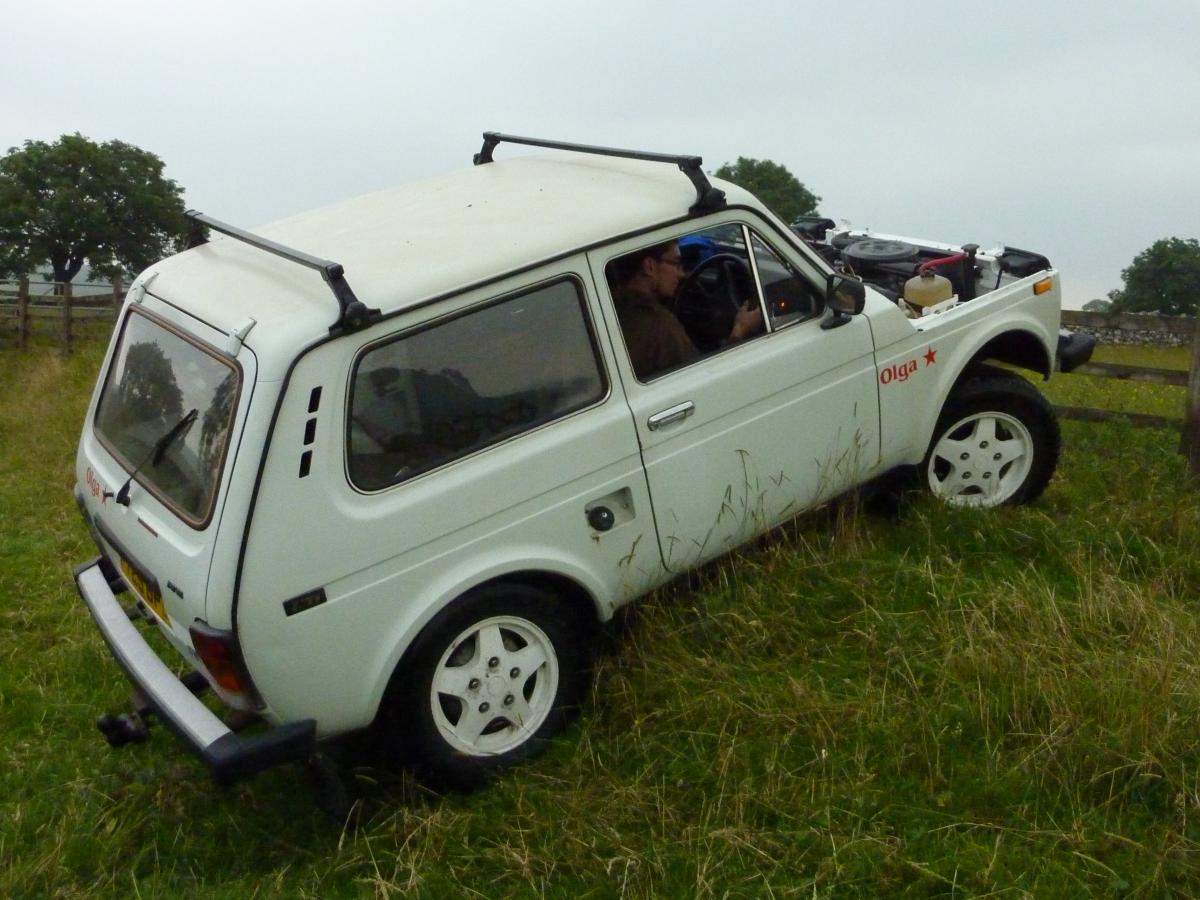

If anyone fancies an Autoshite laning trip in mid-Wales, I'd be happy to organise one. Only if someone brings a Lada Niva though. You don't need fancy kit for the lanes I tend to tackle, but remember this is beautiful Wales, not a Pay and Play site - speed will be limited.
I'm sure wor kid Will should be right up for that if he ever gets a couple full days off together. He has promised that getting Olga running again is top priority once Edd's MG-ZR-OMG-HGF-BBQ is sorted.
Might it not be better getting Ian up to Yorkshire for a bit of laning then...? I'd be up for that.
That could work too! Would be nice to do some Laning elsewhere. Just thought I'd offer a trip around the excellent lanes we have here.
