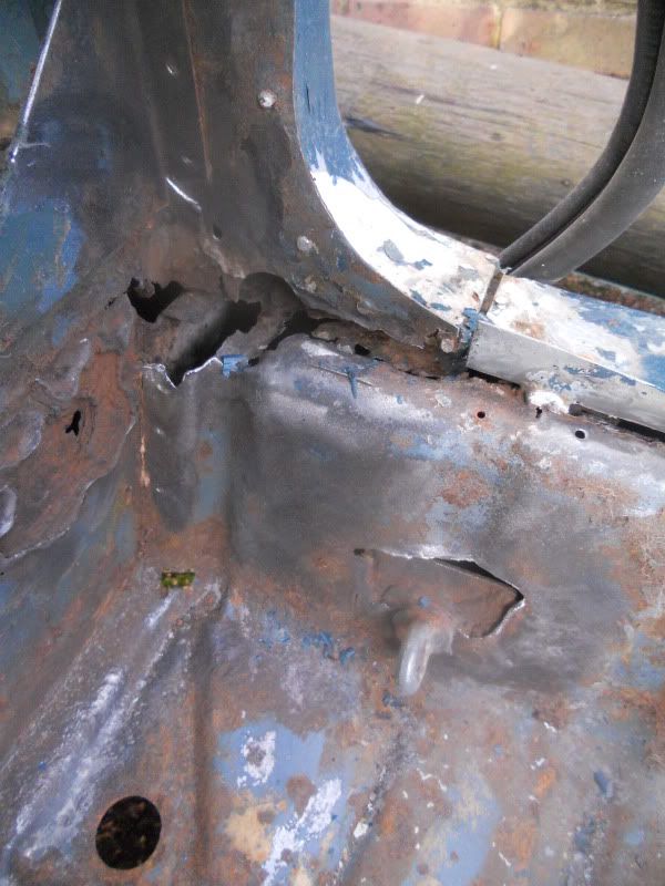

This year I would like to make a start on my Herald and I have been swatting up on welding etc, I am armed with a mig and angle grinder a pair of shears & ive watched all the welding projects on this fine site and read all about owners restos in Practical motorist but no one seems to go into detail on how or what is used to remove the rot, my plan is to go down to the chassis and then repair the body sections one at a time and then rebuild, I don't have oodles of cash so a compressor and air tools will be out of the question. Any suggestions and tips for what you can see below. Thank you.
I have a replacement wheel arch and I know the ribbed panel over the axle is available in segments to fix this bit of rot
How about the bonnet wings? I think I may be better drilling out the spot welds and then plug welding the new wings and 'D' panel.
and how do I make a long cut as in the door bottom repair section, I thought of a dremel cutting disc but would not have believed one would be strong enough for the job.
As I say the chassis will have to be first. so I have time to get the tools needed as I presume the angle grinder, cutting disks and a wire cup is all thats needed for that.
being lazy as I have not had a chance to get under the car yet, The chasis bolts spin in the holes, are they in captive nuts inside the chasis (is it box section?) or do they bolt through as I was thinking the nuts sticking out the bottom of the chassis would do some damage to someone if they were run over, not that being run over won't!!

How rusty is your chassis? I wouldn't be thinking about removing the tub unless it was absolutely necessary. It's possible to replace the outriggers without taking the body off. IIRC the bolts are not in captive nuts as such although I haven't really investigated how the rear section is mounted. I'm not sure how clear it is in this photo but the front section has 'captive bolts' in a bit of box section that go through the chassis and are secured with regular nuts underneath. Visible on the left of this pic, sort of:
The rear arch section is gonna be a bugger even with a repair section (lucky bastard) as it's quite a complex double-skinned jobby, assuming like mine the rot has got through to the floorpan section as well. It's all MOT'able too as it's so close to the seatbelt mounting point. Again it's not mega clear here but you can just see the rear outrigger through the hole there
On the plus side your front floors & a-pillars look sound as a pound, which is unusual. Have you checked behind the heater box :wink:
