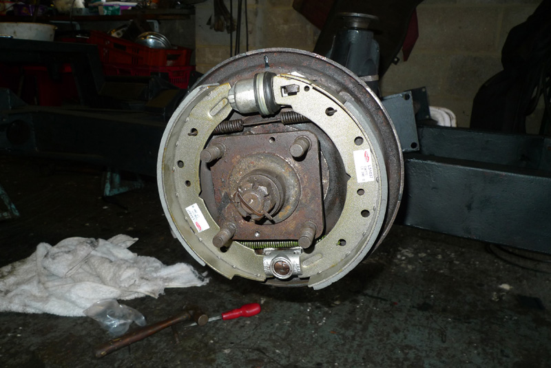

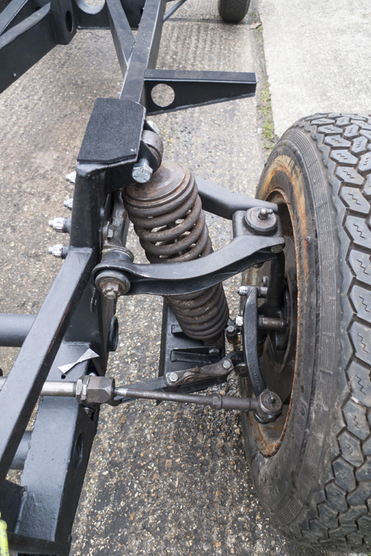

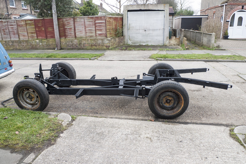

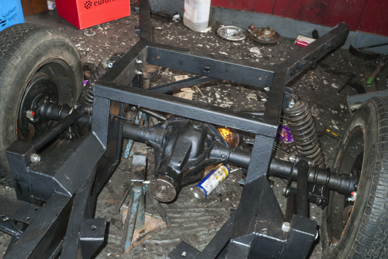

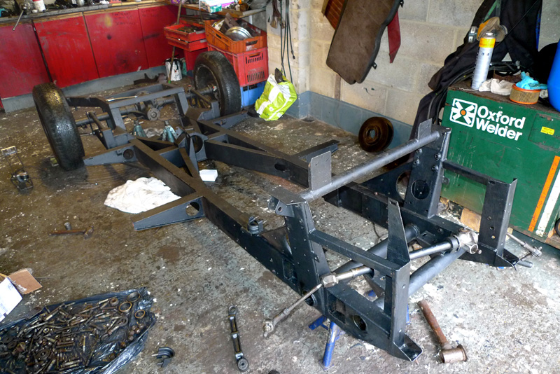

Friday was spent building up suspension components, The Rear Axle was built up with new genuine Girling cyinders, New Shoes and adjusters.
The rear axle was then refitted fitted with new metastatic bushes bought from QRG.

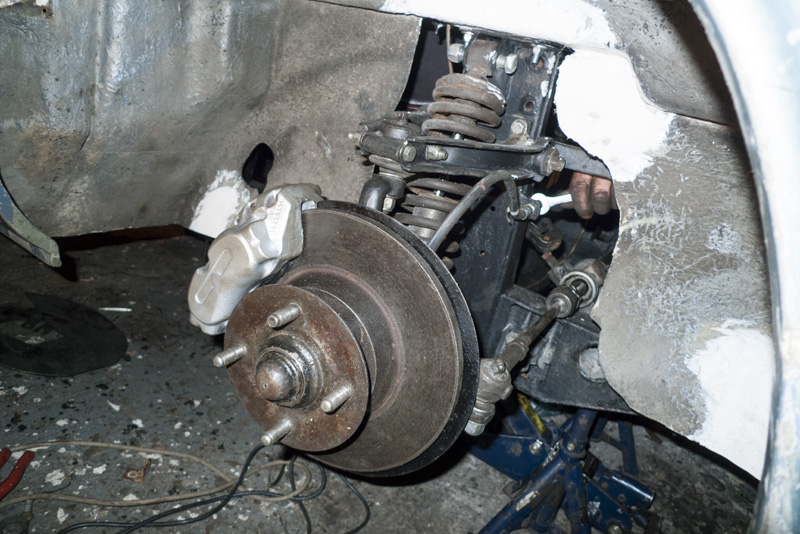

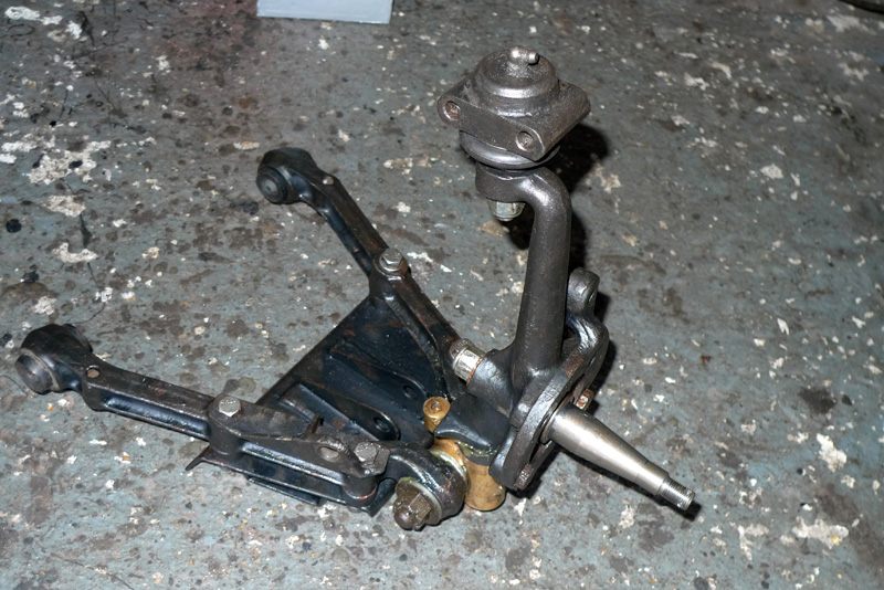

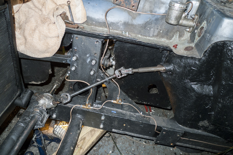

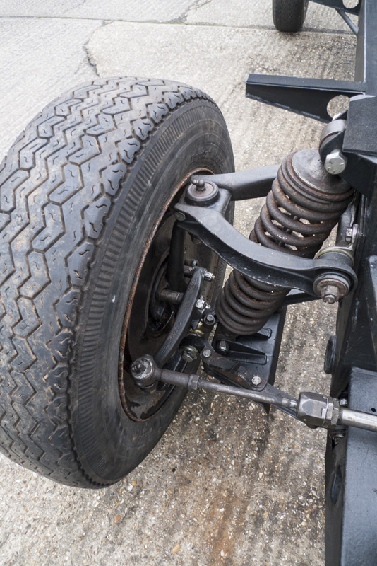

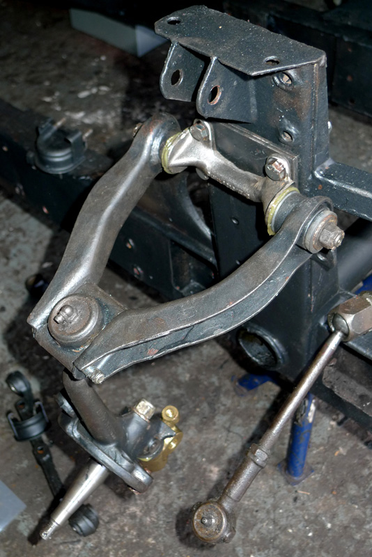

The Refurbished 5a front suspension was resembled ready for refitting. With new components where needed: Lower shock mount plates Stub axles, ball joints, a trunnion, and all bushes and seals were replaced.
The new front suspension setup was to use 5a hubs, vertical links, stubs, and lower wishbones while the steering arms, and upper wishbones were kept as standard coupé parts.

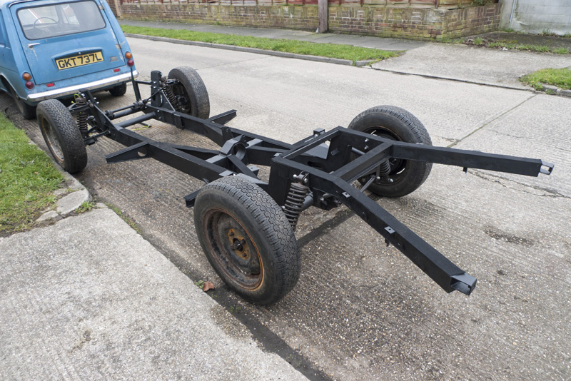

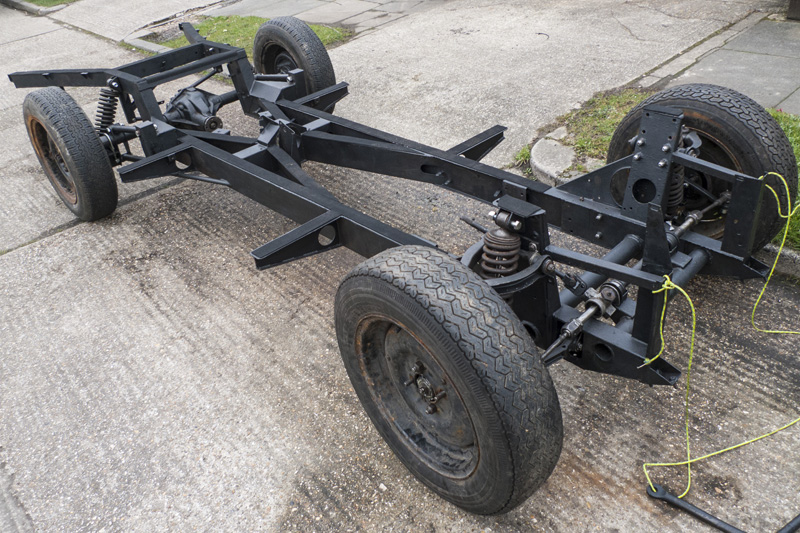

The following day saw the additional help from my friend Marlon. Cheers! The chassis/suspension build up continued and revealed that the outer bearings did not fit the stub axles, some checking in the manual revealed that the late 5a hubs i had did not fit the 5/early 5a hubs and bearings. A lot of time was wasted attempting to find somewhere local that would supply new bearings of the right size to fit. In the end the decision was taken to temporarily fit the hubs with an assortment of old bearings to allow the reunion of body and chassis to take place...
Refitting the Hubs has highlighted the need for wheel spacers on the front wheels to make up for 1/2inch of difference in the hubs either side. precise measurements will be made once I've sorted the hub/stub issue. I'll fit longer stubs if needed. Setup of the shims will be left until the engine and gearbox is in and things are sitting at a more normal height.
With the front end temporarily assembled and New chassis foam the chassis was ready to roll. This was handy as it needed to be pushed a mile to the garage where the body was stored...

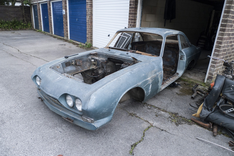

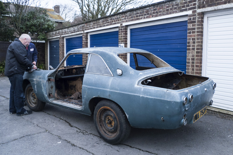

The body was retrieved from the lock up garage where it had been stored since October.
Marlon contemplating the chassis...!
With the help of friends and family the body and chassis were reunited.
and finally the body and chassis were then pushed back home where the car can at least be worked on in one piece.

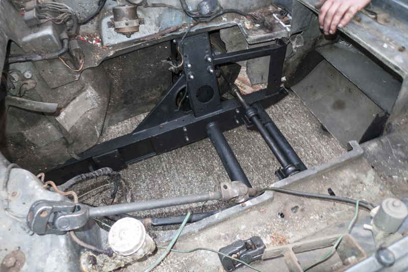

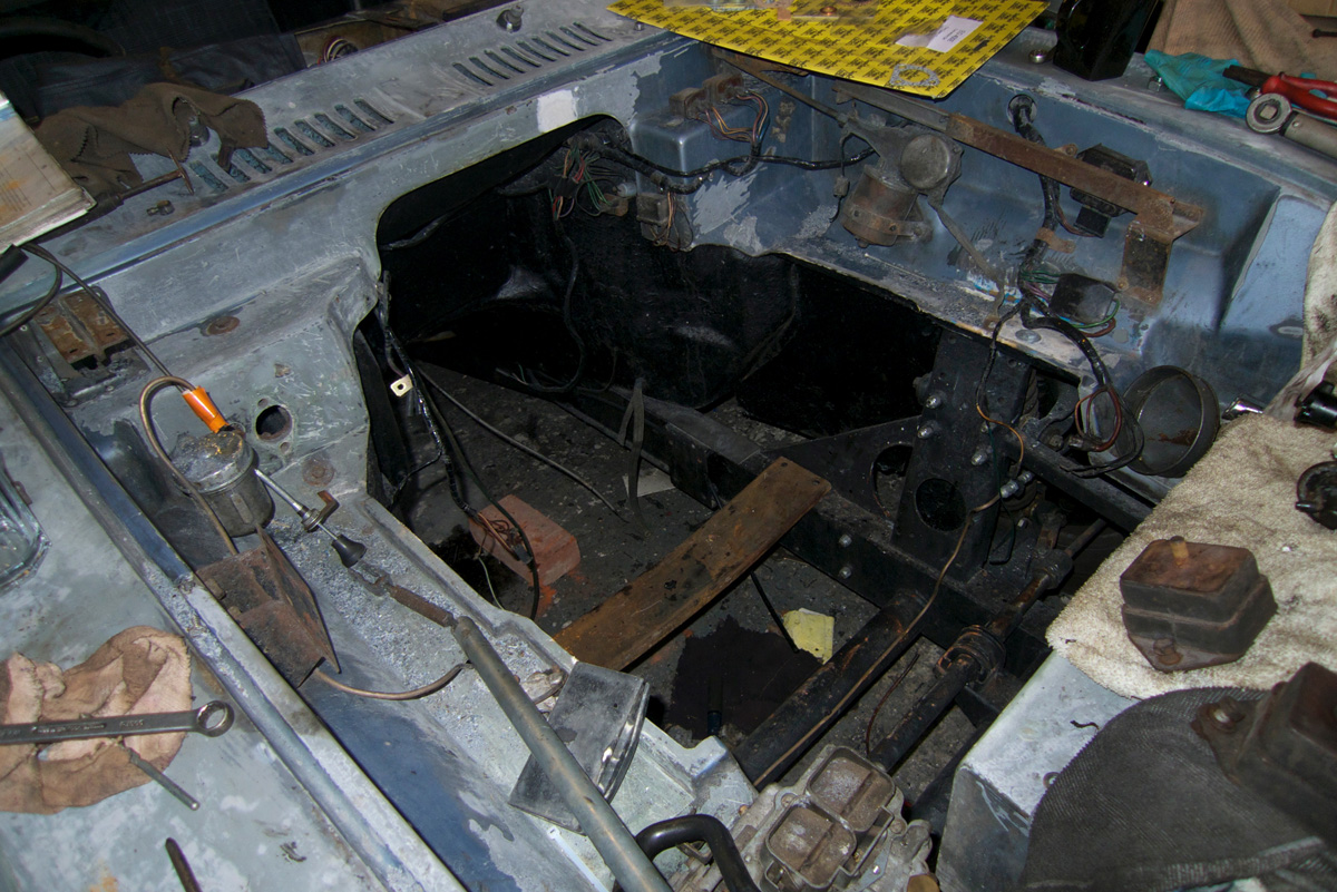

Engine bay:
The priority is to sort the suspension hub / stub situation out, I also have new front spax shocks to fit rears and springs still need to be sourced.
The next stage will be fiberglass repairs, these are fortunately much less than first thought. The a posts and sills are actually in reasonable condition and will only require minor attention rather than actual replacement. The front footwells need repair where they have been botched in the past. As does the the fiberglass around the steering column and nearside front suspension mount. There are also some other smaller repairs.
The plan beyond that will probably be to fit an engine and gearbox and brakes attend to small jobs like steering and electrics. The plan will probably to try for an early MOT before worrying about paint or interior as I want to get the mechanical issues sorted before worrying about the cosmetic.

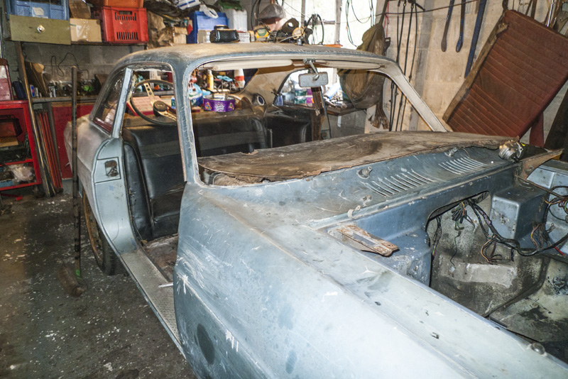

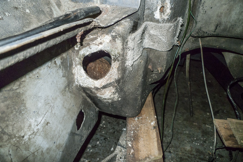

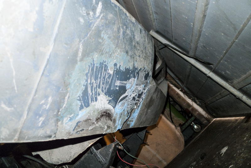

With the body sitting on the chassis we had a decent opportunity to evaluate the body and see what structural work was going to be needed... As it turned out there was quite a bit to do!

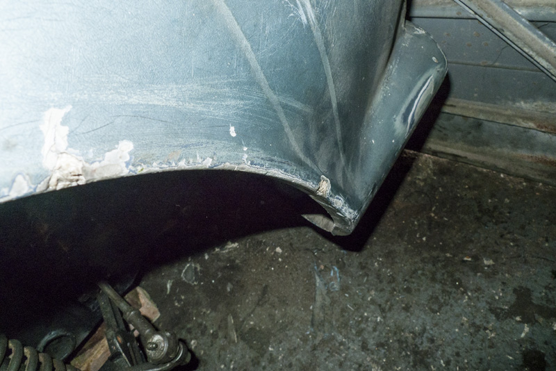

There were many small marks chips and spits as a result of its time in storage to be addressed. There were also a number of previous repairs that once they were poked at quickly snowballed into being much bigger jobs... for example the coupé floor is quite a weak design in comparison to the GTE and required quite a bit of remedial work to get it back into the correct shape.

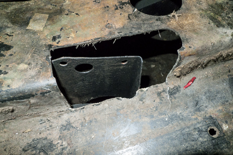

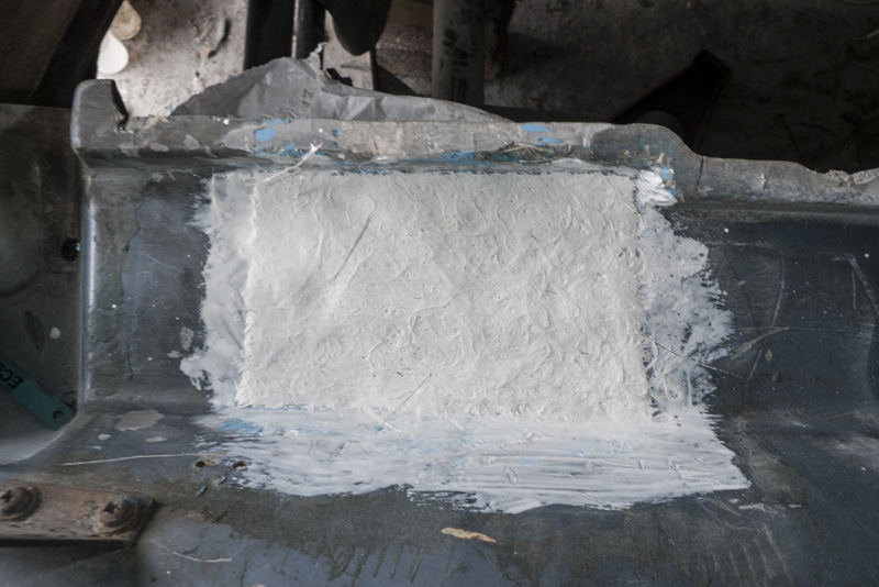

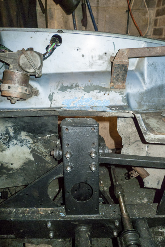

The following photos show the work identifying some of the areas needing work and the subsequent repairs in progress:

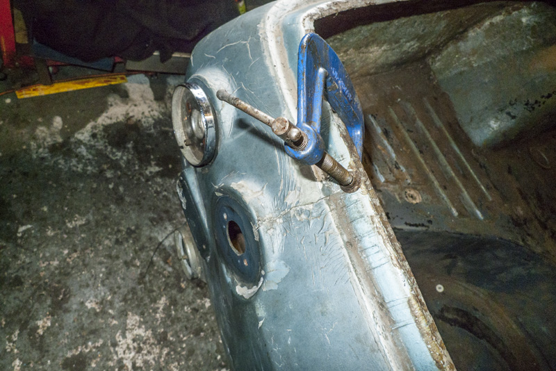

GRP Turret mount had been previously repaired....
But not very well...

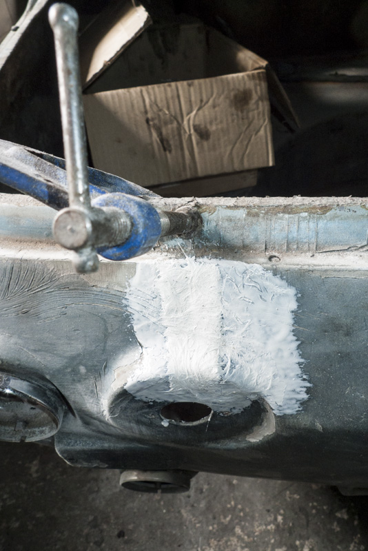

There was very poor penetration in this repair, it was nearly completely dry in the middle and was not bonded to the car in any structural way.
To do a decent repair the front was jacked up, to allow both sides to be cleaned and prepped.

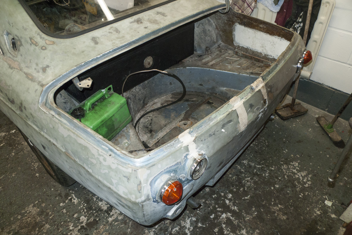

Work in progress on a repair around a rear light:

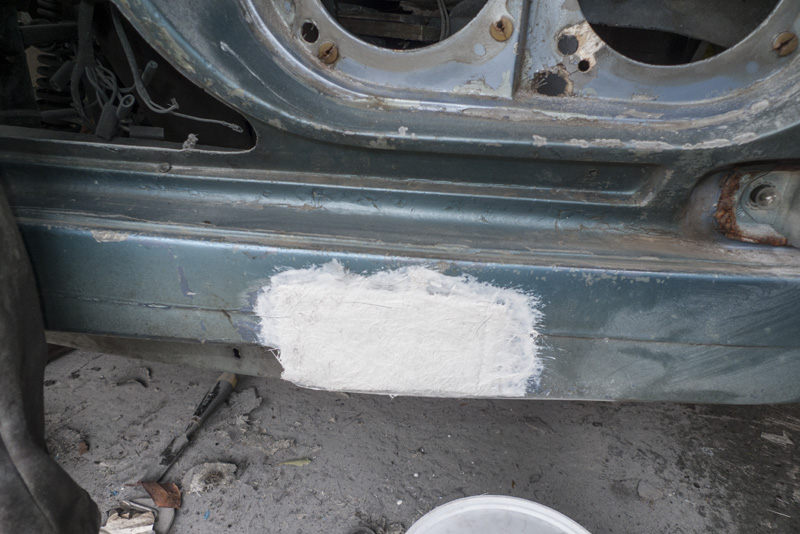

A few other areas that needed attention:

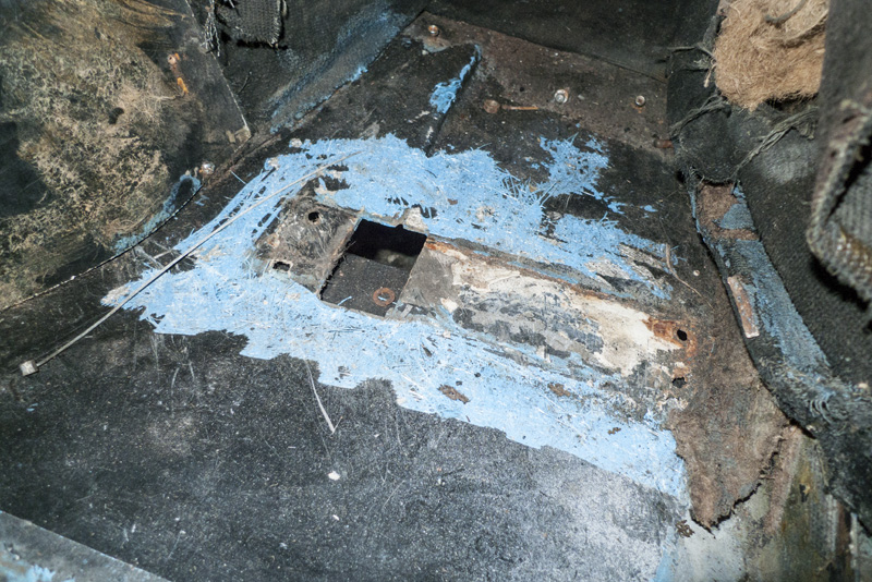

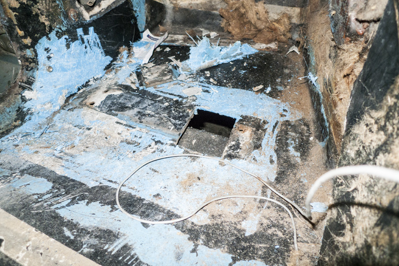

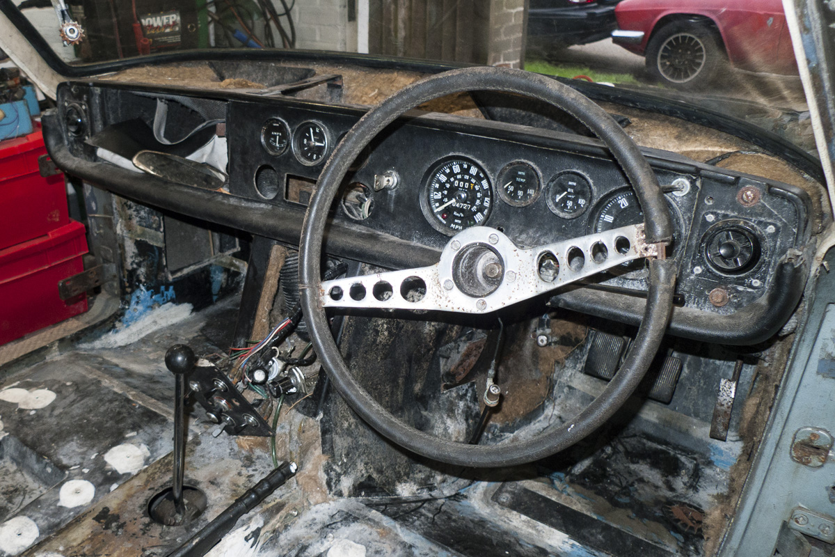

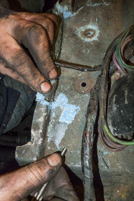

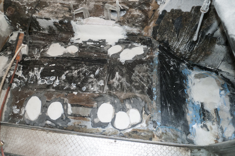

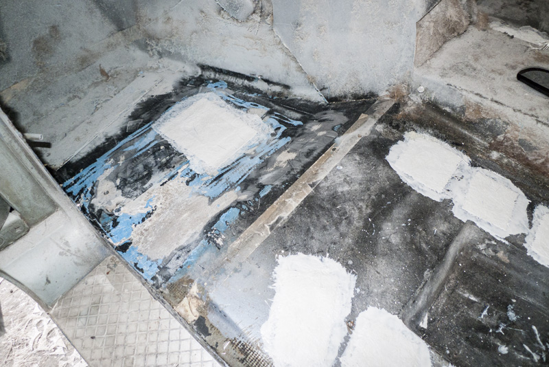

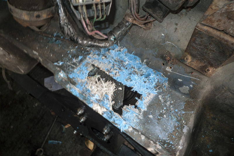

The drivers side footwell has also been patched up with the sh*t blue fibreglass...
An oversize cutout around the handbrake needed repairing.
Passenger footwell

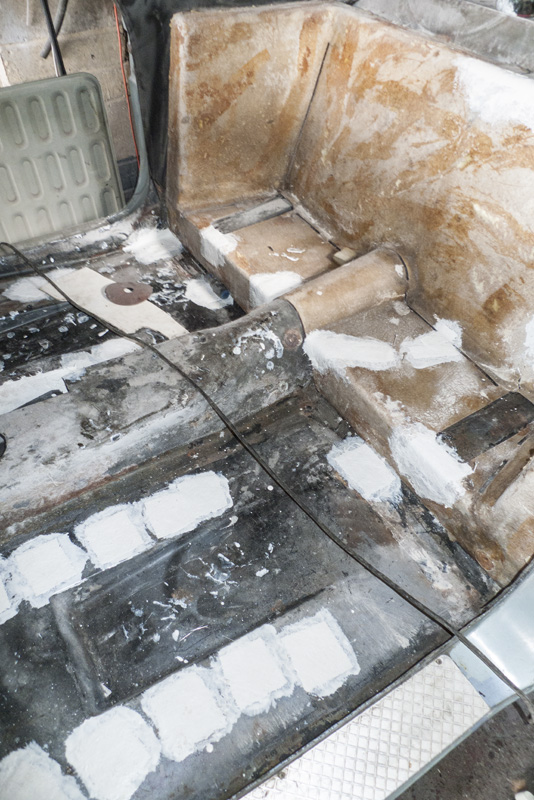

Interior GRP repairs:

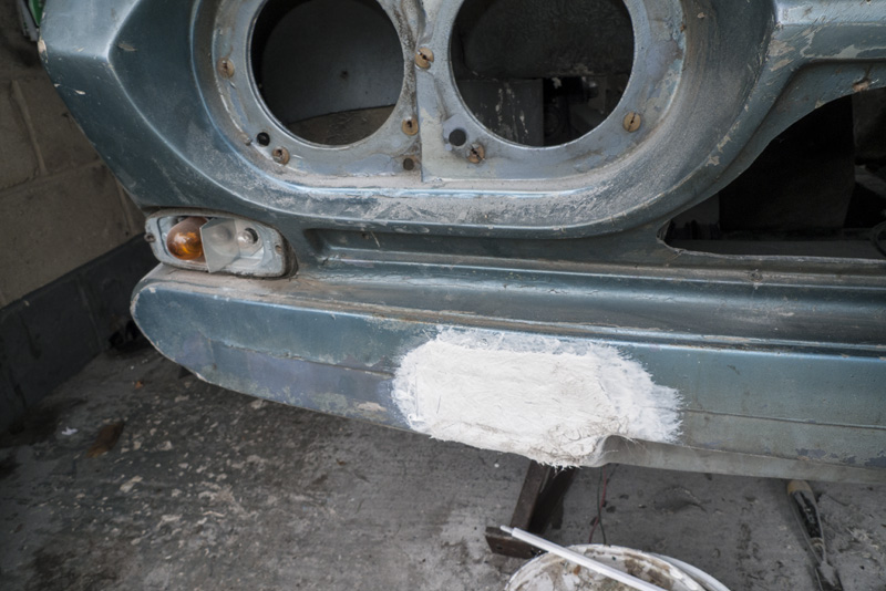

Repairs were also done around the bumper mounts:
A large gash in the boot was found and repaired:
The structural work to the body is now mostly complete, It will be returned to when the prep work is being done for the paint which will not be until after the MOT.

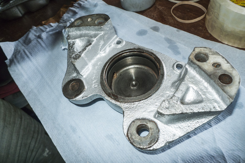

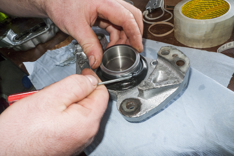

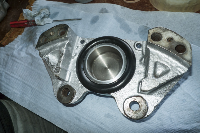

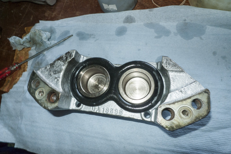

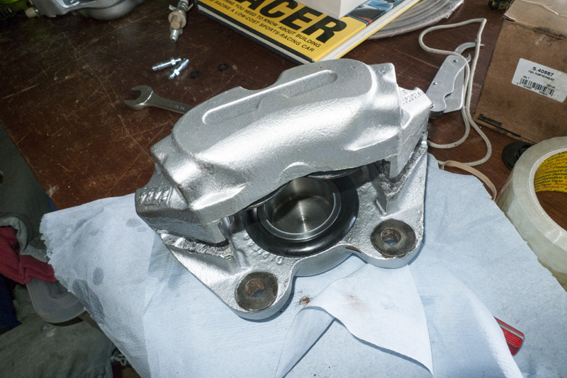

With the bodywork at a stage we turned our attention to getting the brake lines laid and rebuilding the calipers. We decided to rebuild the calipers in house with all new pistons and seals this offers a decent cost saving on sending them away. After Spending hours cleaning and prepping the bodies they were finally painted and ready for rebuilding.

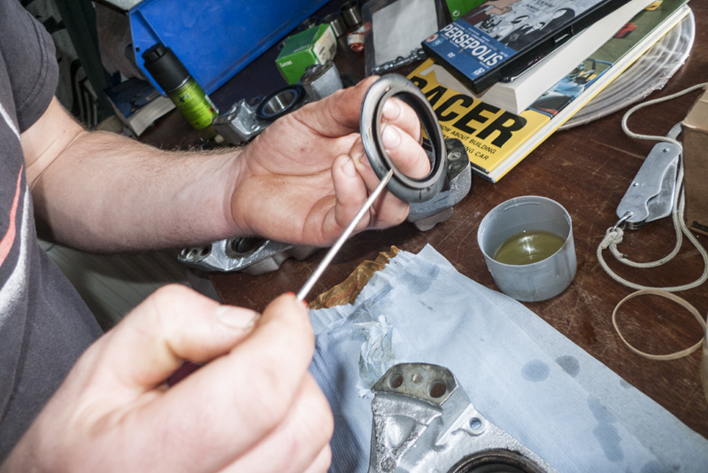

The main seals are fitted first: they go in the second grove from the top and are inserted into the grove by hand having been lubricated by fresh brake fluid.
Next stage is to fit the dust shield, again the fitted edge is lubricated with brake fluid to help insertion.
The lubricated caliper piston can then be inserted.
Single and double pistons ready for joining. Important not to forget the seal which goes between the two caliper halfs.
Finished on the bench,

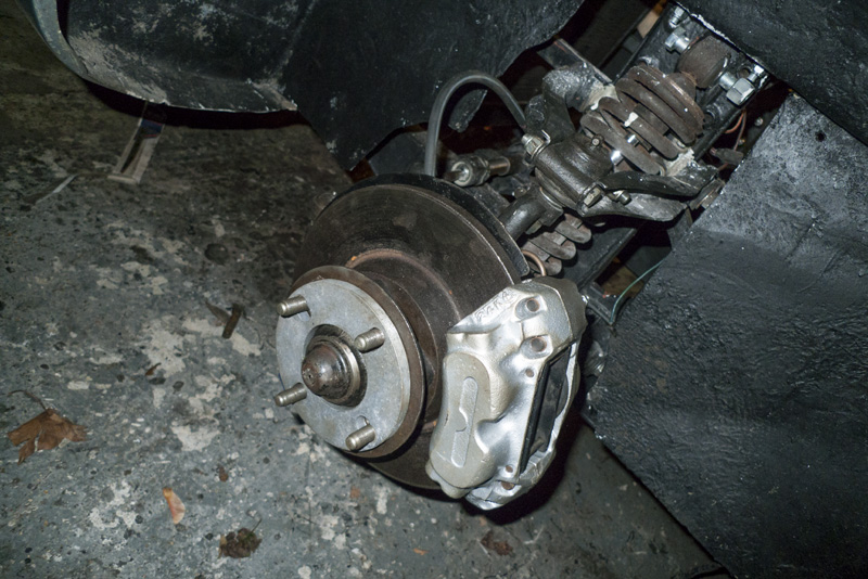

Fitted to the car, also worth noting the correct spacers have now been sourced and the wheels no longer have any clearance problems.
We also refitted the rear loom, fitted new cupro-nickel brake pipes all round and new flexi hoses, the system has been bled and tested though it is obviously without a servo at the moment.
There was quite a bit of messing about to get the dust shields to fit original coupé/daimler dart type were found to be incompatible with the later front suspension. In the end 5a ones were used, though it was necessary to remove the brake pad indicator brackets and use coupé brackets for the flexi hoses.

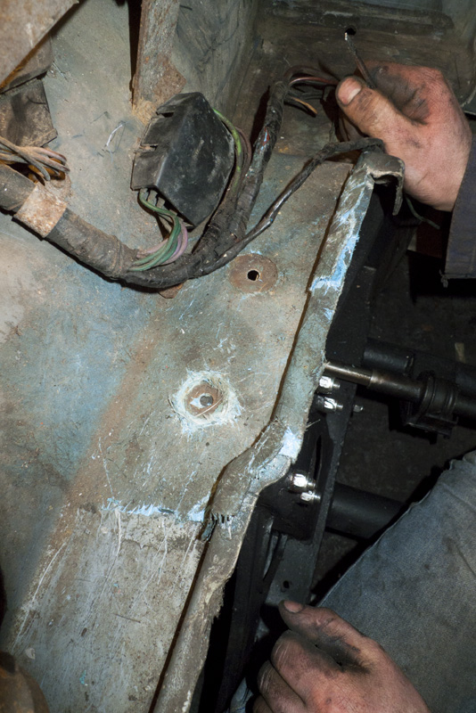

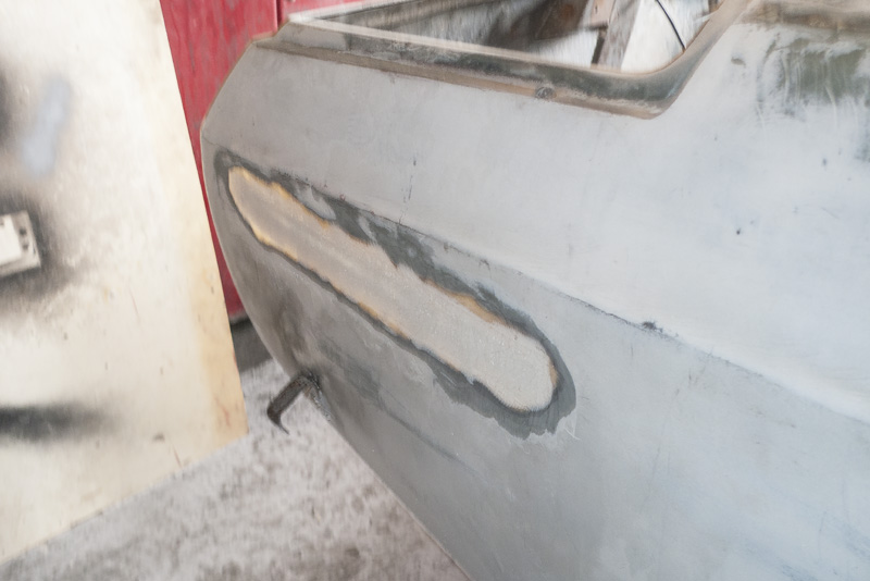

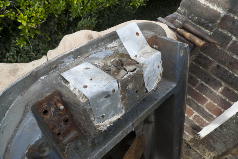

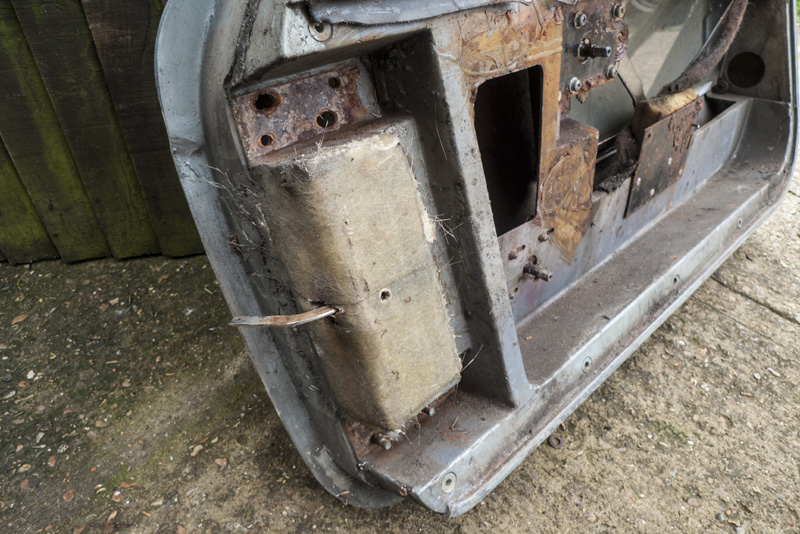

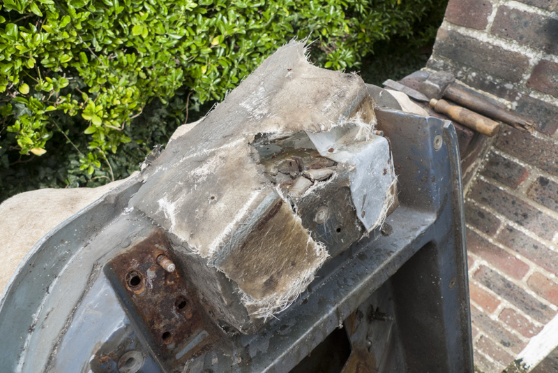

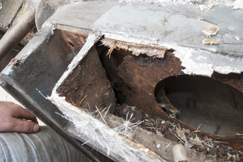

Coupe doors seem to be a bit of a weak area, lots of cars seem to have had problems around the hinges and door stays, The steelwork bonded in at the factory is quite under specced for its task. My doors showed signs of previous repairs but closer inspection revealed just how badly bodged the'd been... (both doors were like this)
Bare CSM hints at a previous repair:
Some work with a chisel reveals a bit of galvanized plated bodged underneath.
Stay plate which has distorted and pulled though, this will be replaced by a modified version which will be galvanized, thicker gauge and of an improved design, introducing a fold along the edge for strength and it will be larger to better spread the load. It won't be Australian coupé spec (http://www.scimitarweb.co.uk/sgwrs/viewtopic.php?f=20&t=10292) but it will be a significant improvement on Relaints own effort.
This photo shows the hinge spreader plate this will also be replaced with a galvanized plate.
This pretty much brings the thread up to date, I'm about to get a lot of new steelwork folded up for the doors, seat runners etc and will soon begin work on the gearbox bushes and seals and will need to pick an engine out of my stockpile!

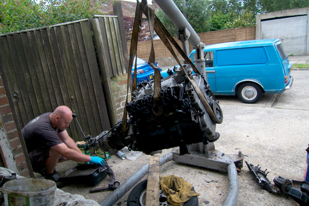

In the meantime here are a few photos of the engine installation from last year which I'd forgotten about!

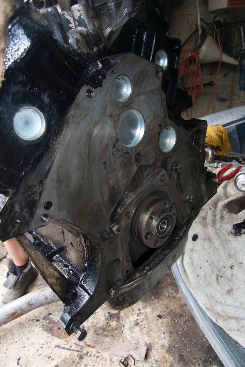

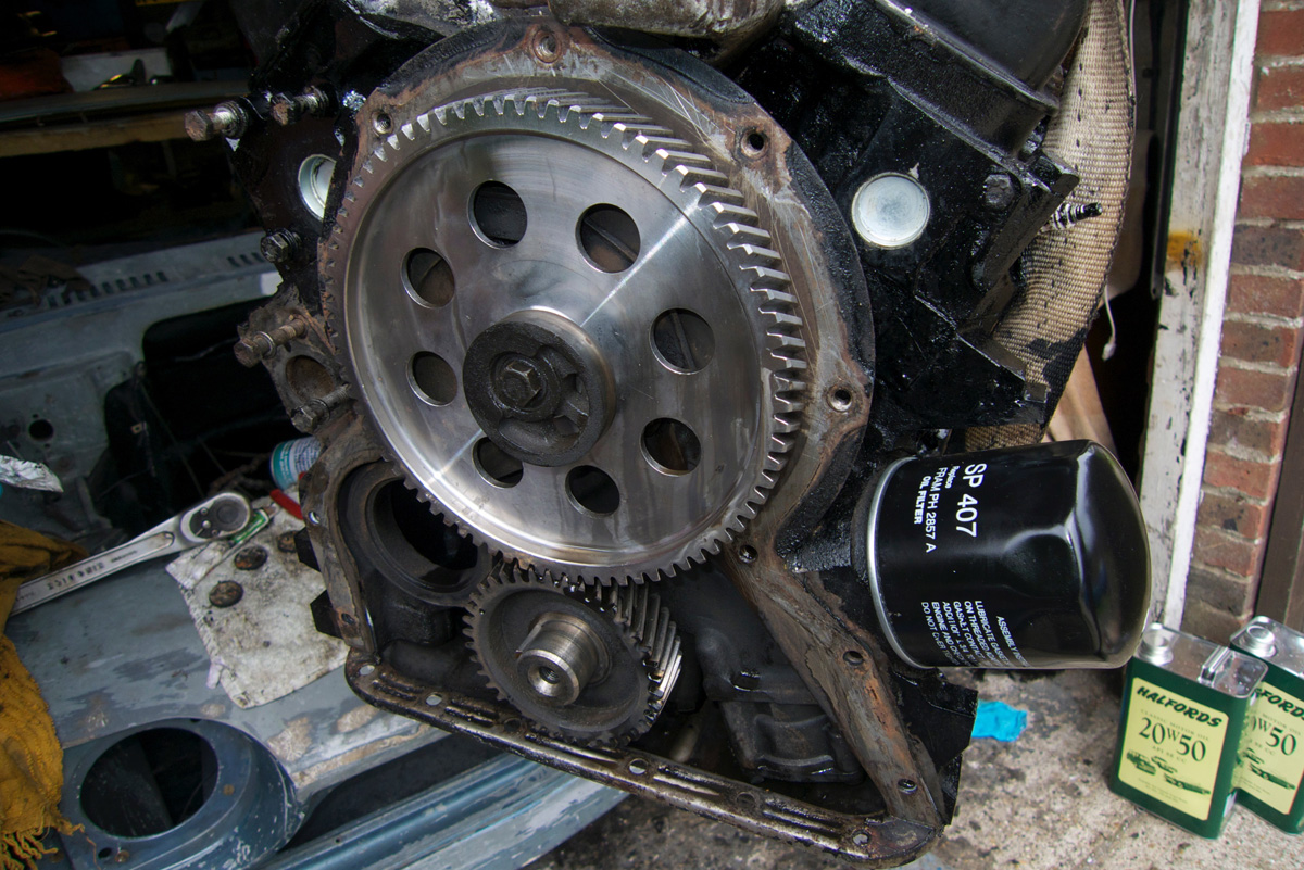

I gave quite a bit cof consideration to refitting a 2.5 Essex to this car but in the end opted to fit a decent used 3.0 engine, The new engine was from a late se5a which I had tried unsuccsessfully to sell on as a restoration project and had in the end broken for spares. I'd had it running in the donor and new it was in good order but it still needed some attention before fitting it to a coupé.
It was fitted with a new steel timing gear:
New Core Plugs, Seals and a coat of paint,

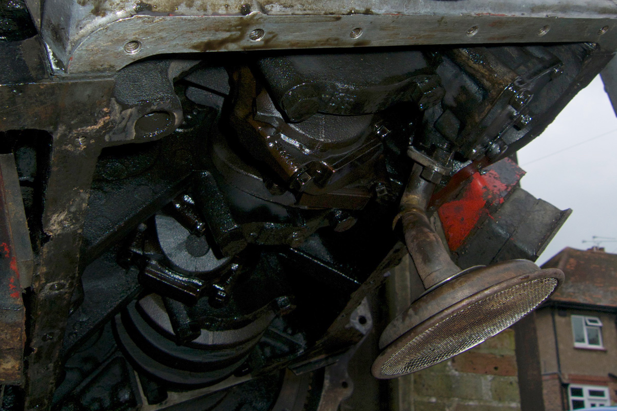

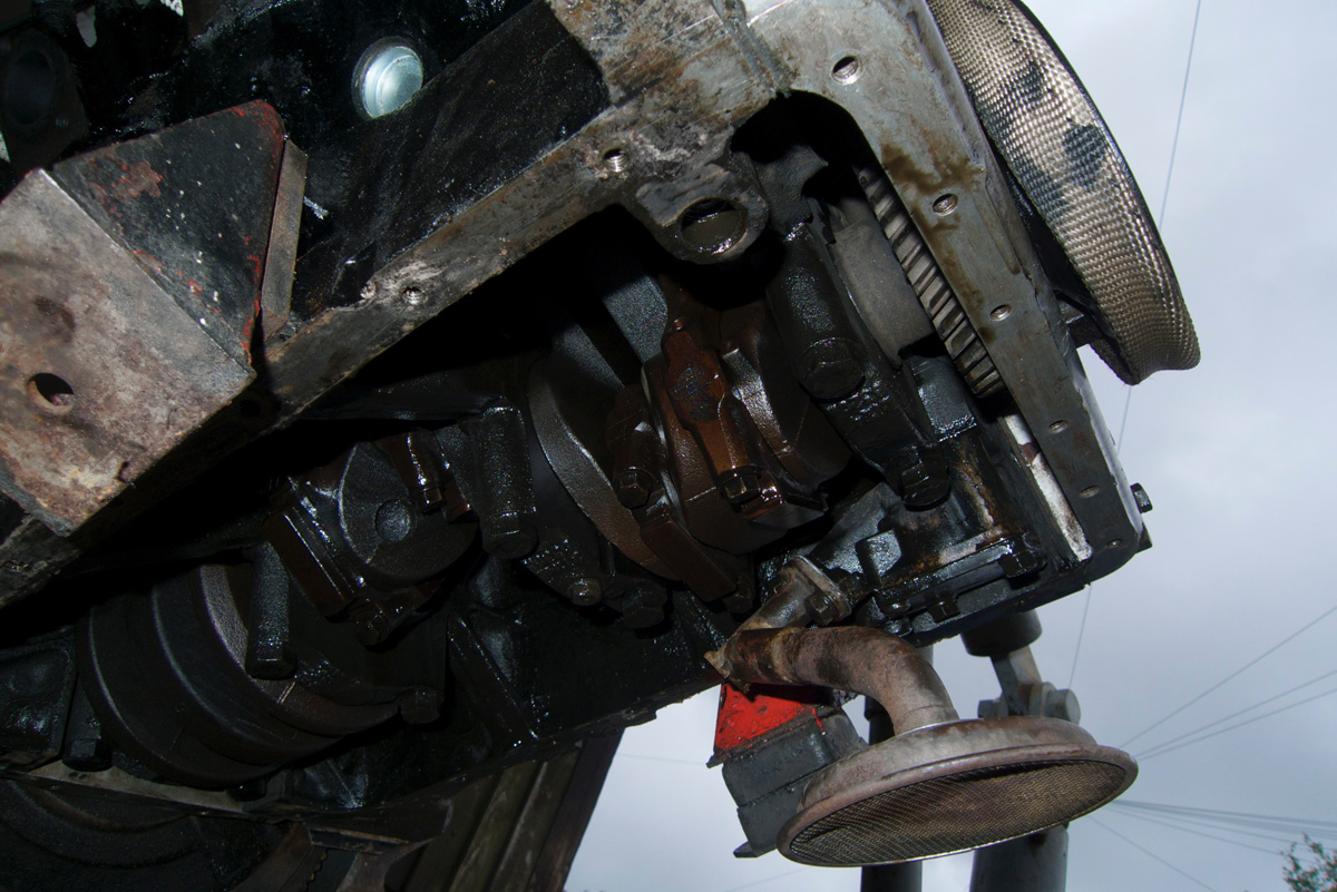

As we were fitting a later Essex engine to an early car it was nessicary to convert it to front bowl sump (including fitting an early timing cover, and revised oil pipe.
Oil Pickup, This had been brazed together from a rear type pickup.

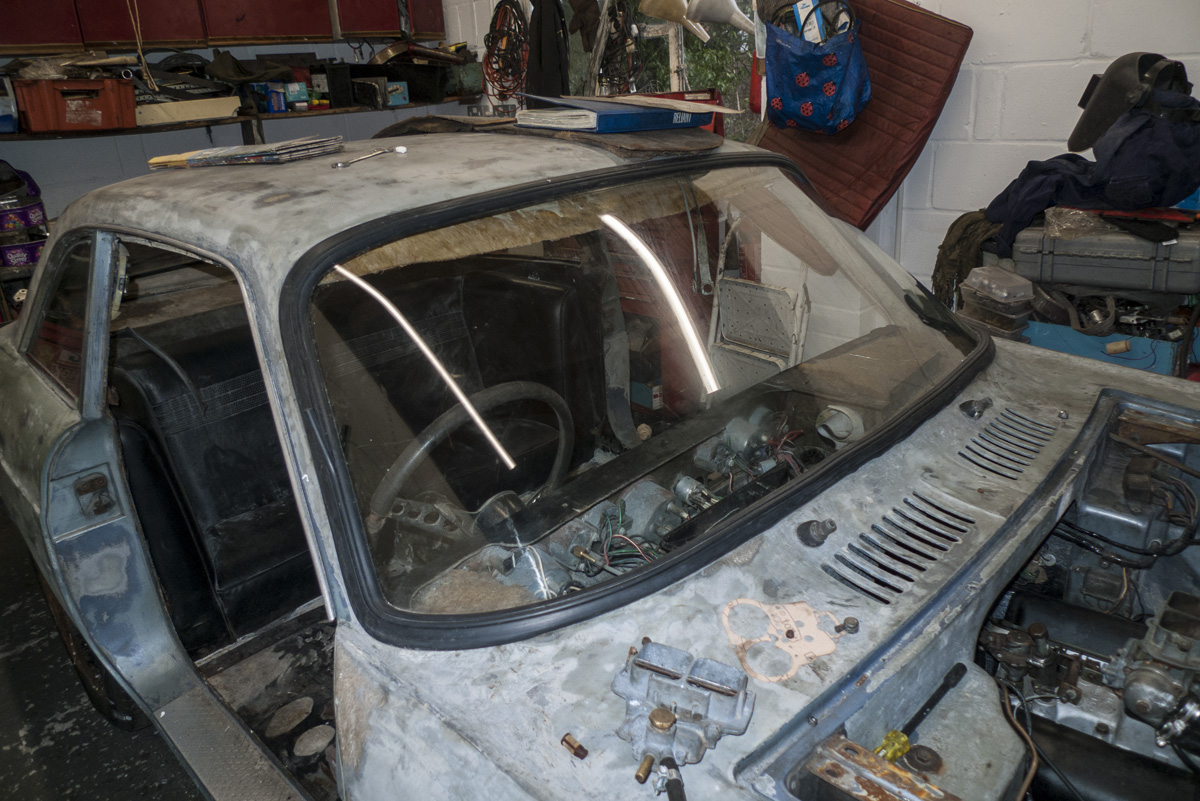

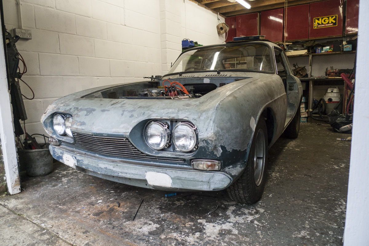

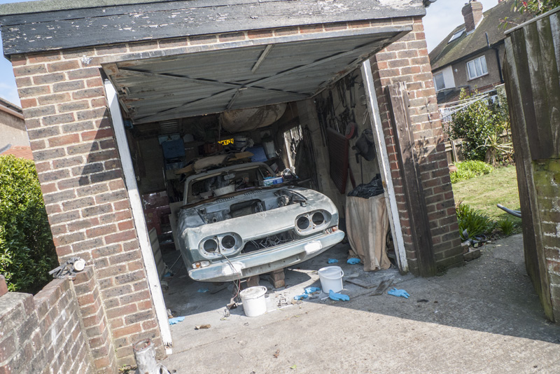

As promised I got a few fresh photos today which should bring this thread completely up to date:
Overview, Headlights have been refitted and electrics are now all connected and tested.

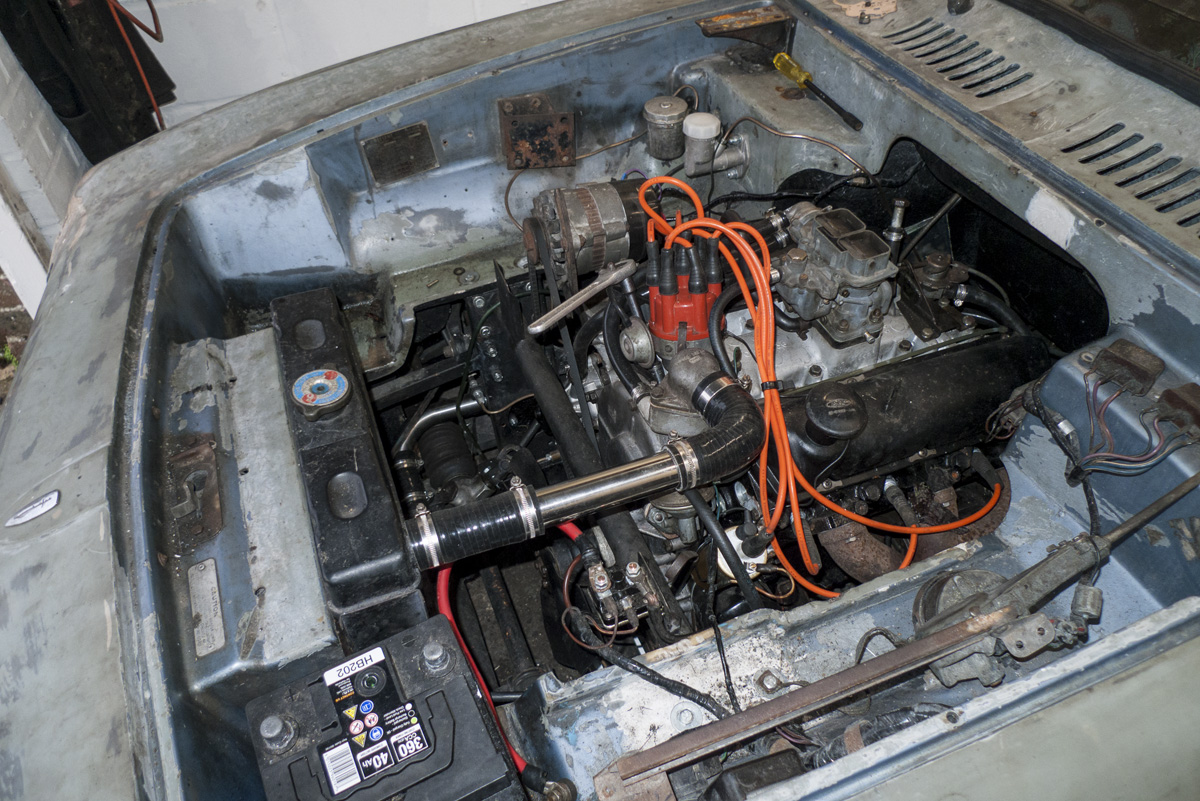

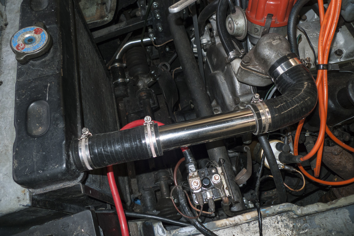

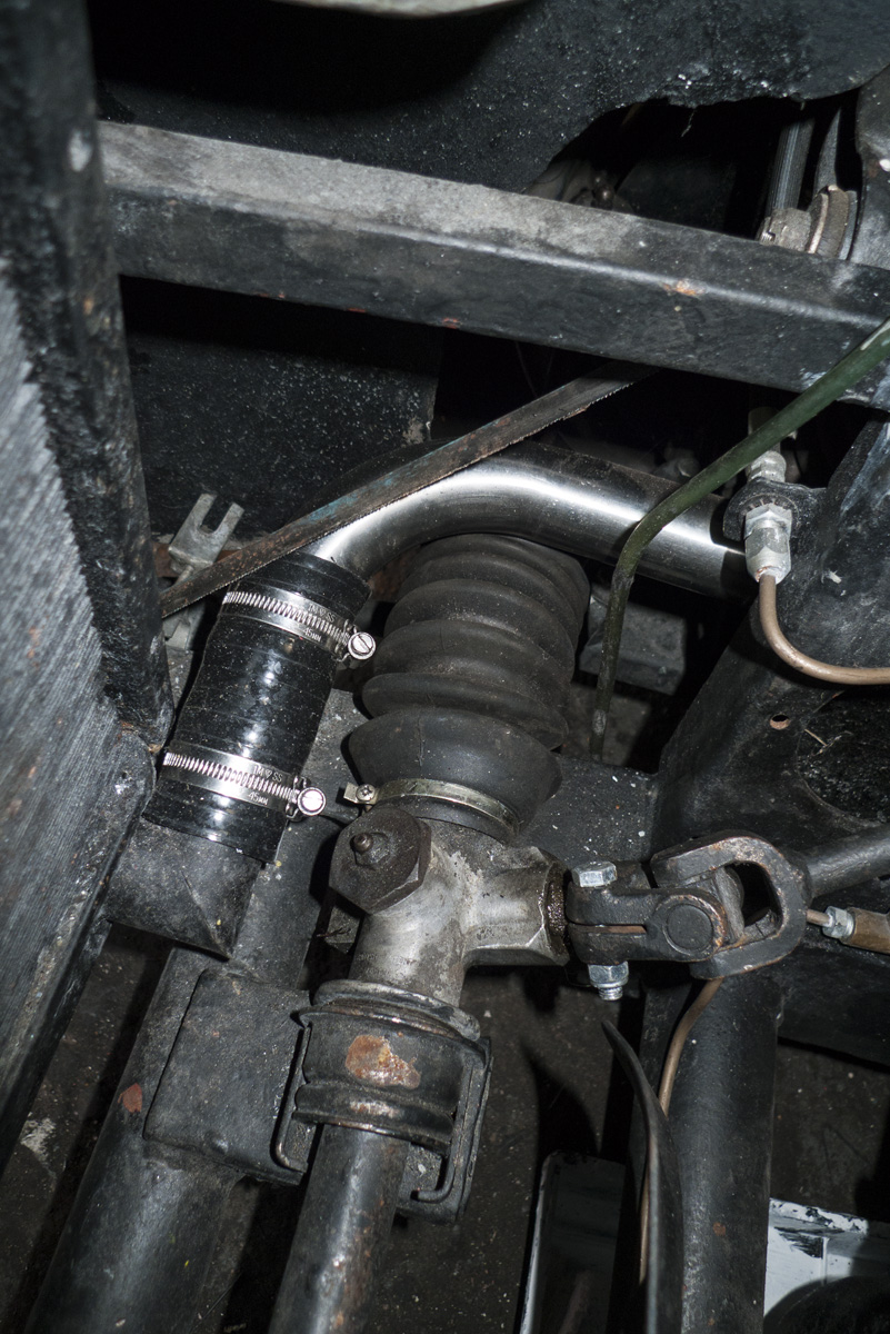

Engine Bay. Shortly after fitting the engine the exhaust manifolds, waterpump and down pipes were fitted.
The radiator has also been checked for leaks, flushed and refitted. The hoses and pipes are all new silicone/stainless pipe with stainless jubilee clips.
Not much has changed on the inside, the next stage will be fitting the seats and doors. I will MOT it before retrimming and painting as this approach seems to have served pretty well in the past.
I ordered all new seals for both coupés in the autumn. The screens will come back out again before painting. I've got chrome insert for them but wont use that until the final fitting.

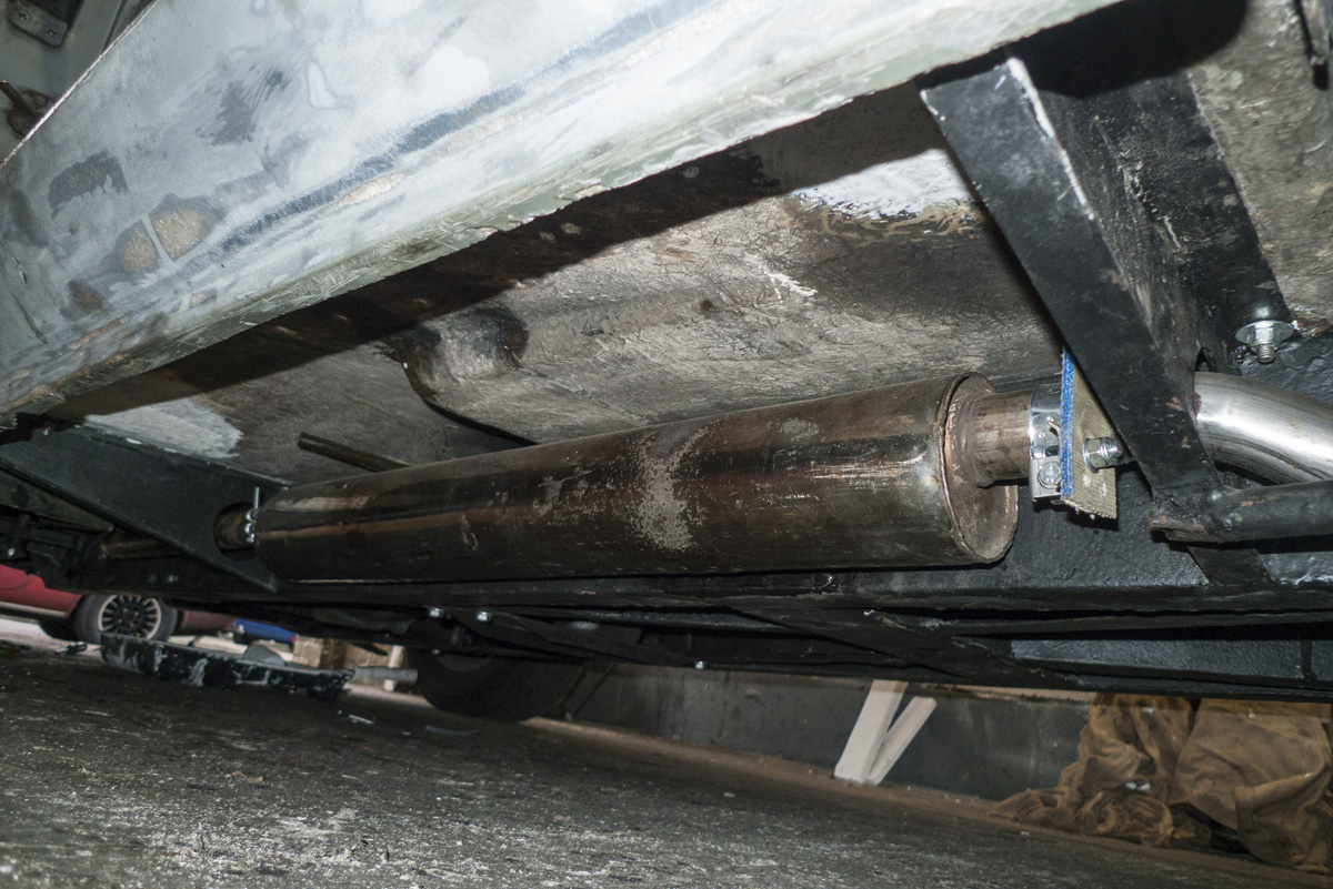

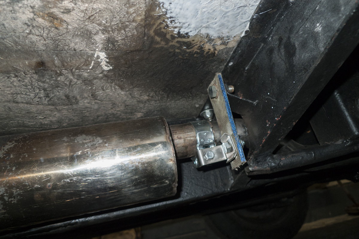

A full stainless exhaust system has been fitted,
Including stainless hanger brackets & Clamps,
