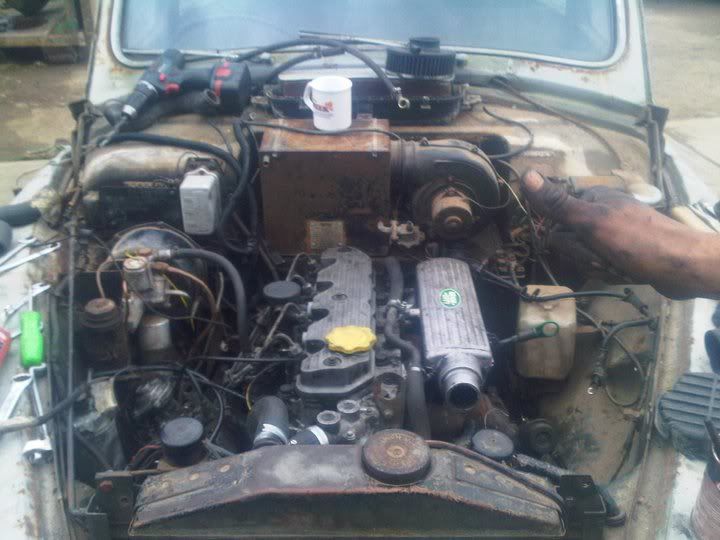

Love it. Given the link between the four-cylinder P4 and Land Rover engines, how tricky was it to achieve? I'd love something like that.
It more or less bolted straight in (it had the Land Rover 2.25 petrol in it), but I think getting it to fit around the P4's existing architecture was a bit more tricky than they thought. I'll get a few more details later.

I love the coffee mug on top of that iron box (my engineering expertise shines through once again).
This one was sub-£500 and the engine cost £150, body is full of filler but it's solid enough underneath, should have a ticket next week.
No cherry Mr Pogpeasant, but it is running on biodiesel!

A 200 does that in a Disco, it should be much better in the P4. And biodiesel is much cheaper than pump fuel. But it wasn't done for fuel economy so it doesn't matter anyway :D
