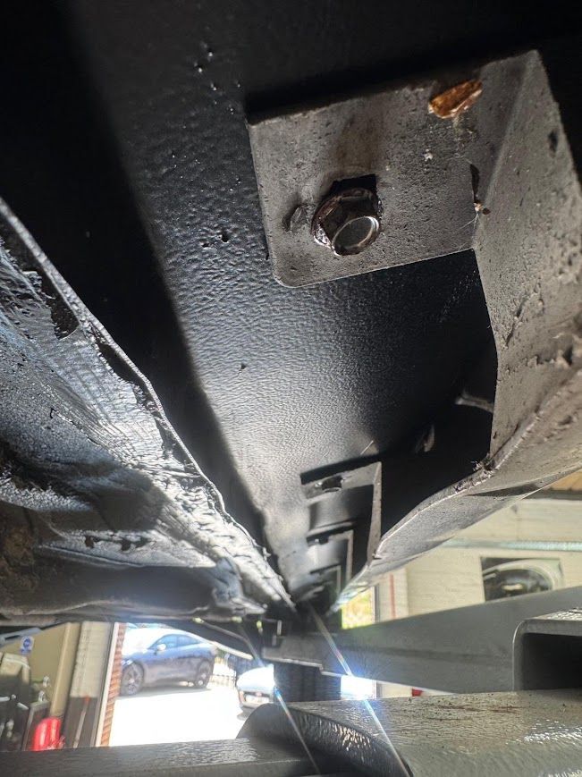

Most recently I asked them to tackle the rust in the n/s sill. This is what they found
That brings us up to date. The A/C doesn't work though, so doubt I'll be driving it today lol
