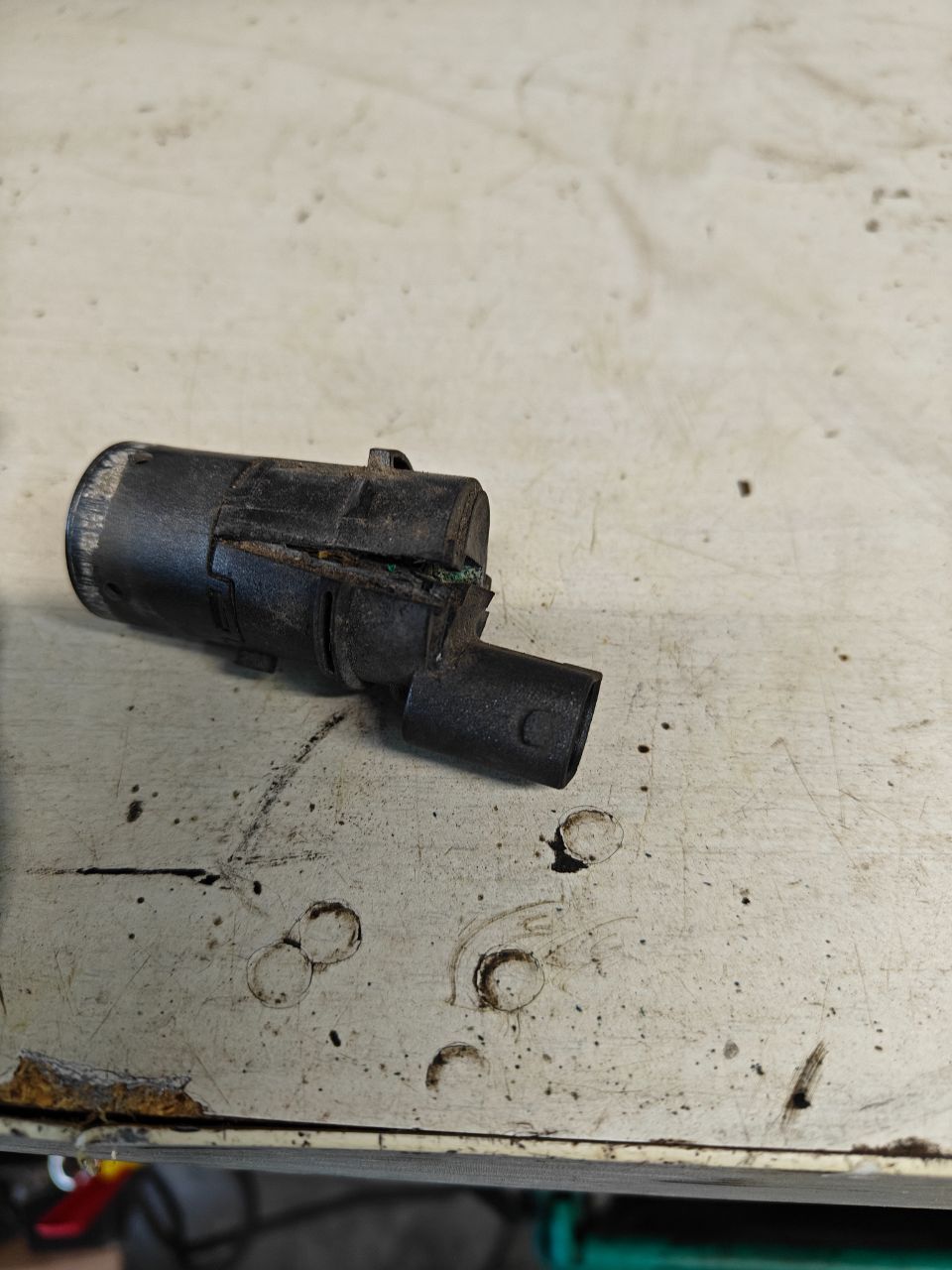

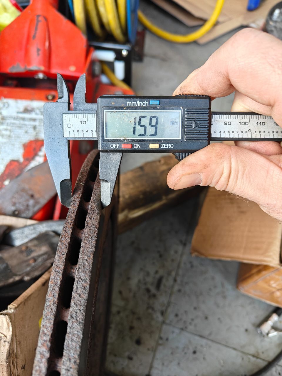

dome Posted March 18 Author Posted March 18 Out of curiosity I ground down the lip on the old discs to see what thickness they actually were. New 20mm, minimum 18mm. There was probably a bit more lip I could've taken off too. The pads weren't too bad so someone had replaced them when the discs were fucked. I had a quick prod at the dead parking sensor, my scanner had told me it was the LH rear. Handily you don't need to remove the bumper but can get in by removing the tail light. Got it out and no, I've no idea why it doesn't work🤷♂️ New one ordered up and we'll get that sorted. I'm thinking I might not tax it til April (expensive tax sadly) and crack on with servicing and fettling it in the meantime. mk2_craig, yes oui si, Popsicle and 3 others 6

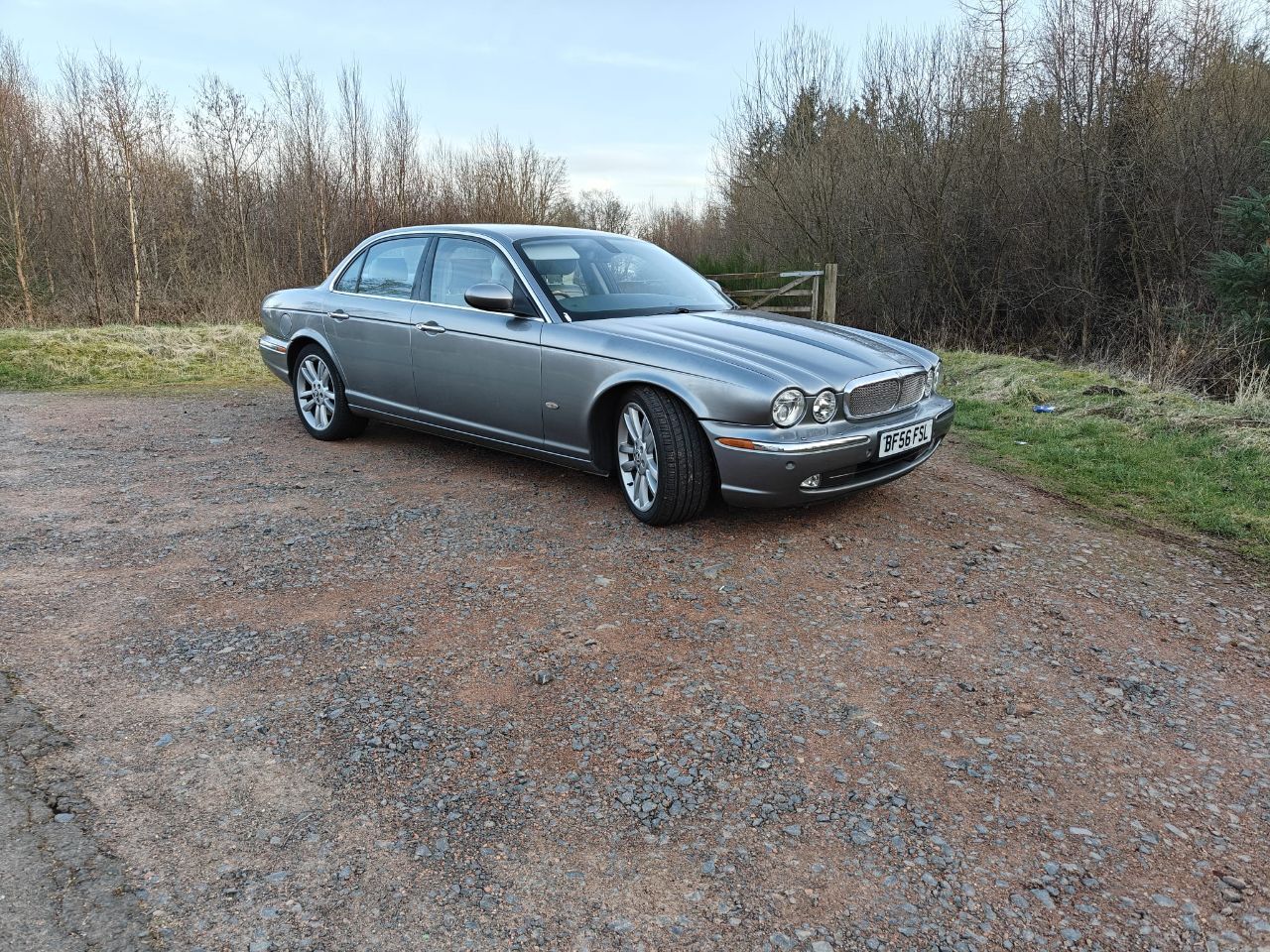

Lord Sterling Posted March 19 Posted March 19 1 hour ago, hairnet said: is @Lord Sterling gonna be dibs No. There is enough Jags here. But I get an uneasy feeling that I may, at some point, end up with it. In the meantime, have a free* picture of mine with a random UK-reg'd 2.5 I spotted in my favourite Brussels carpark: * ˢᵉᵉ ᵗᵉʳᵐˢ ᵃⁿᵈ ᶜᵒⁿᵈⁱᵗⁱᵒⁿˢ privatewire 1

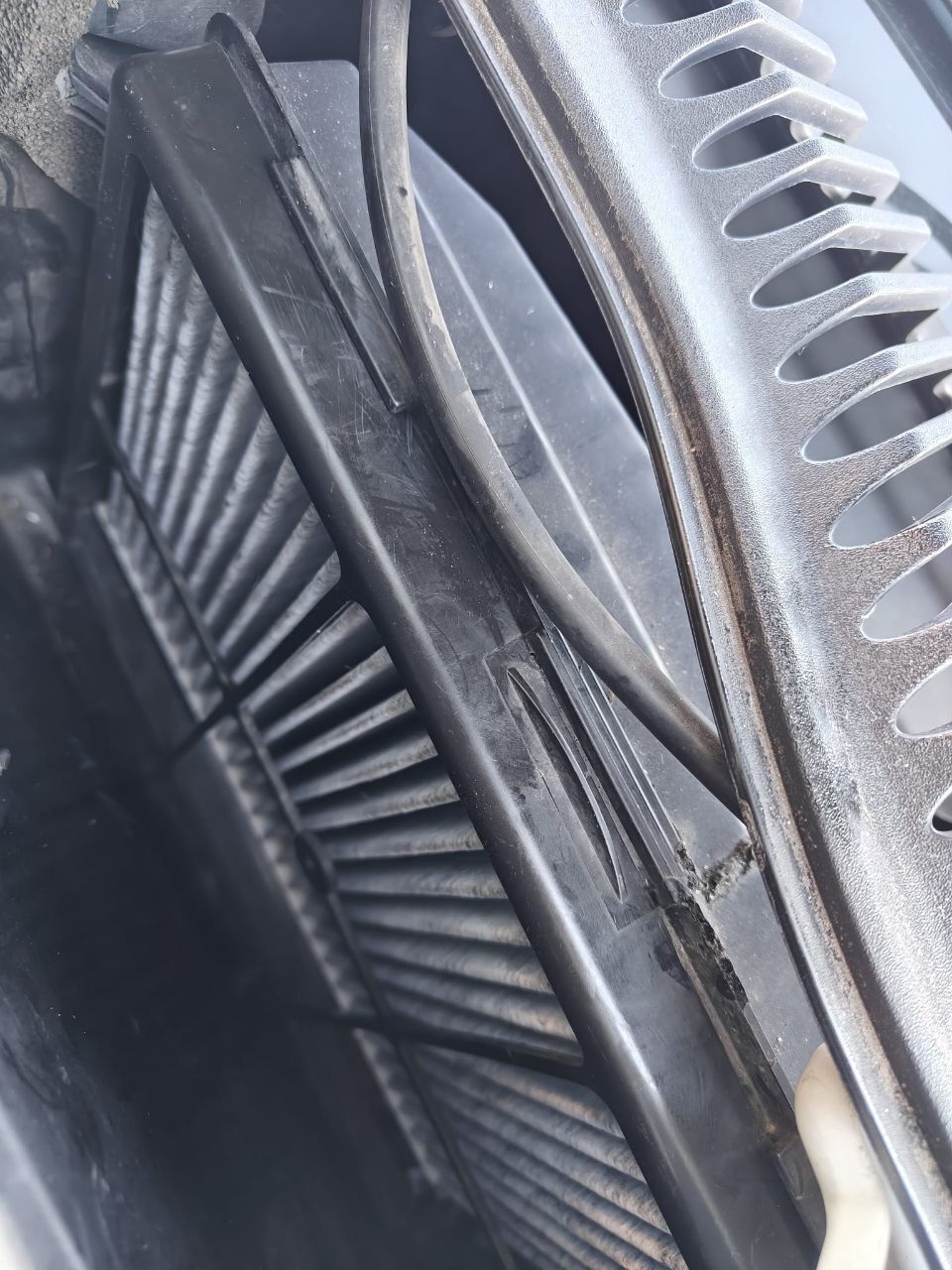

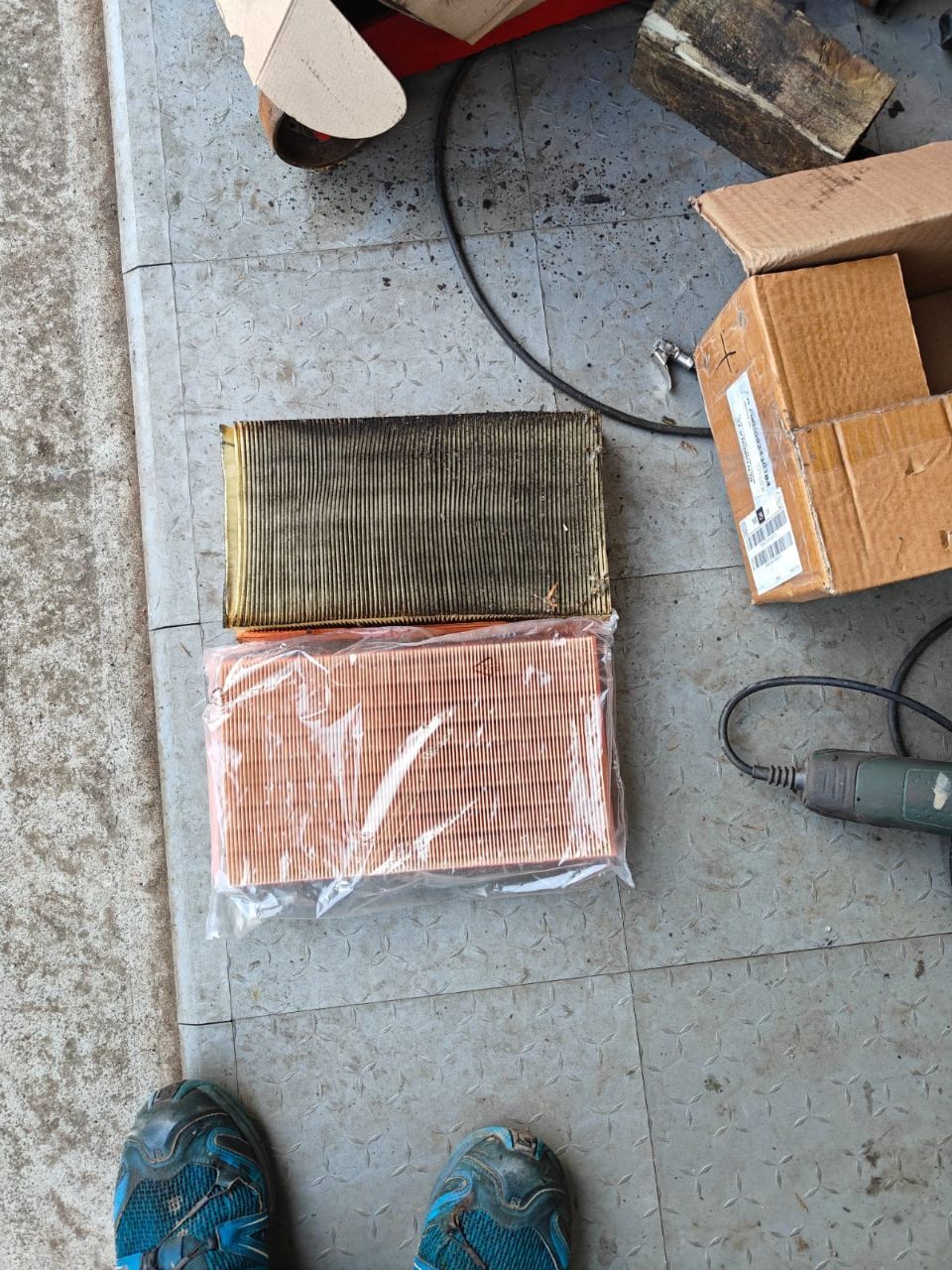

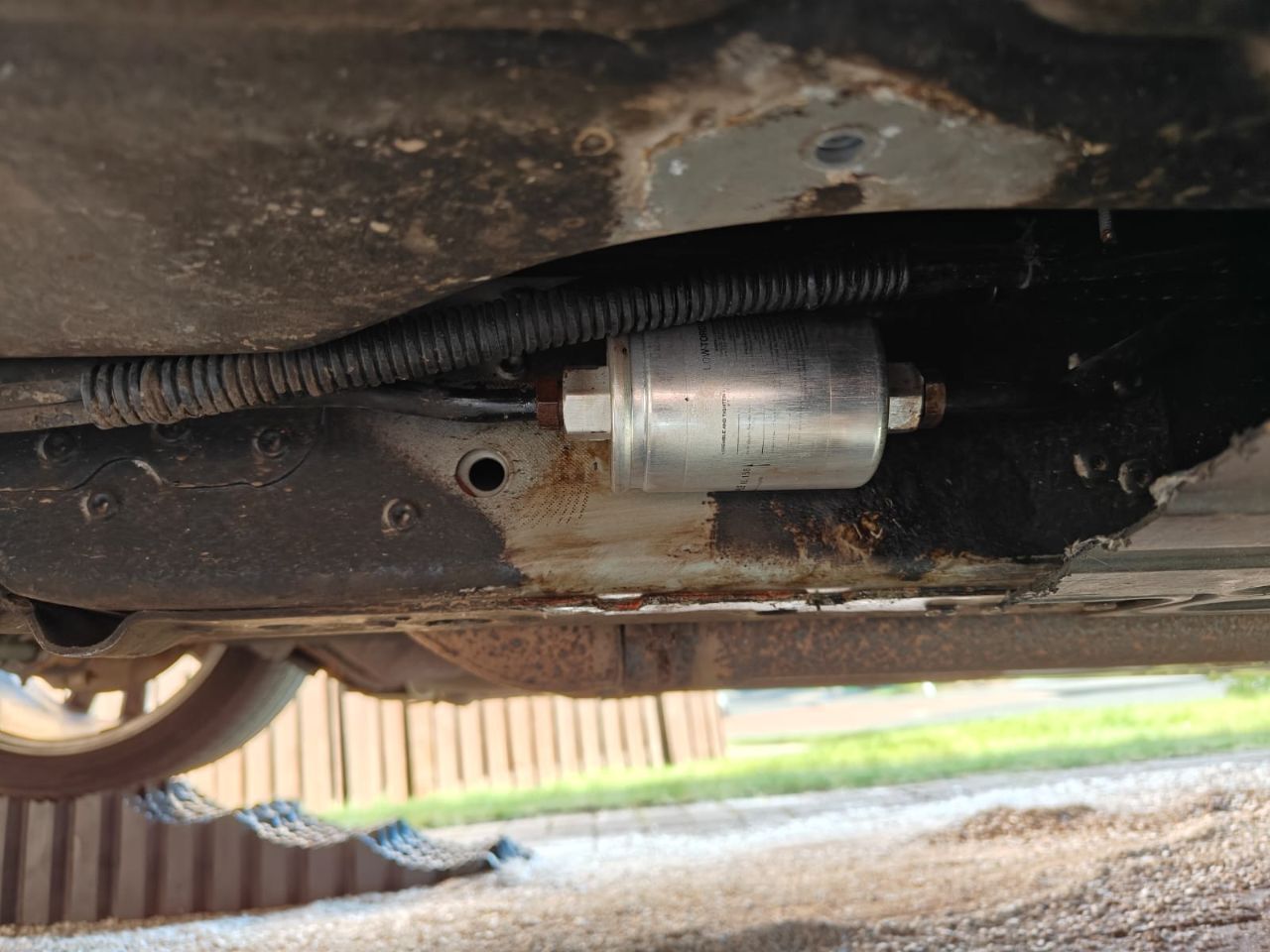

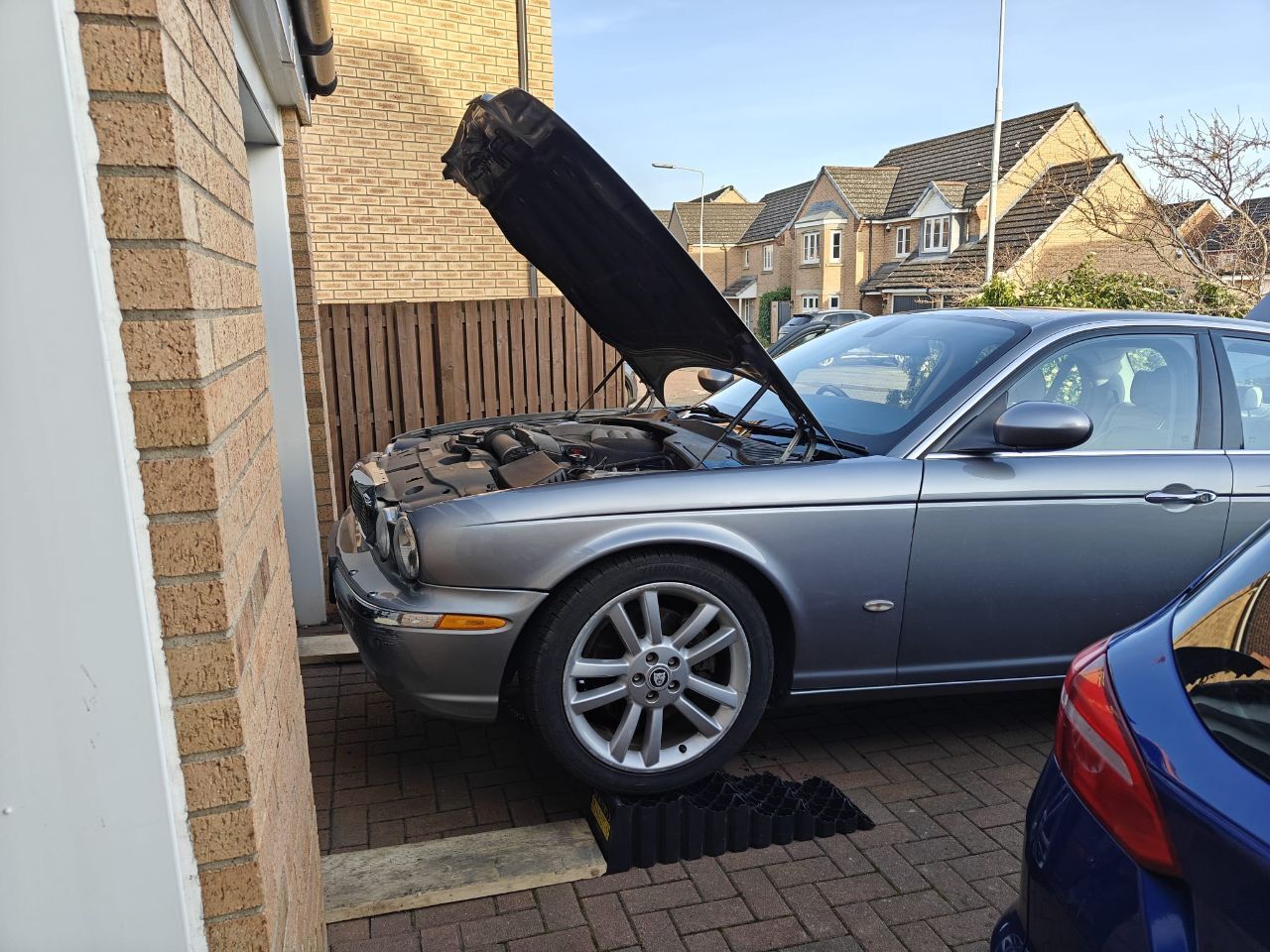

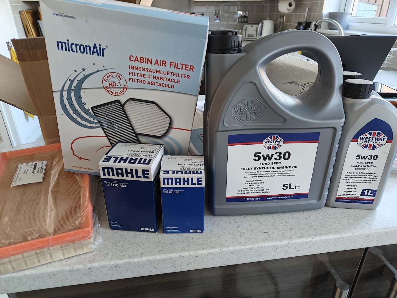

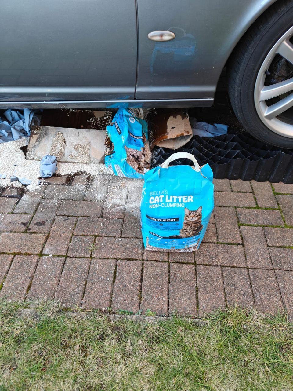

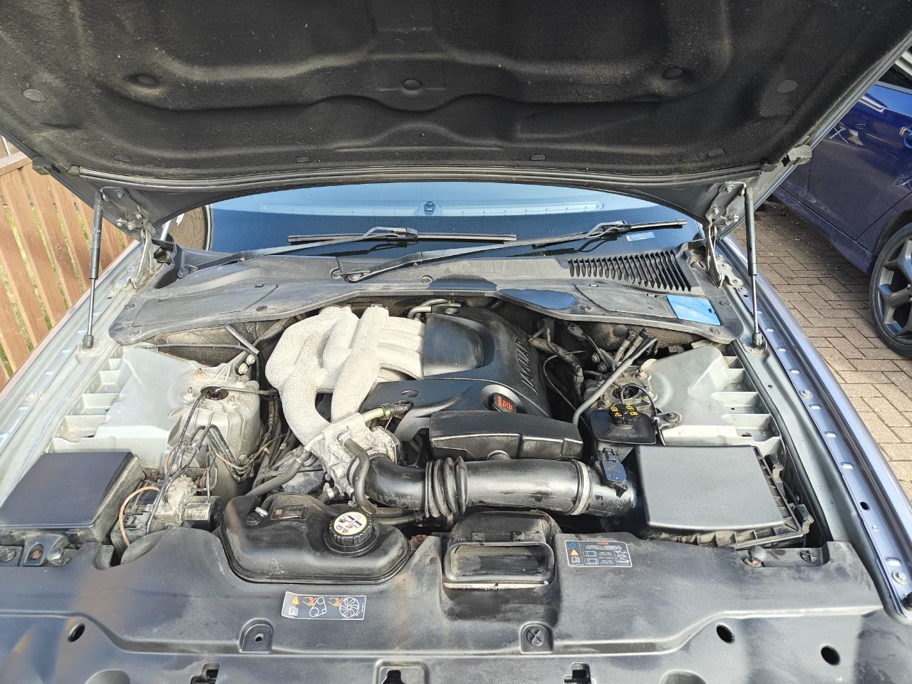

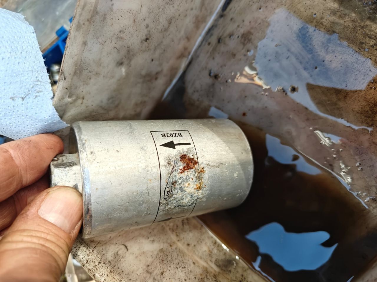

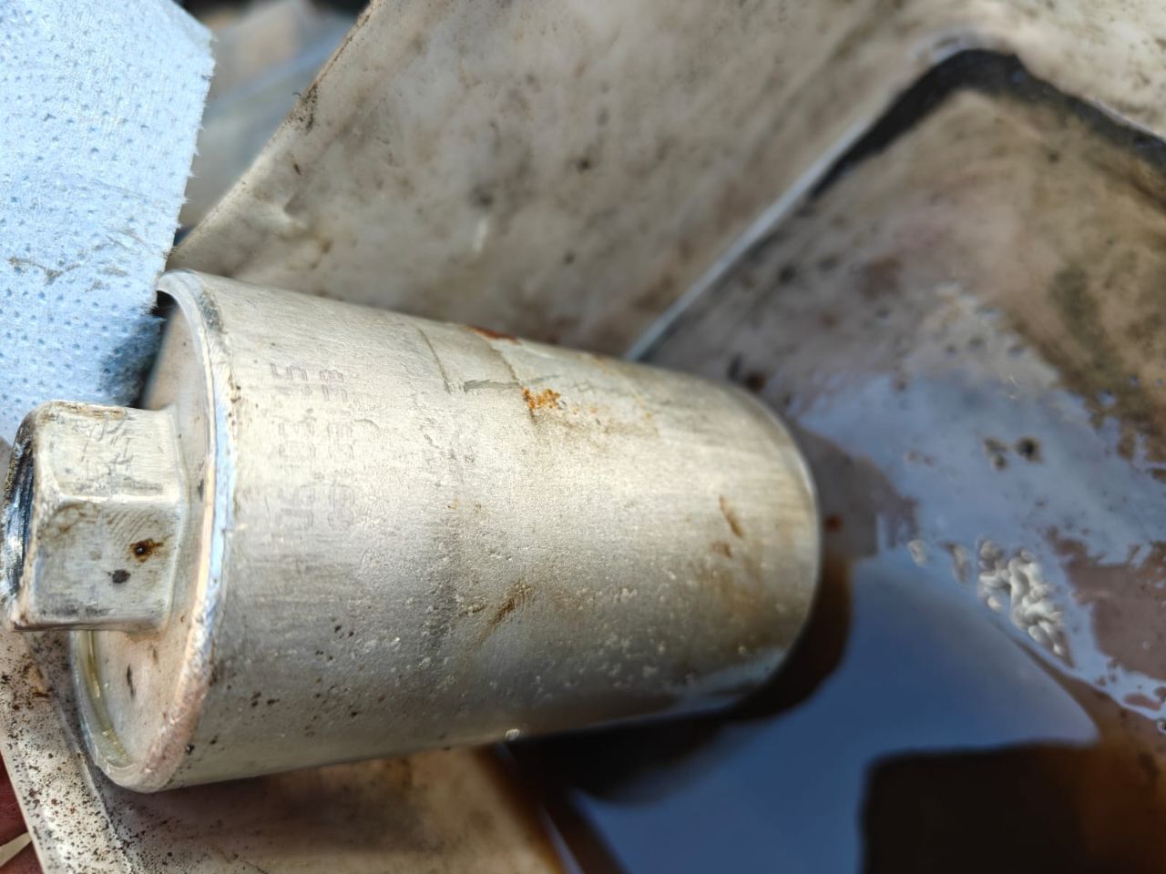

dome Posted March 21 Author Posted March 21 On 19/03/2026 at 18:21, Lord Sterling said: No. There is enough Jags here. But I get an uneasy feeling that I may, at some point, end up with it. Way to make a guy feel good about his latest purchase🤣 The service kit arrived this week so I thought I'd reward it for passing the MOT Assume the position Cabin filter was easy and definitely needed. New on in. Air filter was boggin I dropped the oil into my halfords drain can which decided to drain it all over the driveway 🤬 Insert big cat joke here... Fuel filter next. I had to cut part of the plastic undertray to get to it as a couple of bolts were just spinning on their studs Jag filter from 2015 And new filter on A nice bonus was ice cold aircon when I started it on the first warm day of the year A quick spin was had to try it out, it is a very nice place to be and definitely more special than the E65 730d of a similar vintage. It has that unique Jag thing of excellent body control but an ability to handle far better than something this size and comfort should. vtec-e, Split_Pin, Cento16v and 16 others 19
