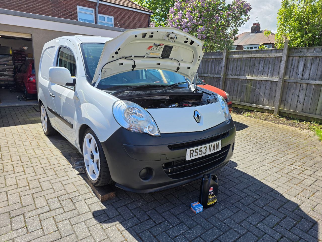

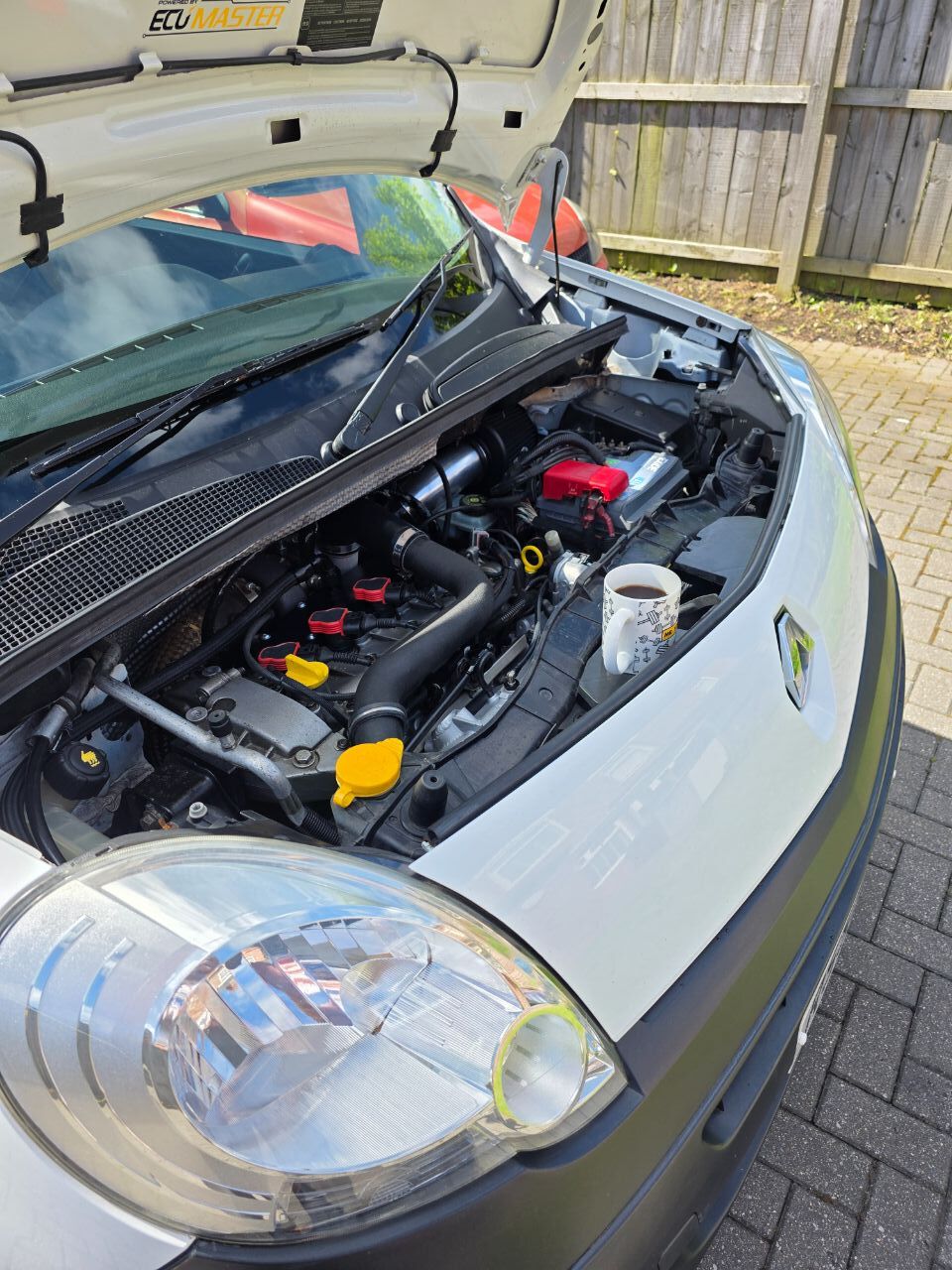

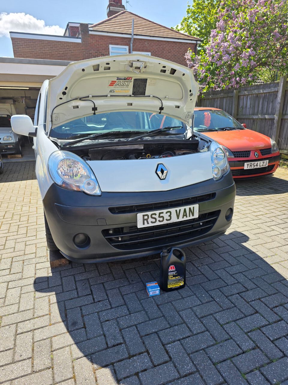

Kangoo updates.
Took it out Sunday morning for a test run, no issues and confirms stress fracture of the fuse was the cause for no start.

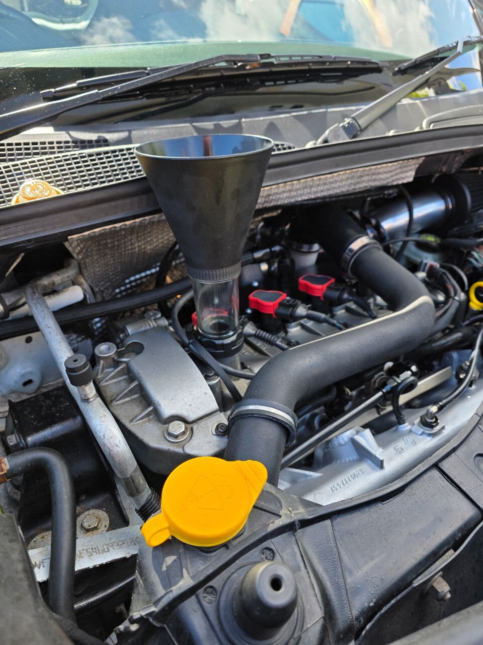

Mapping slot booked for June 13th, prep starts with Oil and filter change. Fresh purflux filter and millers 10/50 nt+.
20260510_103457.jpg.2c2fce8dfd7a53d586474a55bceaee2e.jpg20260510_111238.jpg.c547908cd334fc704d3323e5b1fbbd3c.jpg20260510_111244.jpg.e17fc341fa49da71696e0cfc977c5e8c.jpg
Ive said it loads of times before but just buy one of these sealey oil fillers if you have a megane. Class bit of kit, no spillage.

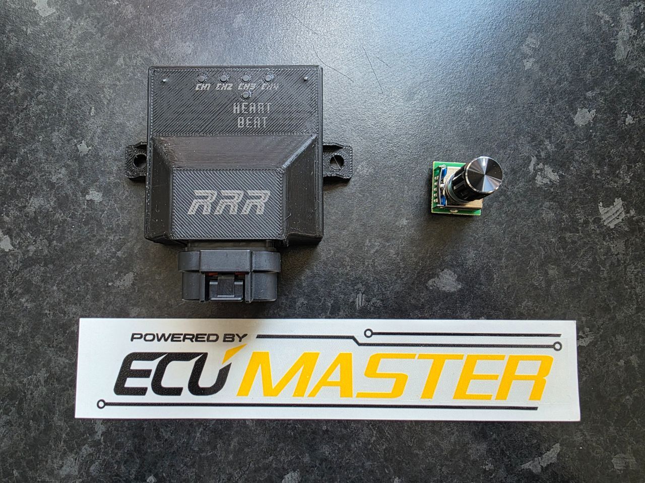

Bought an Ecumaster can switchboard and rotary switch for boost control. 20260508_111506.jpg.9b0e4c4b31bd34c9601d2f143f8f21c8.jpgThe switchboard is a nice bit of kit, i run it on my trophy. Simply connect to canbus wiring in car and you can run extra analogue switches and inputs to the ecu via can. The rotary switch will allow for 8 different boost levels blending boost table 1 & 2 together. I think boost table 1 will be set at 12-14 psi and table 2 at whatever the clutch can handle. Might repurpose the cruise buttons on steering wheel for rolling anti lag and launch, just need a modus cruise squib. Ill get the switchboard fitted and configured this week ready.

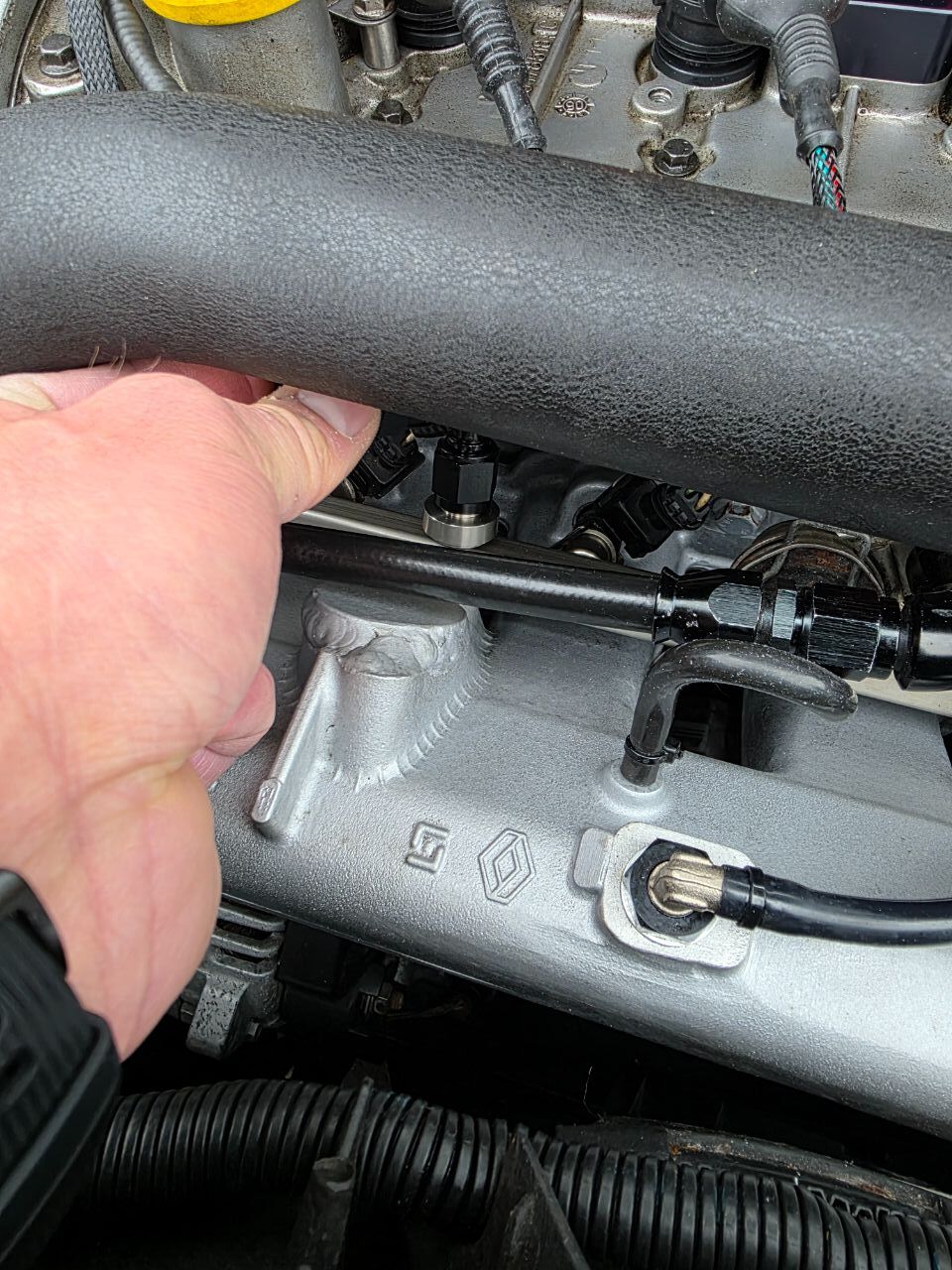

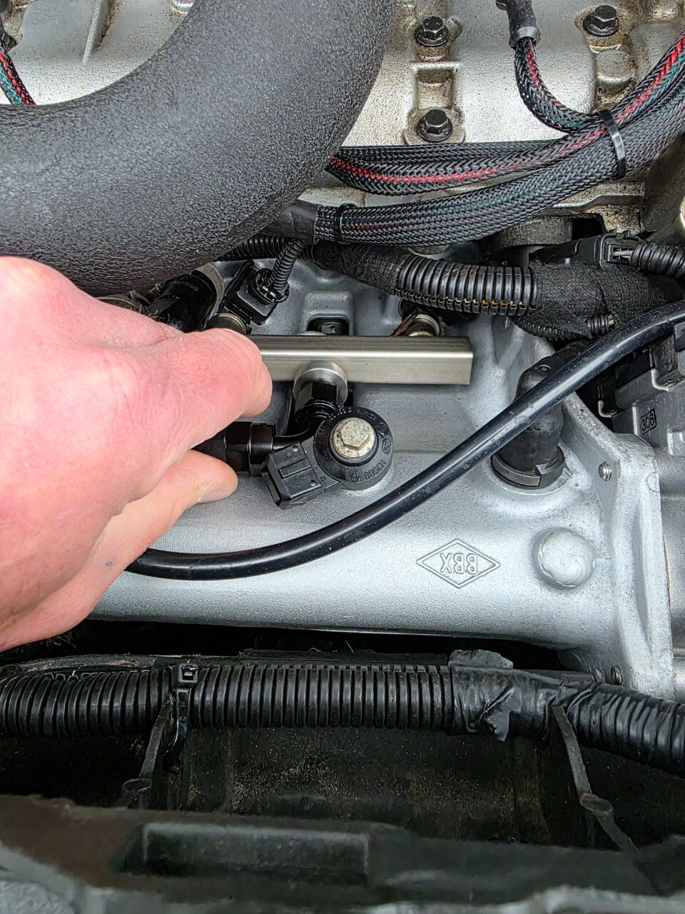

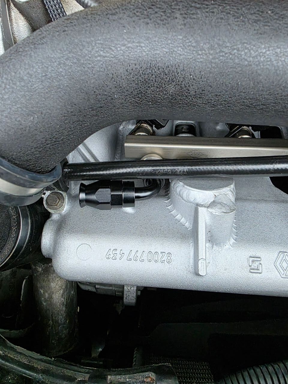

Also been thinking about fuel system upgrades. I have a couple of spare megane 250 rs stainless fuel rails here and plan on getting one modified, removing the oem regulator and welding the holes/fitting an an6 inlet and return fitting. The reason for modding oem is to retain the injector holding clips, as a lot of aftermarket megane rails do not allow the clips to fit.
20260509_140656.jpg.366e777516ccb7cf1c823c061bdee55b.jpg20260509_140703.jpg.380895e5b6fb80bfe2621f3d85513354.jpg20260509_140735.jpg.beb3b644992335c2f46d6f4adcba4691.jpg20260509_140749.jpg.f70724cd05ebadf996783c70d852ff38.jpg
Top or side, both will work in theory. Ill think about it.

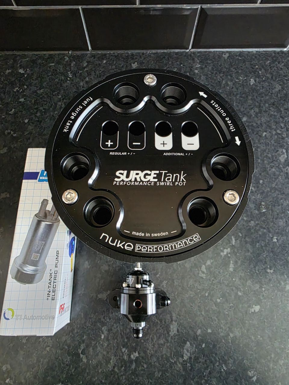

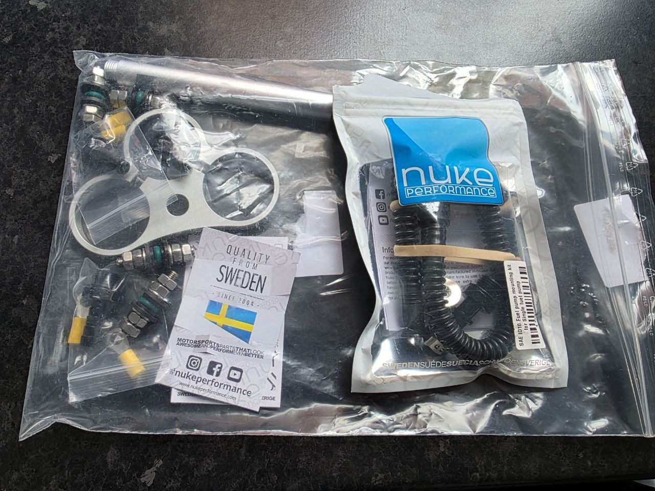

A few bits have arrived for fuel system upgrades on the Kangoo. Nuke 3ltr surge pot, walbro 420lph fuel pump and aem fuel pressure regulator.
The nuke tank looks proper sexy, really well made. Im hoping the internal pump fitting will keep the noise down. We will see.
