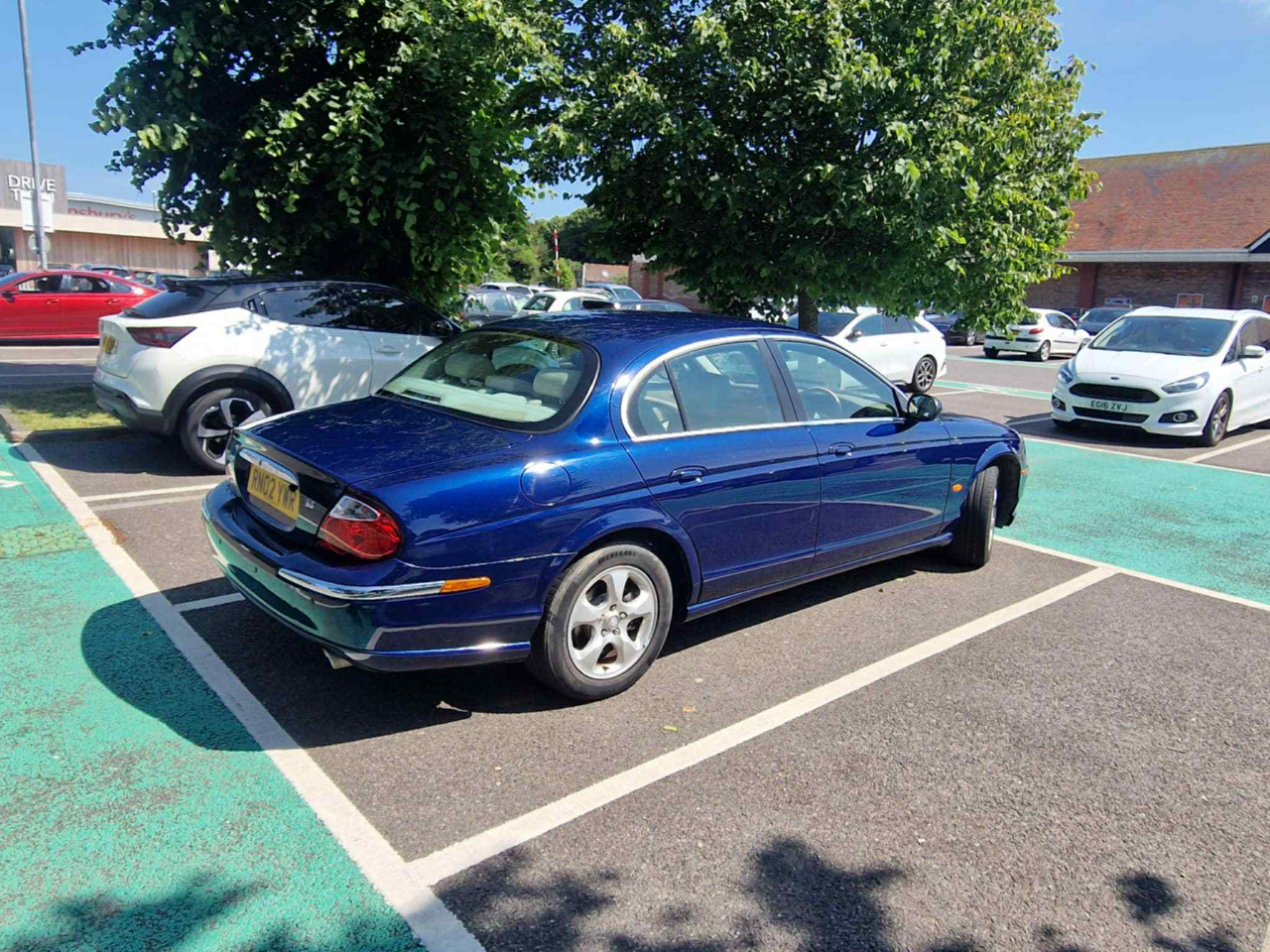

5 minutes ago, Schaefft said:
It looks great for 300 quid, Satnav so must be higher spec as well. If it still has sills that's a bargain.
It’s never been advised for corrosion at all, which seems helpful, part of the reason for the cheapness is the backbox is hanging off on one side, and there’s no paperwork at all, literally nothing, not even a V5. Everything works except the driver window. Will be using it from August when the insurance on the MG expires, will renew it onto the Jag.

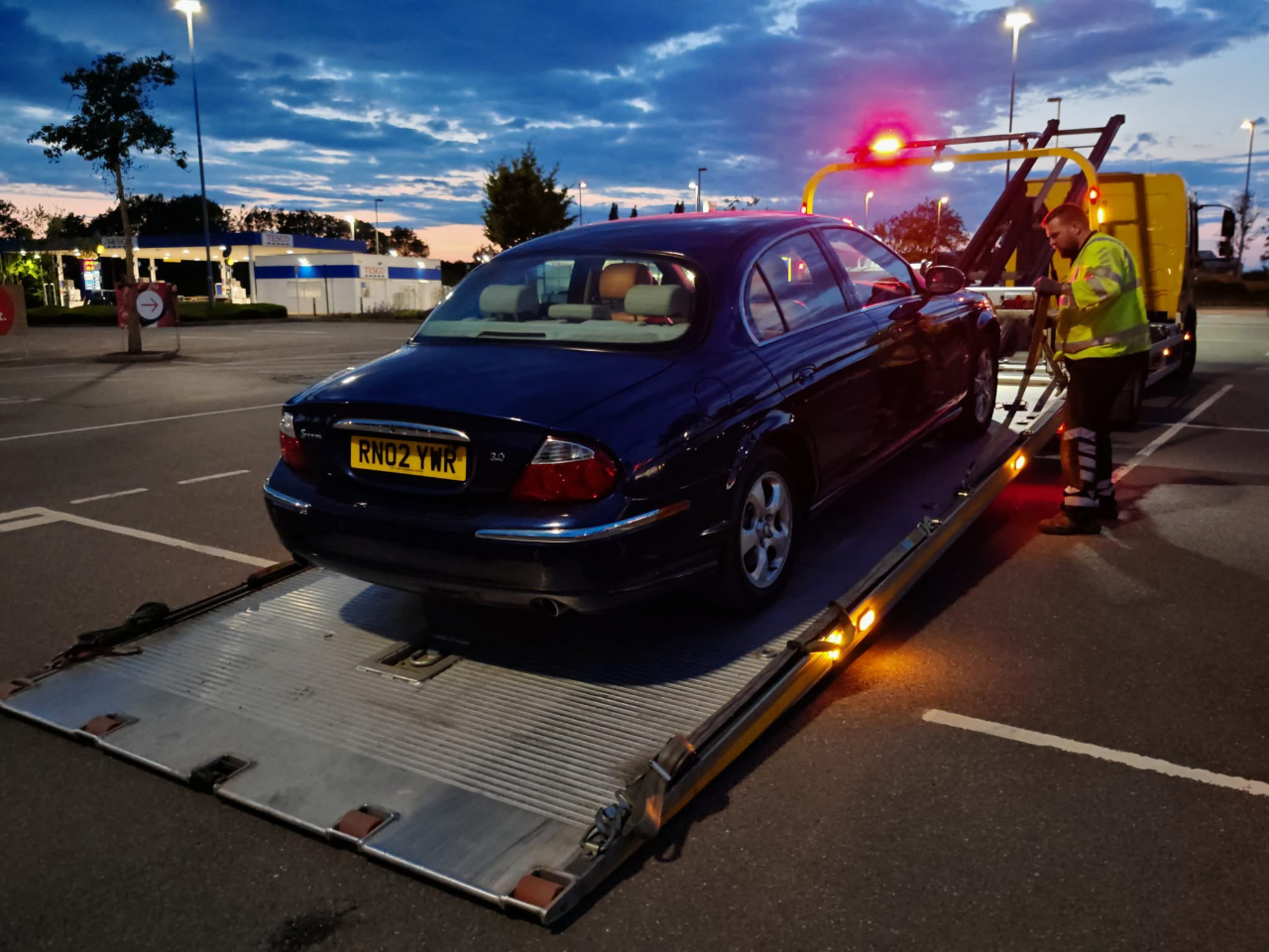

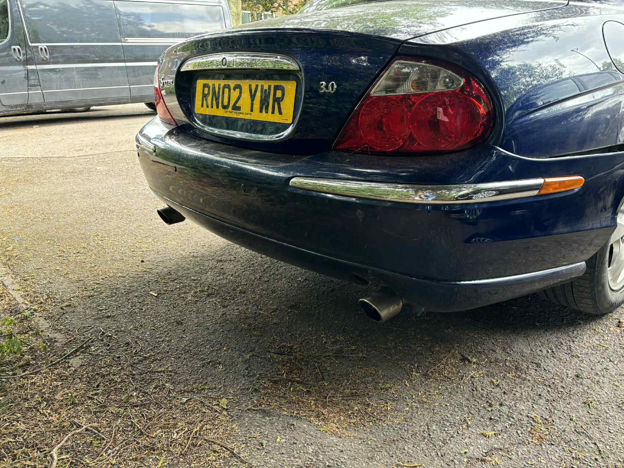

Popped a brake line, very fixable. If it hadn’t gone totally I’d have clamped it off and driven it home carefully but it’s BURST
Ever think you’ve made a bad decision?

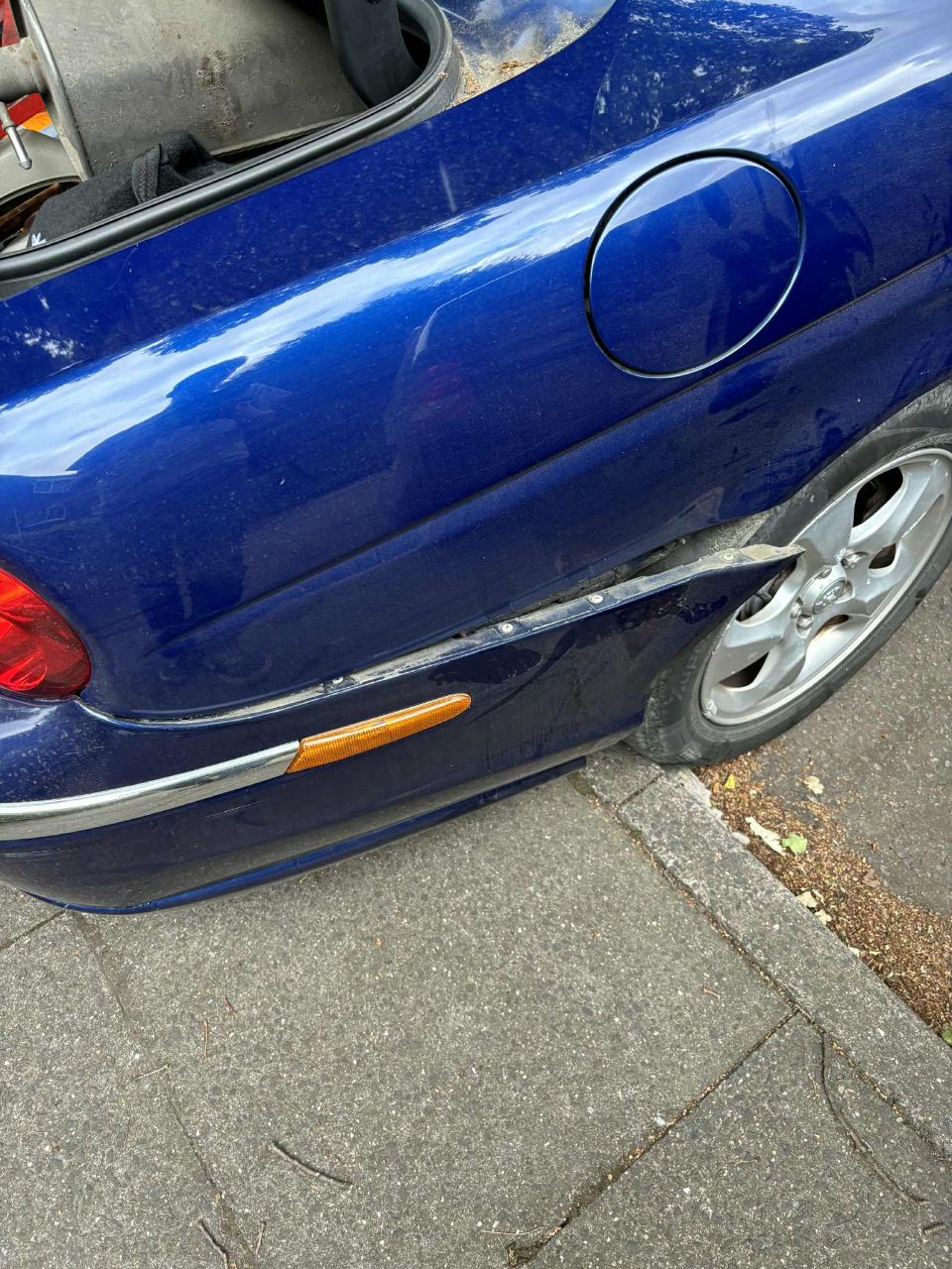

Moved it as it was parked illegally, pulled forwards and there was a hell of a bang.
Backbox has come off and ripped the bumper off.
Not off to a good start are we? I already miss the MG I’ve put in storage.

Assuming your back box isn't badly damaged it should fix back on OK and the bumper will just be needing a few clips.
It was built under Ford ownership. I could show it some heritage and get some duct tape for the bumper.

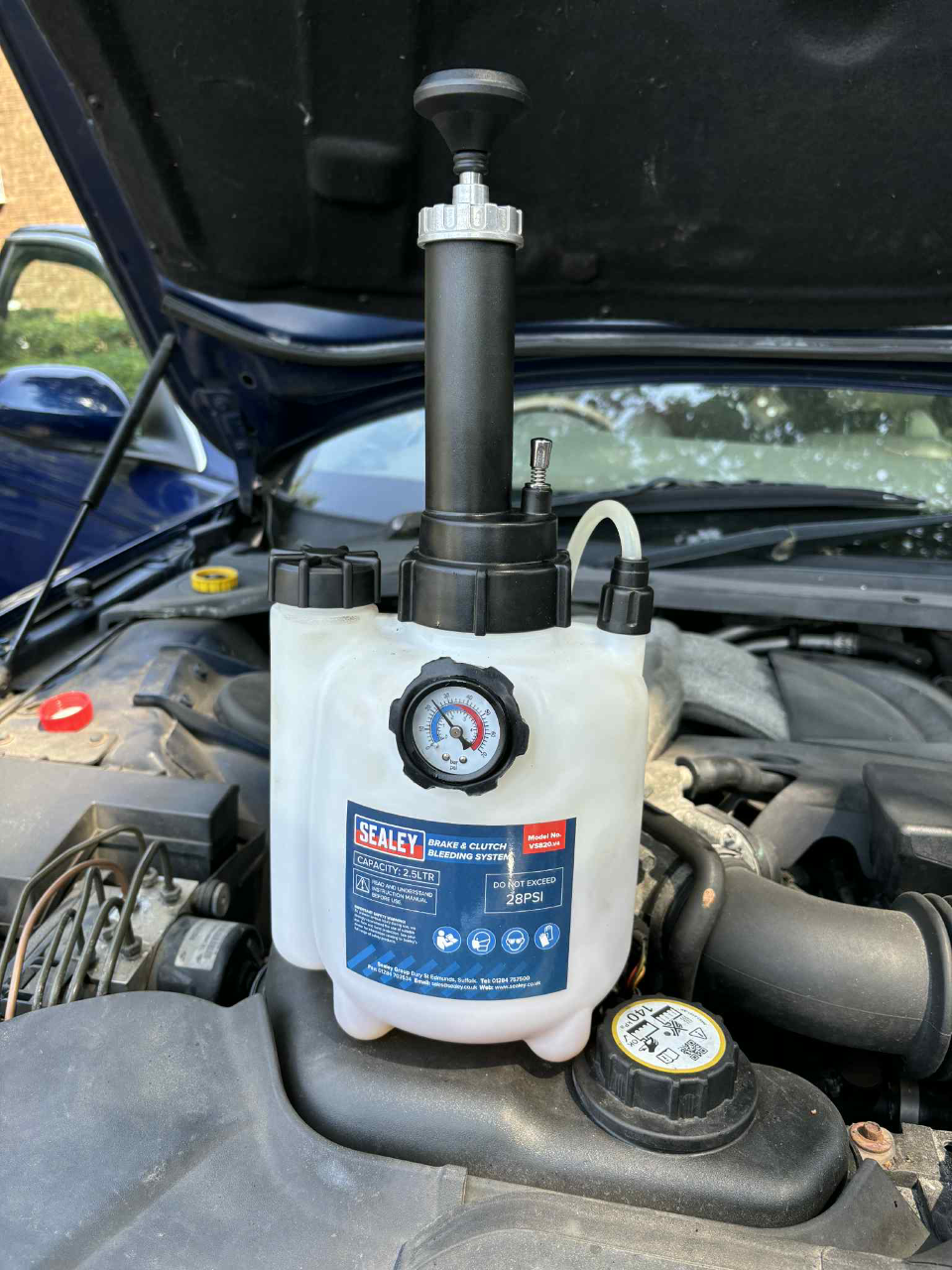

As per usual, many many thanks to @Heidel_Kakao for coming around and making and fitting a brake line for me, especially with this cool bit of kit I want now:

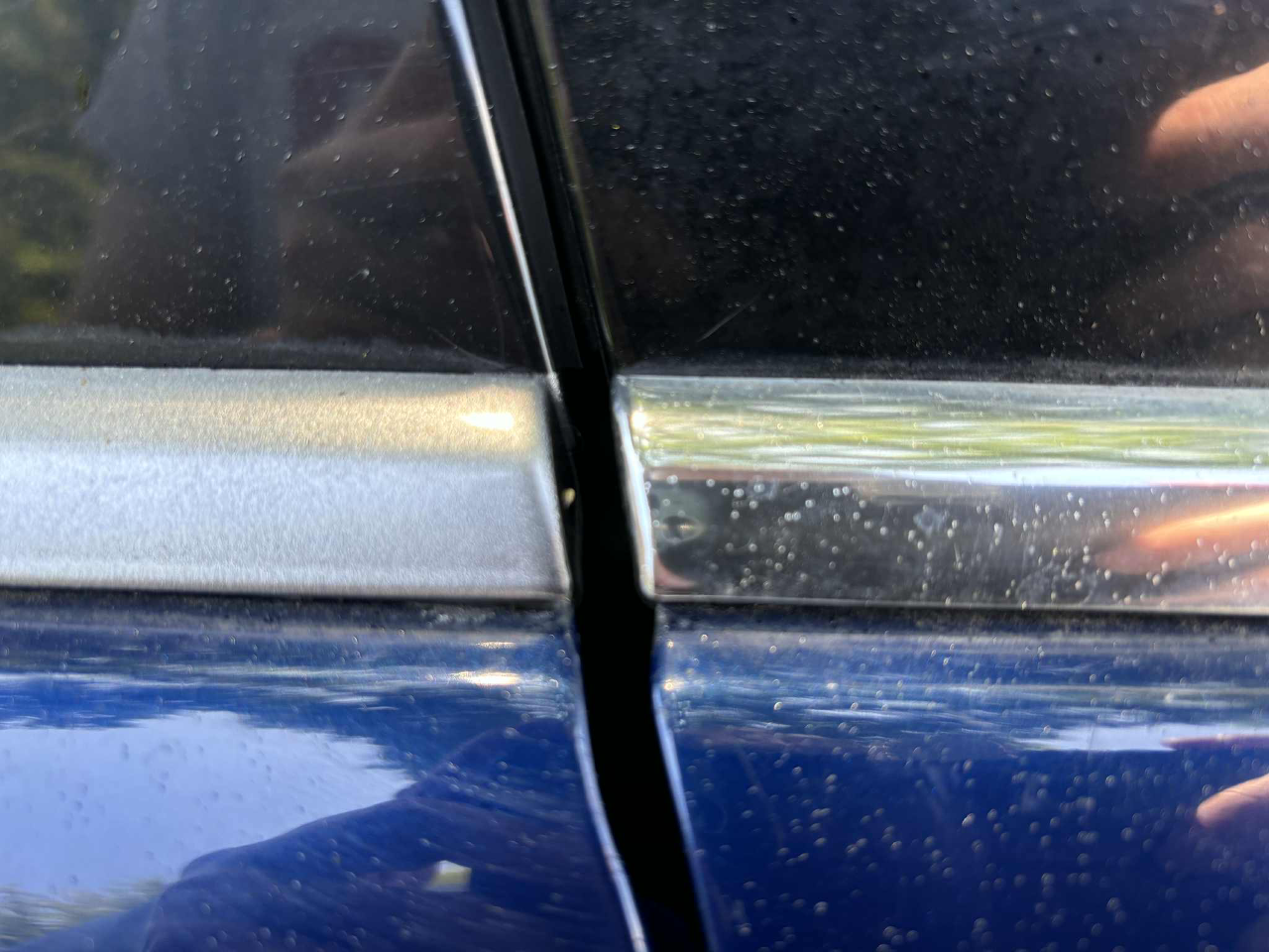

Also discovered some of the chrome was not chrome and was in fact paint and that’s going to piss me off far more than is reasonable:
But on the upside, it’s done 7 miles and not broken, so that’s the furthest I’ve managed in my ownership so far, at a polar bear friendly 17mpg!
Now I just need to get the ABS pump bled through which as far as I can work out requires diagnostics. Pedal is still a bit spongy but it holds pressure on the pressure bleeder and the thing is 100% bled up.

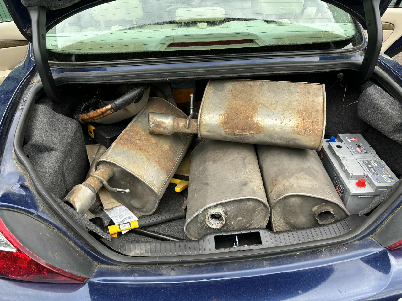

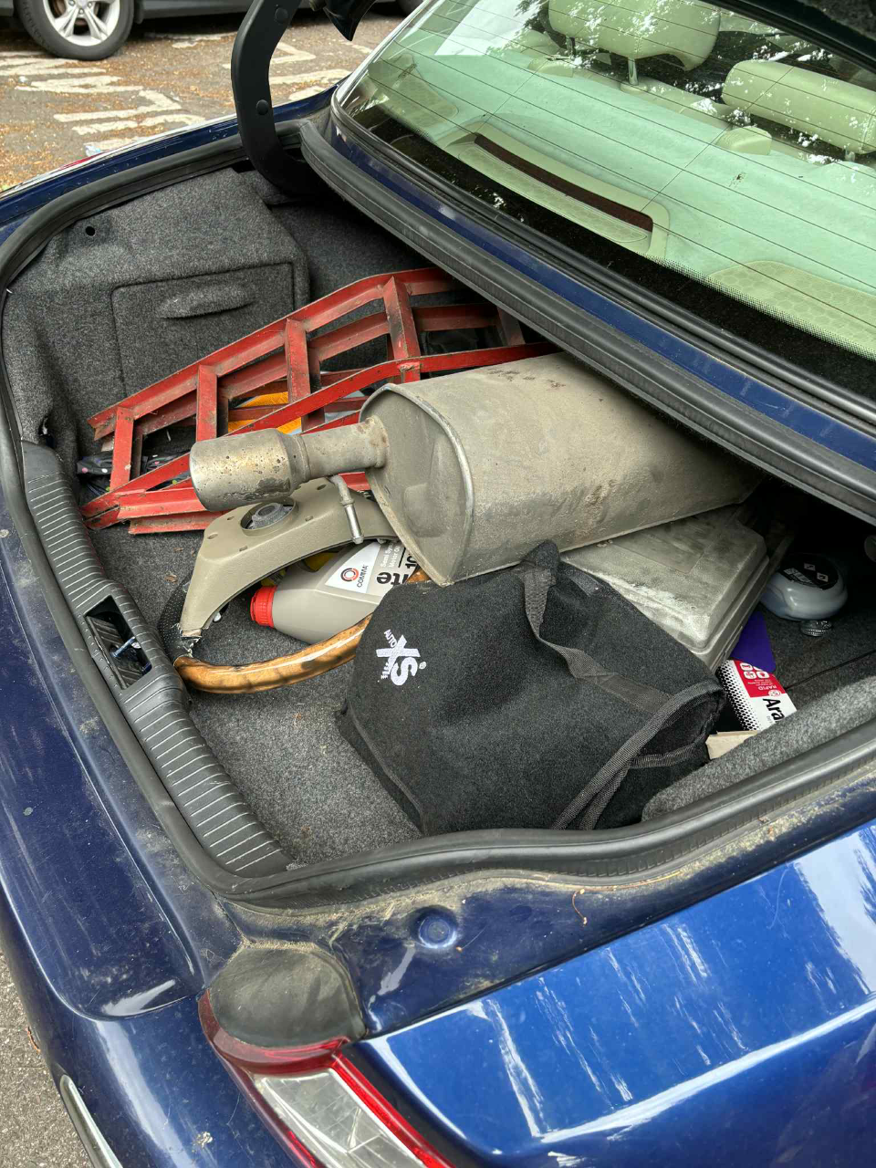

I look like a scrap man. On the upside though, new* backboxes. One may not be any good but the other one definitely is so I’ve got at least one backbox good to go. Won’t silence it entirely but it’ll shut it up a bit, and the bloke who I got the thing from gave me the centre section FOC too.

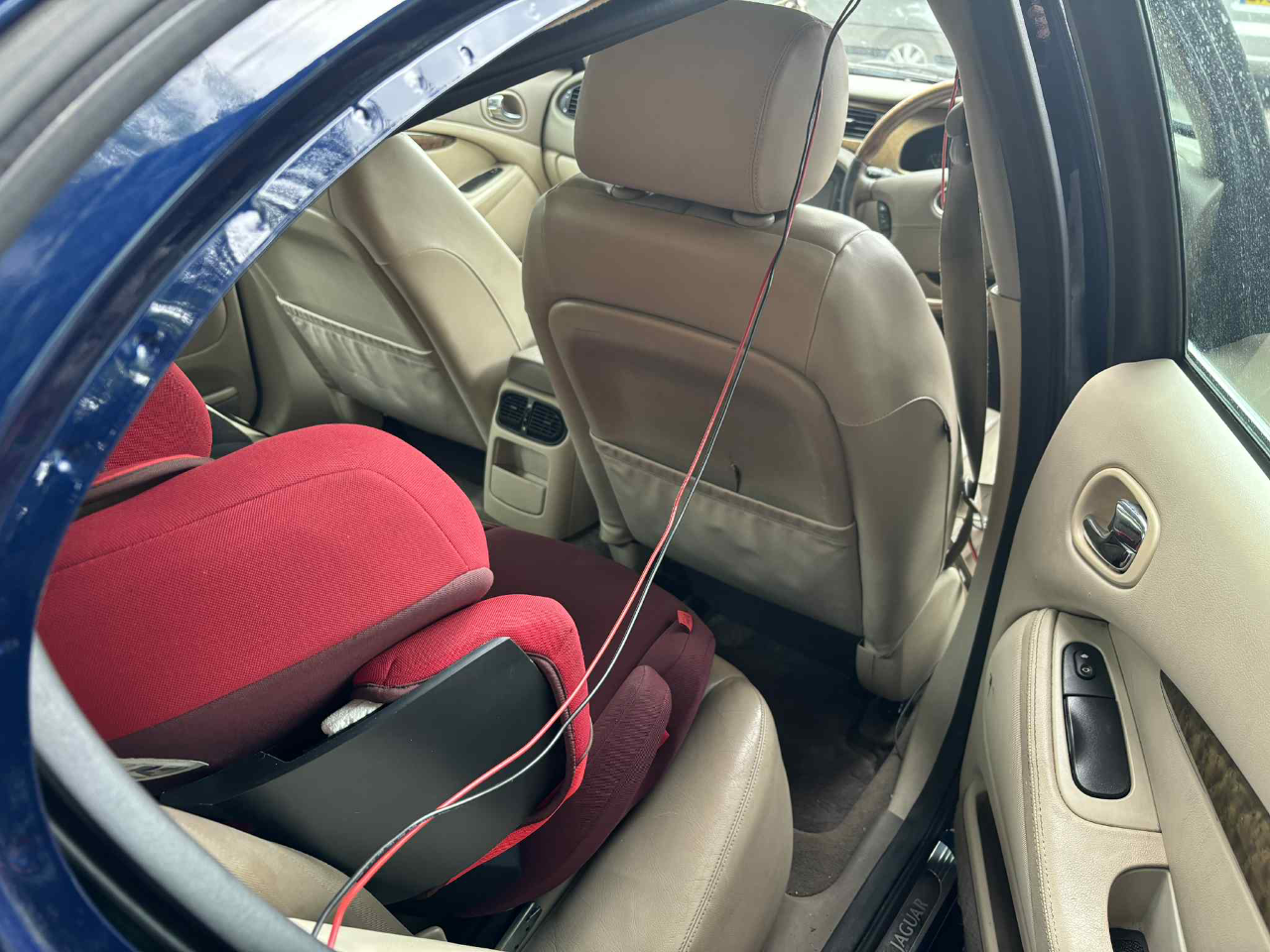

Further work has happened. Decided to remove that horrible reversing camera/old broken parking sensor wiring since the sensors don’t work anyway and half the system is missing…
Fuck me, the thing leeched EVERYWHERE.
Including my favourite part where instead of wiring the camera to the reverse switch on the gearbox, they wired it to the reverse light. So if the bulb fails, your camera stops working, great work there!
I’ve removed a literal armful of cabling from the car. As it was broken and half of it was missing I cut the wiring to the parking sensors to save me rooting around behind the bumpers. As the rear bumper is damaged anyway and the front one has giffer scrapes, I may replace these for units with OEM parking sensors and fit the full system if the car is a keeper. The wiring loom has all the required plugs for sensors anyway so it’s literally a case of plug and play. Car looks a lot nicer without that horrible square camera sticking down below the number plate plinth. And yes, the cheap horrible plates are going…

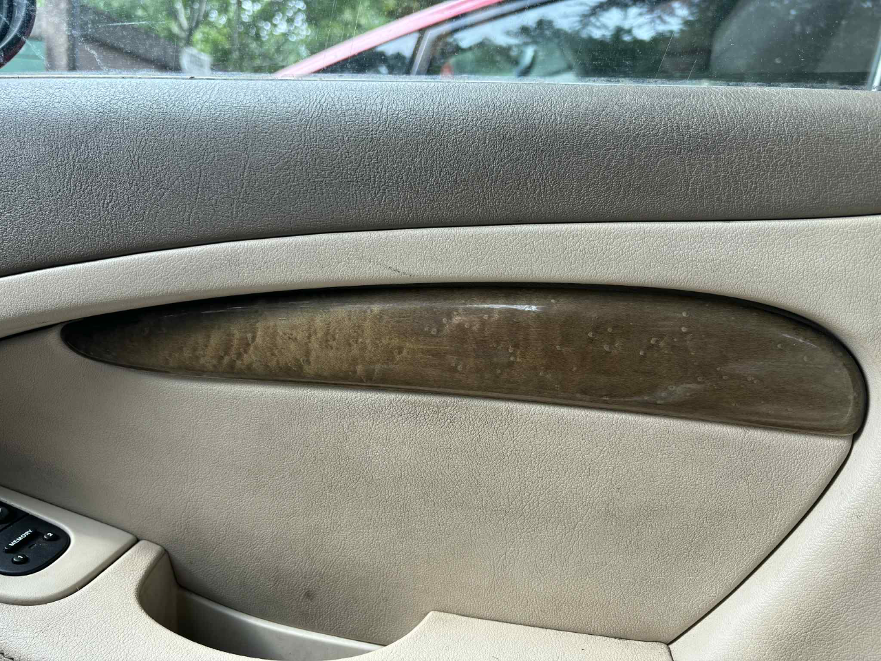

Now I can’t nitpick on a £300 car, but I’m nitpicking on a £300 car. The driver door wood grain is different to the rest of the car. I need to change this for my own sanity (lighter one is the driver door)
In for backboxes and a brake bleed tomorrow and hopefully then I can enjoy the wafty quiet comfort of a Jaaaaaaaaaaaag
I can hear myself think again! The voices in my head tell me this is a good thing.

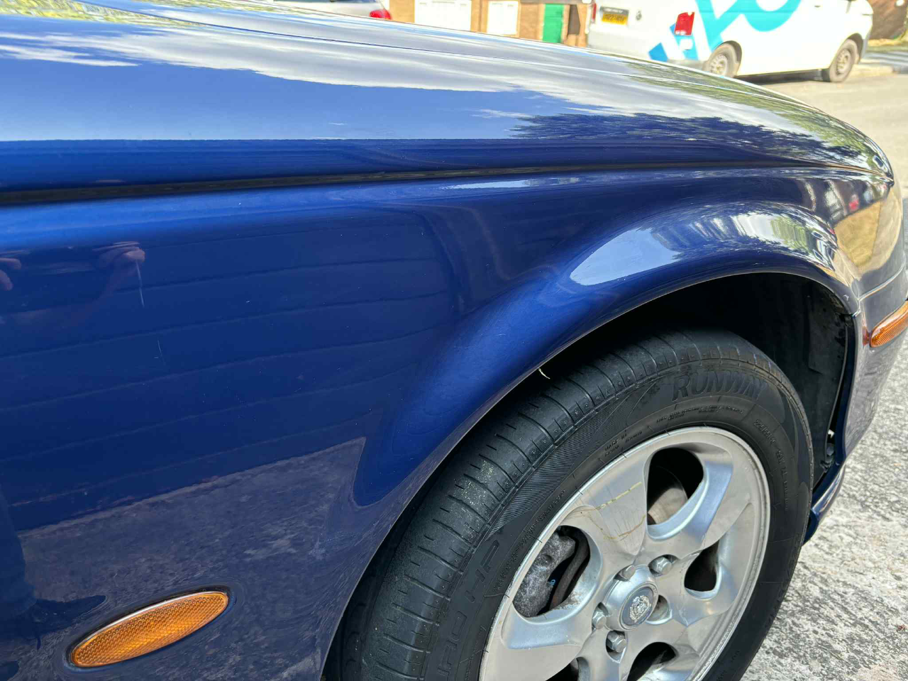

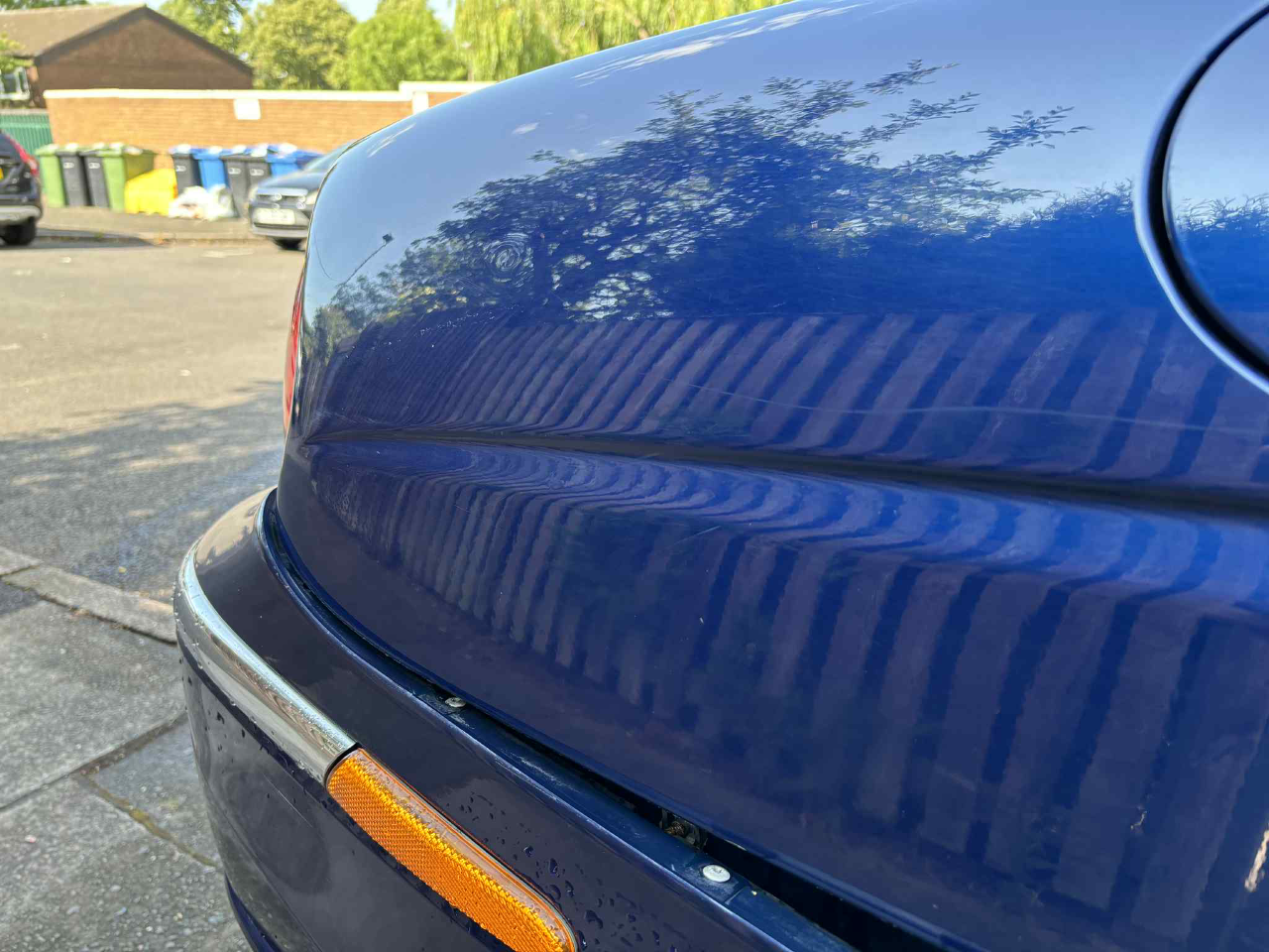

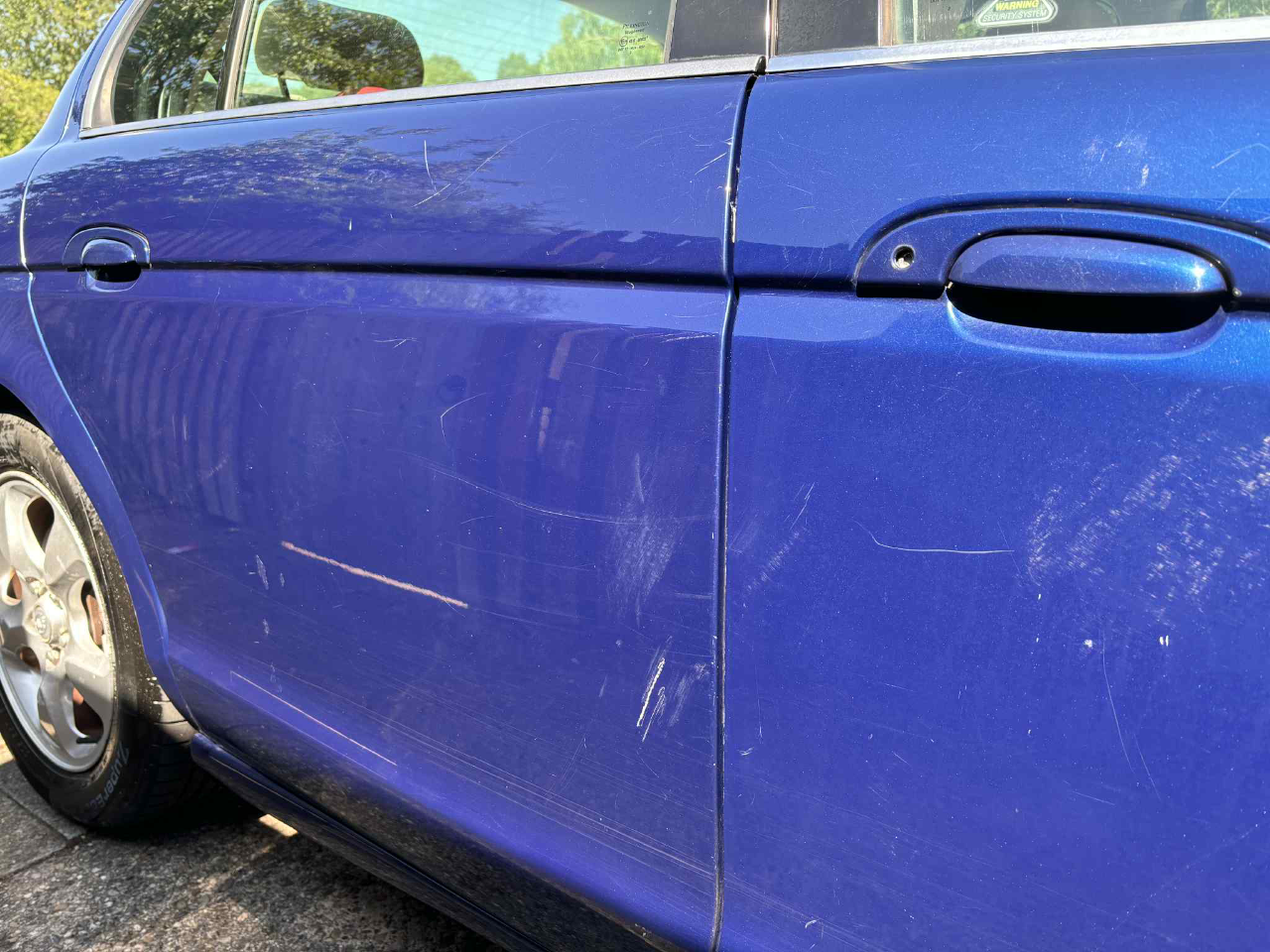

Washed car. Cannot unsee.
Anyone selling a door?
And aye the paintwork needs some love. It’ll get some before winter hits.
Thought it was worth a shot…
Little bit too warm though. The water was drying up almost immediately, however the car is absolutely covered in swirl marks, so on the panels I tried it did somewhat improve it.

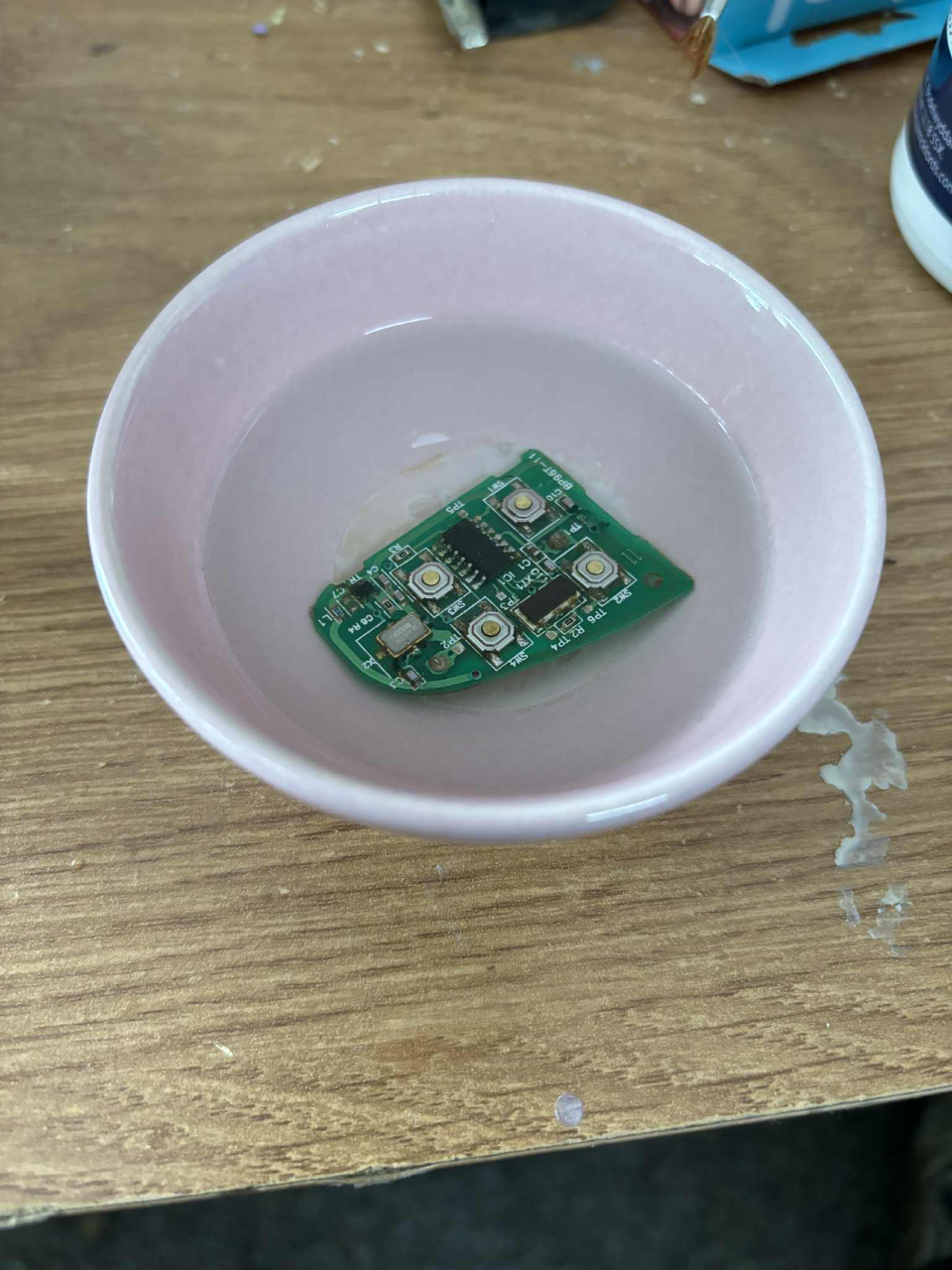

So what am I doing here? Why is the key fob in water? (Yes, work bench is a tad grim I know, but it’s a solder/repair/anything else station, gets a bit messy)
Not water. Rubbing alcohol. The fob doesn’t work at all. All the buttons are jammed. Gave it a bath and cleaned it all up, microswitches then pressed and worked, however they all needed re soldering. So I got on with that. All plumbed in… Still no dice, sadly. I’m wondering if I may need diagnostics to pair, or if the fob itself is just ruined.

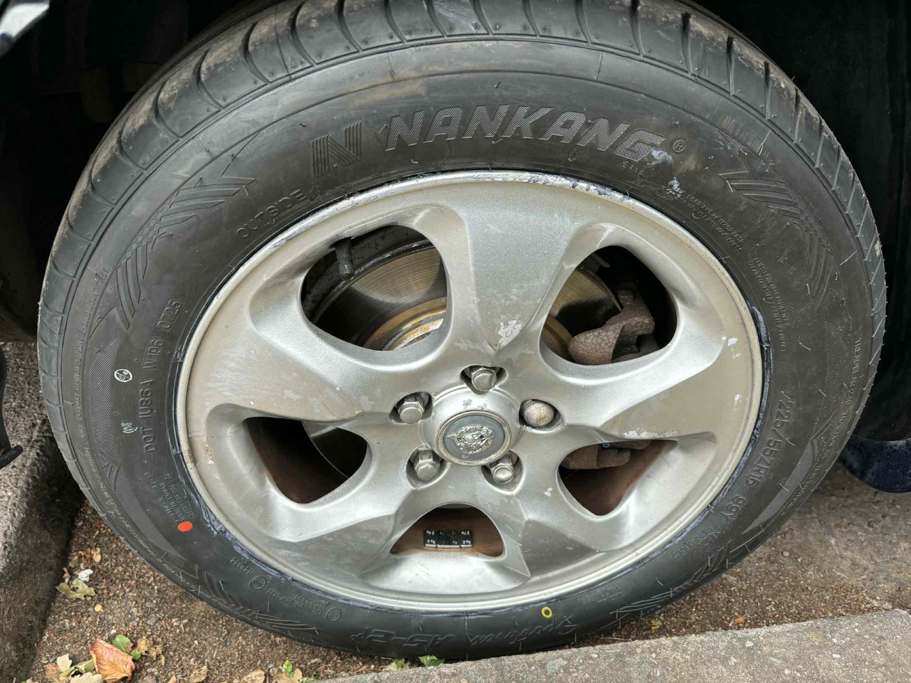

New rear tyres, £140 for both fitted and balanced from the same tyre place I got the tyres for the ZS. Not bad.

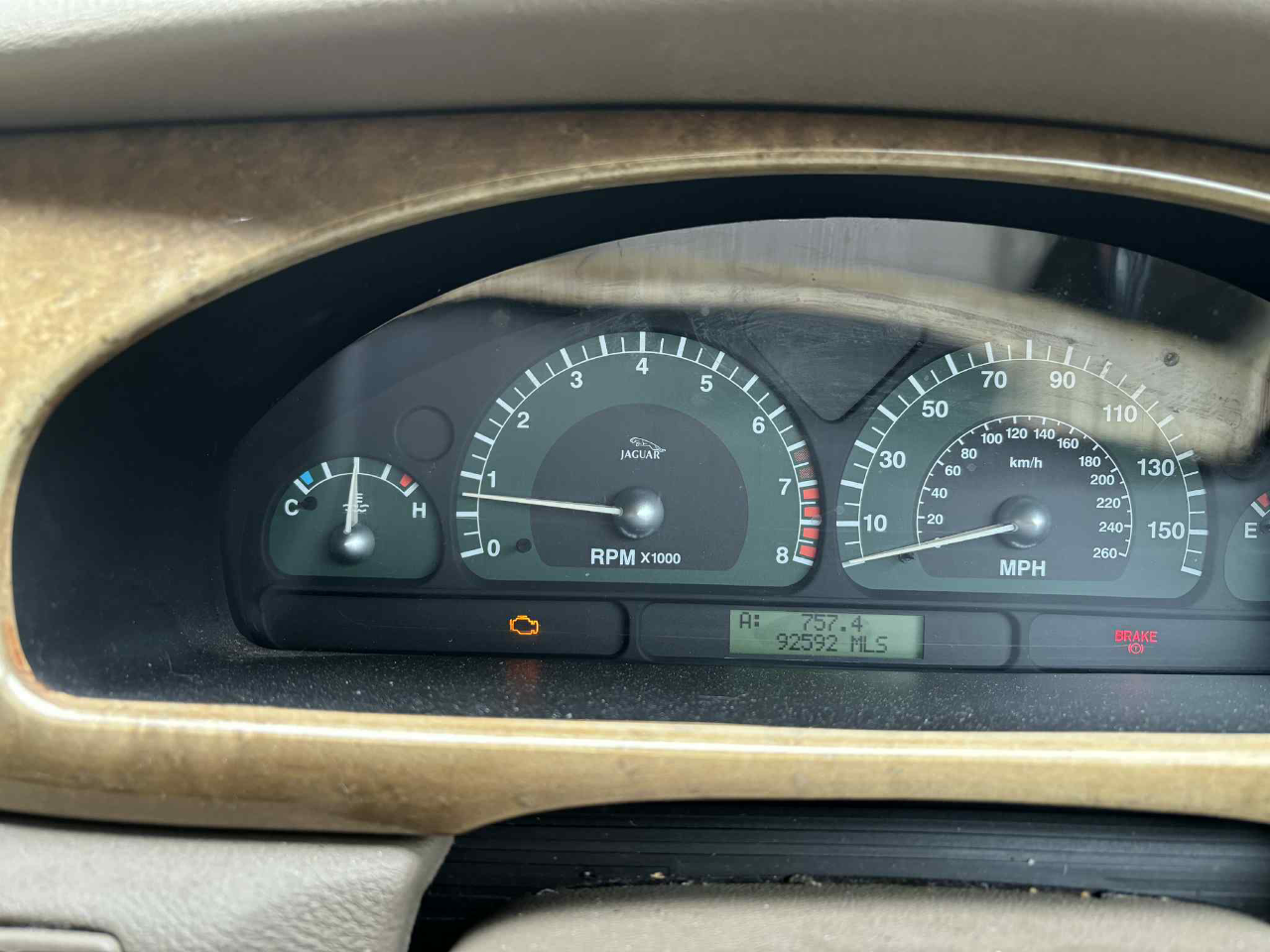

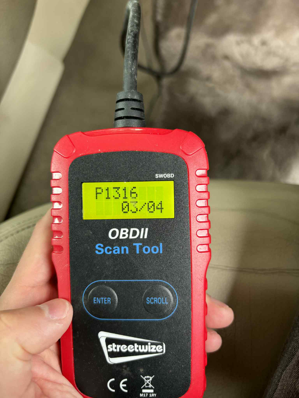

It decided to thank me for this literally THE NEXT DAY by shitting a coil and running on 5.

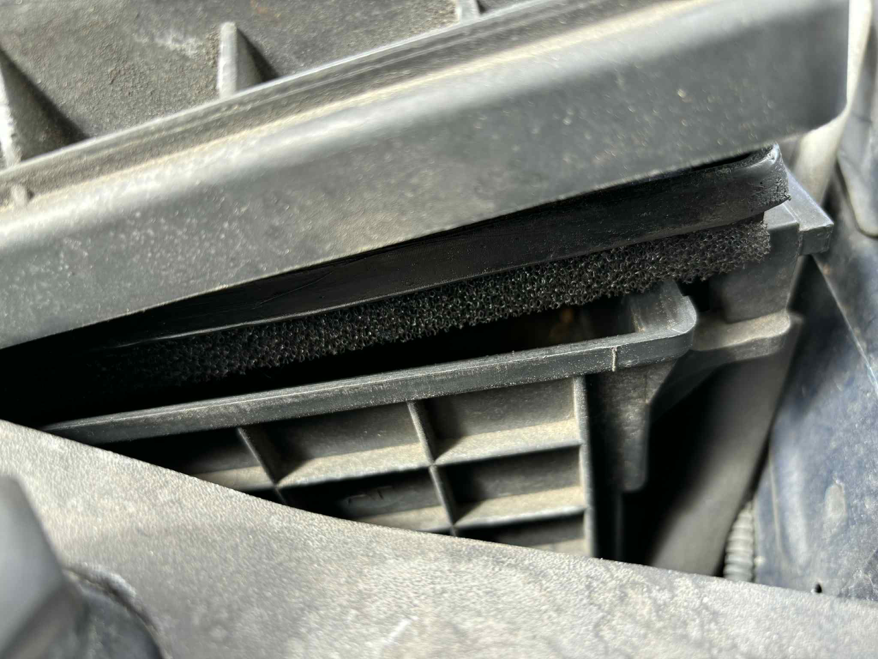

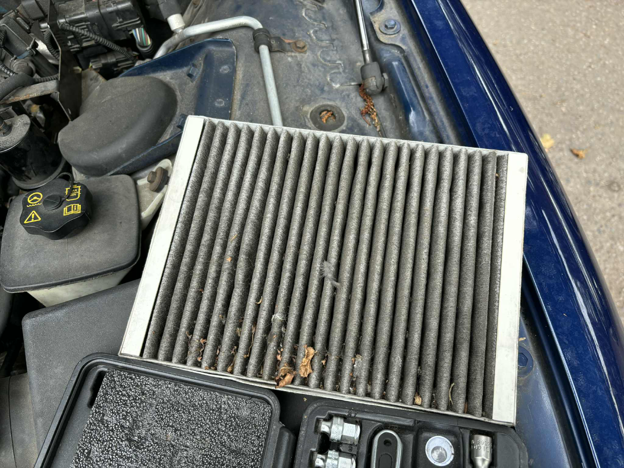

Didn’t have the parts anywhere so I had to deal with limp mode for a bit. While this was happening my new air filter turned up which was designed for the 2003 model year S Type. Yeah, fits great that doesn’t it?
Cabin filter also turned up. Thankfully that was a straight swap and based on the old one, it has been neglected for a while. I can’t tell if it was made in the 20th week of 2007 or July 2020, but either way, due a change:
A/C certainly smells a lot better now.

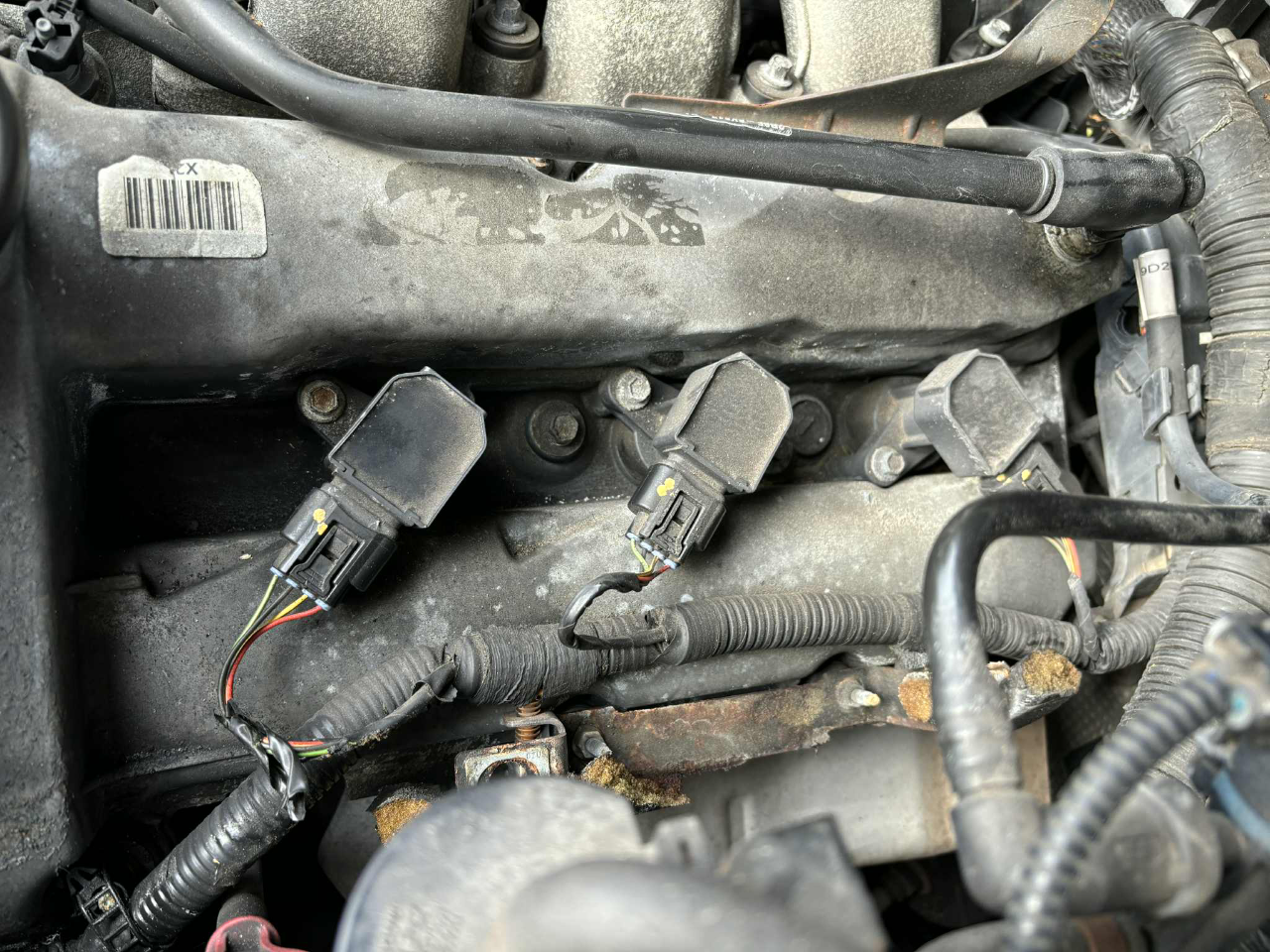

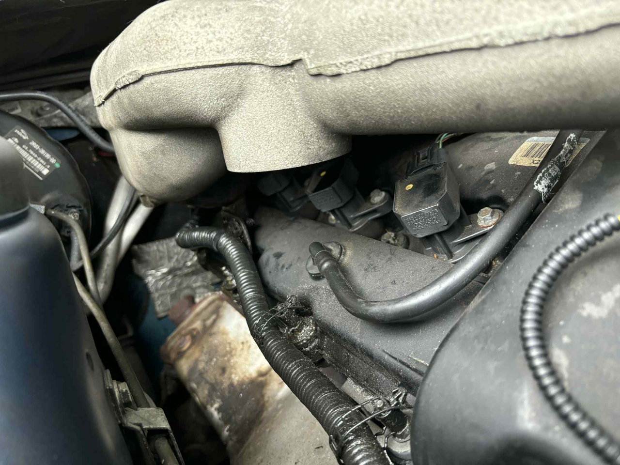

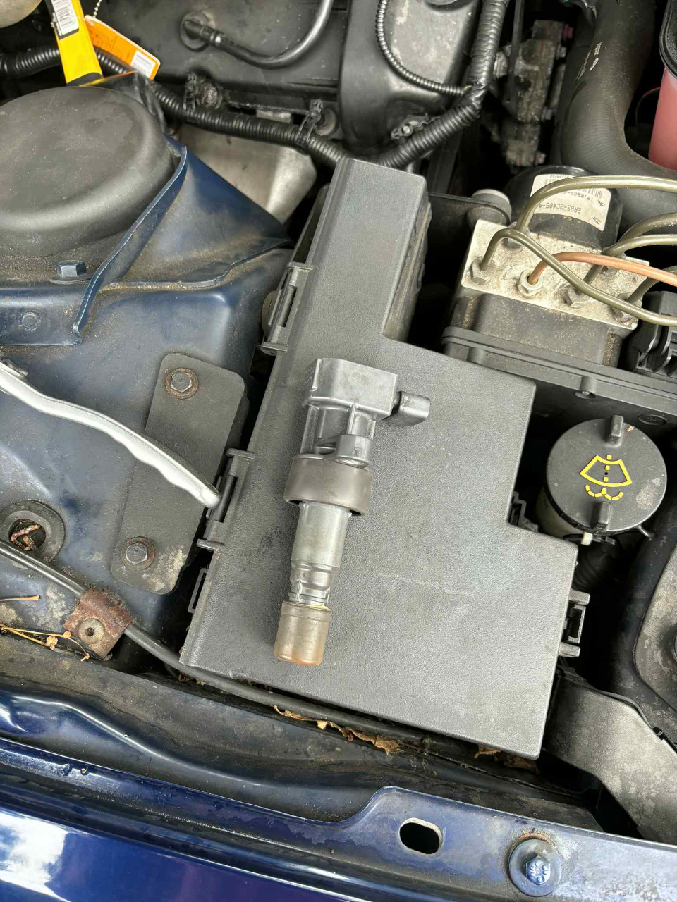

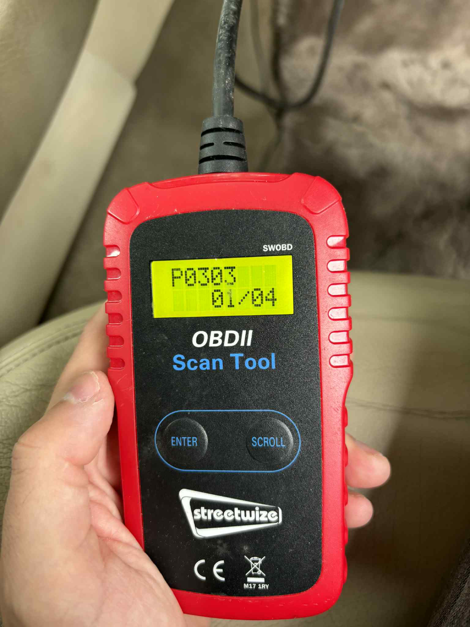

But. Back to the misfire. Managed to get a pattern part for £60(!!!!!!!!!) (not sure what I expected price wise, but last time I bought a coil it was £4 from a scrapyard, but that was a Peugeot 106)

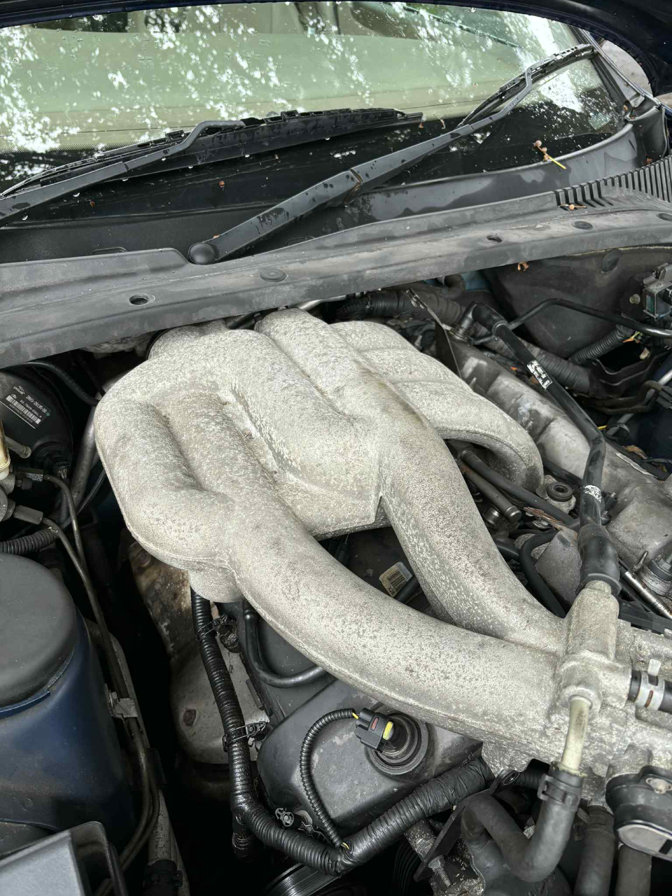

Then the pain began. So P303 is cylinder 3.
Looks easy right? Wrong. This is bank 2, that’s cylinder 2, 4 and 6. Bank 1, for reasons known only to the engineer that designed it, looks like this:
Who did this and why? Pulling the bolts out wasn’t too bad, until I realised there was a hidden one in the very back corner nearly against the bulkhead. So tight I couldn’t get my slimline ratchet in there with the 8mm attached, I had to blindly put the 8mm onto the bolt and then lever the ratchet onto it. What a fuck on.
Anyway, removed all that and then discovered there’s vacuum lines and coolant lines that go through this manifold (FFS), so I decided to get creative.
This is the most room I have to get a cylinder 3’s coil (middle one):
So, I got a hammer and used it like a pry bar to give myself a tiny bit more room:
Just enough there. After wrestling with the plug on the coil for a bit, managed to get the old coil out:

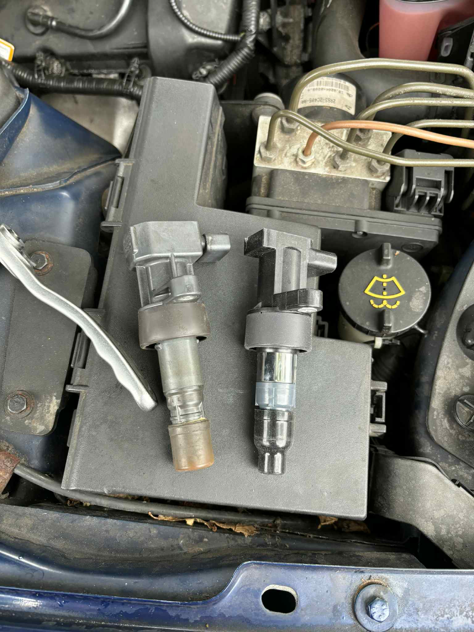

New one against old:
In, and codes erased:
Normally I’d not do an update for the sake of a coil but what a fuck on that was. Christ.
