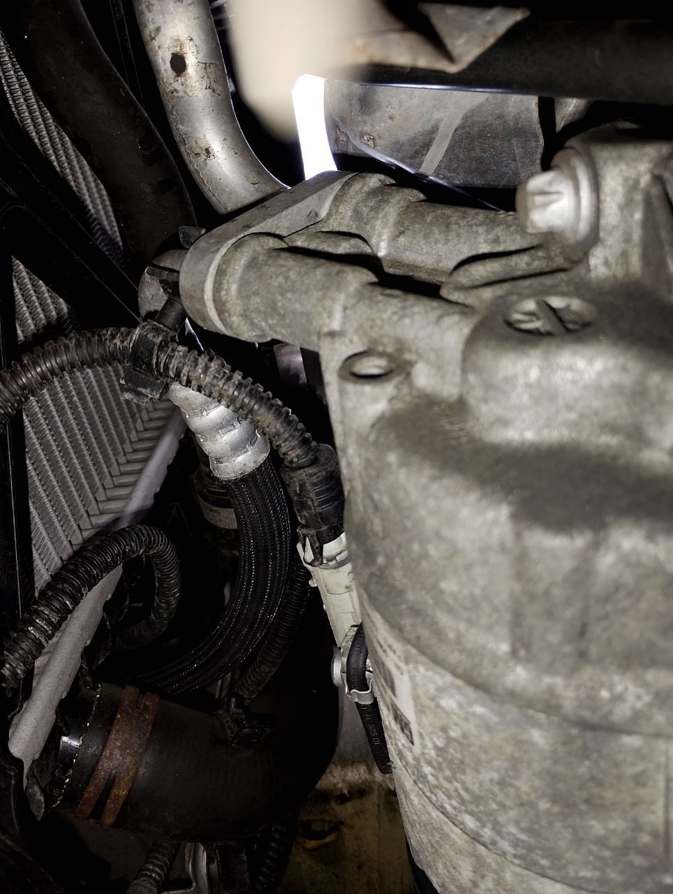

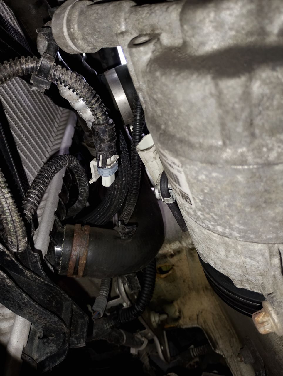

Today, I will mostly be....

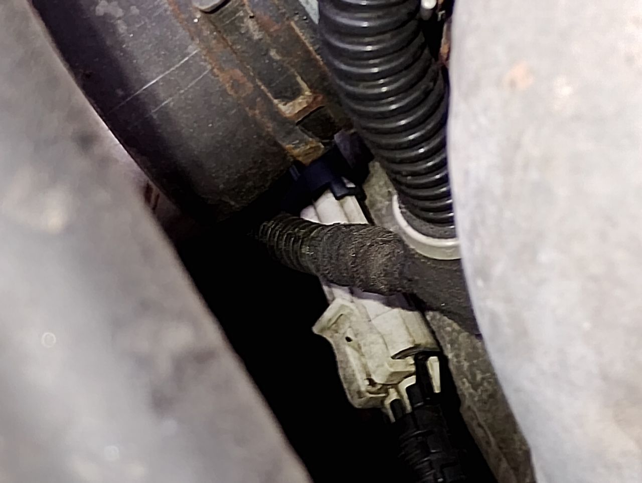

Unplugging/reconnecting the A/C clutch cable connector......
...... in the vain hope some jiggling will recommence elekterrifikationing 🤔
🔧tally-ho🔧
Well..... That was 20min I'll never see again 🫤
A skinny armed 10yo would struggle access from the top....
So >> up the ramps.... Unplug/reconnect X2
Not A Flicker 🙄
#cheap *fixes first, eh.....
I suppose I missed a trick = connect a bulb into power side and run engine/AC to see if we got 12V ... Ah well...

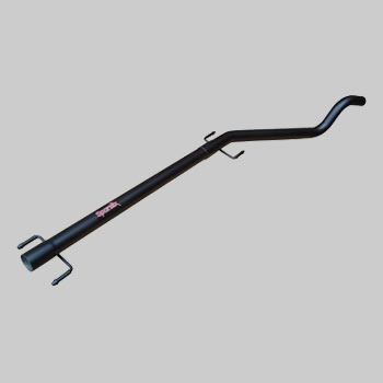

New CAT back pipe [for leaking]....

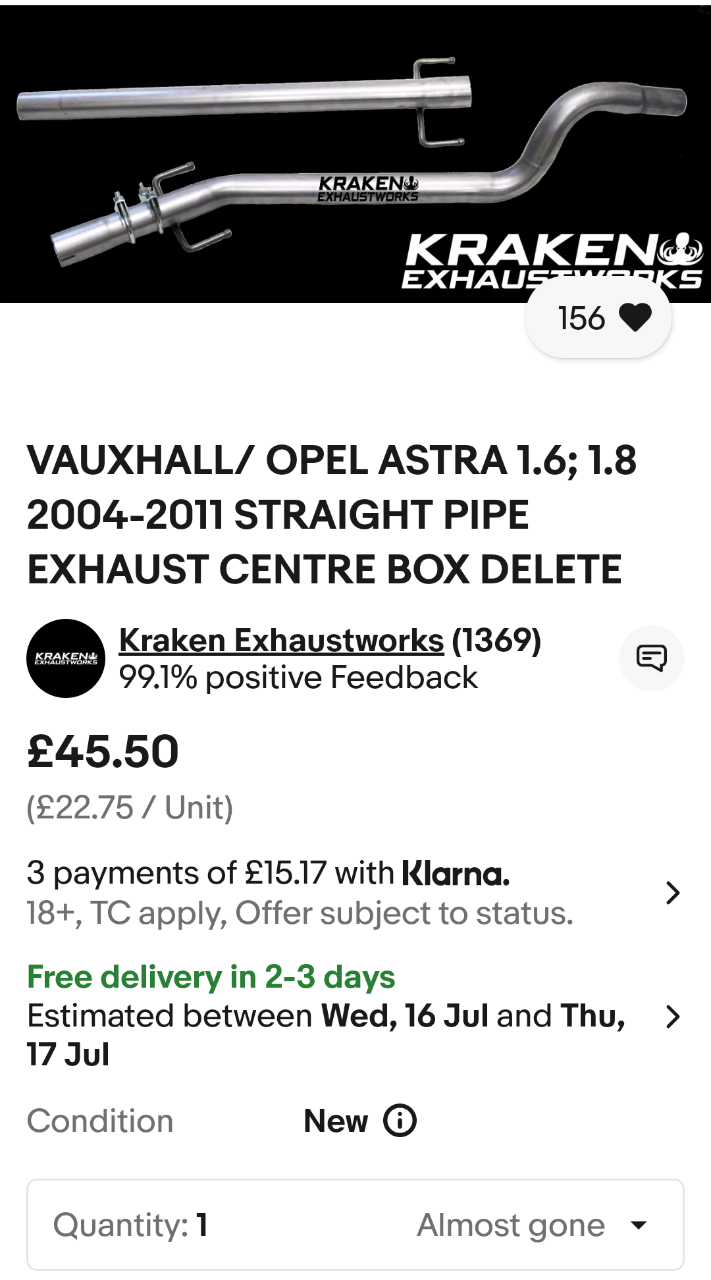

A little while ago my 'tame' spanner man fitted an eBay back box ....
Now... 🫤... we have a blow at the CAT back/secondary box pipe section join ! The only piece of Ex that hasn't been changed.

I'm fairly price immune AKA if it's $hit then I'll get a stock 2nd ex put in...
eBay confirmation delivery 16 Jul.

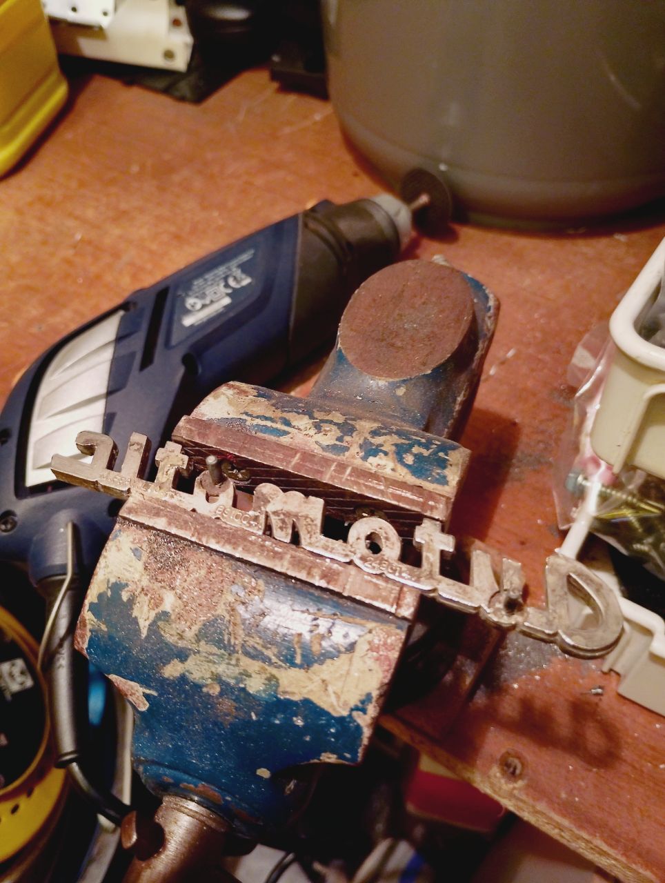

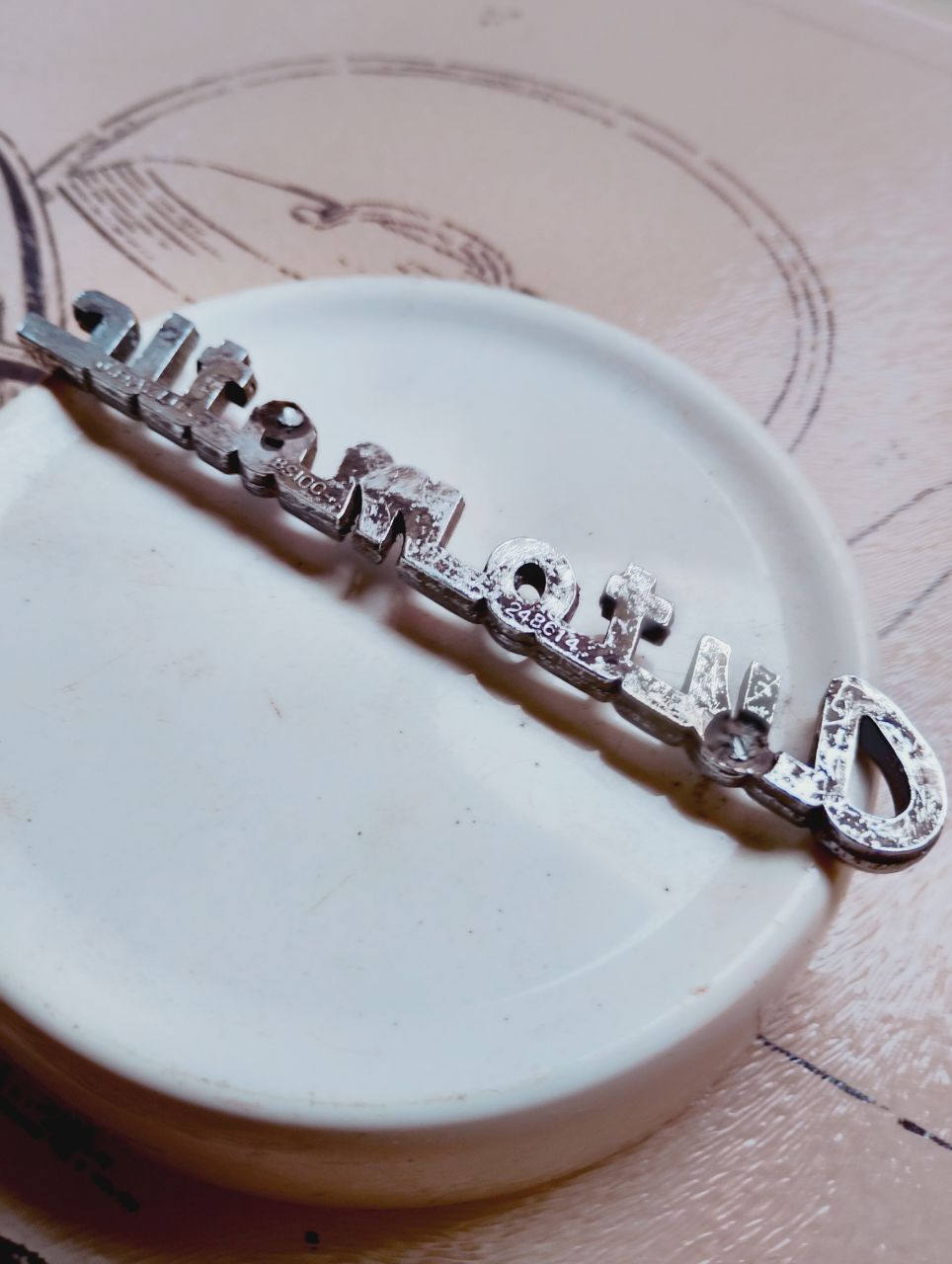

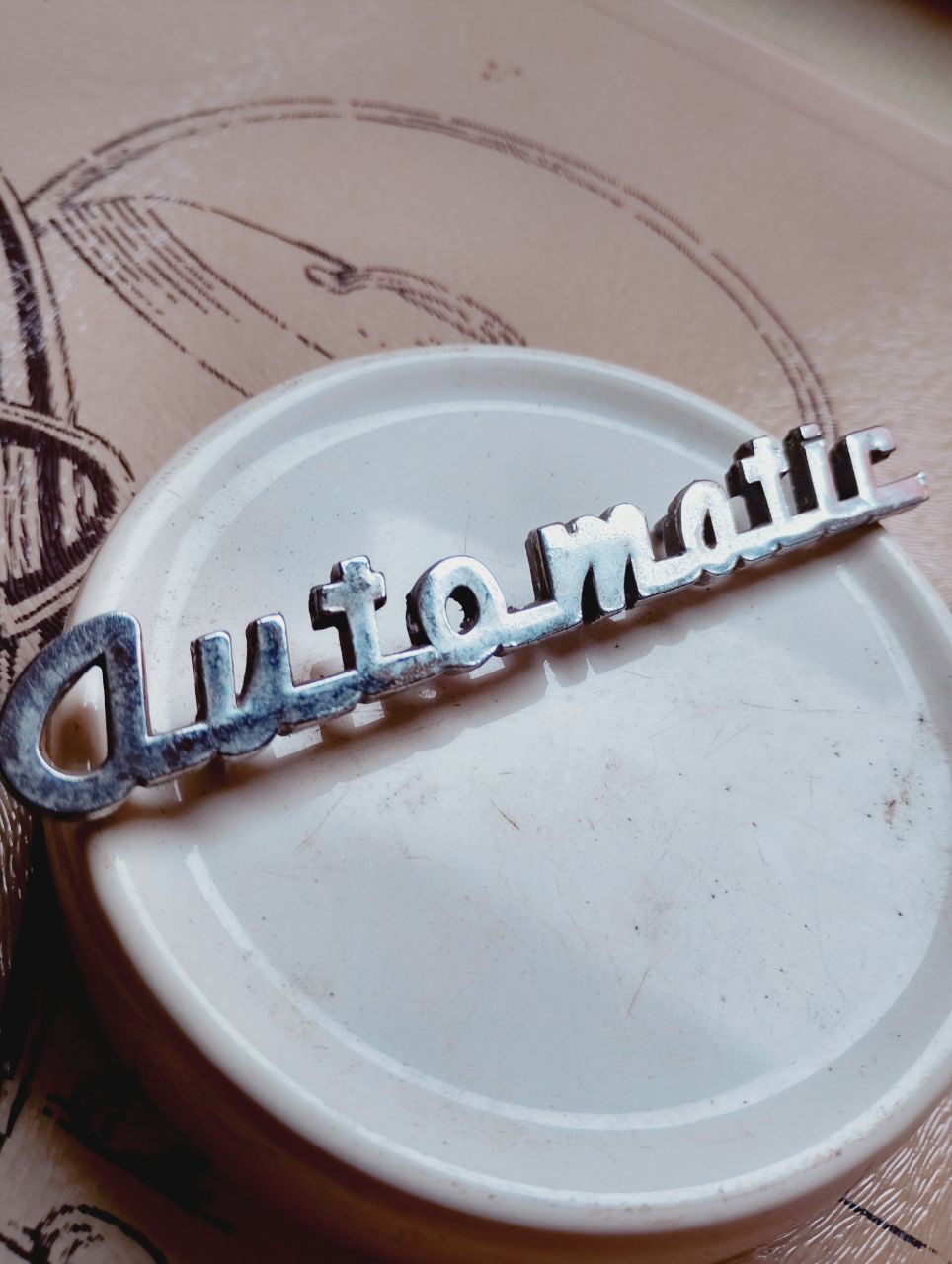

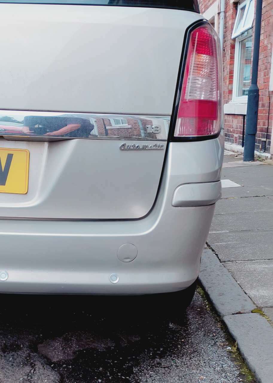

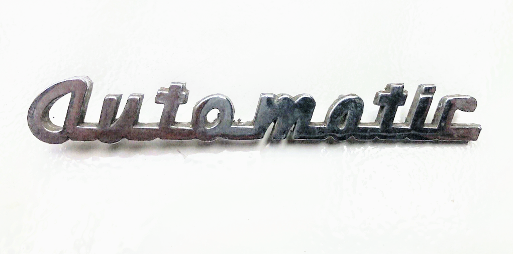

My *cheappo AUTOMATIC boot badge is beginning to delaminate.. paint flaking off 🫤
.... This @£5 should do another 40yrs 👀

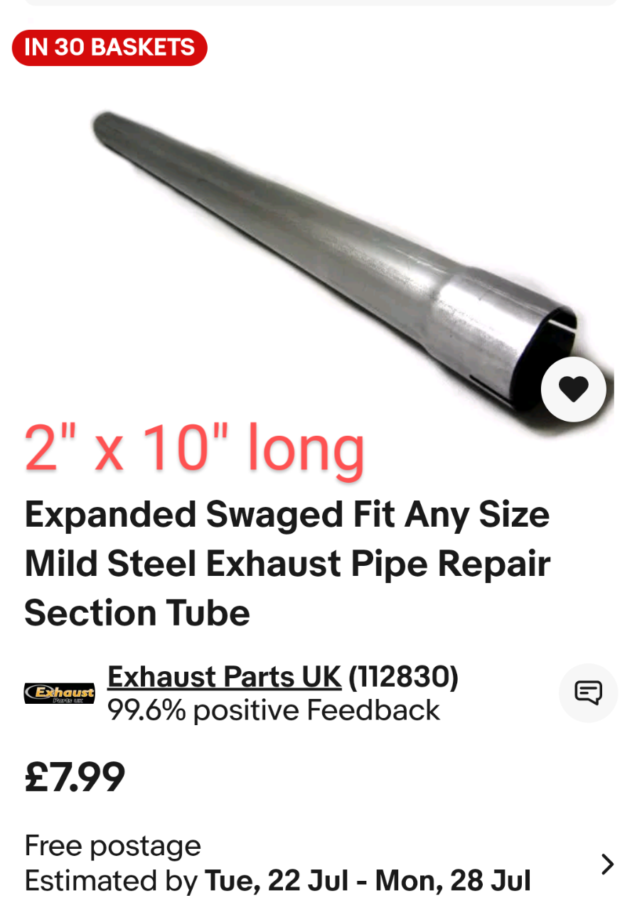

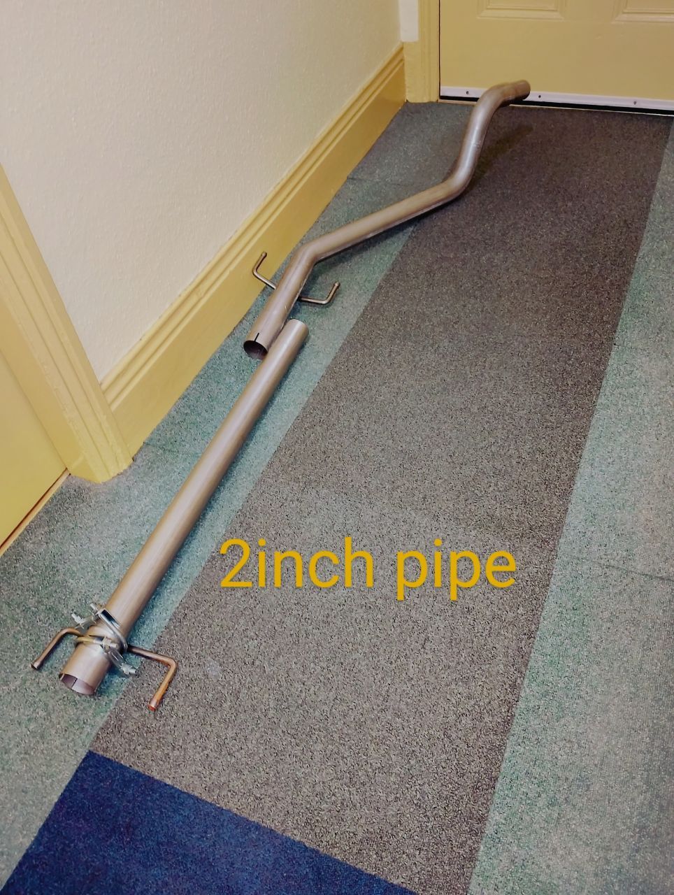

Pipe arrived.... 2" od.
5 days rain on the horizon so no working outside...
Mainly I need to mock the new pipe against my Estate pipework to ascertain where to 'snip in' the missing 7 1/4" of wheelbase 🤔
Like a challenge, does I 😋
Just sorting the 'tweak' bits....
This just covers all bases 😉
Because *simple tubes.... 🛠️

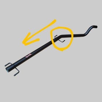

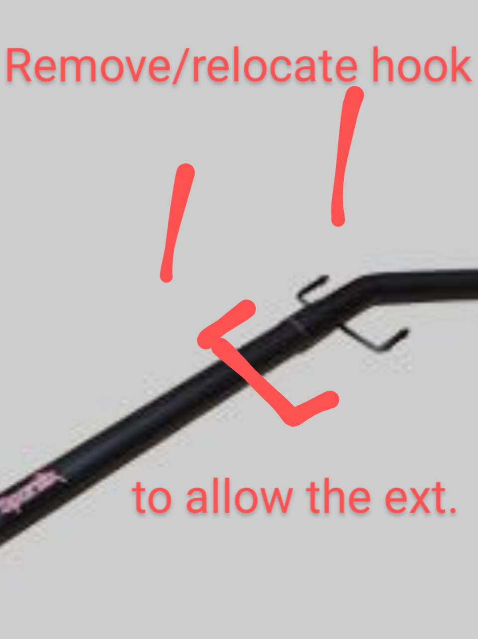

With my extension tube [10"] I can shift the rear axle kink along the floor.... But any change causes the pre fitted loop brackets to move apart = not good.
Someone on here demonstrated a *bodge fix, using a U clamp, to replicate a rubber loop bracket on a section of exhaust... I looked + learned!!
Once everything has been spaced out, to Estate dimensions, I shall fix that second loop clamp - using the fix described, having cut off the original 👍

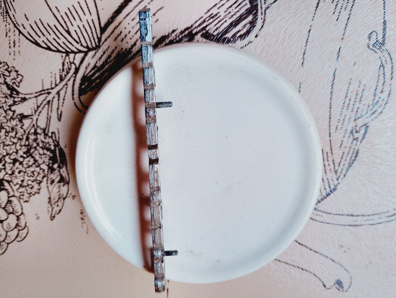

My Auto badge just turned up.... Excellent condition 😍
It is a press in/plastic grommet mount type
.... Pins gone 😮
The gel 'hi tac' adhesive is now in place, after total degrease....
.... awaiting a dry day to stick on 👀

I'm actually somewhat confused about the 'section' found too short.... I imagined (with the rear axle moving further back, rather than as saloon) the standard over axle pipe bend would be the issue NOT just a fix by lengthening the back box pipe 🤔
We will see 👀
AUTOMATIC for the people Savvy ♥️

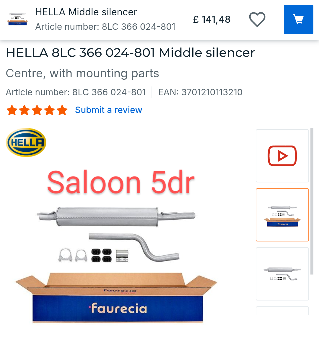

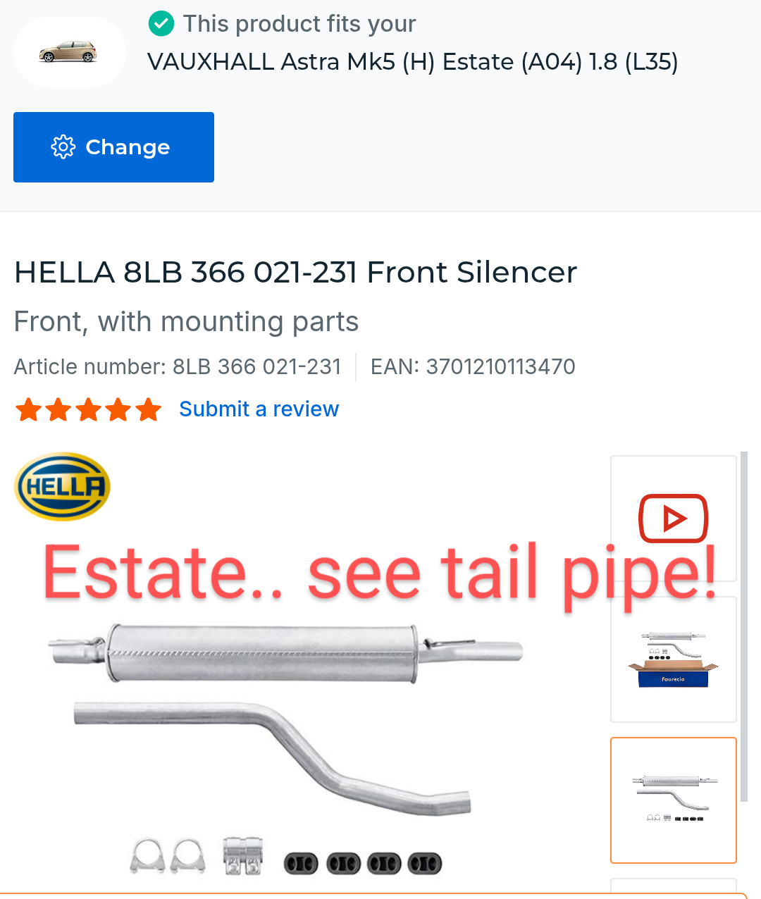

Finally extracted a like-for-like piccie...
Saloon
Estate
Looks to me Hella sell the *same centre box BUT two different lengths tail/axle pipe...
That is how I imagine my lash-up will be fitted 🛠️👍
