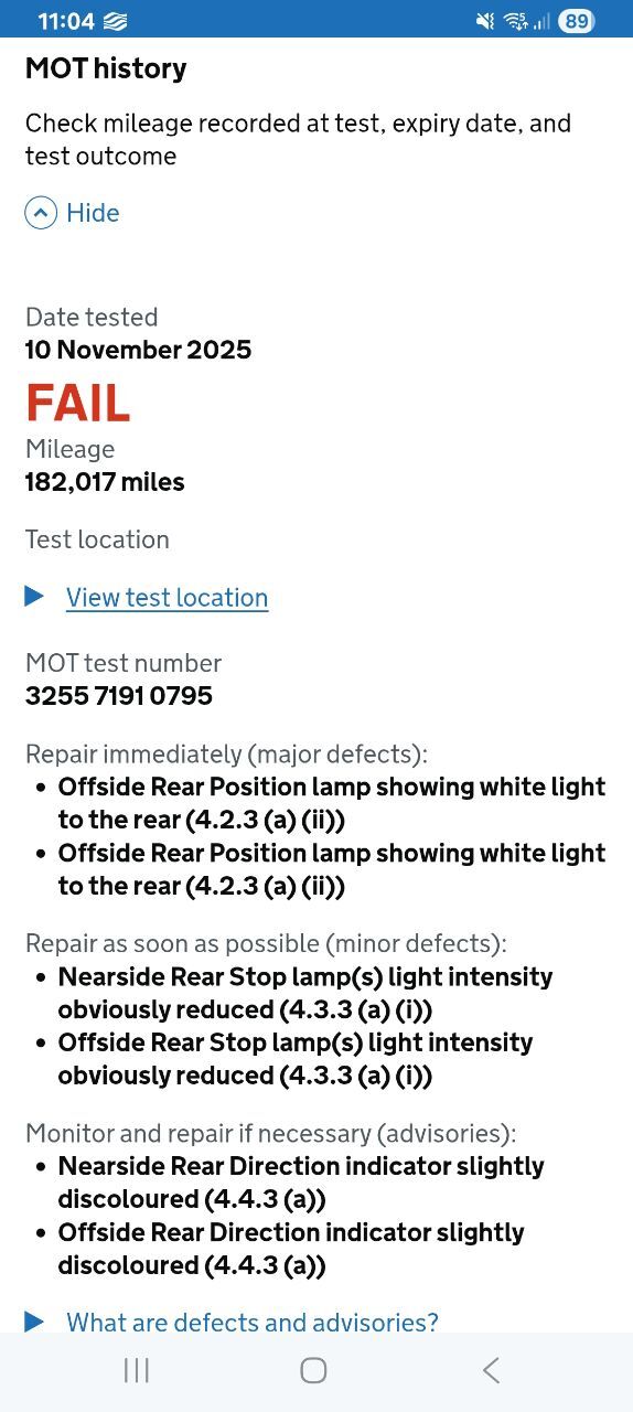

Went to a new place today:
He said they are very pale.
I think its the lights from a Supercharged model which it came with that are faded. I have the originals, some new bulbs and we should be good to go.
For a 21 year old Land Rover, that's bloody good going, happy with that.
The test fee is also only £40.

Quality result on the MOT!
Fitted the old lights again. They are a bit fucked but they do work. I also prefer them ten times over to the clears (anyone want them for £50 lol, theyre in decent condition but will obvs need new bulbs).
Also, every nut and bolt I or a mechanic has undone on this car has been greased by whoever was there before, even the 10 mils that hold the lights on. I'm going to presume the previous owner James so thank you for that!
I'm bringing it down to the test station again tomorrow morning hopefully for a Pass!
Because I did all the lights I now have a Pass with no advisory items.
Someone is coming for the old lights this evening so for the first time ever, I should actually be up by some money after an MOT!
