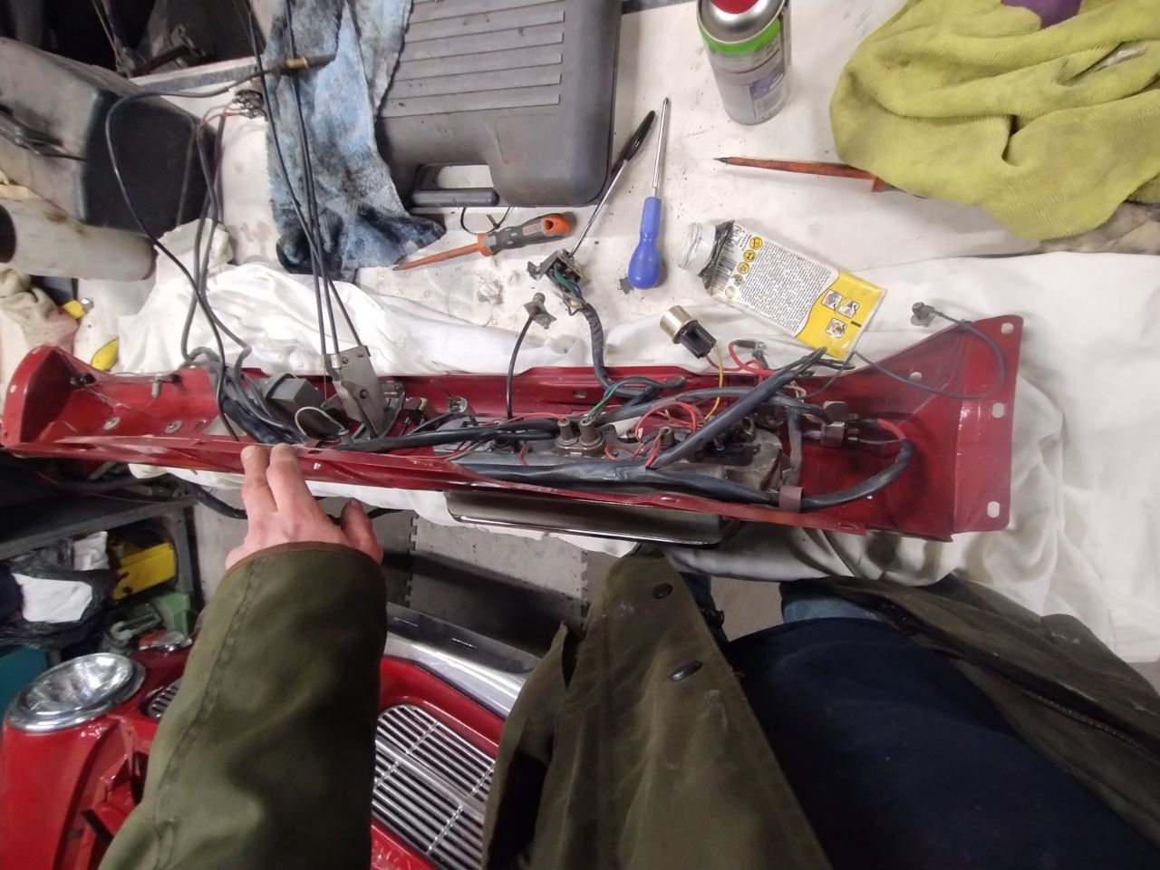

I've had my head down trying to get this job jobbed. I've had the car for two and a half years and I want to drive it now! The wiring is now complete with the exception of an earth to the rear number plate bulbs (this can from the body originally but I haven't the heart to scrape away the paint). I have added an earth to the rear lights as well for the same reason, replaced the relays with modern equivalents and installed a bladed fuse box. The indicators have started hyperflashing after initially working ok - both directions are the same. Time for a new flasher relay? Bulbs are traditional fitment and earths are good.

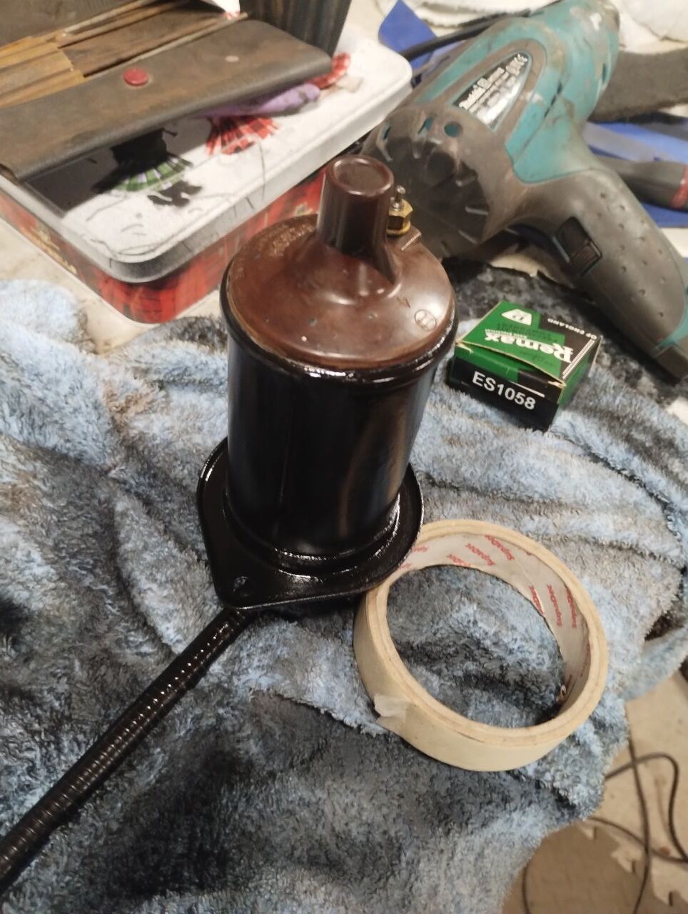

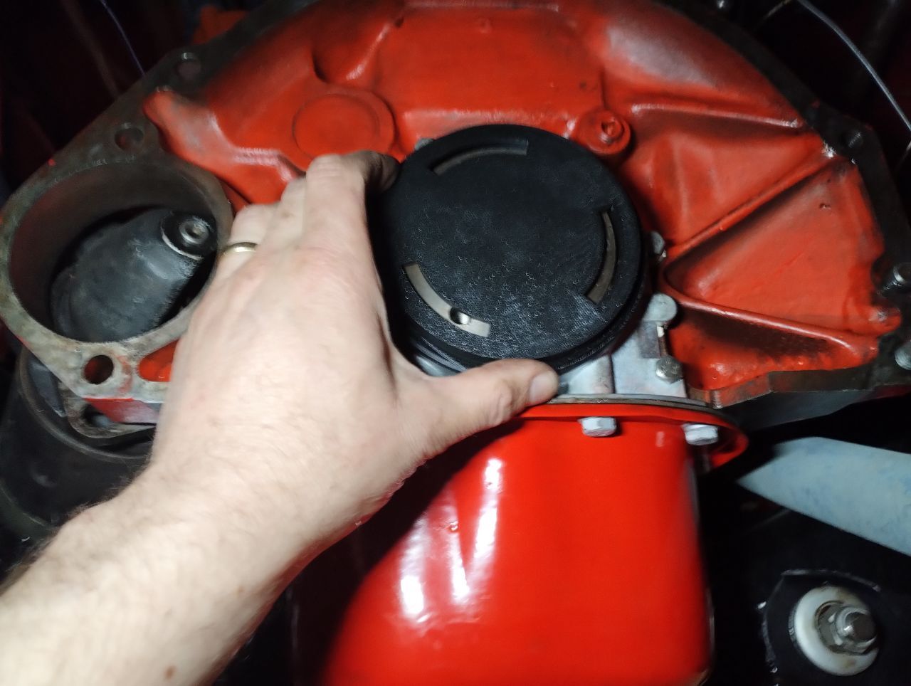

The original coil has an armoured cable back to the ignition barrel which I guess was a security measure back in the day. 60yrs old bosch coil? Yeah, reckon that'll be fine. I also took the dizzy apart and found it to be in great condition, so that went straight back on.

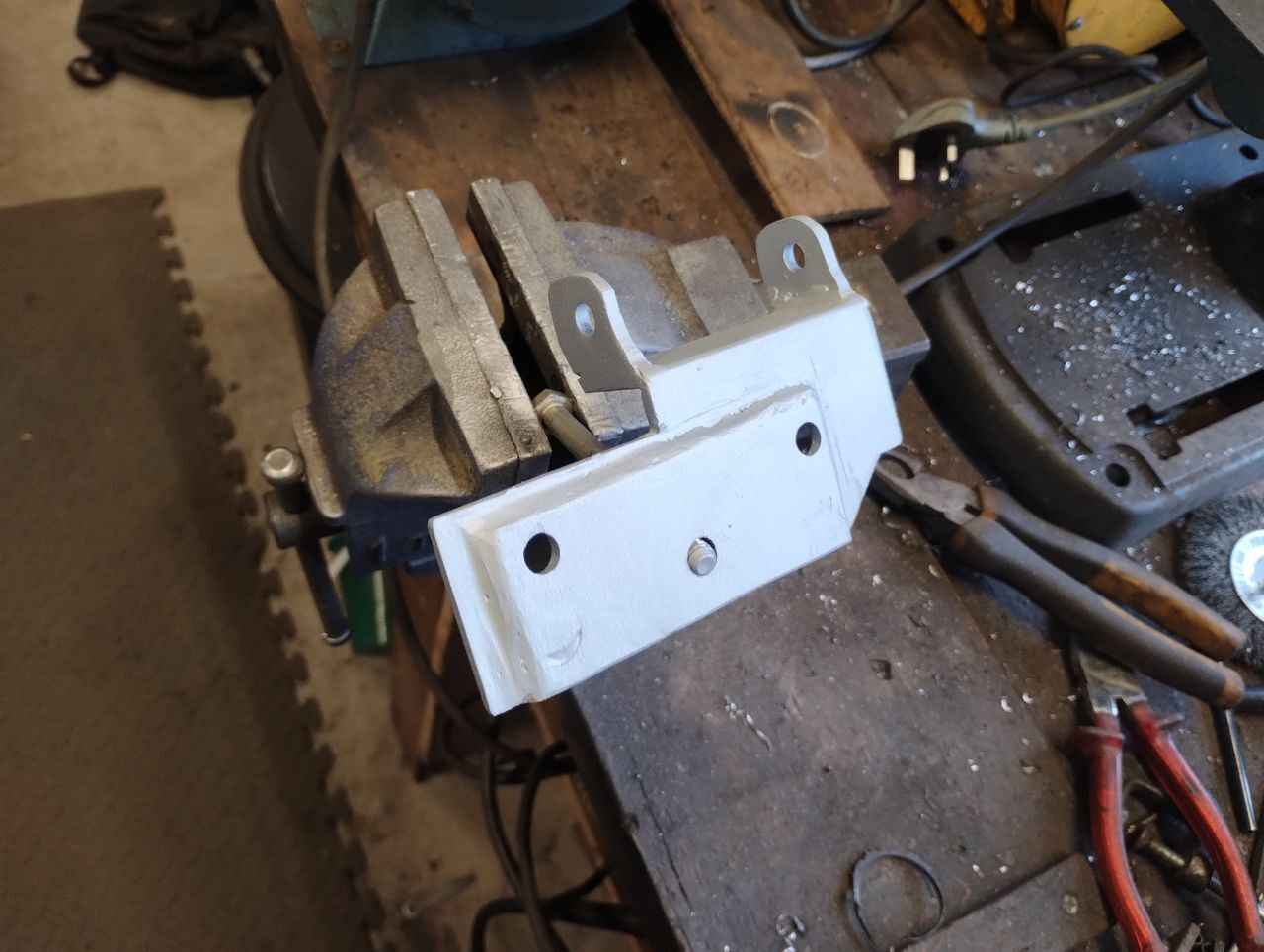

I've also put a lucas style alternator and I'm glad that @juular had a go first! Made myself up a bracket, painted it, then realised that the earth was via the bracket. Paint off and then cold galv spray for attempt two, and I added a spacer to the back helping a 900mm belt to fit. Worked well. IMG_20260313_163518592.jpg.5c1e3b4686e32e8eeb6769a7bd120cdc.jpg

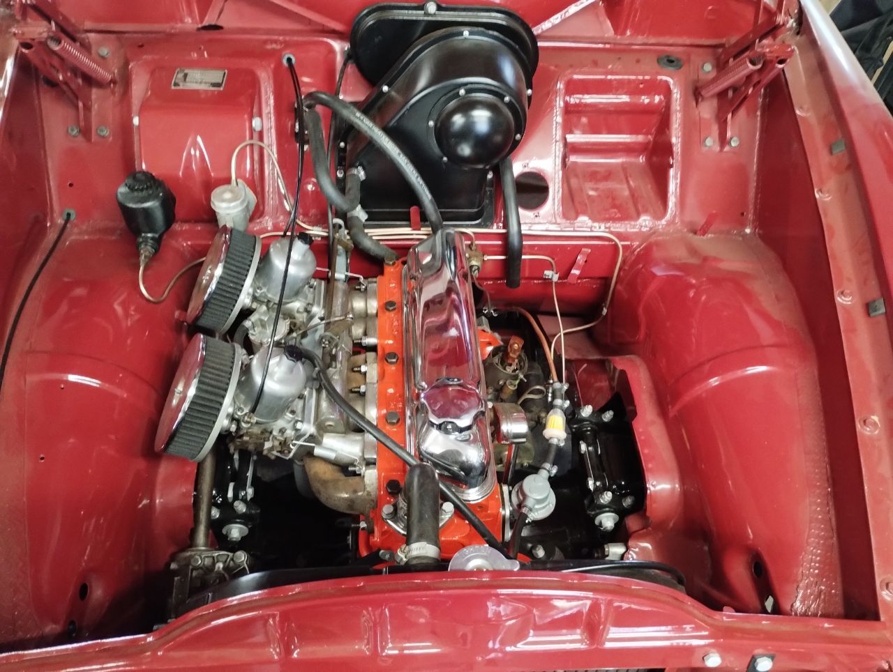

This is a great photo. I could stare at this all day. It was taken a couple of weeks ago and the bay is now complete. It would be rude not to try and start it! It took a while for the fuel to pump through and I knew that the car was only very roughly set up, but the oil pressure light went out quickly and it coughed into life! No nasties from the exhaust either. Bloody result that. It is tuned and balanced a bit more now and is sweeeeet.

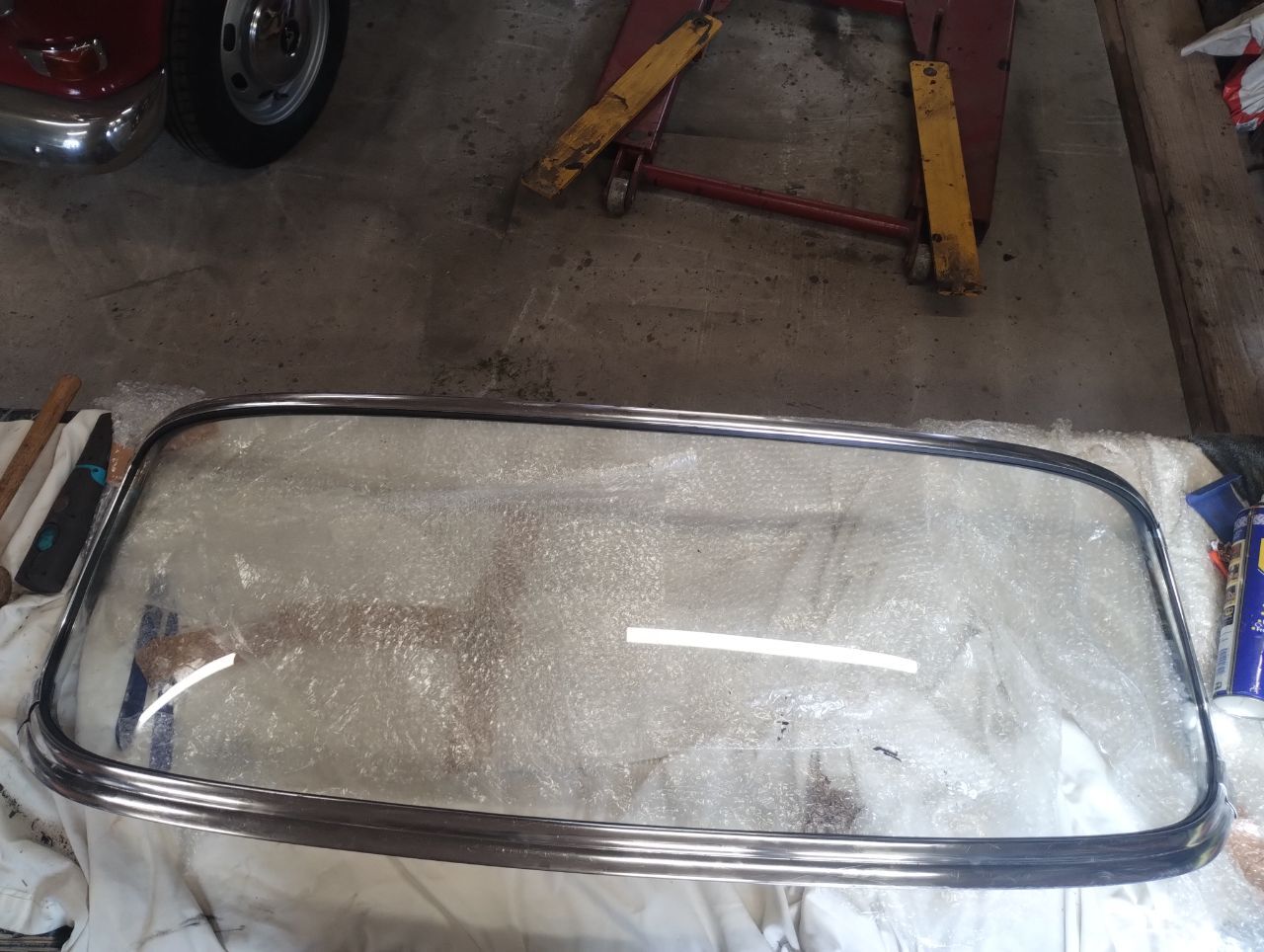

Had a go a fitting the front and back windscreens. They went in fine, even with the aluminium trim attached, but there is a gap between the seal and the body behind the face rubber so am going to have to put in some non-setting sealant. Any tips gratefully received.

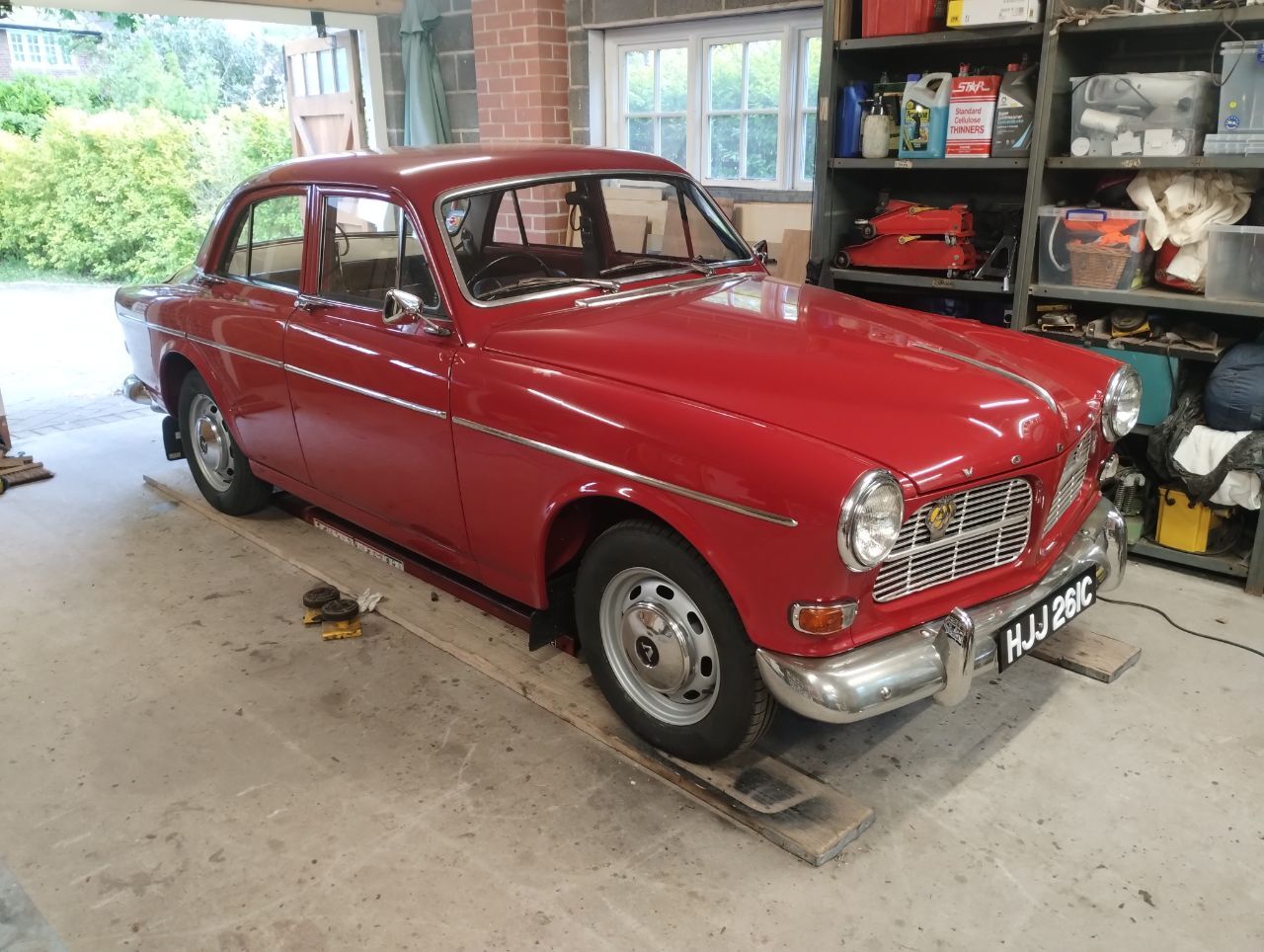

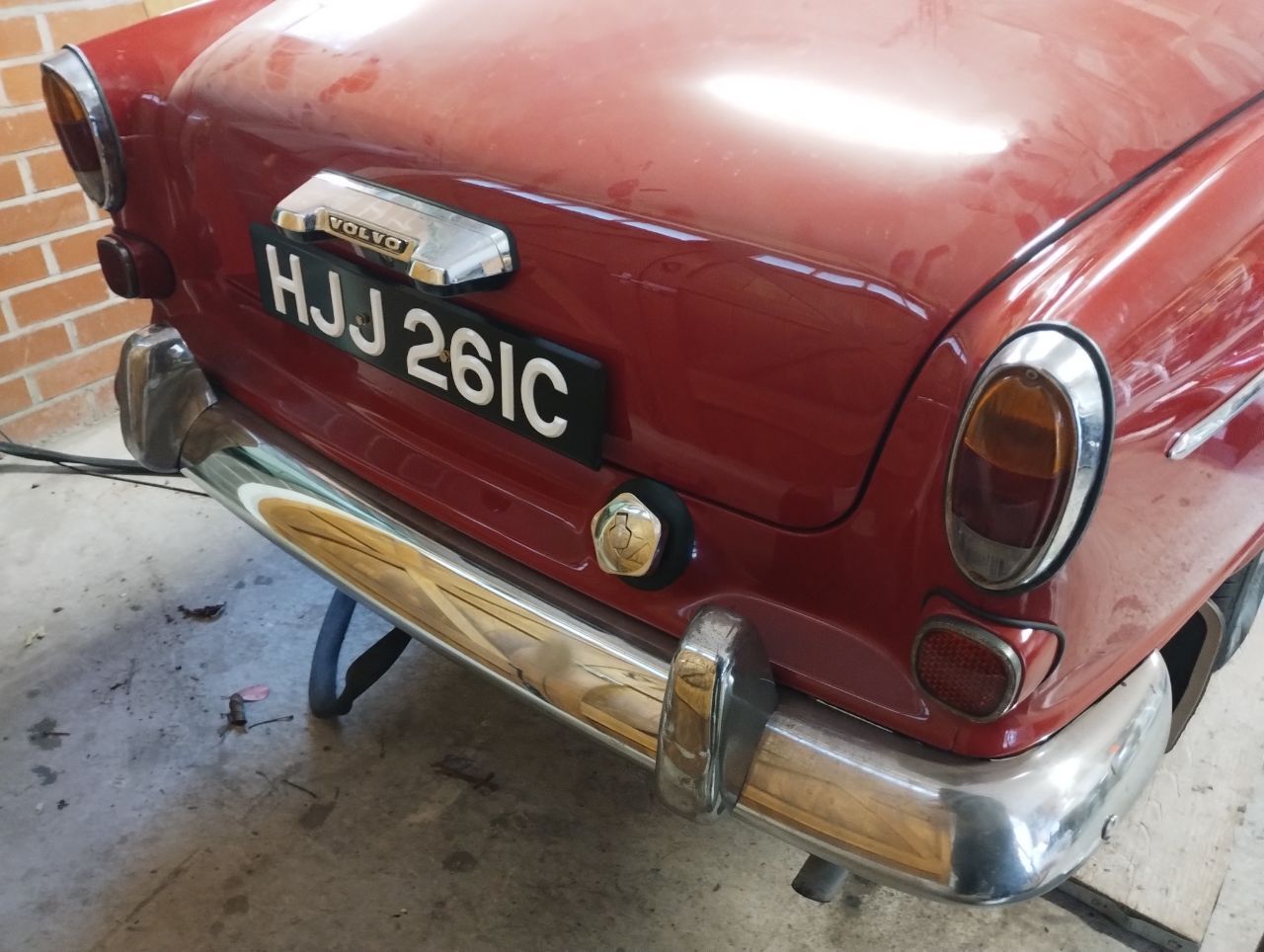

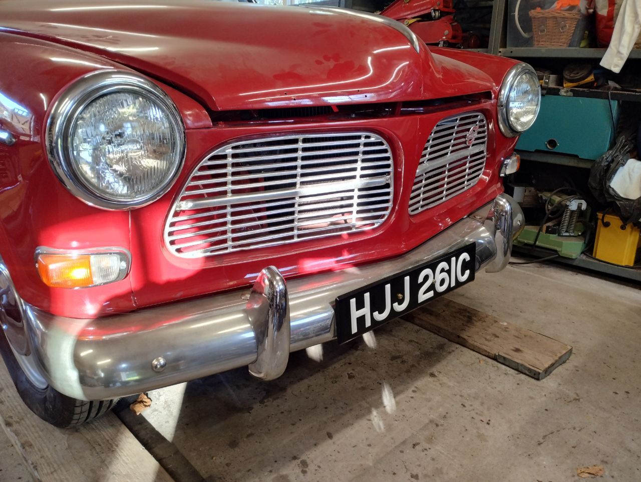

I'm working on the interior fitout now and the end is in sight! Fitted the number plates today. They look the business!
