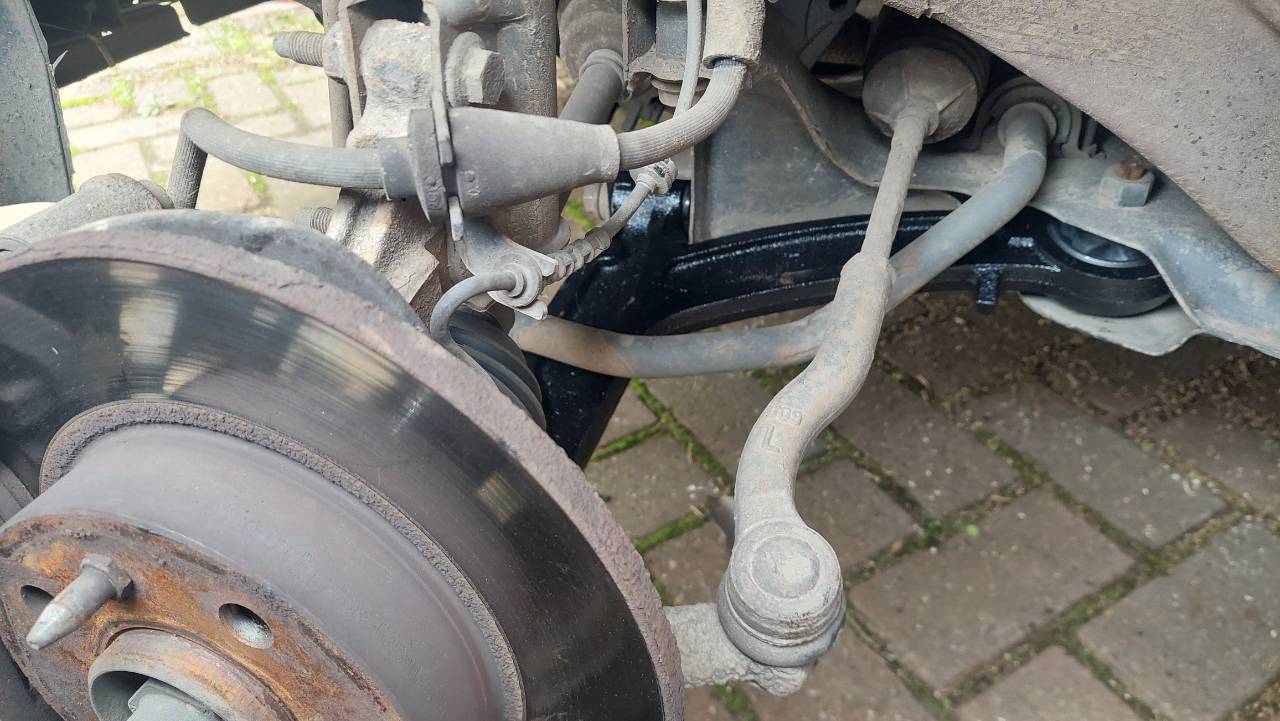

Well the pointy end went OK, with just a worn antiroll bar linkage to deal with.   a dose of lubricant and working rhe nut back and forward with the windy gun soon had it free.

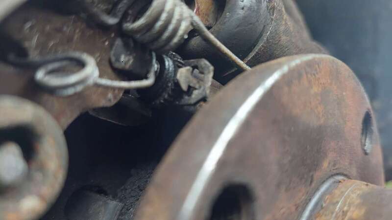

The story at the rear however, is less than good. At first, the slack brakes looked likely to be caused by a slightly mangled adjuster.
Did in fact turn out to have been fixed by welding the adjust bolt in place.  Fine whilst the shoes were in reasonable condition, but now they are a bit worn they leave the handbrake rather slack.
I've enquired as to a new set from ECP which came out at £fukinhowmuch plus vat, so I've got a set of cheap nasties from Amazon on order in the event that I can't procure a set at the scrappy in the morning.   The other side is missing it's adjuster plate too, so both sides are just sat slack.  Annoying but nothing that can't be made right for the next owner.
So in another thread, I detailed my trip out to the local scrappy in order to procure a pair of rear brake shoe adjusters.
I should point out that the repair in the post above is perfectly adequate to get you out of trouble, but not a long term solution.
It is almost certainly the sort of repair you reluctantly do for a customer after they beg you and promise to have it repaired properly after their holidays. This of course guarantees that they turn up in a new car 2 weeks later having sold the previous one.
Anyhow,..
N/S old vs new:-
2 vital components missing on the welded part, the L shaped piece that flicks the adjuster arm, and secondly the plate that turns the knurled wheel, without these, the shoes can never self adjust.
NS shoes rebuilt with the plate correctly with the knurled wheel.
The OS was still missing parts, so it too was rebuilt
OS complete and set up, a quick tweak on the cable adjuster and the back brakes are sorted for the MOT.

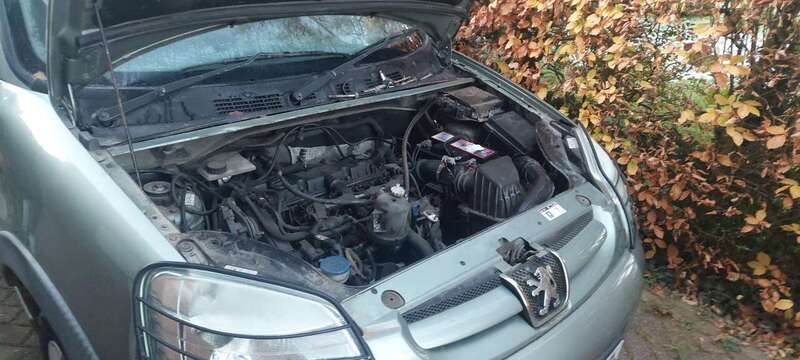

It lives!

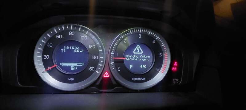

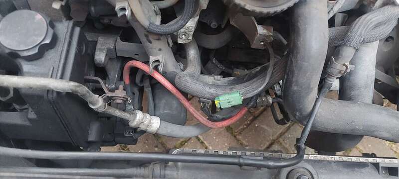

Initial inspection suggested that rhe battery positive had been mucked about with, so I removed it for a better look.
The starter motor cable should have been attached here.
The alternator wiring looks new too:

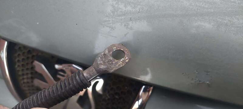

This is the manky ring terminal responsible for supplying the voltage to both the alternator and starter.
I did get a tiny bit of life from the starter but as I was able to get a good price on a refurbished unit, I replaced that too.
The positive cable came off easily,  and I replaced it with a new cable, ideally it would benefit from having an original lead fitted.
The old cable, very stiff feeling so it's possible that it's been cooked at some point.
On driving, well it stops and it starts. The clutch bite is low and incredibly sharp, and the engine sounds a little harsh.

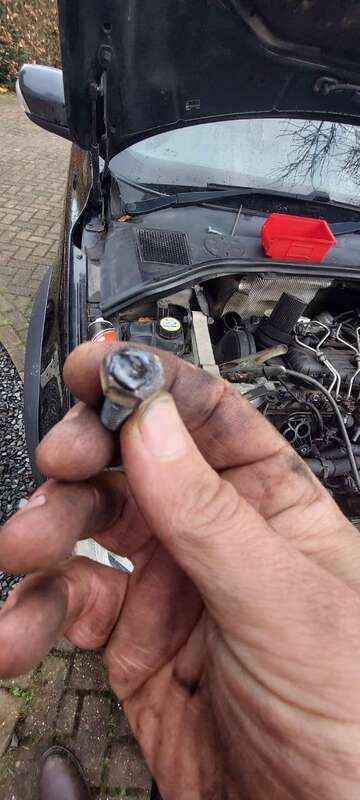

Yesterday I got some time to set about the XC70 and it's broken belt tensioner bolt.
Seen above roughly central is all that remains of the tensioner bolt.  There's a bit of a gap here, but we'll below the alternator.
The alternator was easy enough to remove but did require the oil filter housing to be taken off.  It's here that I discovered the alternator was not the original and also the incorrect spec for the car. The lack of a clutch pulley on the alternator may have caused degradation of the tensioner bolt.
To remove the broken bolt, I was lucky enough to be able to wind a nut onto the protruding bit of bolt. Because of how close it is to the chassis rail, I had to cut down some welding rods to allow access.
On only the second attempt...
It didn't feel tight, so I thought I'd failed to get it to stick again, however...
Thank fuck for that. The tensioner bolt was into the engine block. I am not sure what I would have done had it not come out clearly.

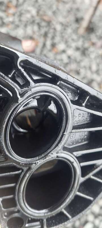

Mission creep:- The alternator must be replaced,  there is oil all over it and down the engine.
Where the filter housing had been removed, the seal had been nicked, ive ordered a replacement for that too, and an OEM tensioner bolt. I may as well service it whilst I'm here

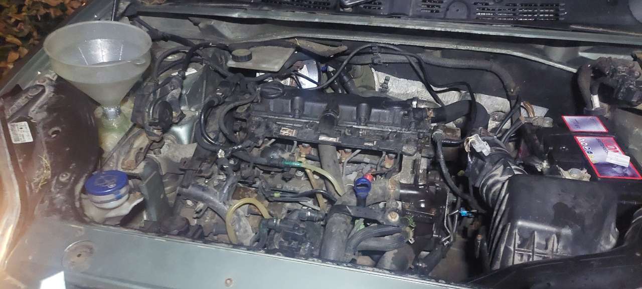

So I replaced the front brakes on the Partner and made a start on  the cambelt.
It's pretty grubby down there. I can see that it has had a crankshaft oil seal and the sump has been replaced as there is a lot of silicone spooged about the place.  The noise that I had thought was the crank pulley turned out to be an incorrectly tensioned aux belt.  Removing the manual tensioner proved fun* as the bolt was seized into the tensioner and was already partially rounded out.
So the technique employed here was one that has yet to fail me.
Firstly find the next torx/spline/allen socket that will fit tightly into the bolt head.  In this case it was an 8mm allen bolt so an M10 spline was the next nearest fit.  This is knocked in as far as it can be before attaching various extensions and propping the end up on an axle stand.
From here I used a 3/4 to half inch step down and hung my old faithfull 3/4 drive breaker bar on the end. At this point I have my weight on the bar, but I am not really pushing against the bolt.  I use a lump hammer to clump the head of the breaker bar and this alone is enough shock the bolt and tensioner free.
Ideally it'd have a new tensioner as rhe bearing in it does sound a little rough. For now I found a replacement bolt and fitted the manual tensioner in the flat out position to allow the automatic one a bit more slack.
Annoyingly the cambelt tension is too tight - something I have always struggled to get right as it isn't an absolute. I'll pull the rear cover off later and let the tension off a bit.
The coolant has been replaced and the bleed points bled, I've cut the egr plate down a bit more and refitted it, time will tell if it works.
All this by torchlight.
