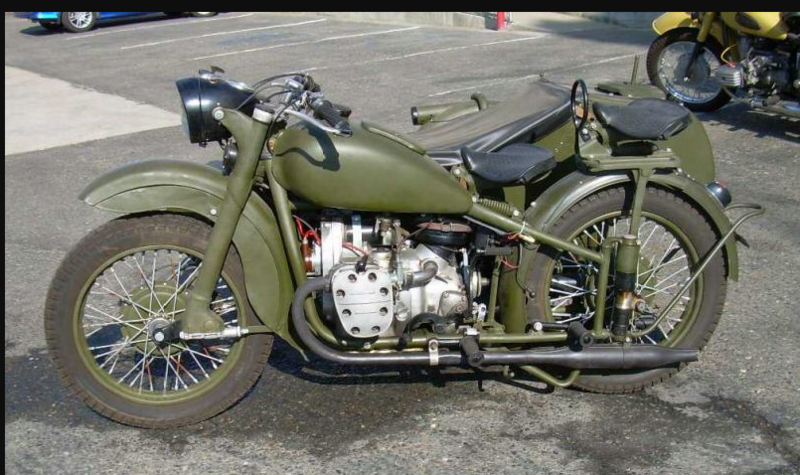

I'd be very careful, the Chinese bike is a Chang Jiang. It was based on an earlier version of the Dnepr, the IMZ M72, not the the Ural . Incidently 'M72' was a designation also used by KMZ for the Ural, I think M72 is more of a generic military classification for motorbikes rather than a  specific model name. As discussed above there is little interchangeability between Ural and Dnepr. A Chang Jiang will have evolved well away from the Dnepr by now and, I suspect, won't have anything in common with a Ural.
Chang Jiang
IMZ M72. I spy many differences.
