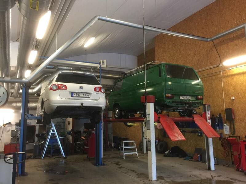

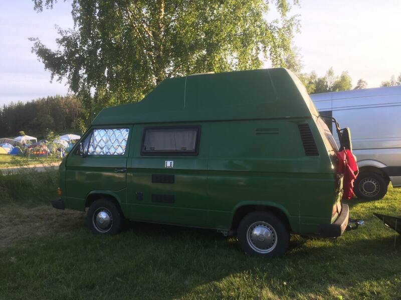

Volkswagen Transporter Diesel tinkering today. Lost reverse gear just before winter storage and thought it was time to find it again. So I changed the gear lever bushings today, quite a simple job. The result was that gears 2-3-4 are now easier to find than ever. First gear has disappeared completely and reverse is still nowhere too be found... Yippie! I

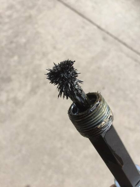

So this is my Volkswagen Transporter D 1983. An ex Atlas Copco service van. Originally it had an naturally aspirated 50 hp diesel. The owner before me changed the engine to a JX 1,6 Turbodiesel from another Transporter. That engine went into self destruct mode the same day I bought it. It later turned out that the oil pan had gravel and small stones in it... When I got home after a 8 hour drive at 70-80 km/h the engine was shot. Spewing out oil through the crankcase breather and refusing to go down in rpm. Oh crap!
The VW 1.6 diesel tends to do that. I'm not sure where its good reputation comes from.
Do they have a good reputation? Don’t know how well that engine copes in Golf. But in T25/T3 the workload is too much.

Todays Volkswagen Transporter garage session resulted in all 4 gears working smoothly, reverse gear is present again and I did an oil change on the gearbox.
Link to comment
Share on other sites
14 hours ago, bear-in-the-air said:
So where was reverse and 1st lurking?
I found them lurking in the bowels of the gearbox. But I got them back to work by adjusting the linkage. A rather tricky and time consuming job, but well worth it in the end.

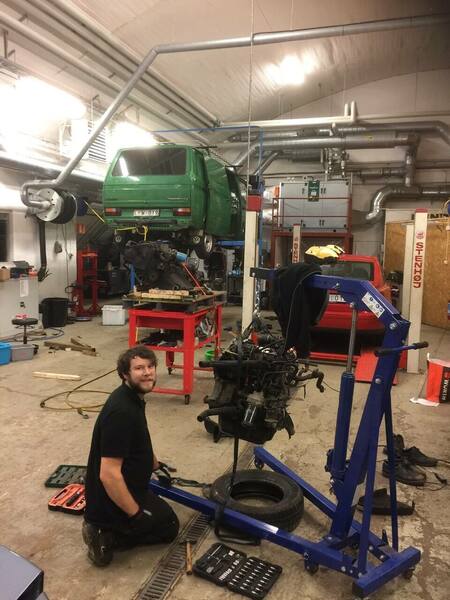

So after the disaster with the Transporters engine I had to find a replacement. My first choice was to try and find a AAZ engine or an AEF. AAZ 1,9 TD is more  sought after and found in Golf and Passat in the mid nineties. AEF 1,9 is usually found in Skoda pickups. I ended up buying an AAZ dirt cheap with unknown history and did the engine swap together with my two fantastic friends Eskil and Anton. During the swap we changed cambelt, waterpump, turbo, a driveshaft, clutch, and all the things that’s needed to adapt the engine to its new life: at a 45 degree angle. It was a great moment when I finally could turn the key and the engine fired right up.
Here is a picture of  Eskil, hard at work!

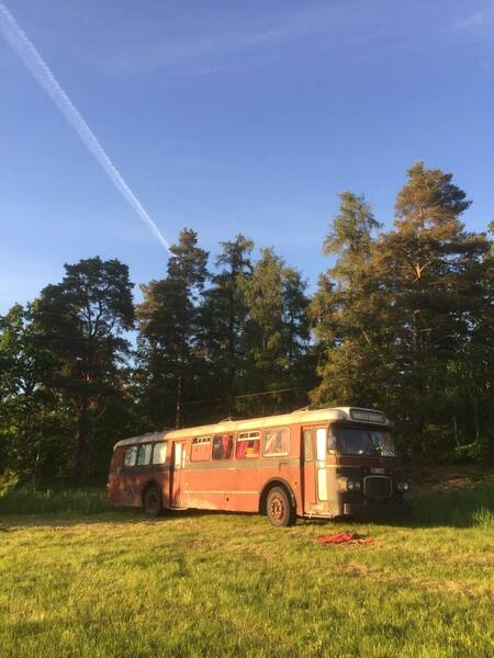

3 hours ago, Rightnider said:
That Ford van… I want it.
Had the old buses been driven there? They look a bit stationary.
Yep, that Econoline was mint!
PEZ 150 Is stationary I think. It’s some sort of photo exhibition inside of it. The others are not stationary, the last one is Siena Roots tour bus.
Link to comment
Yep, PEZ150 a Volvo 63508 from 1961 has been off the road since 1997.
