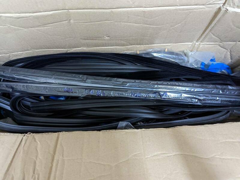

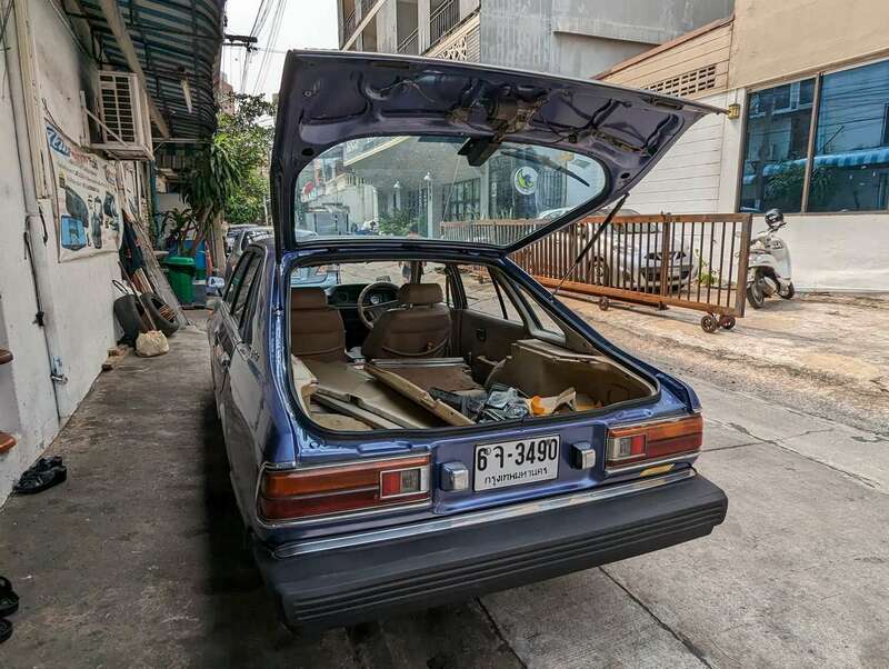

This big long box also just arrived.
What's inside I wonder? Mince pork?
AH SNAKES
SNAKES FUCKING EVERYWHERE
SSSSSSSSSSSS

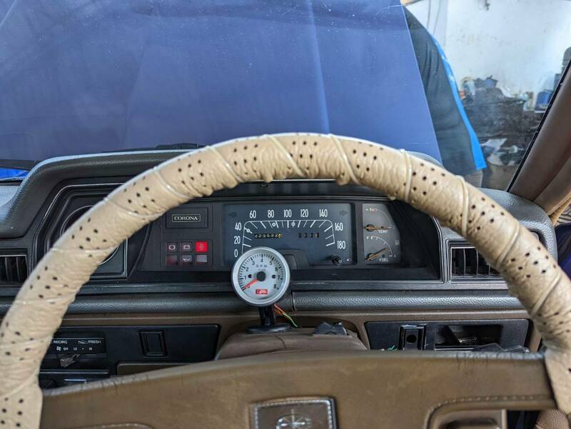

It's now also got a rev counter. For counting revs.
More shenanigans found as when I've rev it out to the max speed indicated for each gear on the speedometer, it's only 4,000rpm. FOUR THOUSAND.

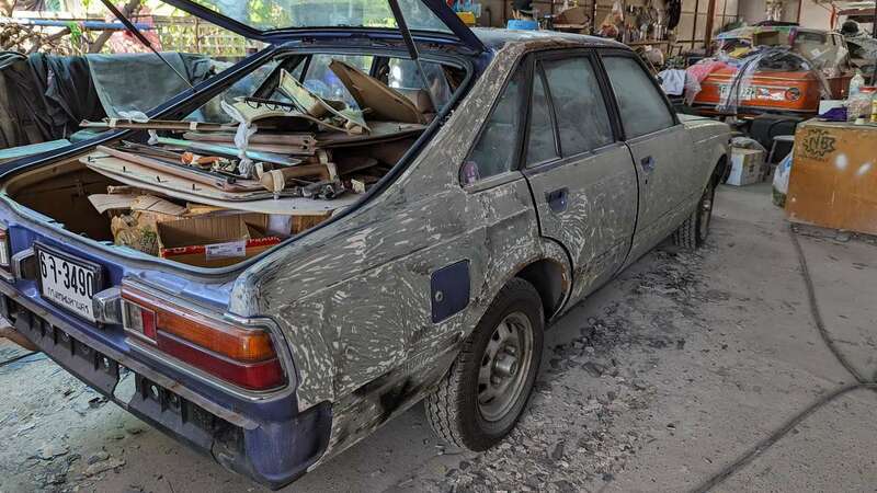

For more than 2 months this car's been in the bodyshop. It's supposed to be stripped to bare metal, welded, and a repaint. Not great timing you see, because for the past 2 months it was a monsoon season which means bodywork like this cannot be done without it effecting the end result. The work you see above got started 4 days ago.
PXL_20221103_072249231.thumb.jpg.2c41645b729620762f8ff107639ee484.jpgPXL_20221103_072249231a.thumb.jpg.27f8b179fb506a70fc48bd710d2bfee4.jpg

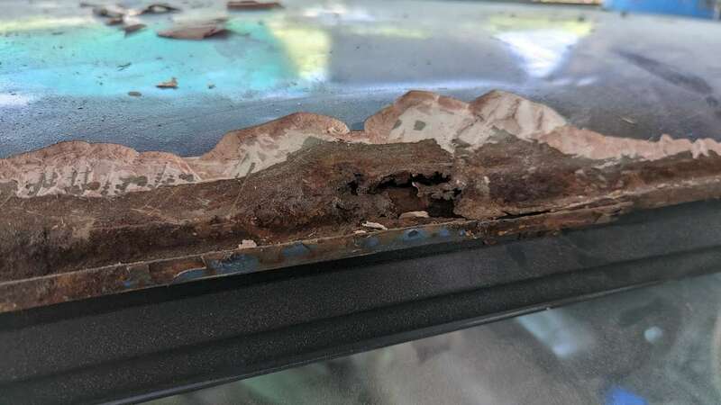

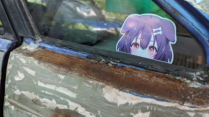

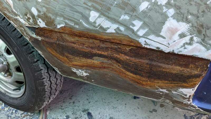

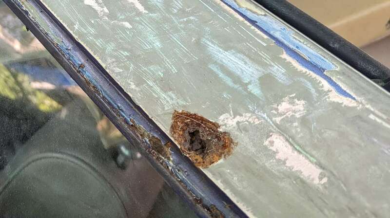

There are signs somebody was here before. This has always been very obvious even without getting the paint off.
This bit here was covered by a trim piece. The rust's there because water did collect here quite a bit under the trim. It didn't get inside the car however, and that is a very good thing.
Everything considered this is still a very solid car. Incredible as it's turning 43 very soon. These are all surface rust which can be remedied relatively easily.
Again, signs somebody was here before. I believe the black marks are from previous repair, possibly chemical ones and not actually electricity. This actually resulted in paint peeling off which led to more rust. Also why this needs redone eventually.

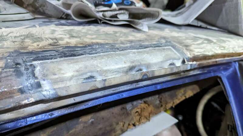

The absolute worst bit of this car is the roof. This hole actually leaked water in as well. And the filler thickness is of comical level. One consolation is that it's only the roof that's like this, the rest of the car only got a light skimming before. It can be fixed.
This car should be shining, shimmering and splendid again by early December.
For those who might be wondering, I've been quoted about £1,400 for all this work. More than what I've paid for this car.

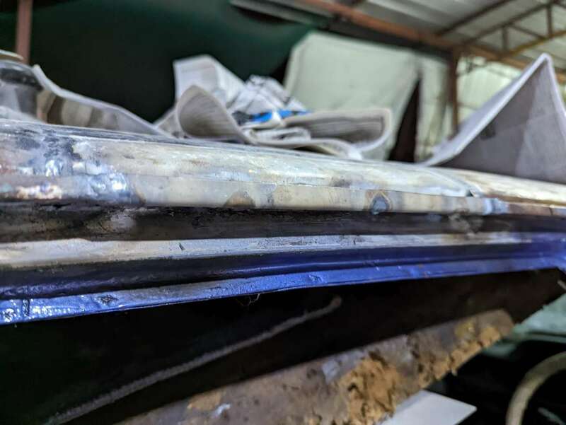

I went to see this car today so a smol update.

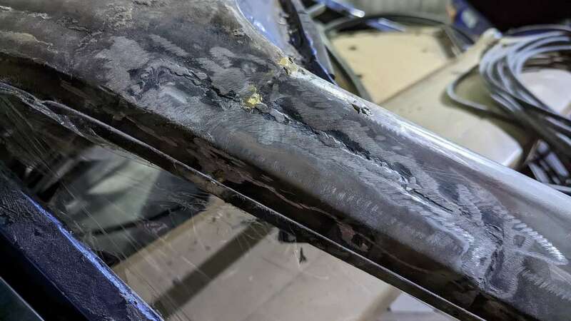

The worst of the rots have been welded. The progress so far I'd say is very good, although the early December target still isn't a sure thing.
The guy working on this told me very remarkable how little fabricating and welding it actually needed especially for a car this old.

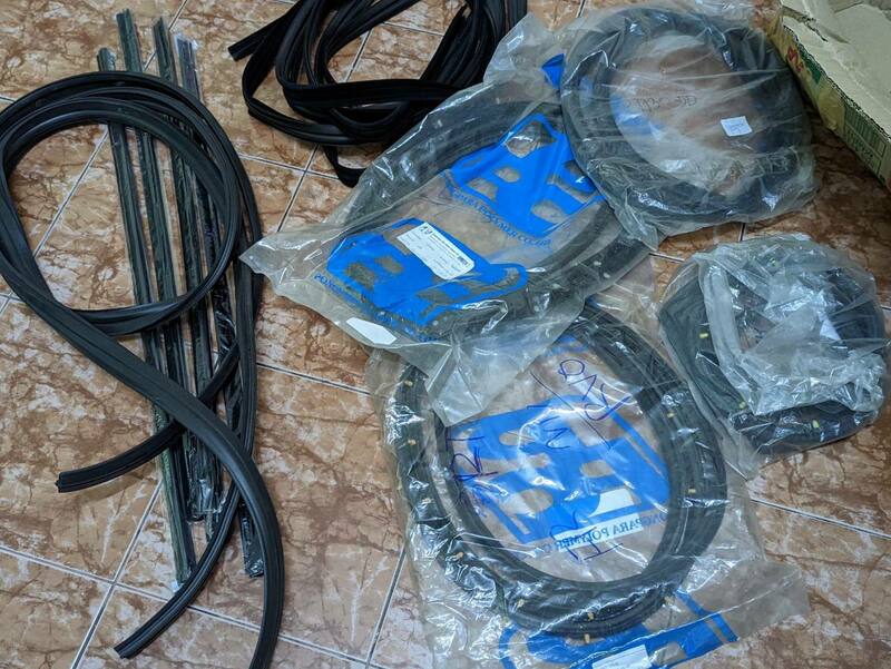

A good haul of parts seems to always come near the finish line, or at least, if the repair's done anytime soon I'll be able to continue without pause.
Quite pleased with everything that I've manage to sourced.

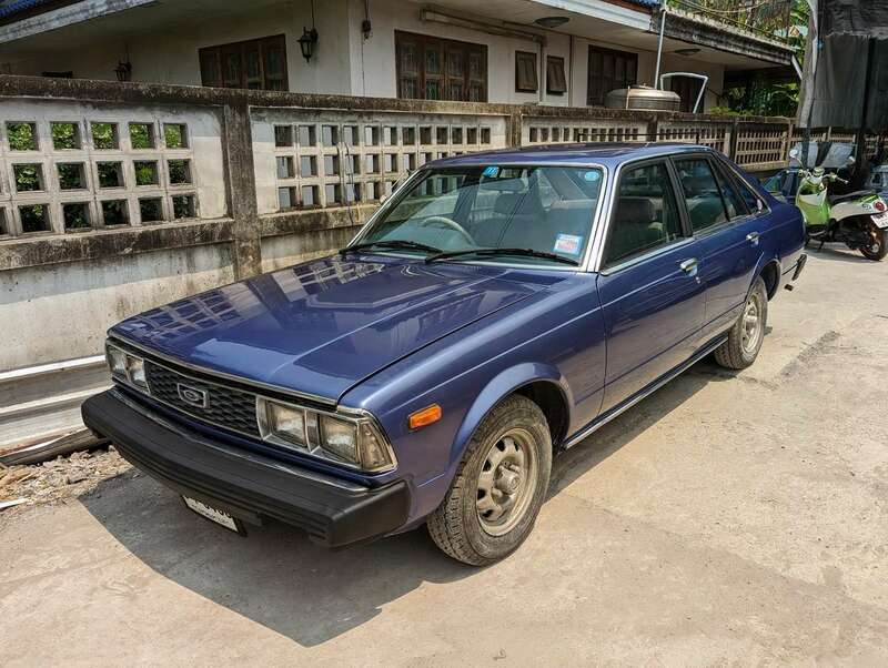

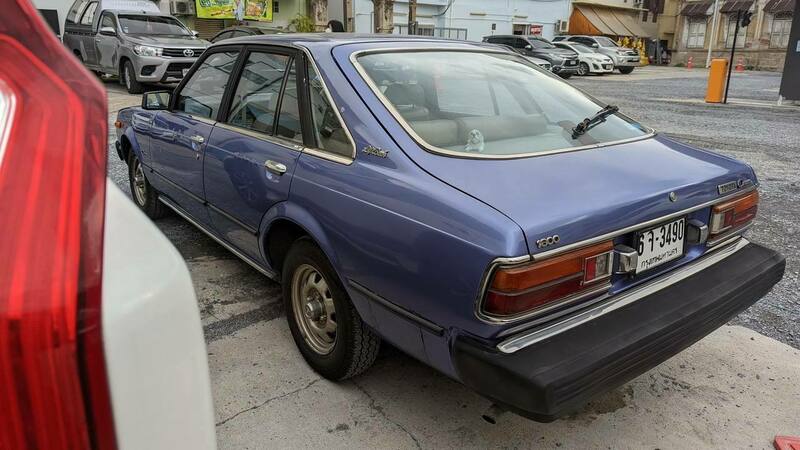

27 August 2022 - 11 March 2023
It's done.
It's finally fucking done.
And in pictures it looks kind of exactly the same. 🤣
