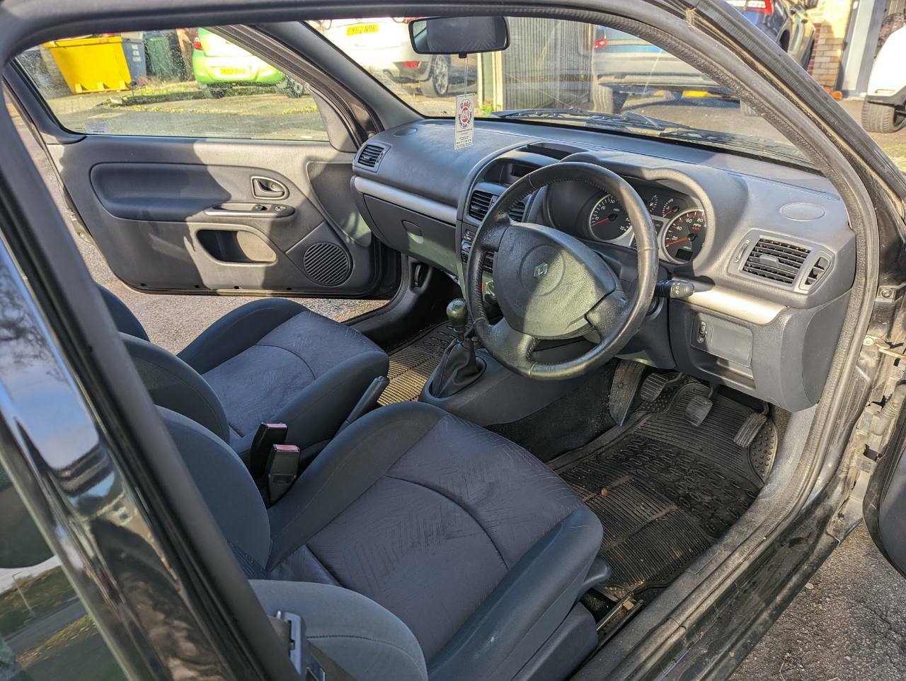

Thought I'd start a new thread on my recent Clio purchase. I fancied something new to tinker with and with being in between work contracts didn't want to spend a fortune.
This Clio popped up locally on eBay for a third time and triggered my sub £400 search so I went for a viewing.
It's right on that cusp of being uneconomical to throw at a garage for lots of small repairs, but DIY'able fairly cheap if you don't mind spannering. It's a 2003 Dynamique with the 1.2 16v 75bhp motor, sunroof, electrics windows and mirrors, sporty seats and a sunroof. Oh and 6 weeks MOT when I bought it.

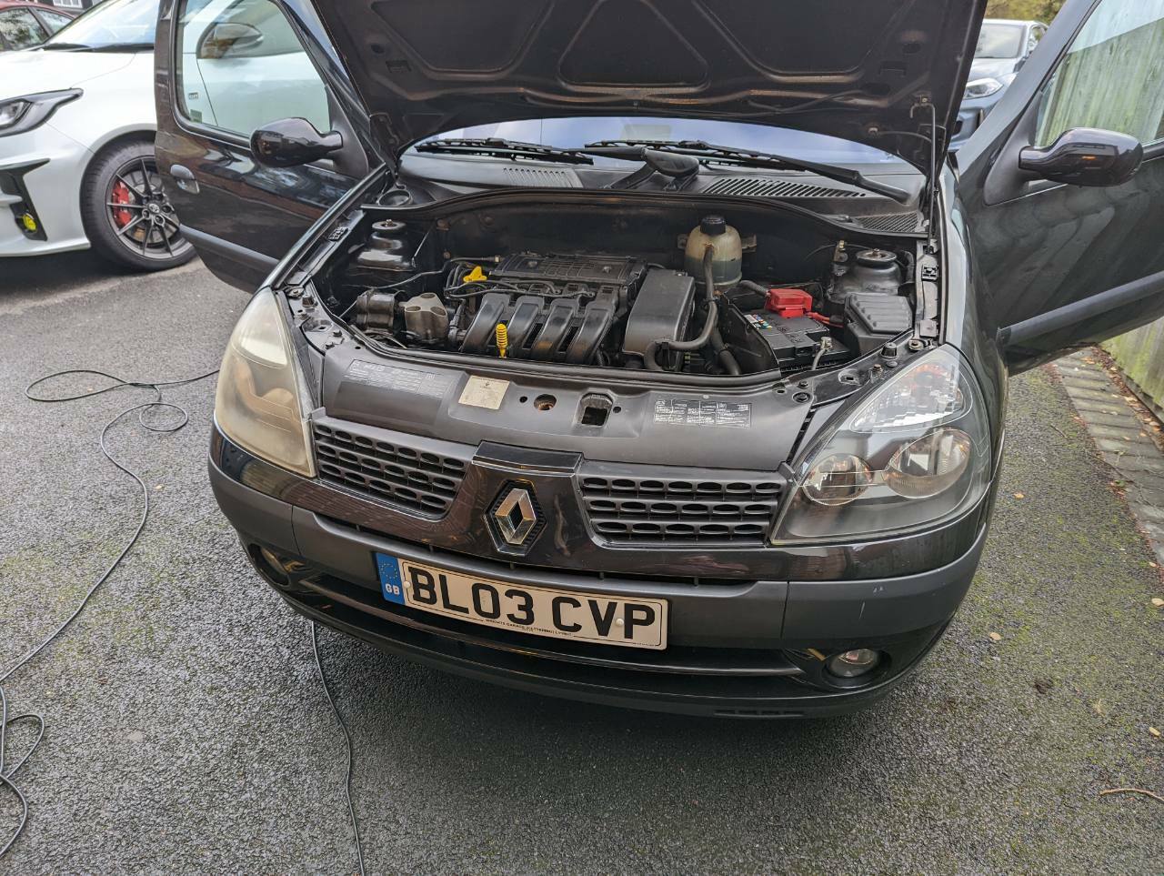

Here's how it stood when I bought it:

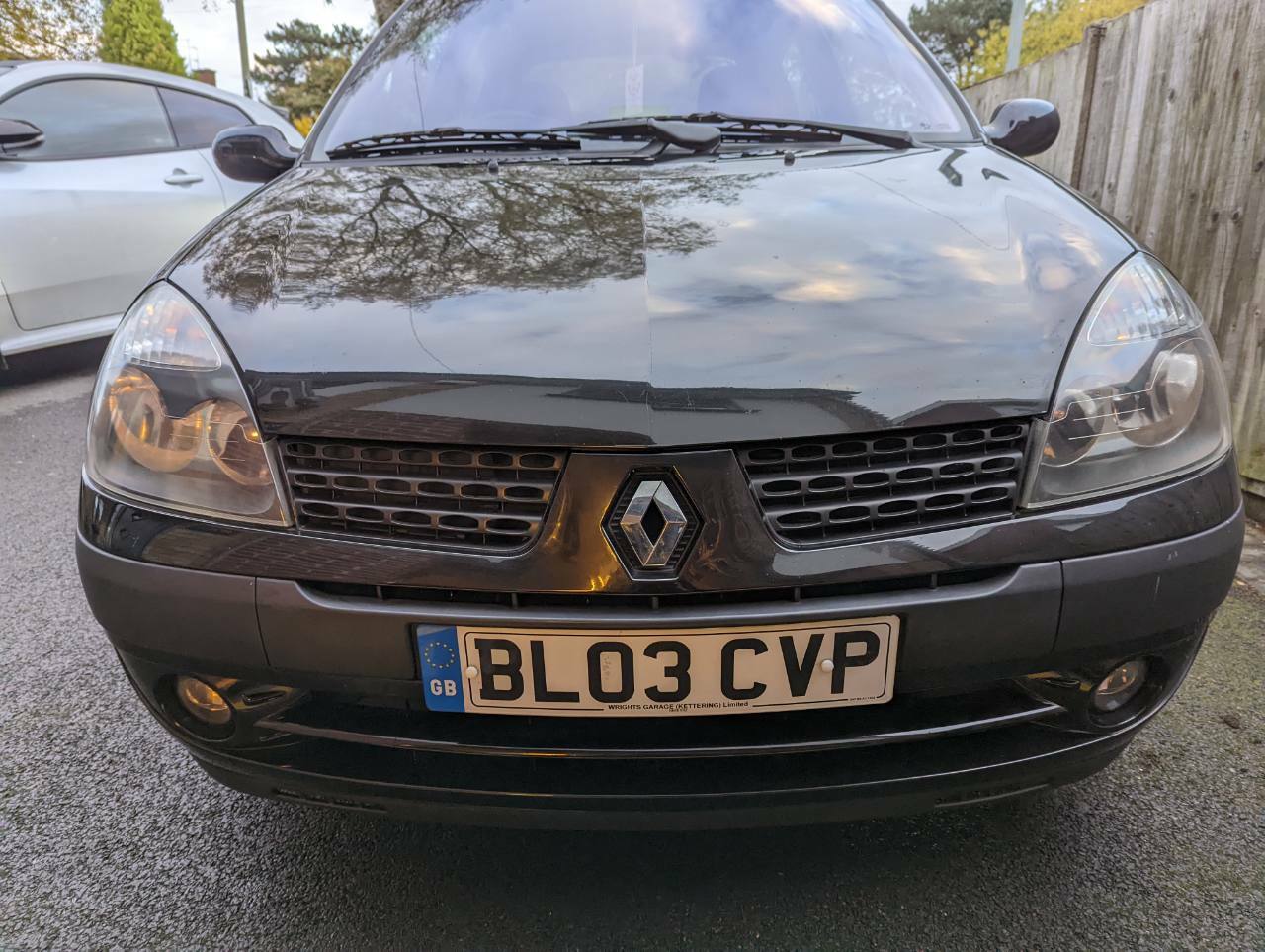

The exterior came up pretty well with a good wash and clay, I will wizz over it with a DA at some point. Noticed during cleaning the headlights were really faded, so some cutting compound on the DA on the headlights did the trick:

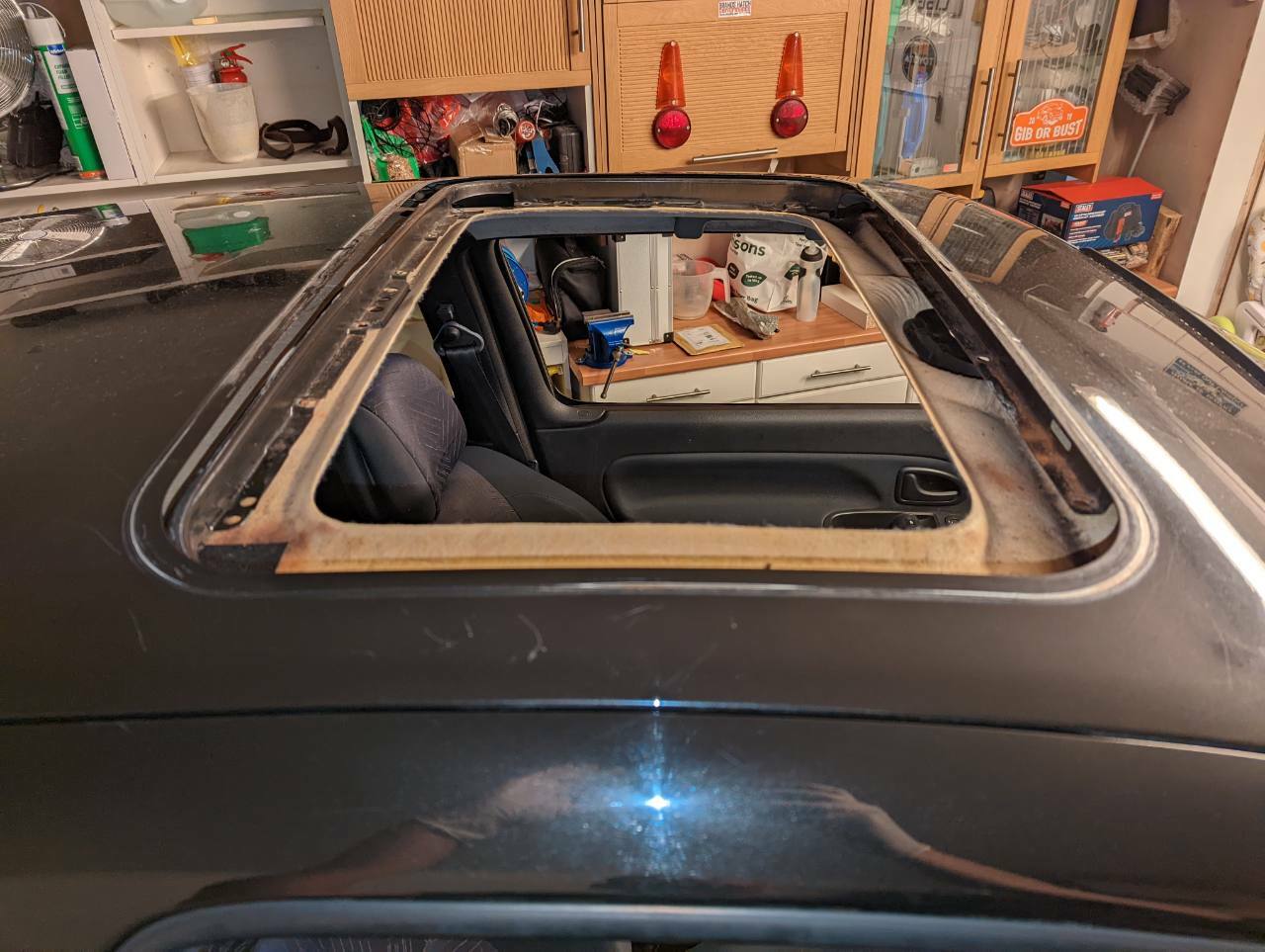

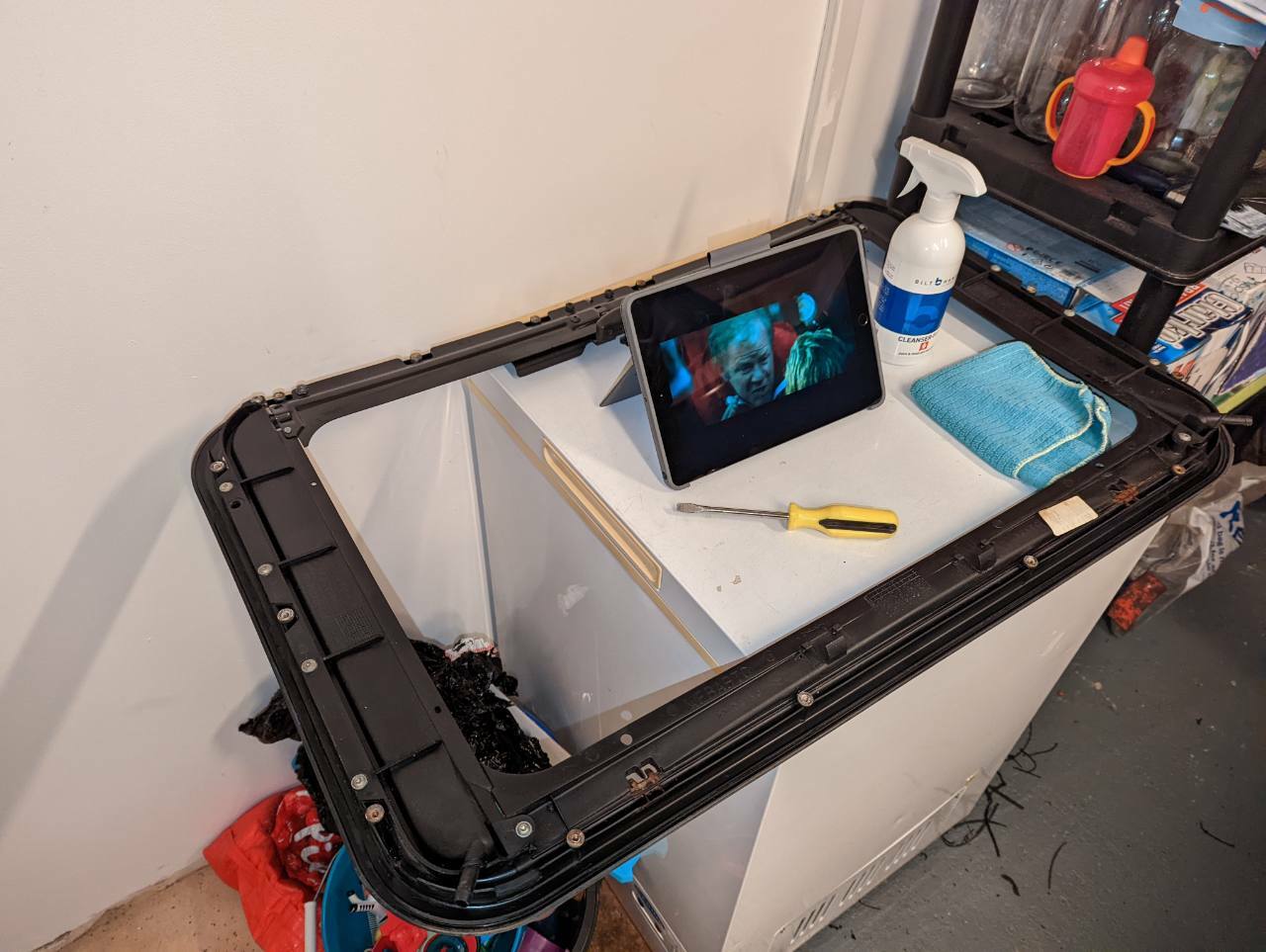

Once the interior was cleaner (another pass still required with wet vac) I set to work on the sunroof. Plenty of videos of sunroof leak fixes, so I bought some 8mm mastik from eBay.
Glass out:
Interior trim and seal out:
Sunroof out:
Once it was refitted I left it overnight then tested with a hose the next day, no more leaks! Everything was still sodden though so I left it airing with windows and doors open in the garage for a few days, all good so far. The front footwell carpets took 2 weeks to dry!

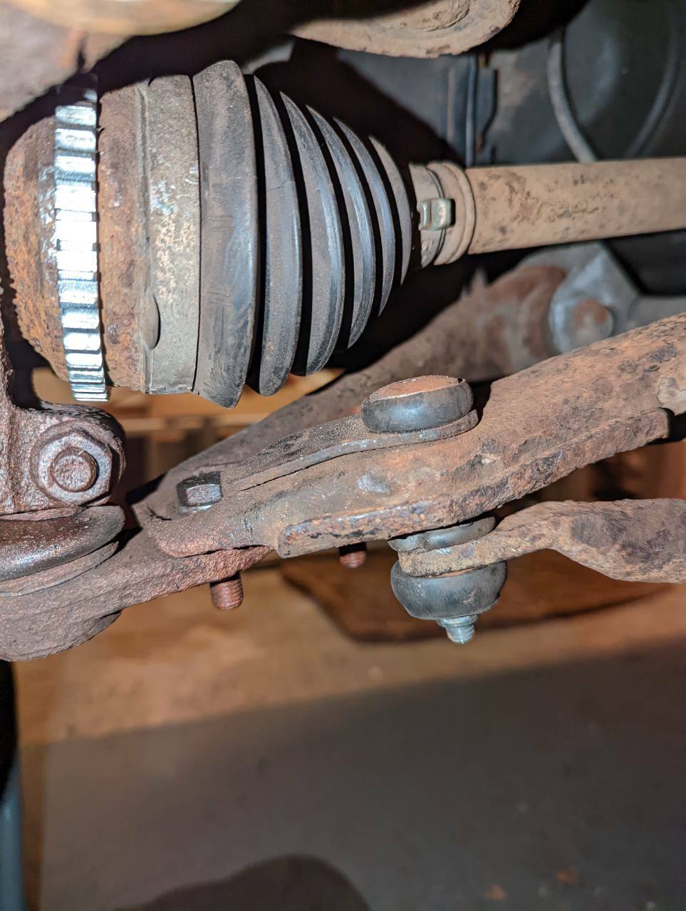

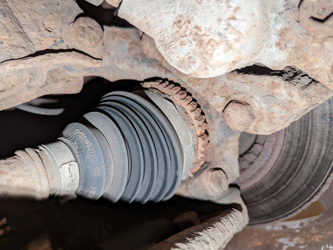

It was also immediately apparent which ABS ring was at fault:
And why the exhaust was knocking, I added the cable ties as a temp fix:

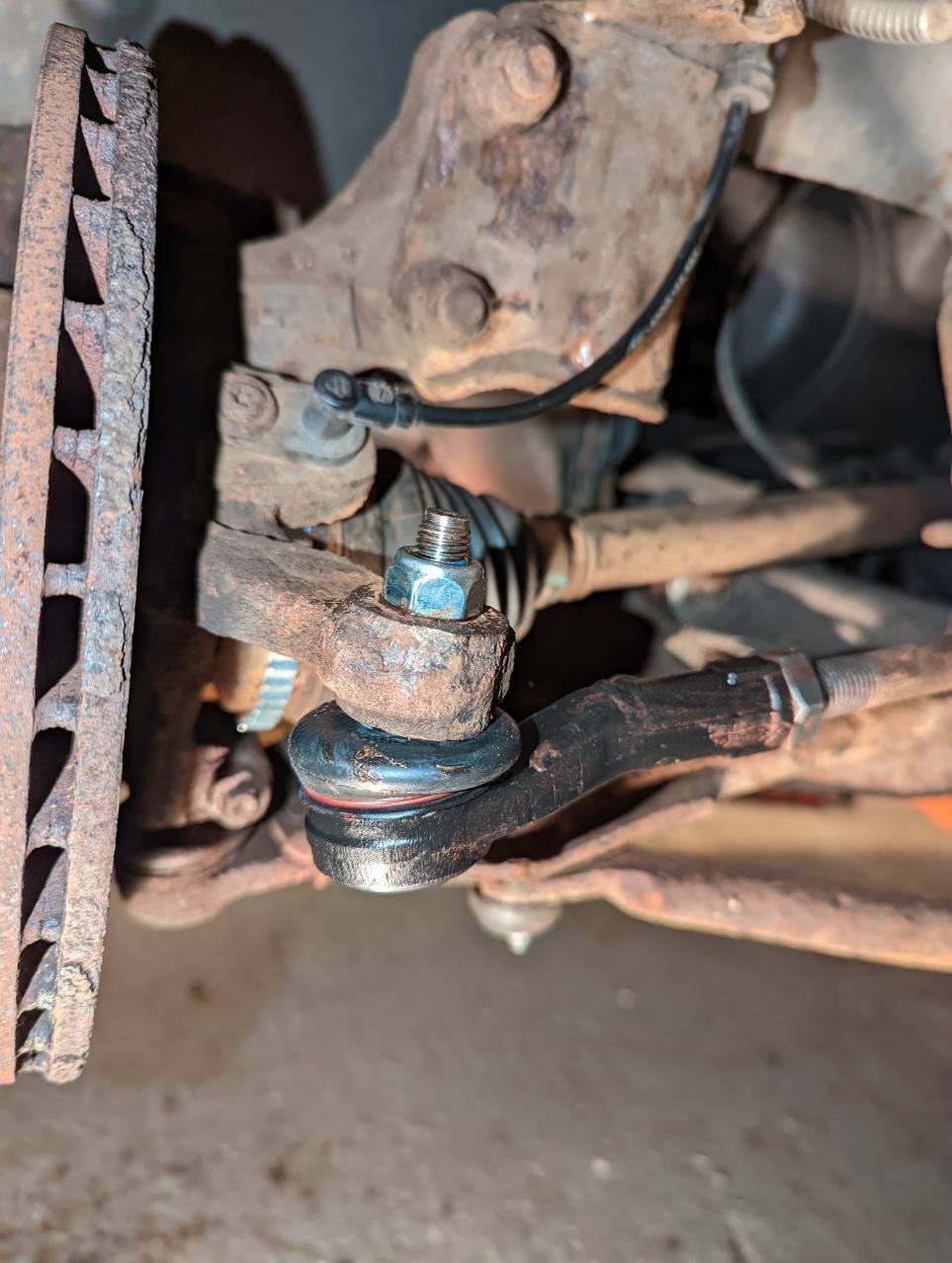

Noticed during this work that the nearside steering rack boot has fallen apart so I'm currently in the process of changing it. The tie rod end had to be cut off, and I cannot budge the inner tie rod nut or spin the tie rod end, it's all seized solid so that's my current challenge.

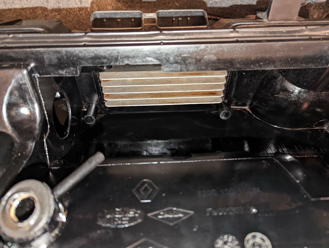

I cleaned the oil leak up a couple of weeks ago and have been monitoring, definitely coming from rocker cover area.

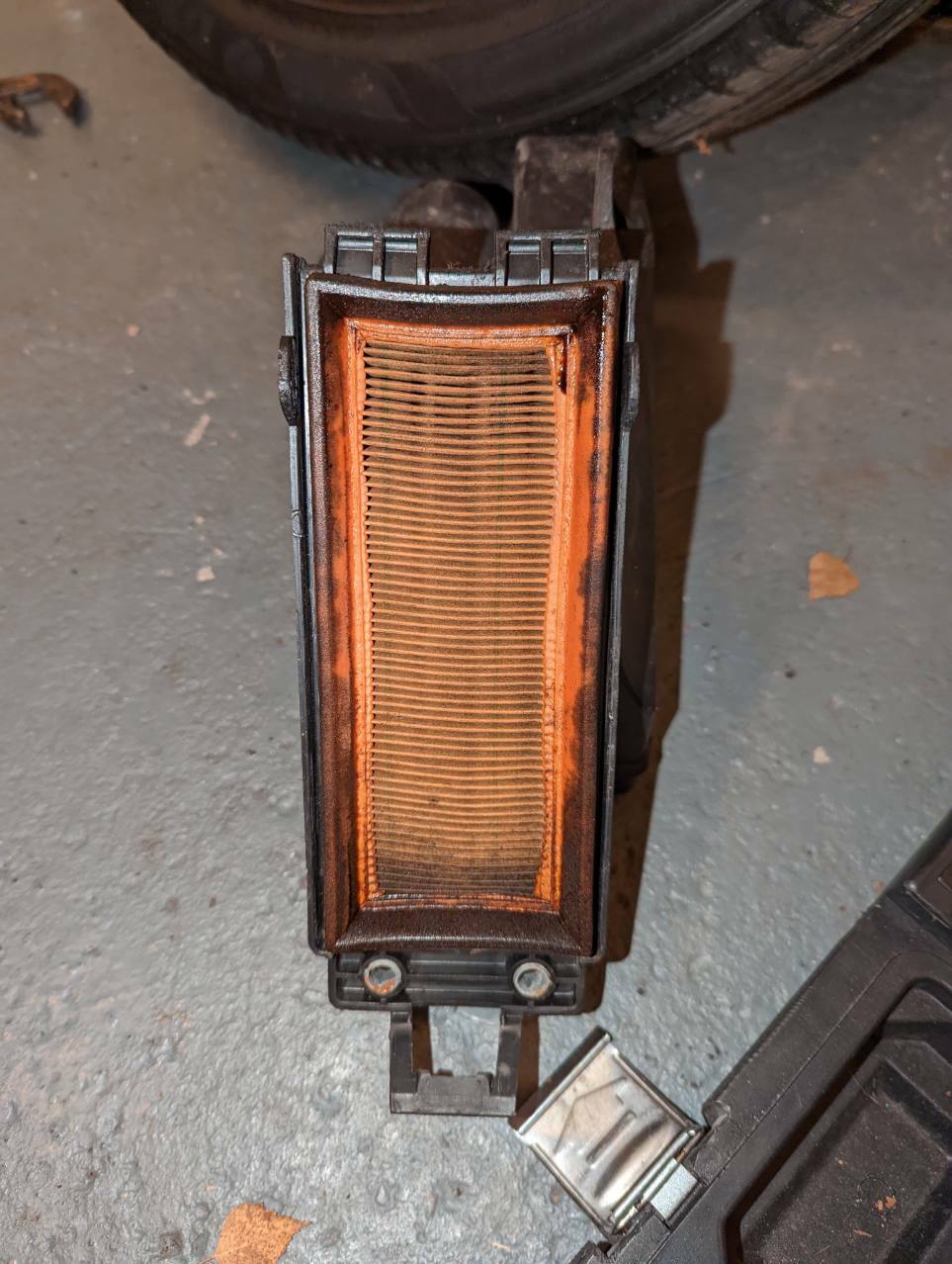

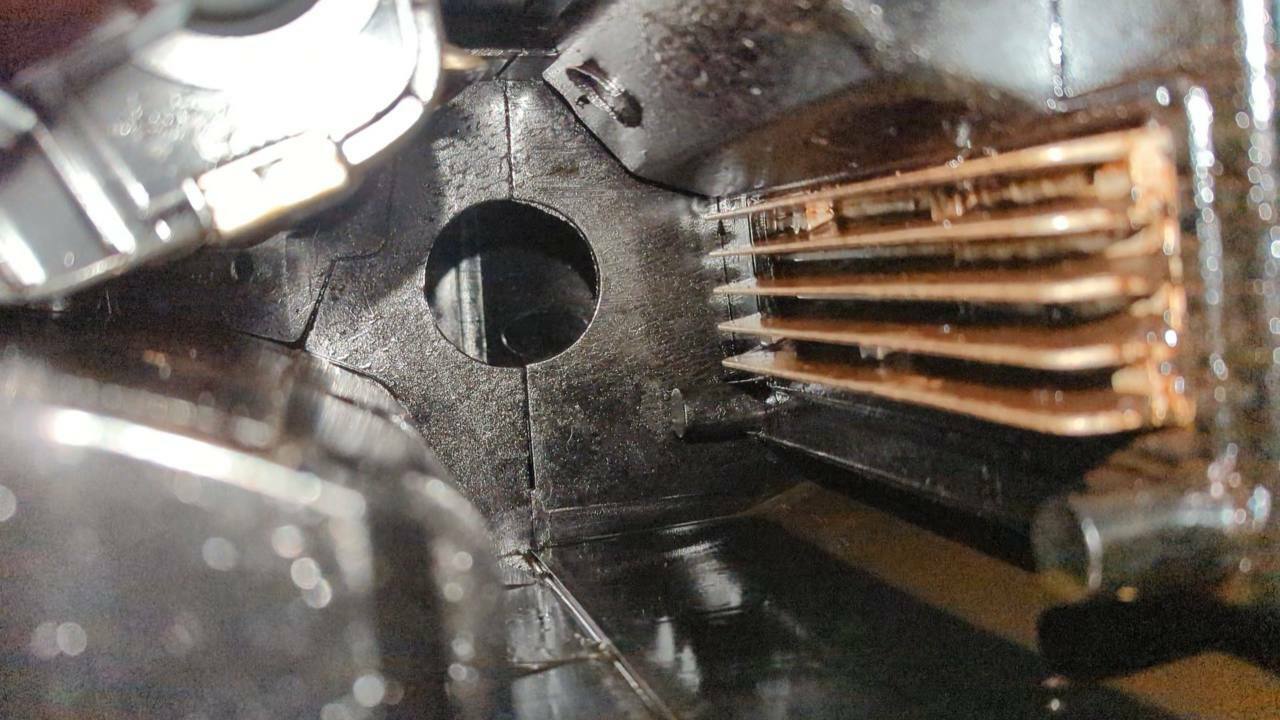

Popped air filter off and...
159644079_PXL_20211207_205618669.TS_exported_15967_16389134589372.thumb.jpg.5fbab45650a09397b1c7382c123517f3.jpg
Nice and oily! I've read about a problem on these D4F engines with the rocker breather failing and oil pooling in the airbox so took the inlet manifold off to clean it all up:

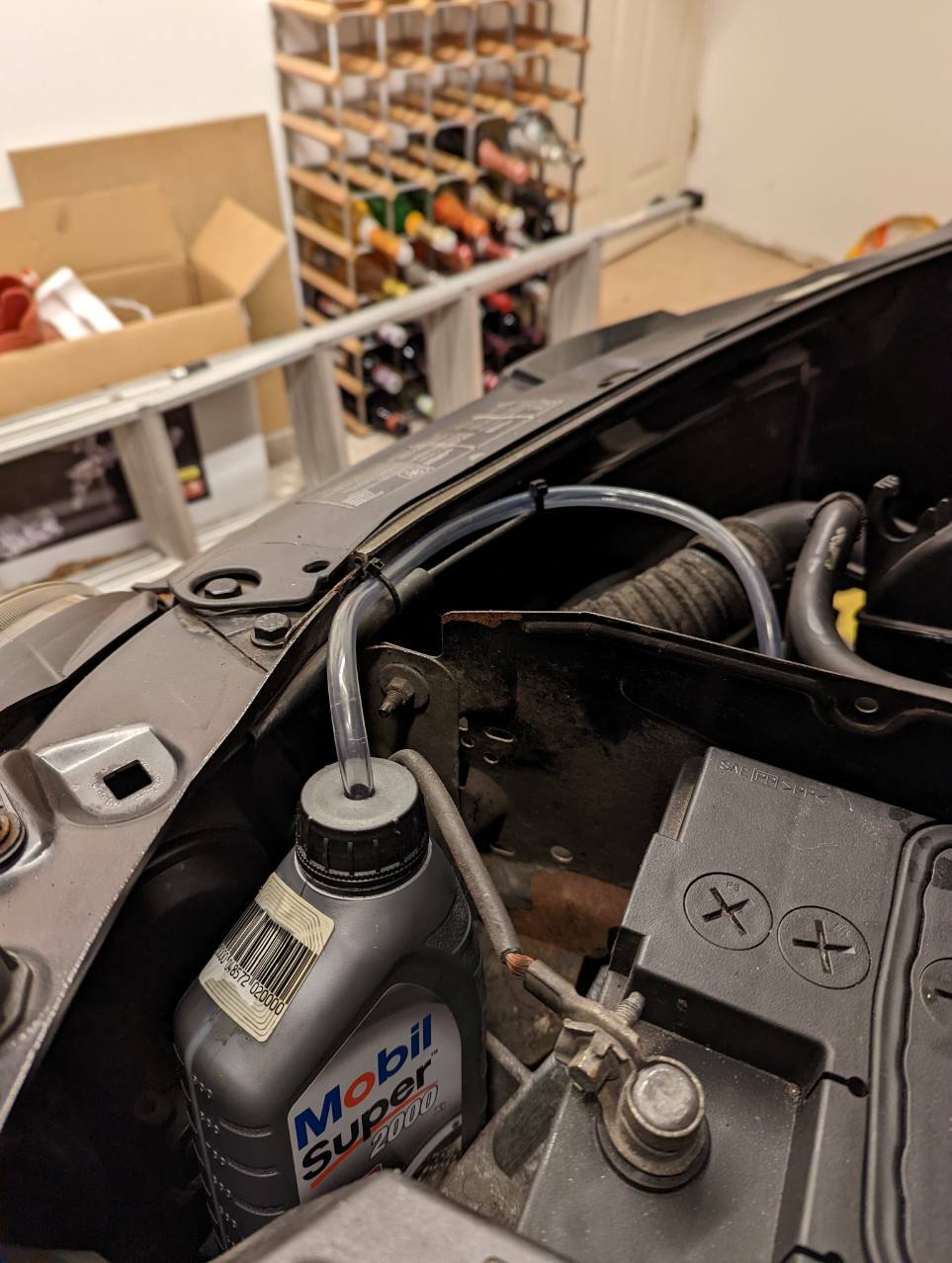

From what I can see online the rocker breather is part of the rocker cover itself so you have to replace the lot! Sod that, going to make a catch can with some tube and see how we get on 😂

Got the inlet manifold back and on catch can in place:

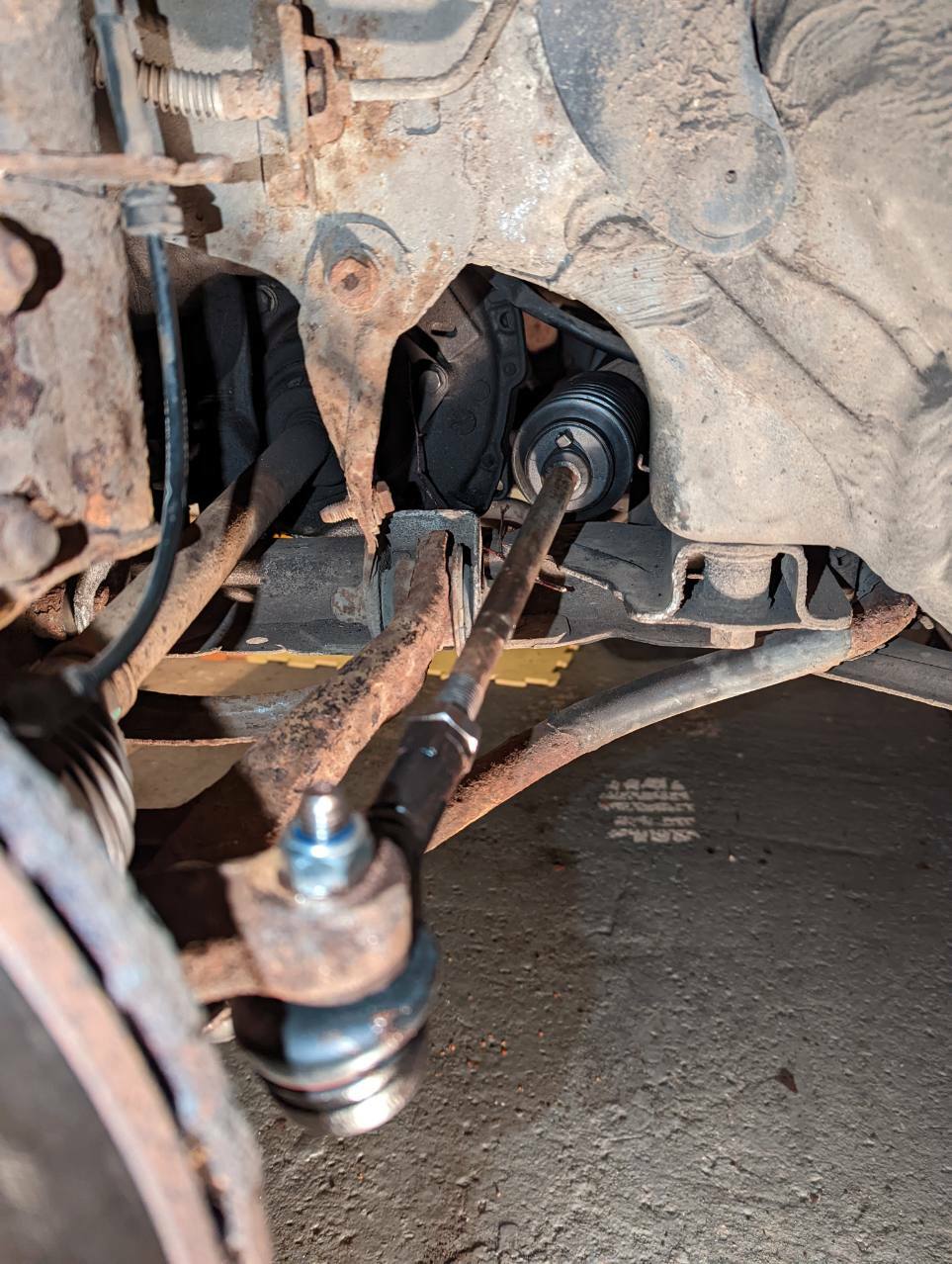

Also managed to get the track rod end off, but had to cut in to it to get it moving so replaced it and the steering rack boot:
