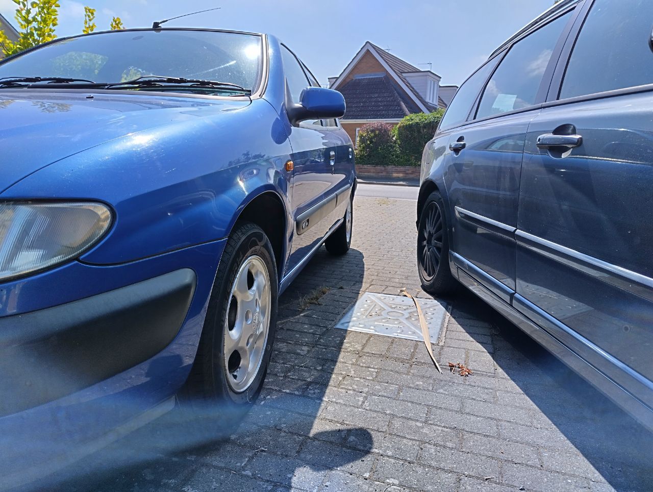

So, after just over a week I finally got round to actually driving this Xsara. Snagging list is getting gradually longer with a couple of niggles appearing for every one I fix. So first one was tyres, usable condition all round until I noticed that while the fronts were the correct 185/65/14 the rears were a matching pair of 165/65/14. Fixed this in traditional fashion with a set of Peugeot rims off marketplace
..which I nearly got away with but the offset left them a bit lost in the arches and the fronts were catching the track rods on full lock, 20 mm spacers all round this morning left it finally driveable and looking a bit less ungainly.

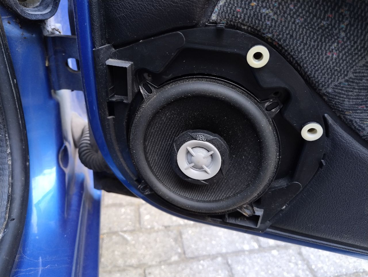

Crucial to the operation of the car also the speakers seemed to be original all round..
definitely woofed their best those. Managed to replace all 4 main speakers from the stores which was a result.IMG_20260707_203344_HDR.jpg.4423b9923a8751627569eade80f1c87a.jpgIMG_20260707_203413_HDR.jpg.594592cb09c62943ba34d0b764cf80bd.jpg

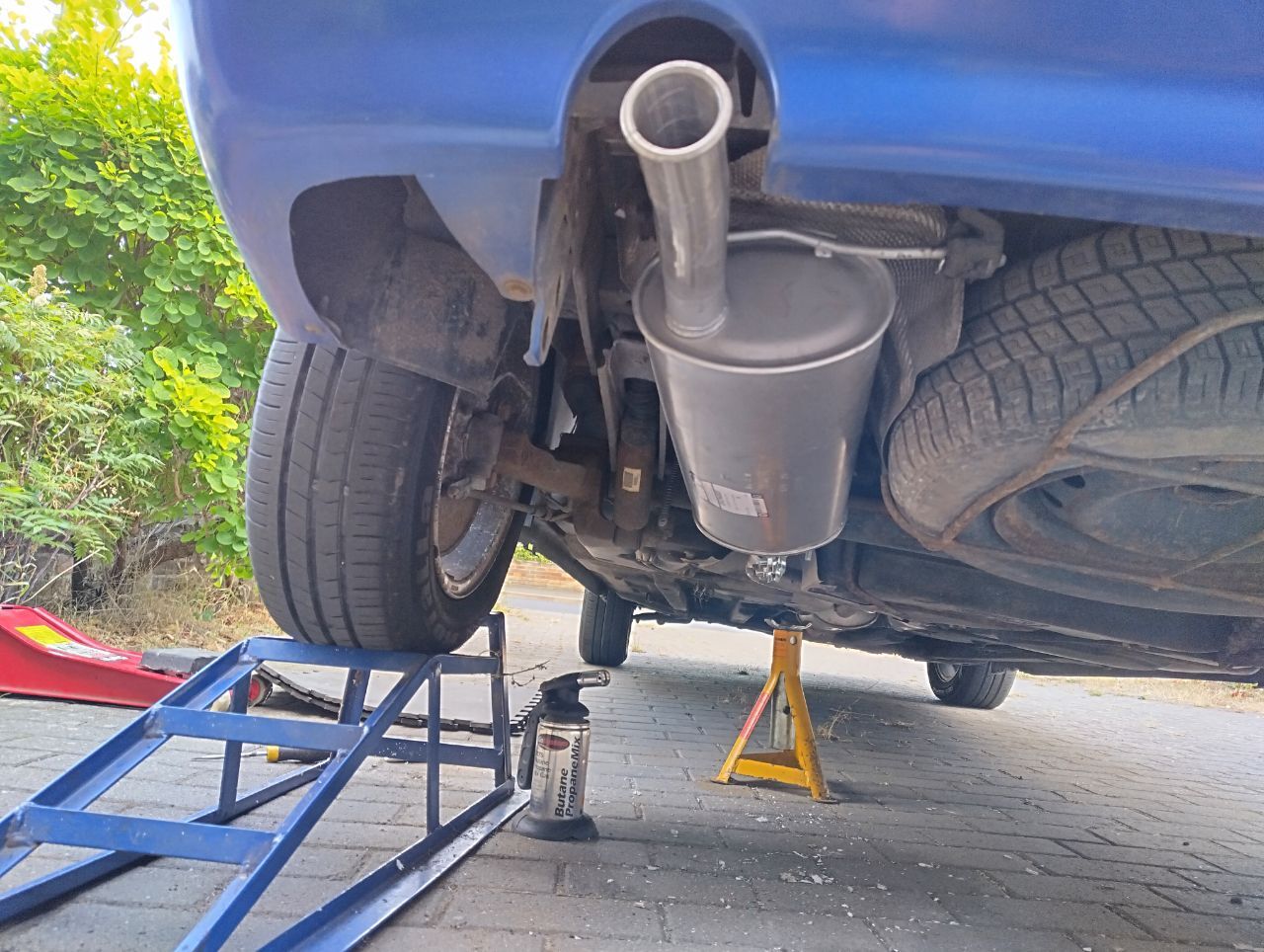

Still on the list, clutch is pretty stiff but it's cable so will get it all lubed up before I worry too much. Wipers don't self park which is annoying but not a disaster for now. Speedo is miles out and the gearing seems to be shorter than it should be so suspect there's been some gearbox jiggery pokery at some point. And OMG the exhaust... Sounds quite cool for about 2 minutes but really, not any significant silencing on there... and it's a quality build.
Standard back box on order. Looks like it'll take some butchering to get on as it is supposed to be a tapered flange fitting which has been hacked off the centre section presumably after some brown stuff infestation got in, but fortunately looks like there's a selection of sleeves under there already to help get it back together.

Been messing about with the Citroen some more - couldn't live with the daft exhaust (Hornet apparently when I got it off) so after some de - bodgery and subsequent re bodgery as the back end of the centre pipe had obviously been choppped to get the fart cannon on the standard backbox went on:
IMG_20260726_200258_HDR.jpg.87ca9271779b5efcb7258e913caef482.jpgIMG_20260726_200403_HDR.jpg.2a98b5f0add6f12bc3e6b10fe2f84244.jpg
What a difference! It is hard up against the rear beam so knocks a bit but it's still massively better than the noise it made before.
