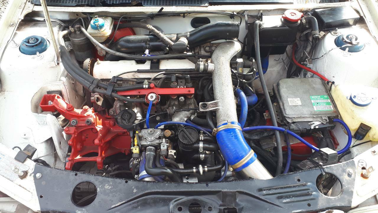

I hope you are right as mine where  £1500 for the 1.6 gti and £2000 for the 2 litre turbo gti although that one is interior less with a cage,
