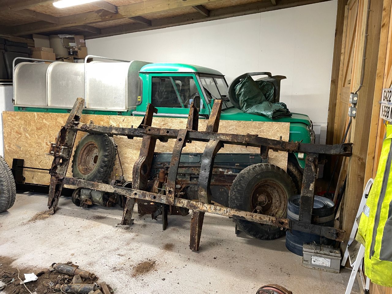

Galv chassis is the best way forwards but that quarter chassis would be a very good alternative, probably a couple of slow days’ work as opposed to a few weeks for a chassis swap. Just make sure the cuts are exactly even on both sides (lots of marking up and double checking measurements) and job’s a good’un.

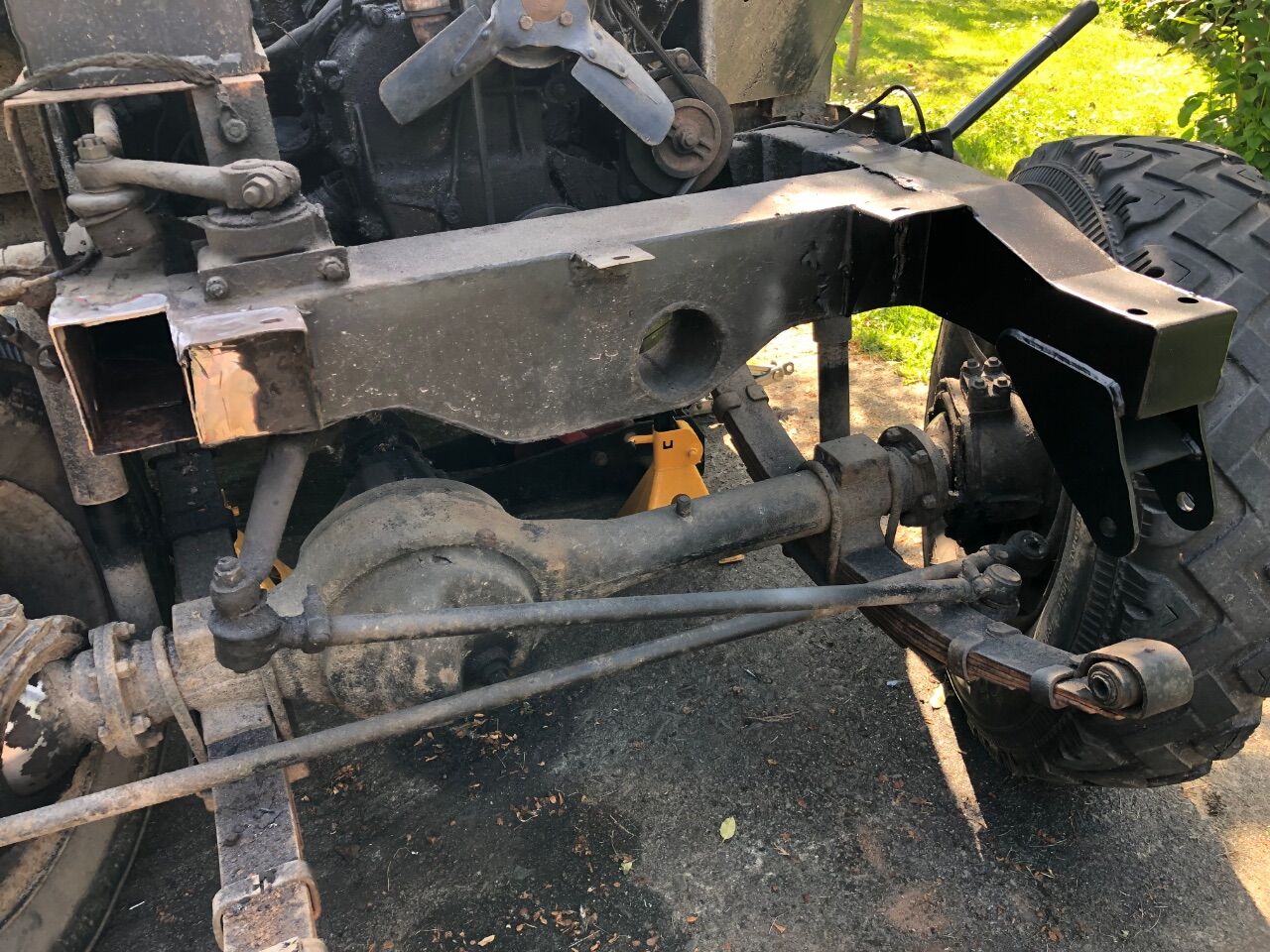

I'd be inclined to cut both dumb irons off, repair the crossmember with plate steel and fit a new pair of dumb irons.
Having seen the damage (and provided my welding expert agrees) I think this is exactly what I'm going to do.

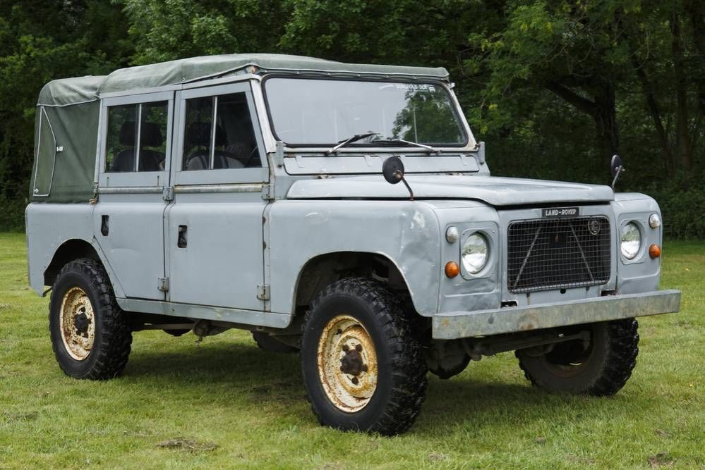

After a few months sat looking sad on my driveway things are starting to happen for my Series 2a.
The great thing about getting my mate Will to do this is that he isn't interested in merely welding bits back on, he wants to do things properly, so he's really gone to some lengths to make the repairs as strong as possible. This is the easier side, the other side is slightly complicated by the steering mechanism, but it is possible to work around that.
I'll feel a lot happier about tackling my new project with this back in one piece, find it impossible to focus coherently with multiple projects on the go.

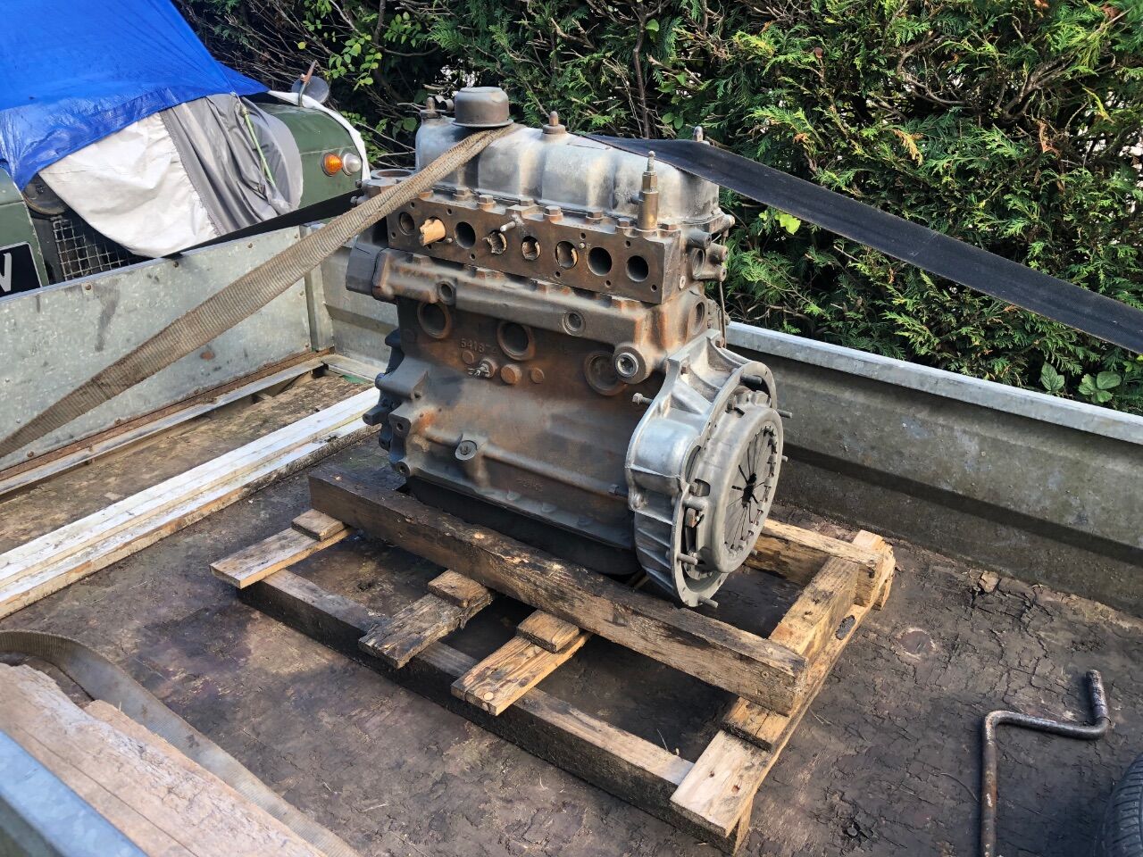

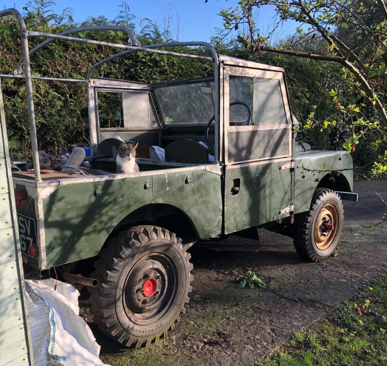

Hurrah, finally found an engine for my Series One Landrover project.
Eagle eared Landrover experts will notice that that isn’t a Series One side valve engine, it’s a Series Three ohv engine but they’re cheaper, components and sundries like gaskets and seals are pocket money prices and I’m more familiar with them. Plus this one isn’t seized or stuck so hopefully it’s serviceable. I’ll use the bits off the one I acquired earlier in the year to build this back up that was out of a Rover saloon so might have fancier manifolds.
