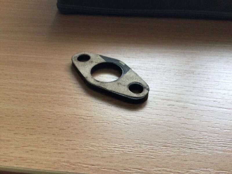

From memory, isn’t there a spacer usually fitted between the block and pump? I’m sure it’s to stop heat soaking into the pump as well as act as a spacer. Is your’s there? If it’s not, could it be that missing and causing the pump rod to get smashed because it’s too close to the little pump drive?
The old pump was ok when I removed it from the car. It was still ok, except maybe a bit weak, until I took it off.
There wasn't a spacer on the car although I know some seem to have them. There also wasn't one that came with the pump.

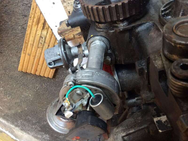

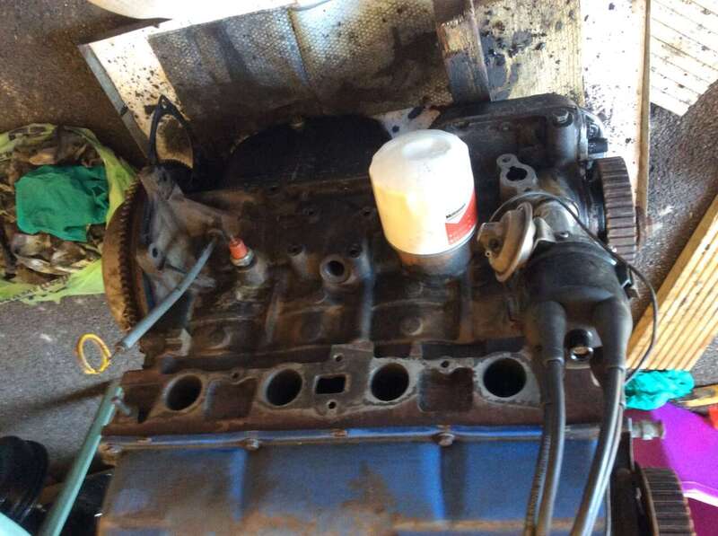

Only pics I can find showing my pump aren’t great, but…
These are the old one from the engine before it’s spruce up.
Looking at it, I’m not actually convinced mine has the spacer??

I wonder if you could fit a spacer then try it? Assuming you could get or borrow a pump the same part number as the one you have.

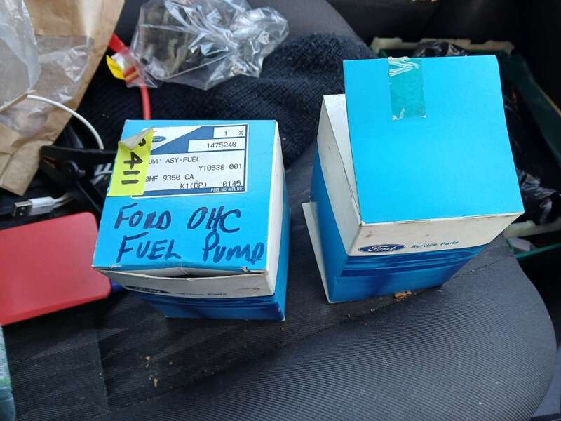

Both of the pumps are OE Ford, bought as part of a batch of 6 in 1993 according to the sticker on the side! God knows what they'd cost off ebay with OMGOSFtax.

If you turn the engine over does that 'centre' pushrod rise above the mounting face ?
If so, you probably need the spacer (£7-10 on ebay ...)

It doesn't seem to. I've ordered up a spacer anyhow.
