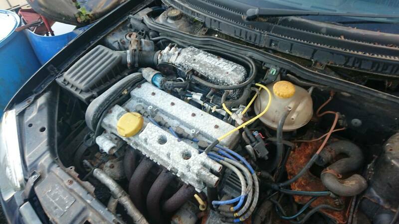

C20XE, but the much later coil pack one. Runs just fine without the typical lifter tick.

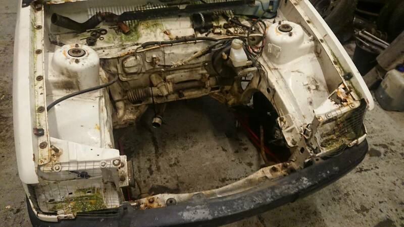

I've pulled the engine and the rolling shell is gone up for sale.

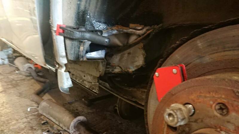

Moved on with Vectra again.
Cut the outer off first. Didn't go nuts and chop everything out.
OK. It's not as knackered. Still a bit of work required.
This meant I could repair this side instead without hacking huge chunks off. This time I did the repair bit by bit to keep the original profile.
As I seem to insist on buying repair sections and they rarely fit worth shit.
Gave the bottom arch corner a bit of a think. Although it was better,  with a good tap of a hammer that was gonna land on the floor.
Patched in the last piece of the inner. Just as a point I can work from or too.
Now. Had wondered about the sill and what it was hiding.
So I made a decision.
If I'm going to the effort of making it solid. Then I want to know it IS solid.
Sill was £45 quid too, yes crap quality. Having fresh metal outweighs the potential issues of rot creeping back out later.

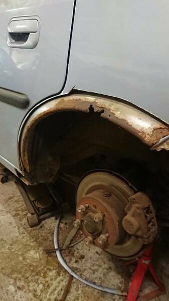

Rigggghttt. What are you hiding!?
*Goes at the inner arch tub with the grinder.*
Fudge!
Ya fully multi layered pile o' bastard!
That hole goes straight into the inside of the car. So interior out to access all round the area.
From what I've seen it's a VERY common area for Vectra B's to rot out.

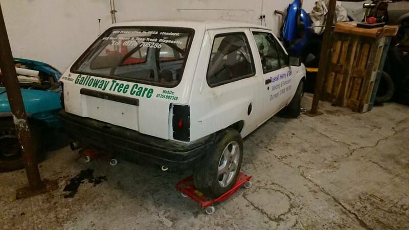

So another shitheap was purchased.
Another Corsa B. This one's a 1.6 Sport.
Knew of it's existence. But hadn't asked the lad about it. Until earlier this week.
It's gonna be bloody handy for parts and such. Also was fitted with a rather rare part. If you know your small block Poxhalls, you'll spot it straight away.
I must know... does it have that cool hooded spoiler thing like they did in the brochure? :)
