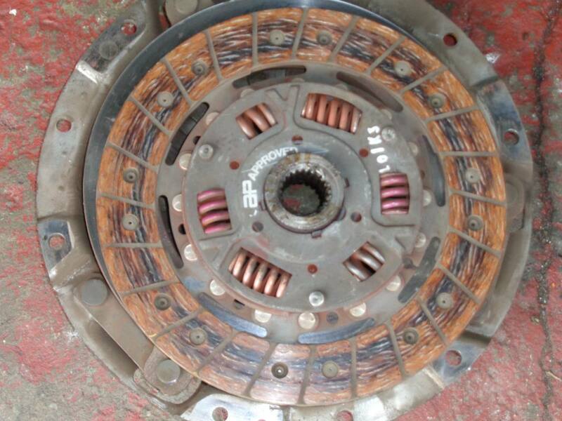

antony denman Posted January 18, 2021 Author Posted January 18, 2021 (edited) been busy yesteday gearbox is out.the clutch was knackered,new clutch needs holes were dowle locate needs drilling out bigger,cant get to my drills car in the way lol,its on axle stands,found it very therapeutic took my mind off whats going on being under house arrest lol,lockdown as they call it,loads off clutch dust so going get some brake cleaning fliud.The floor off the mazda has never been touched its unreal so while gearbox is out will underseal it,my laptop wont let me upload pics up,hopefully next week it be back on the highway take it down coast rd,get my daughter look at laptop see she fix it put pics up,it took all day get it out the bolts were at back off the engine couldent get the sockets in or rachets spanner had use good old fashion ring spanners and starter sits at top off the engine what fun i had there brill,bag and taged all bolts what a sad git,up date fitters at work are going to use pillar drill drill holes out for me, Edited January 18, 2021 by antony denman update BlankFrank, tooSavvy, Vince70 and 3 others 6
antony denman Posted February 19, 2021 Author Posted February 19, 2021 right its been abslute nitmare bought 2 clutches,clutchplates and bearings were right,but pressure plate were wrong 1st one to wide,2nd one to small,then a pressure plate turned up on ebay nos bought its a borg and beck one and put it in and its fit,so the 2nd clutch kit i used as that was a borg and beck one,sure 2nd clutch i bought its a 1600 pressure plate as being a bit to small anyway hopefully get gear box back in hooray,just wished i had a bigger garage.bloody japcrap Vince70, Stanky, Dick Cheeseburger and 2 others 5

antony denman Posted February 19, 2021 Author Posted February 19, 2021 pressure plate is same as 929 and looking at box it looks like really old stock looks like been ligging for 40 odd years,am just happy it fits.the one i drill looked right but it wasent the clutch flapping like good un,2nd one was just bit to small,anyway it hit me in the pocket but still lot cheaper than new astra daulmaster clutch,and i save on labour doing it myself, Vince70 and Dick Cheeseburger 2

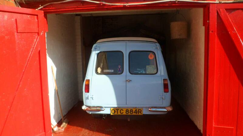

antony denman Posted February 20, 2021 Author Posted February 20, 2021 eddie its same garage granada gone,wanted something smaller and more mangable lol,seem be going after coupes,here pic off my old granada in same garage that was tight fit,breath in every time went in Vince70, DVee8, Stanky and 2 others 5
antony denman Posted February 20, 2021 Author Posted February 20, 2021 here few cars i done in my cramp garage,van used own is in another lock up i rented full off my daughters stuff now moved back in and saveing for a house.yes got thing for fords crad, eddyramrod, davocano and 5 others 8
