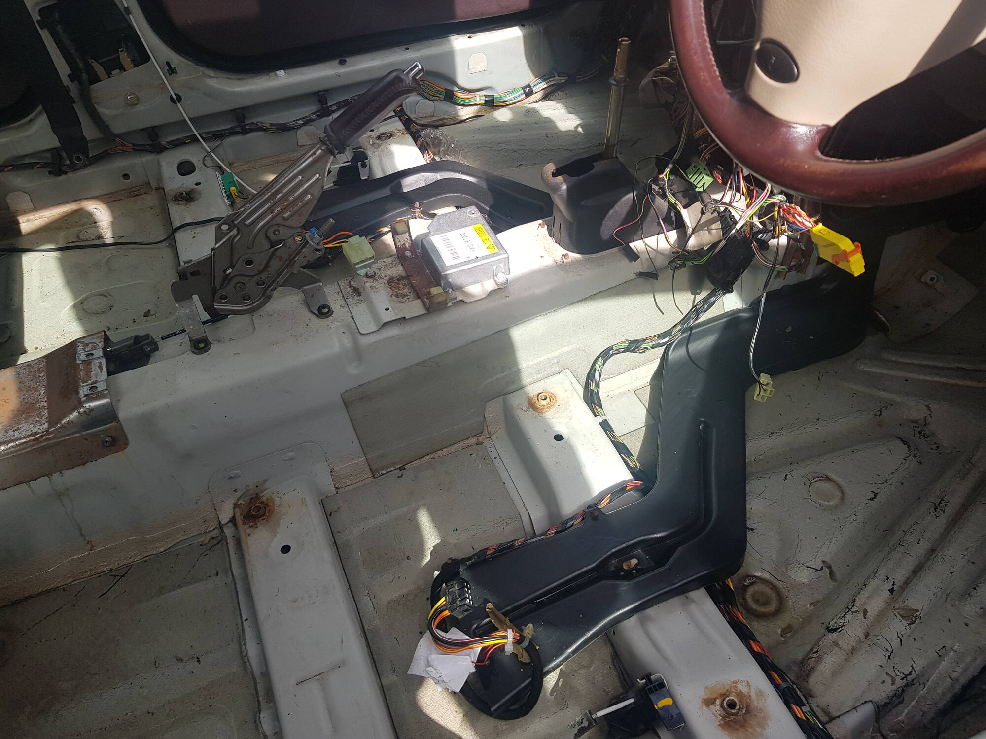

Ok we have sorted the leak into the interior(we hope) but using the dehumidifier is doing something as its sucking up some water but as the carpets are so thick it's never going to clear it.
We have spent the last couple of hours getting the whole carpet out. It staggers me how well these cars are built.

My dad was having a look around the 75 and took the rear wheels off to paint the inner arches and found the discs to be past their best. We had a set of brand new rear discs and pads so we started to take them off.
The passenger side went smoothly but the backing plate on the drivers side had rusted through.
I bought a genuine backing plate and also a new handbrake cable and we got that all back together.
I then bought a cheap cable and downloaded toaf(a rover 75/at diagnostic program)
Plugged it in and the car said about the abs issue being the passenger sensor.
We have the new one but the connector on the other end is missing so I am just waiting for them to arrive then solder them in and then see if that clears the fault.
We still need to put the carpet back in amongst other jobs but the car is getting there slowly.

Ok so having time off over christmas and new year and having nothing to do I decided to get on with some work on my 75.
We put all the gubbins back in and now have the carpet in(what a pain in the arse job)
My dad was there to help as he had alot of holiday left over. We have also sorted out the abs issue. The issue was the car had no arch liner in and the wiring got caught round the caliper and ripped out. Theoretically it should mean that I now have working cruise control as that runs off the passenger front sensor.
While the seats have been out we have given them a couple of going over with the leather cleaner. We have put a new velvet door seal on the drivers side and also bought a couple of arch liners. We have painted the passenger front arch then put the arch liner in with new clips.
What I need to do now is solder the under seat connections then put in the centre console and tack up the headlining.
