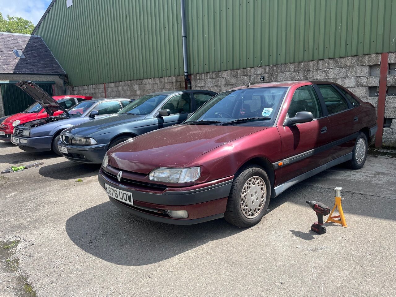

Anyway, here’s the photo everyone wanted to see.
I recognise both of those registrations on them safranes!
Did you by any chance by the Ph1 from a guy called Dave or Luke?
The Ph2 was on ebay years ago.

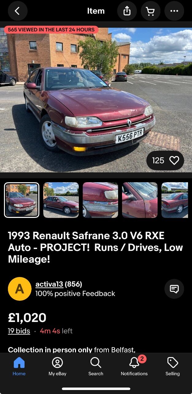

Wow, that looks properly rough for having 48k miles, what happened to it? I'm surprised it got bid up to a grand considering how long it's been off the road. It took ages to find a buyer for the green V6 Safrane with about twice the mileage at like 350 quid, and cosmetically that was mint.
Ooh, that's the one @R9UKE owned - known as 'Peter', cos of the plate. I think I know where those photos were taken, too.
I understand he's been having a bit of a clear-out recently - dunno if this is part of the sell-off, or if it had been previously passed on. Don't think I've seen it on the road for six or seven years now, maybe more. Looked in ok nick last time I saw it (though it might have been raining, in fairness).
But yeah, older cars do seem to fetch surprisingly high prices in Northern Ireland, even if not exactly pristine hence my latest cross-water expedition to bring back an Avensis estate - think I'd have had to pay double the asking for a similar example on this side of the Irish Sea.
But at least if someone's willing to pay that for it, hopefully they have plans?
EDIT: I didn't buy it, sorry!

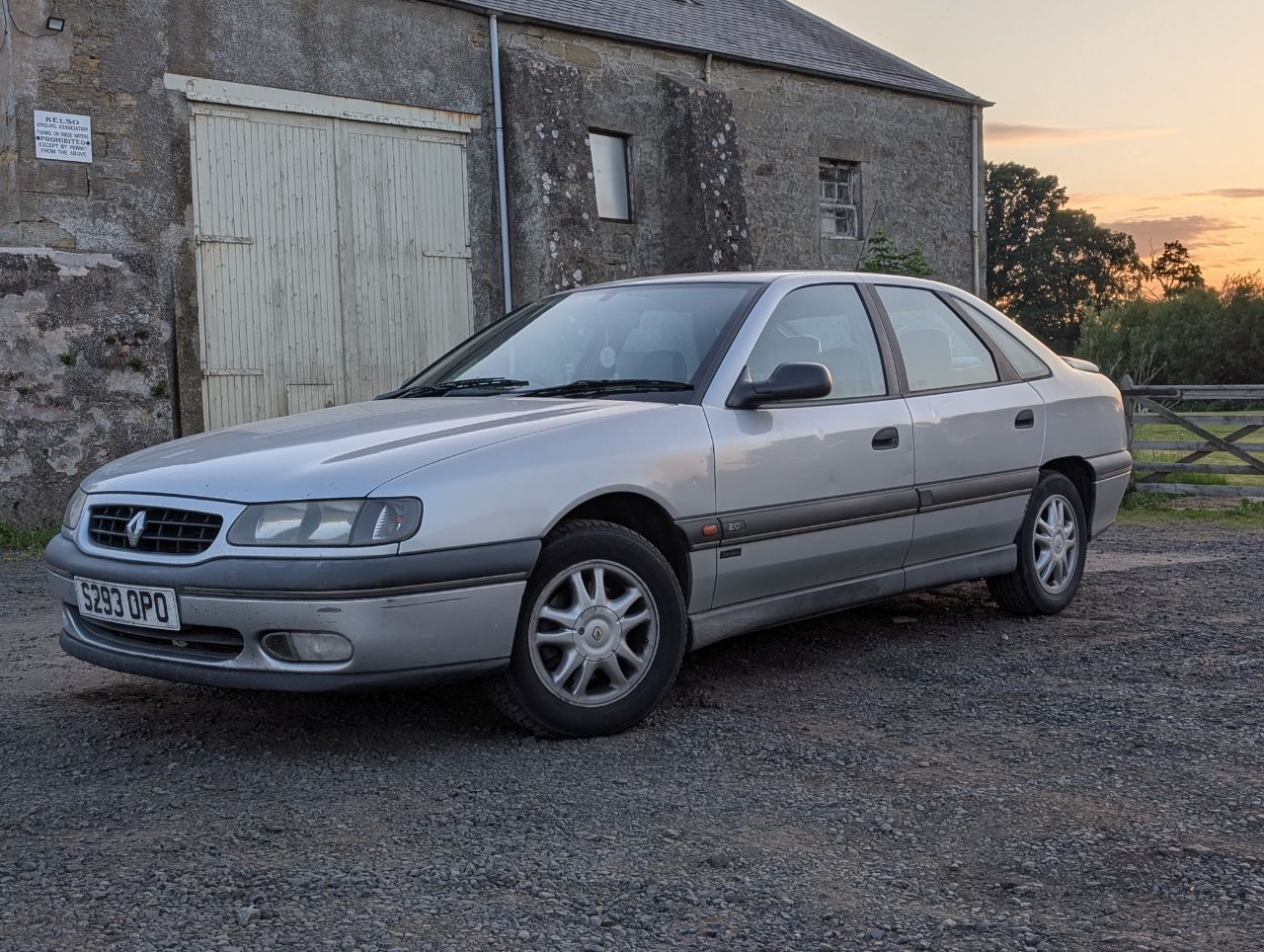

As a side note, my mate used to own the silver PH2 Saf in this thread. Sold it earlier in the year, but I daily drove it for a wee while when I needed set of wheels for commuting. What a machine! If it wasn't rotten, I'd have bought it off him. Ice cold AC, supremely comfy and rather thirsty haha.
