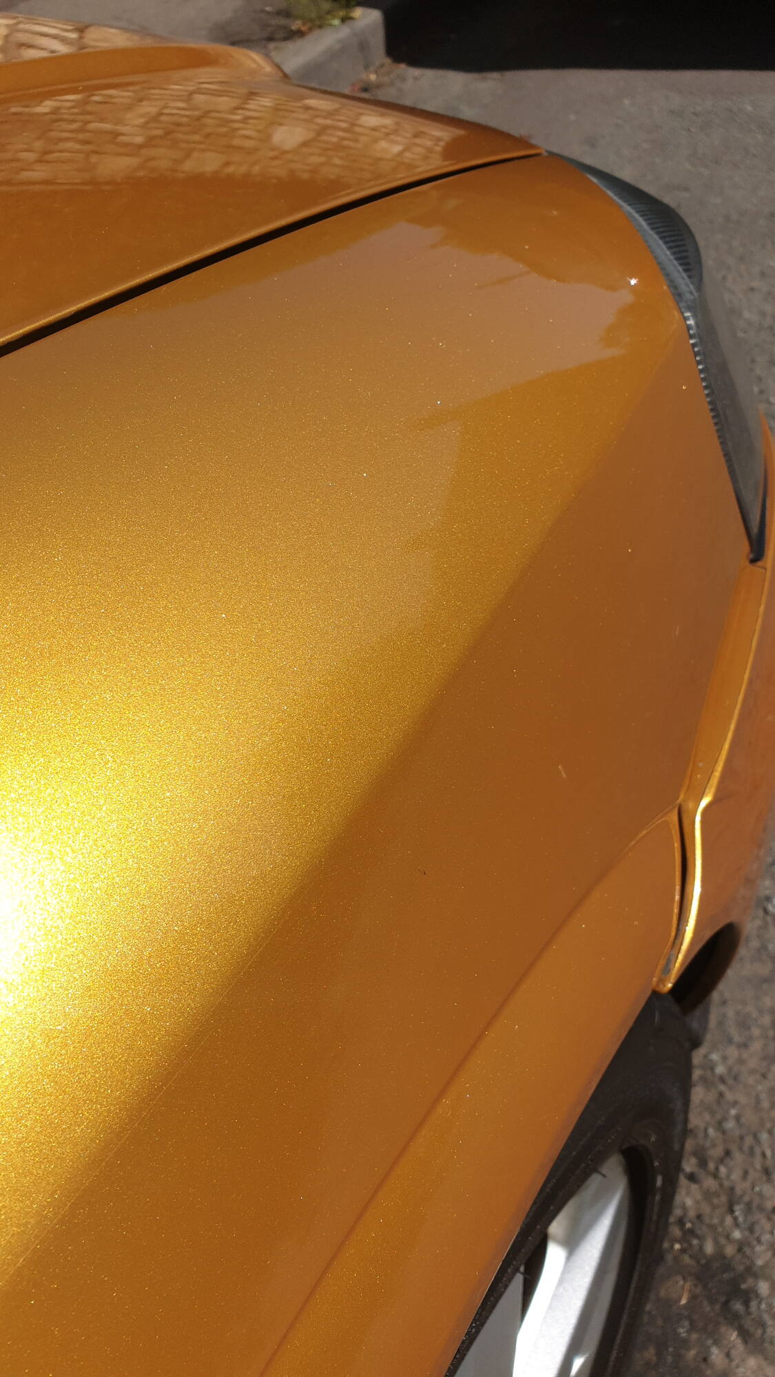

Cookiesouwest Posted May 30, 2020 Author Posted May 30, 2020 The paint really pops in the sunlight, after a polish CreepingJesus, BL Bloke, paulplom and 2 others 5

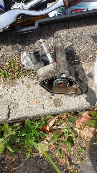

Cookiesouwest Posted June 1, 2020 Author Posted June 1, 2020 Advice needed. Took Shirley out for a 20 mile drive. Did drive quite 'briskly'. When I got out of car and was walking past rear offside wheel, I felt a lot of heat. Wheel was too hot to touch. Sticking caliper? Wheel bearing? Car drove and braked fine. The other wheels were warm, but not melt your fingertips warm.
Split_Pin Posted June 1, 2020 Posted June 1, 2020 Likely sticking caliper from lack of use. I had to replace one on the Mini because of exactly this. You will need a wind back tool to wind the piston in, not dear from eBay I don't think. If you try and push the piston in you will ruin it. There are 2 types of caliper. Helpfully I cannot remember the name of each nor the visual differences which are supposed to be quite clear from memory. I think one type has a finned surface but I could be wrong. Cookiesouwest 1

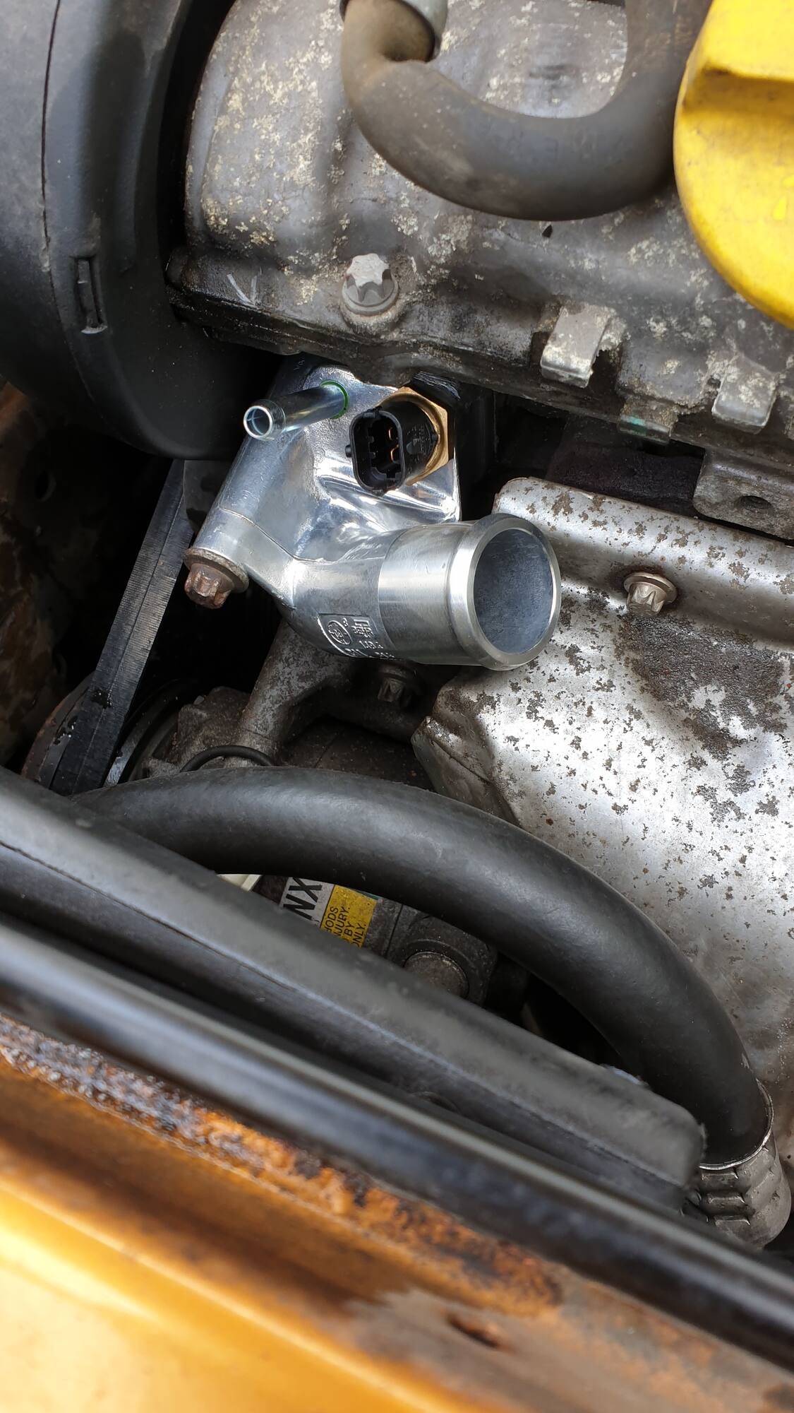

Cookiesouwest Posted June 3, 2020 Author Posted June 3, 2020 Parts have started to arrive Thermostat Plugs Coil pack Outside temperature sensor Window switch Still to arrive Bonnet lifters - ok not OE but I like them Rear discs, pads and calipers timolloyd, Tickman and Split_Pin 3

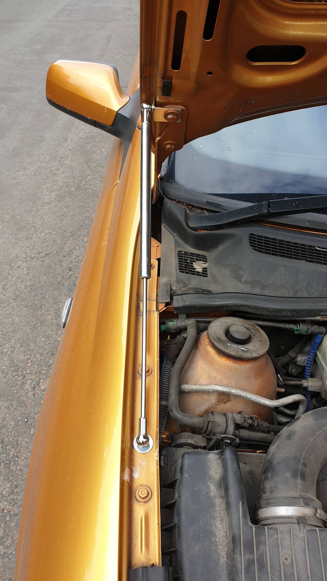

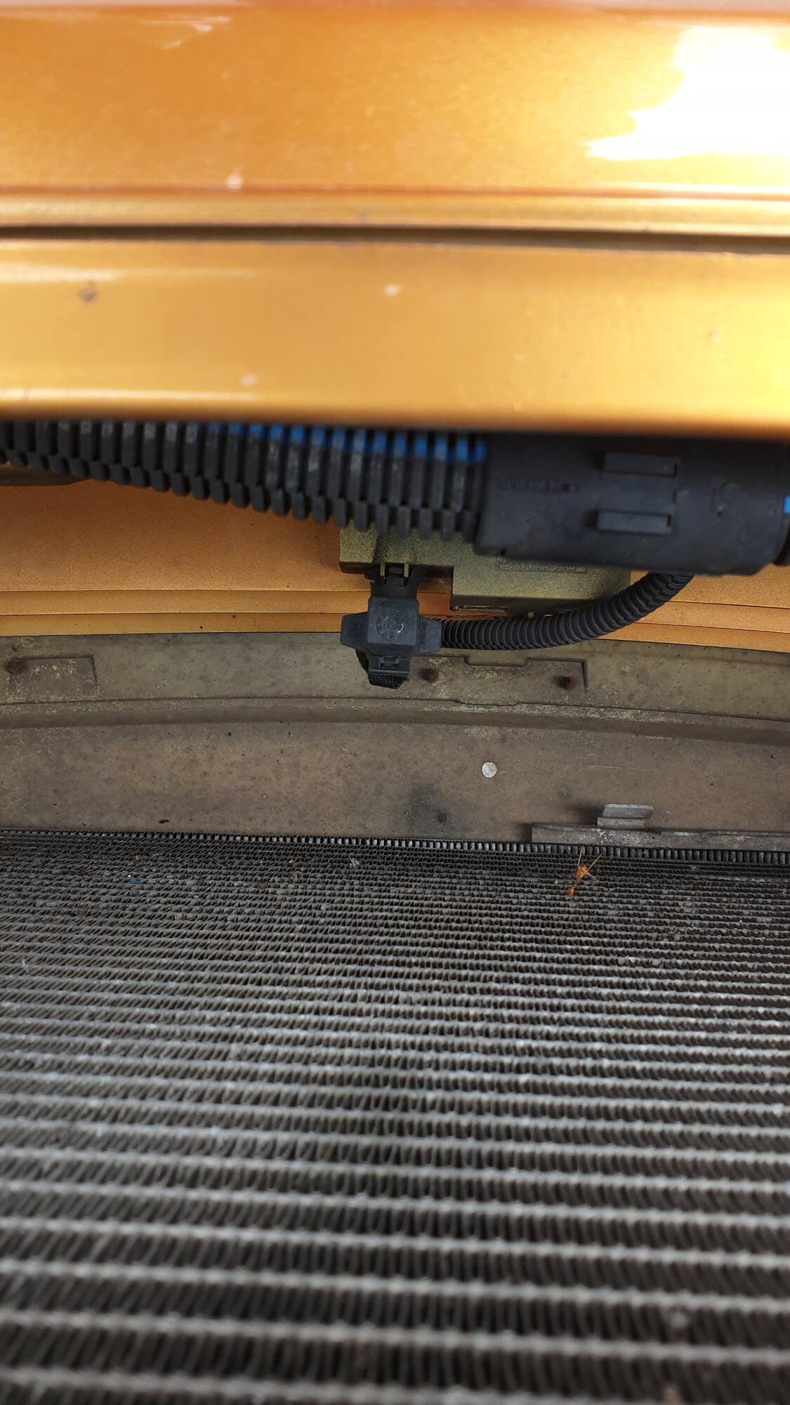

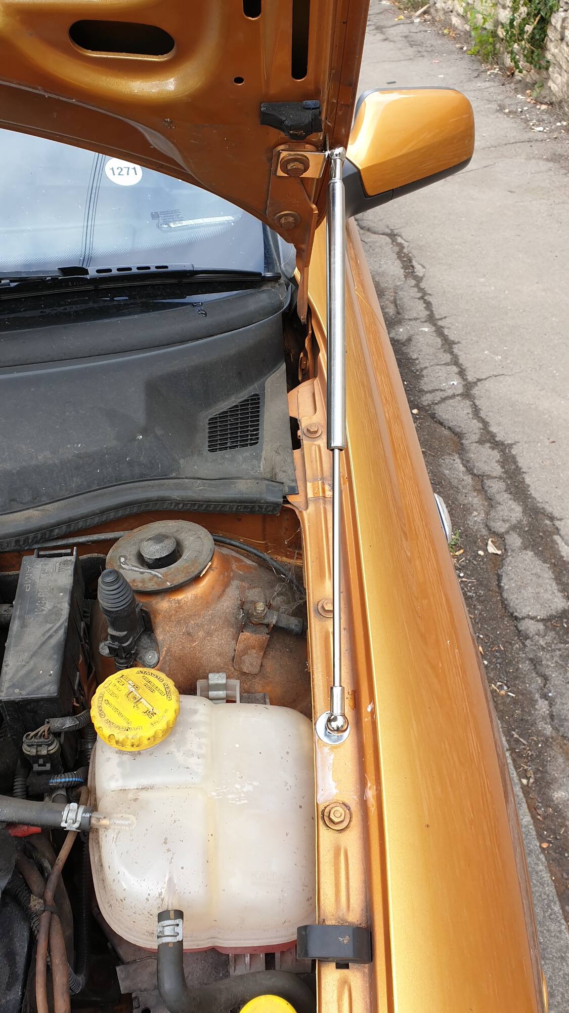

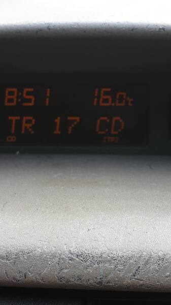

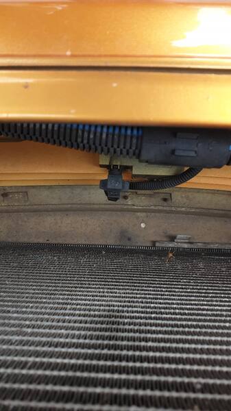

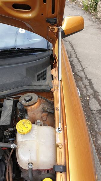

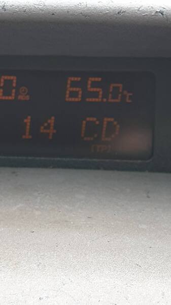

Cookiesouwest Posted June 6, 2020 Author Posted June 6, 2020 Most parts have arrived. Just waiting for rear calipers and a spark plug socket, because I'm a dick and lost mine. First up - bonnet lifters. Not actually needed, but I like them. Takes me back to my yoof and max power days Next up - outside temp sensor The current sensor shows a temp of between 50 and 73c. I know it's been hot lately but not that bloody hot. The old one, located on rear of front bumper Easy to replace - thankfully - unplug the loom and pull out the old sensor. As HBOL says fitting is a reverse of removal. And now, I know what the real temperature is. Once Amazon turn up with my spark plug socket, Shirley can have her new plugs and coil pack. paulplom, BL Bloke, scdan4 and 2 others 5

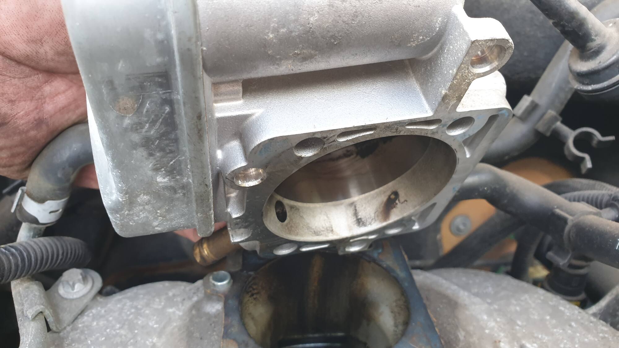

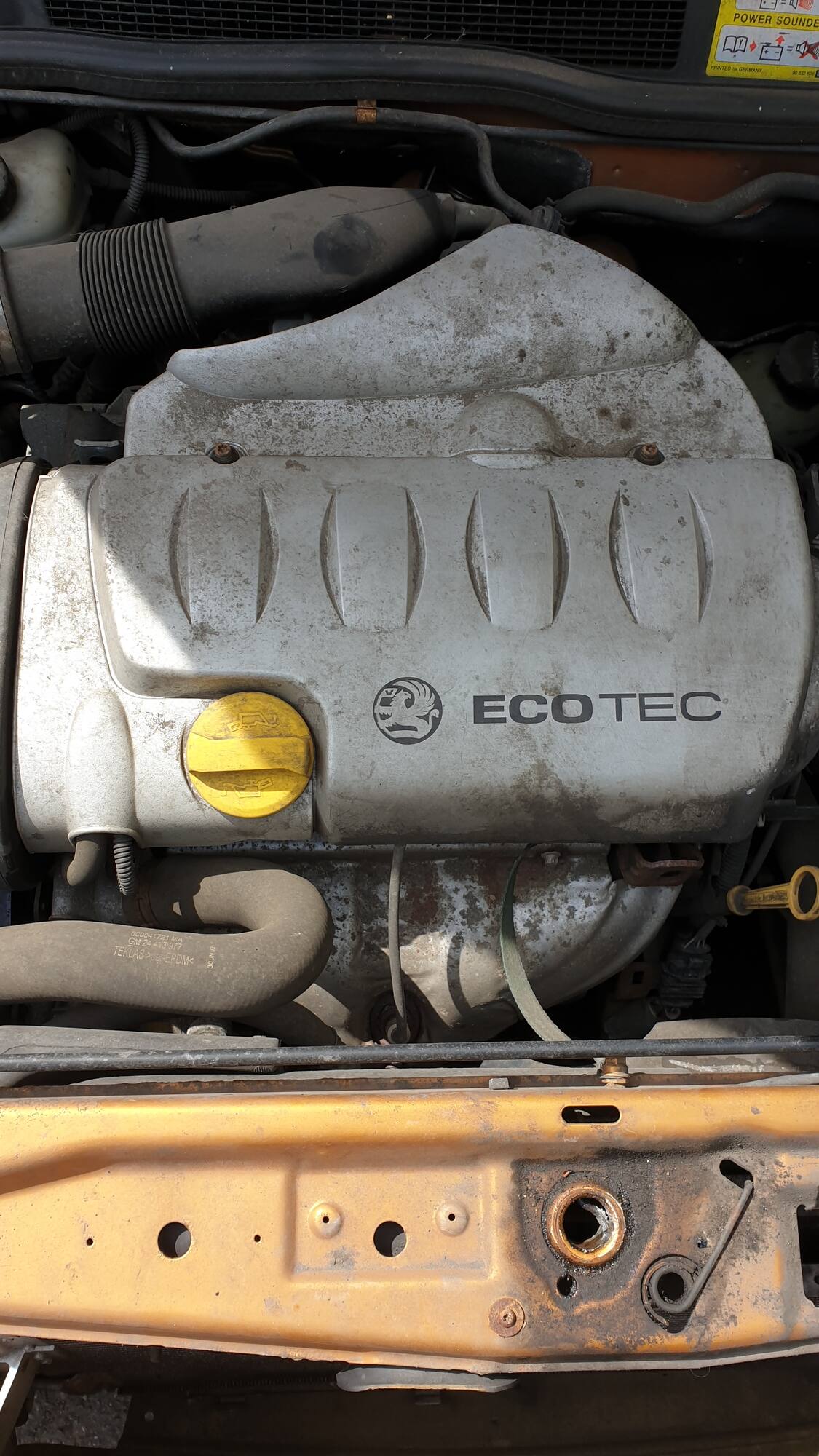

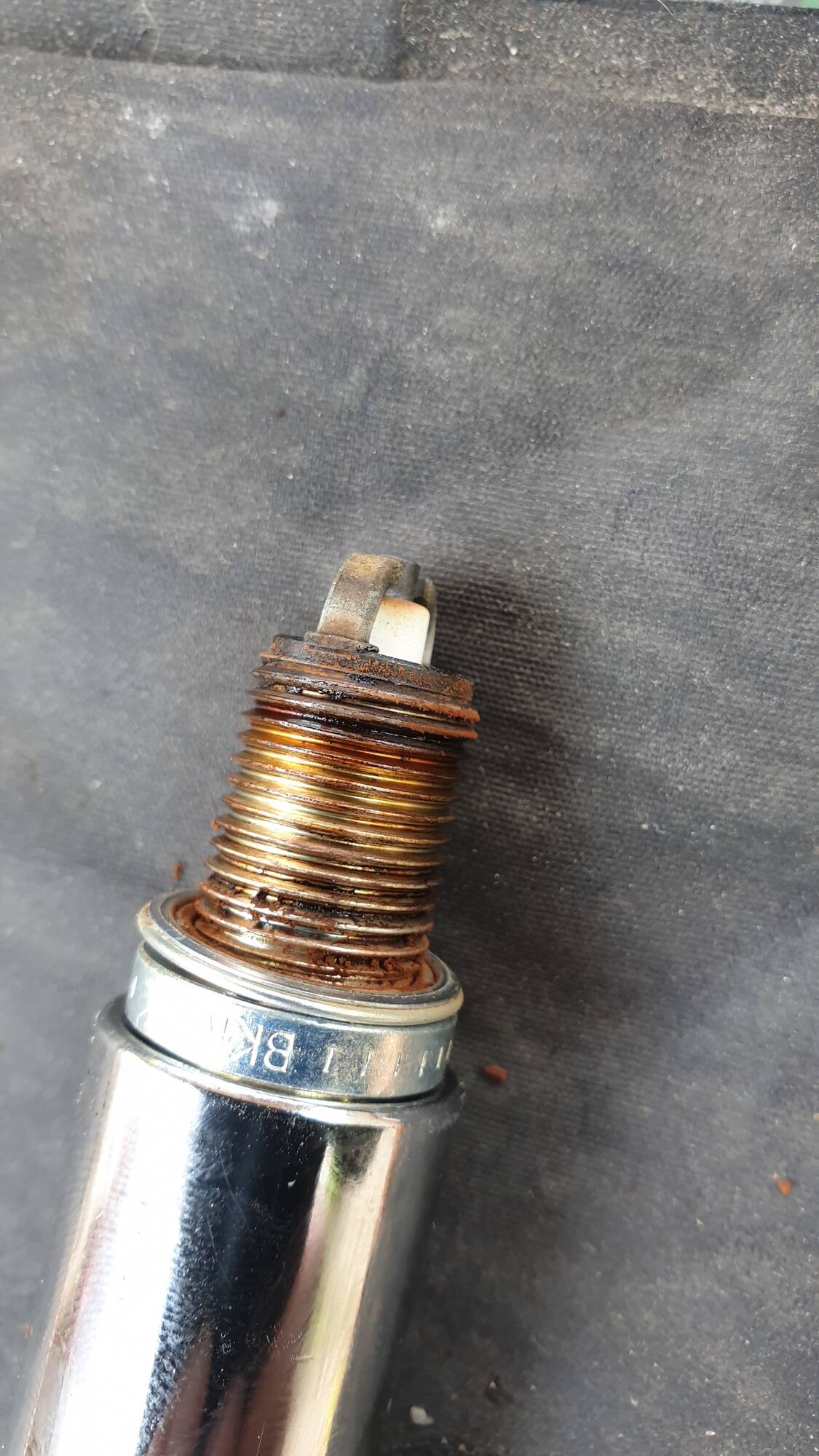

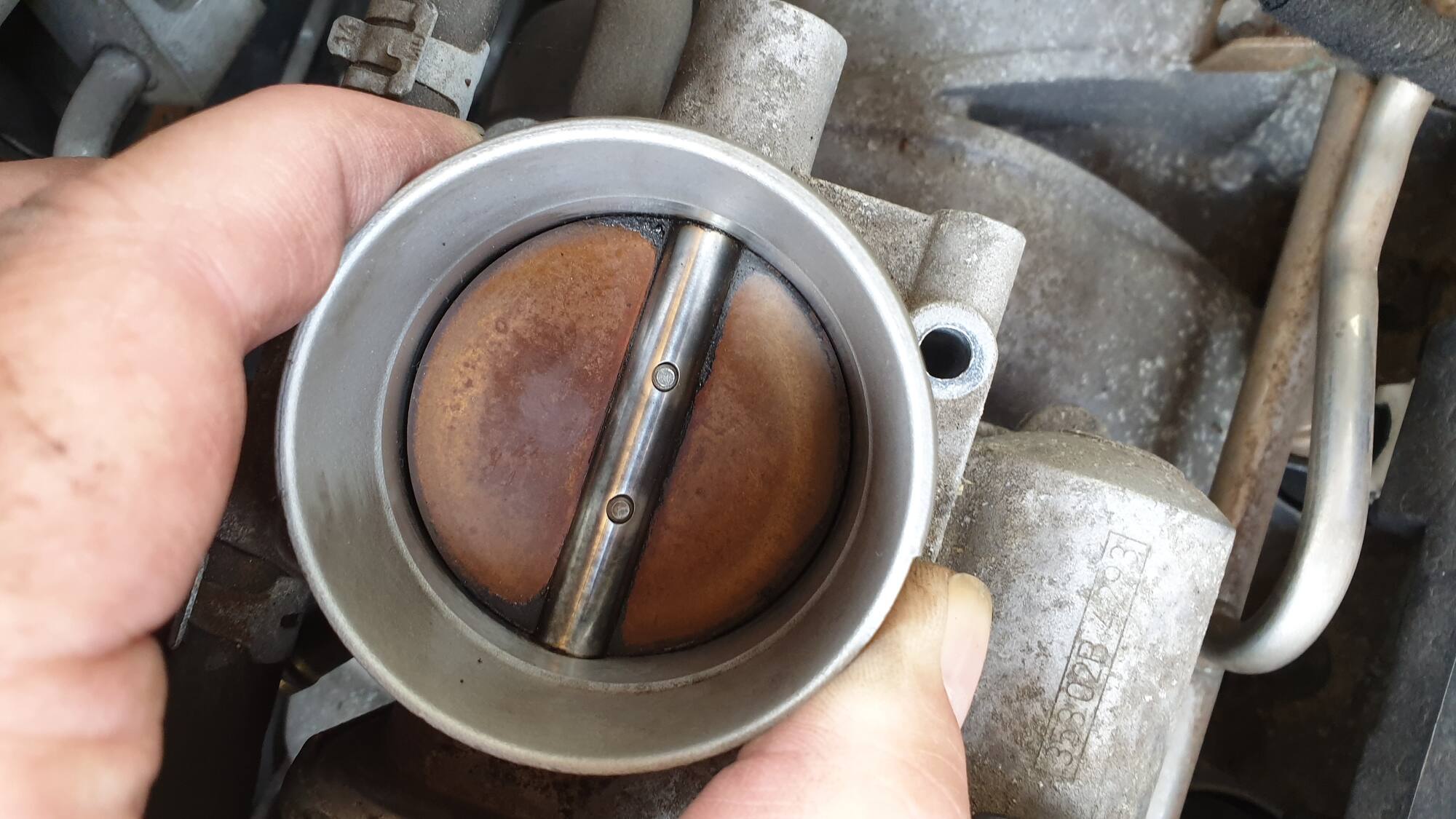

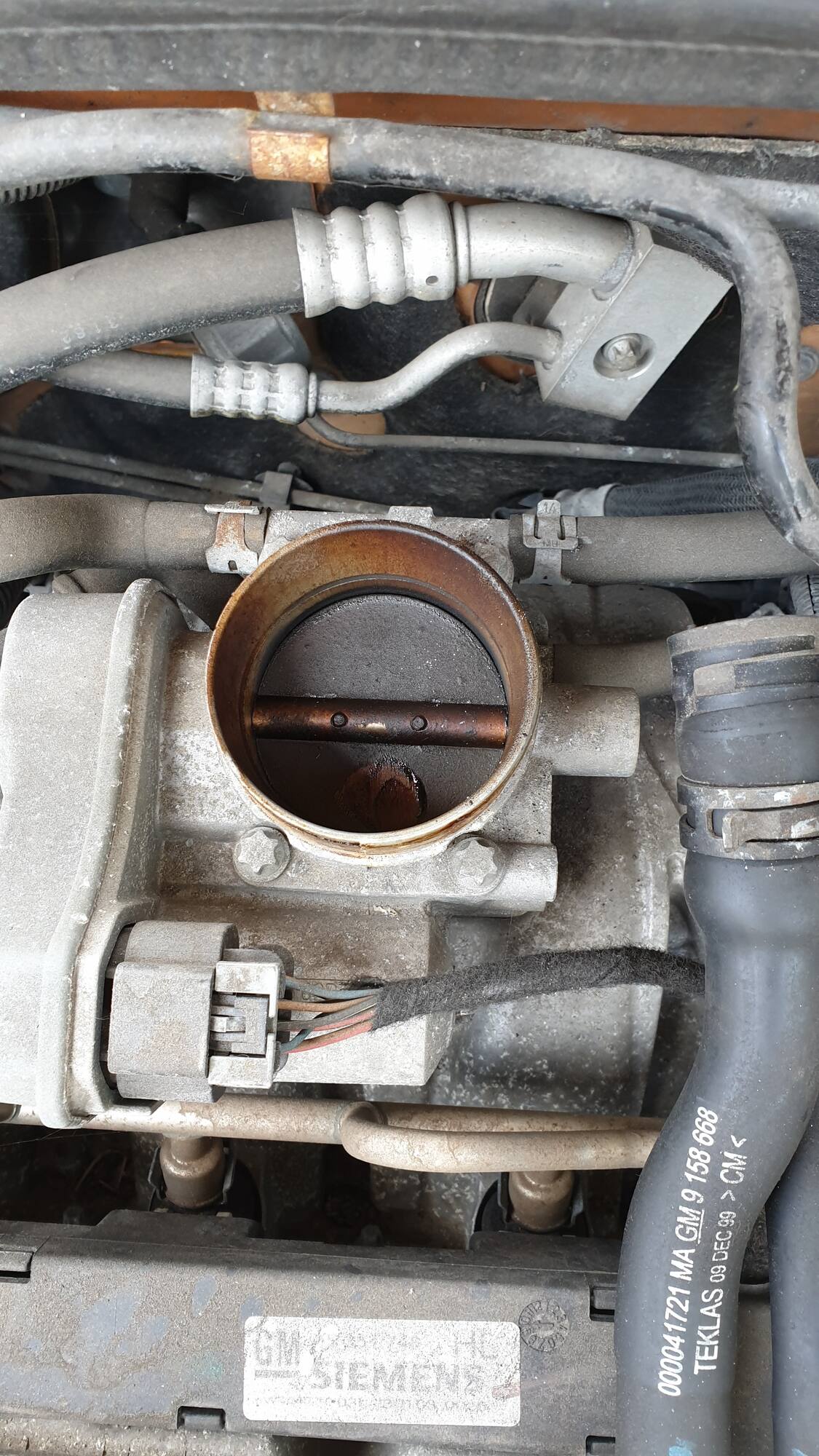

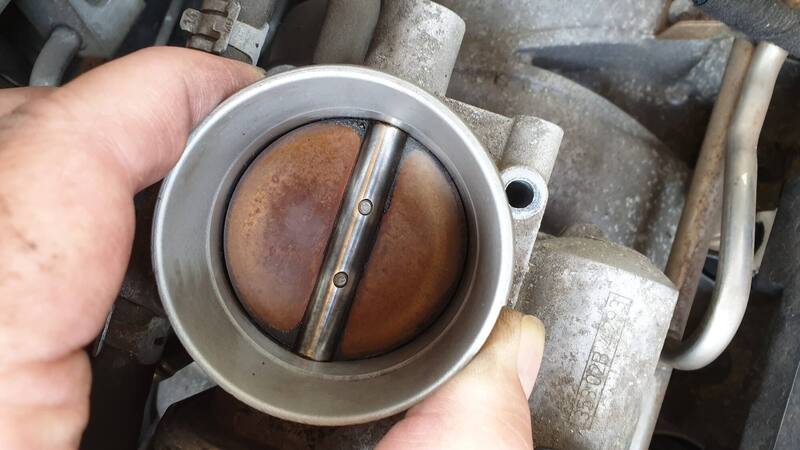

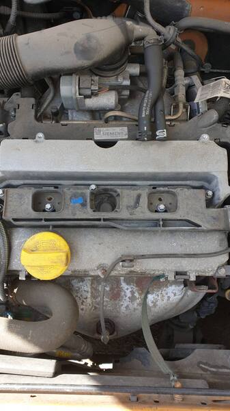

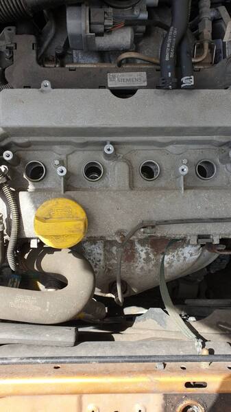

Cookiesouwest Posted June 9, 2020 Author Posted June 9, 2020 All parts now received. Time to give Shirley, some attention. Remove engine cover. Nice and easy, as I ain't no mechanic lol Unplug coil pack from loom and remove. Took a bit of effort, it was on very snugly Then remove the plugs. I wont bore you with pics of all 4. They all looked like this. Not as bad as I was expecting tbh New plugs put in and replacement (used) coil pack attached. Then on to the throttle body. It was a bit manky. Didn't have any brake cleaner, so used WD40 Then took Shirley for a spin. The flat spot at 3k has gone but now has a very big flat spot at 4.5k. Either I've not cleaned the throttle body well enough or I have another issue (possibly fuelling). Car is off to garage on Thursday for fuel filter and oil change. So I will see how she runs after that. Then engine cover off again, to tackle the thermostat. The old one still had movement, so I can only assume the reason for cold running was the sensor. Put the new GM one in, as it comes with a new sensor. Topped up coolant. Took her for a thrash, then topped up coolant again - Vauxhall's self bleed which is good. Also looked at exhaust and most of it seems quite new, which was a pleasant surprise. It is blowing slightly near the front. Garage can investigate on Thursday. paulplom, andyberg, Robson3022 and 3 others 6

Cookiesouwest Posted August 19, 2020 Author Posted August 19, 2020 Well Shirley hasn't been driven since June. She's been started regularly, to keep battery topped up. The binding rear caliper made her undriveable. Sadly due to work / holibobs / weather, I was not able to put her new rear brakes on. So I bit the bullet and she was delivered to Angry Parrot this morning, to have both rear calipers / discs / pads changed. I think one of the fronts is a bit sticky too, but will have a better idea, when she gets taken for a thrash tonight. Tickman and Split_Pin 2
Cookiesouwest Posted August 20, 2020 Author Posted August 20, 2020 Shirley now has shiny new rear calipers / discs and pads. Brake pedal is a bit soft, but will wait for the rear pads to bed in, before returning to garage and requesting a re-bleed. Gave her a blast last night. Hesitation is still there, so I do need to bite bullet and follow @Split_Pin advice and bung a MAF on. Payday next week. On plus side, now the brakes aren't on all the time, she is a lot quicker Shirley now owes me 1277. I supplied the brake parts and it took 2 1/2 hrs labour (62 quid) to change. Fair to say that a large hammer and lots of swearing occurred. Due to the heat caused by sticking calipers, things had become very stuck together. timolloyd, Split_Pin and Tickman 3

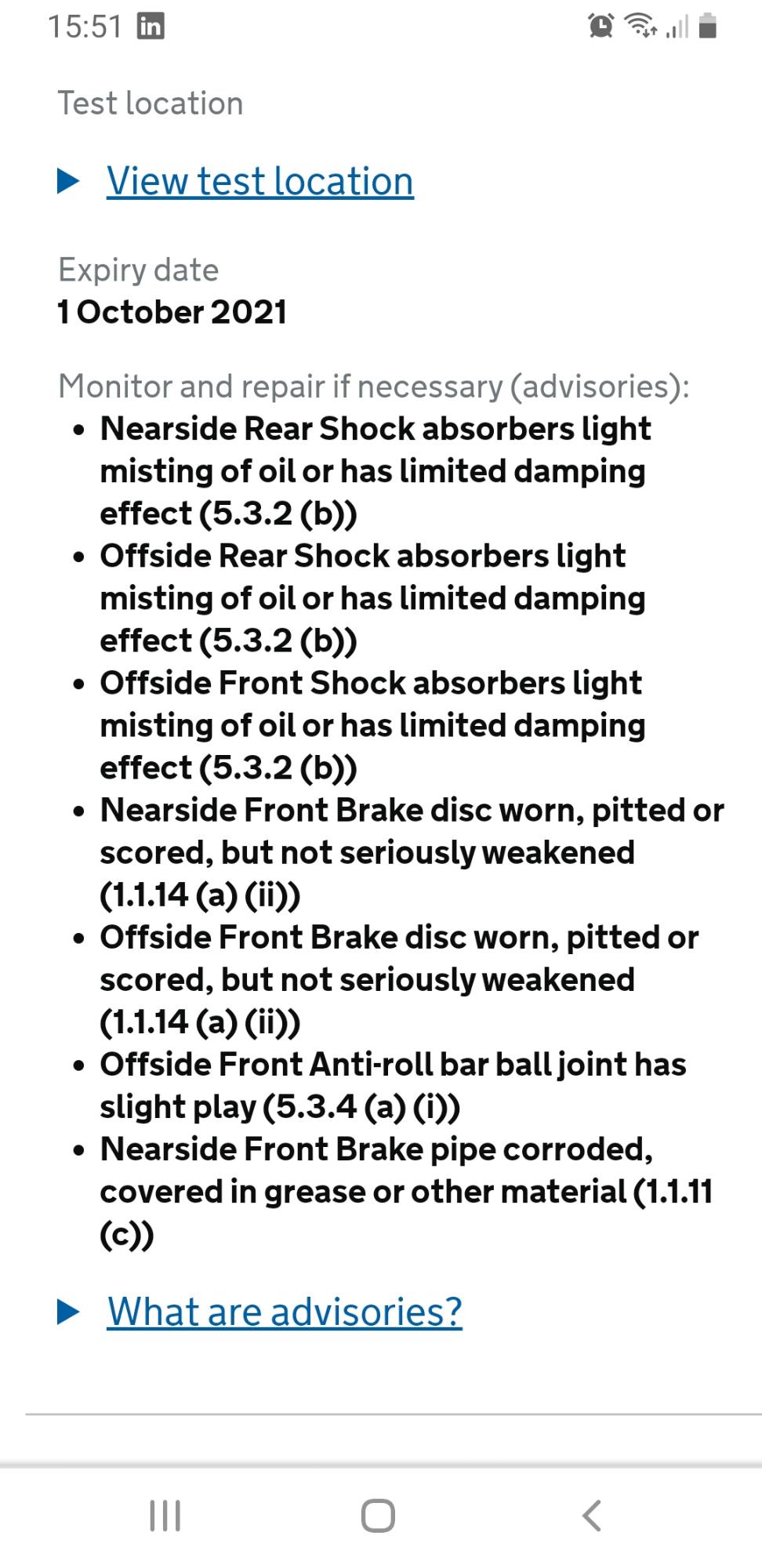

Cookiesouwest Posted September 28, 2020 Author Posted September 28, 2020 The 500 mile report. Yes I know, she's not getting used enough. Anyway today was MOT day and blimey she passed. Does have a few (cough) advisories. The shocks may explain, why she is a bit crashy lol timolloyd, Vince70, Tickman and 1 other 4

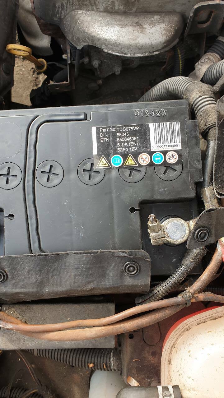

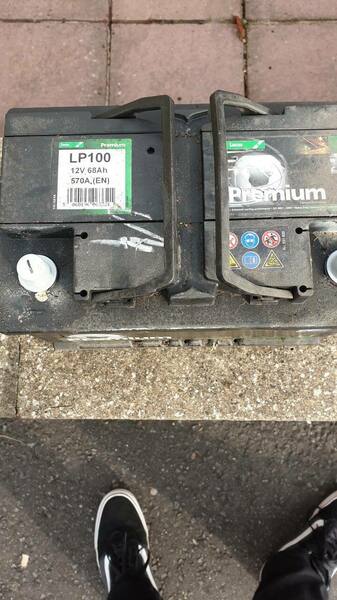

Cookiesouwest Posted November 8, 2020 Author Posted November 8, 2020 Quick update. Knackered battery and failed headlight bulb. Quite a lot of swearing involved so didn't take pics except the two below. The new battery is 075, which is meant to be correct, but a lot bloody smaller than the one that came off. Old New No pics of bulb change because I forgot. Next job is the rear shocks. About 200 to pick from on Autodoc, so will select via lucky dip HMC and Split_Pin 2
