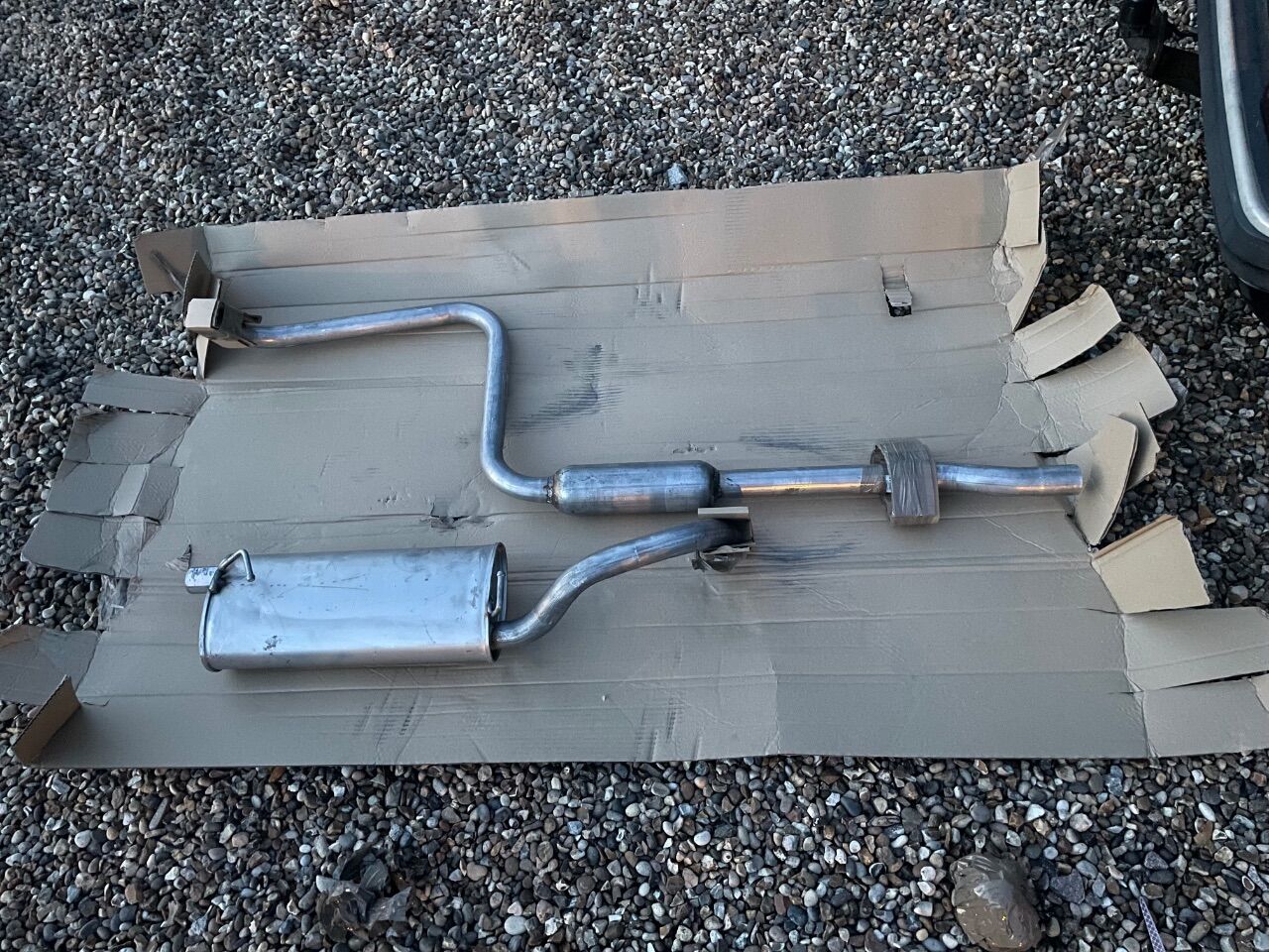

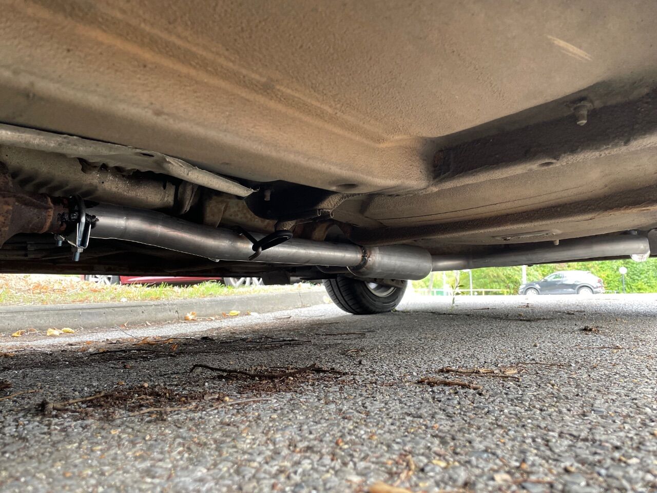

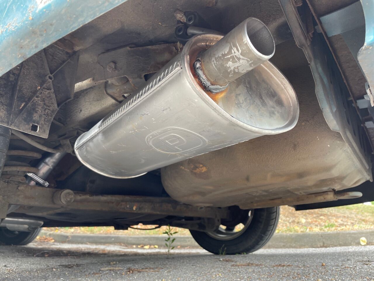

In the meantime the Volvo exhaust is sorted.
This exhaust was brought to you by the letter P
The previous AutoDoc exhaust only lasted about 5 years, but the car did a fair bit of standing which exhausts never really like. Having fitted a pattern exhaust last time by myself on axle stands in the gravel I had vowed never to fit an exhaust again. So a garage fitted this.
It’s not a bad job but I’m not 100% happy as it knocks the body if you get the revs wrong or thump through the gears. I probably need new engine mounts and some bracket tweaking as the old exhaust didn’t knock quite so much.
Also the tip wasn’t the best fit, but this photo sort of exaggerates it.
  • rob88h changed the title to Harrison's Garage - XM and 440
I once fitted a wrong centre section to my zx (was a 1.9td and I got a 1.9d part). Fitted it and a tiny edge of it hit the body in the exhaust tunnel 😂
Drove around for a month with it droning away getting louder the faster I went until a mate welded up my 1.9td centre section and I could refit that!
Let it drone for a few days then see if you can spot a witness mark anywhere,  then smack the car/exhaust there? I did that after 2 weeks and it helped a bit

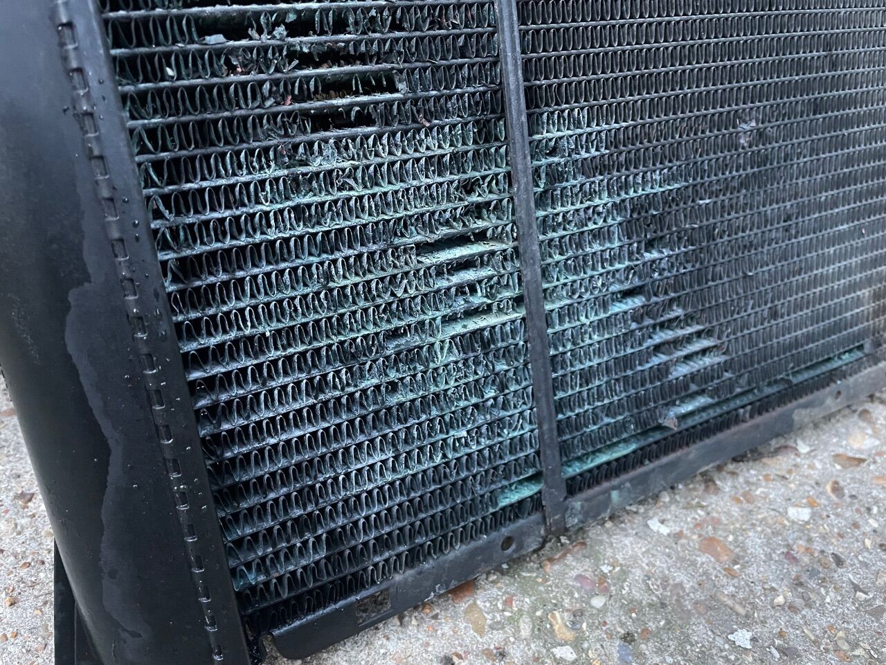

The Xantia radiator has arrived for the XM and it “looks” like it’ll work. First though I needed to shuffle the cars to give the XM a suitable spot to die for working on.
…I struggled to get the first car moved. Bastard.

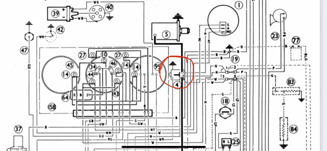

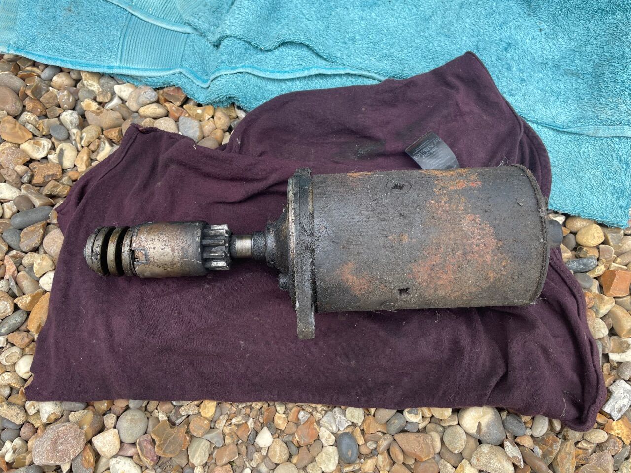

The Mini had tried to start (off a spare battery) then seemed to completely die. No ignition lights, nothing. I chased 12v through the starter solenoid and steering column but could no longer get ignition lights or solenoid clicks. I was pretty puzzled, as everything seemed fine as I worked my way with a wiring diagram from the battery to the starter, through the key, fuse box and solenoid, cleaning up and greasing connections as I went. After quite a while with no success I tried 12V directly to the starter and still got nothing. So out it came.
It didn’t sit right that powering this thing straight from a battery had elicited no life whatsoever, not even sparking as the leads touched, so I tried with a different set of jump leads and lo behold is danced around the floor like a mad one.
I then did a resistance check on my jump leads and the negative lead I had been using had something like 100 times more resistance than the positive one and my two other newer leads. Great... If it’d been completely broken with no continuity I’d have not got 12V everywhere, but under a load the resistance was too high to allow any current draw. I’d been looking for bad earths all day and only thought to check the jump leads right at the end having tried just about every where else.
I put the starter back in the car and using the good leads the Mini sprang straight to life. Looking for the positive (unintended pun), at least I have a lot of cleaned and protected terminals now.

Excited to take the nose cone off the XM I started working my way round it left to right to find that the (practically) penultimate fastener of the job that fits to a captive nut inside a box section was just spinning. (The Torx bit through the tow eye).
This nose isn’t coming off then without drilling that out so I resorted to posting the rad out instead.
Amazingly I spilled no coolant thanks to the handy little drain tap.
With the oil cooler and hoses off the rad (boiling water softening hoses for removal for the win) I was able to pull up the radiator and leave the intercooler in place.
Old vs. New.
The core tube dimensions are quite different and the general quality of (what I think could be) the original radiator is/was clearly better. It’s a pity; I hate buying cheap parts, but it is better than no parts and this new one should probably see the car out.

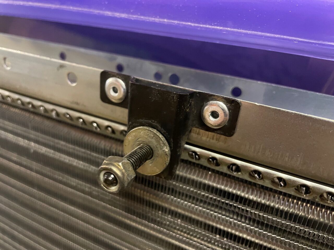

 There is a bracket for the oil cooler that’s pop riveted to the old radiator that I need to drill out and transfer to the new radiator. I need to get a new tool for doing that so I’ve stoped here for the moment.
A few fins down over the years!
And because the XM is boss level diva, the Hydroactive is in fault again. It was a firm ride home bringing it back for the radiator work. While it’s on four axle stands I plan to lubricate the height corrector with silicone spray given the last error code, then drop it down, do a bunch of citroebatics then read and reset the codes again to see what we’ve got.
Satisfying step: transferring the oil cooler bracket to the new radiator using exactly the right dimensioned rivets.
I enjoyed that way more than I should have done.
That allowed me a to reinstall the “shiny new”. I made it a personal mission to not bend any fins and succeeded.
Using my hose softening kit the hoses slid back on no trouble.
I need to finish off a big bottle of pop  for the bleed process, so I’ll know if it leaks when I get a chance to have a go in a few days. The split lines left by the injection molding on the spigots aren’t great, but they shouldn’t cause a leak. Hopefully.

Ive noticed the trend of the crap large bar core aftermarket radiators lately. They cool poorly compared to originals with lots of small bars in. Id imagine due to size of this rad, it will prob be fine temp wise but worth keeping an eye on.
Yeah, it’s not great. The original Valeo one was clearly better, but at least this one *exists*. It’ll be fine for my use I should think. I can’t see a situation where I’m flogging it up hill towing in the South of France, but a man can dream.

You will be well versed in radiator design then 😁 as you say its prob the only design available now and will be fine for intended use. From memory they used to run cool ish as stock too.
I had same newer design rad on my r26 megane and it was straight up/over 100deg on a full throttle pull. Oem is nla, eventually found used oem which sorted it out. All rads seem to be made on the cheap these days sadly.

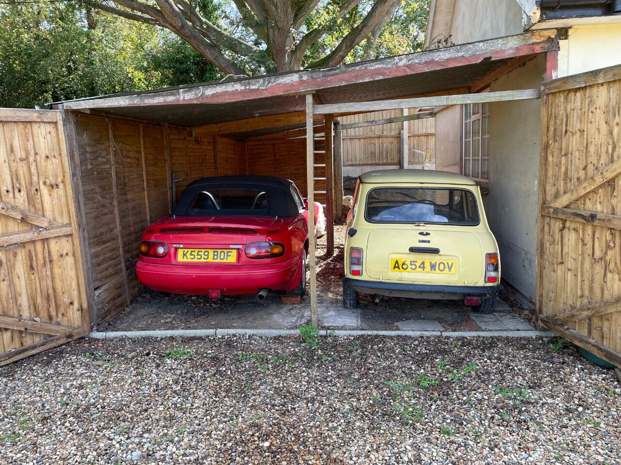

For good measure, in trying to prep the rammel for winter I discovered that if I put the Mini in the other shed “bay” then the MX5 will fit in there too.
Fired up, reversed out, and then just completely died. No ignition lights! Nothing! Just like before. My jump lead was definitely dead before, with very high resistance, but this is more than a coincidence, something else is at play here.
I think it could be (4) the Starter Solenoid given that the main 12V comes through here from the battery and it’s also carrying ignition switch positions. And to corroborate this when I tapped it everything came back to life... It’s not so scientific though as I tapped a lot of things and probably kicked the ungrateful sod to boot.
With it running though I got it and the MX5 under temporary cover for winter. Yes, there’s a rather large hole in the shed where a mighty limb of the tree fell through. Work in progress!

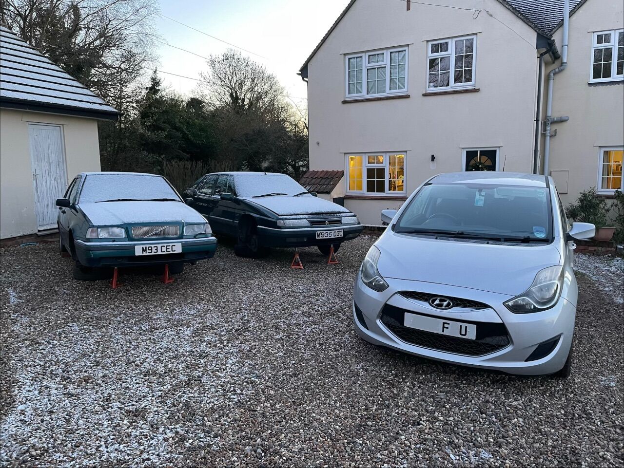

We find our hero out in the dark and the cold rain at 10pm on December the 1st, headtorch donned, fighting to get child seats into the back of a Volvo 440. The seatbelts are only just long enough, so he has to basically push all his weight into them to squish the seat foam enough to get the belts through all the various clips and eyes.

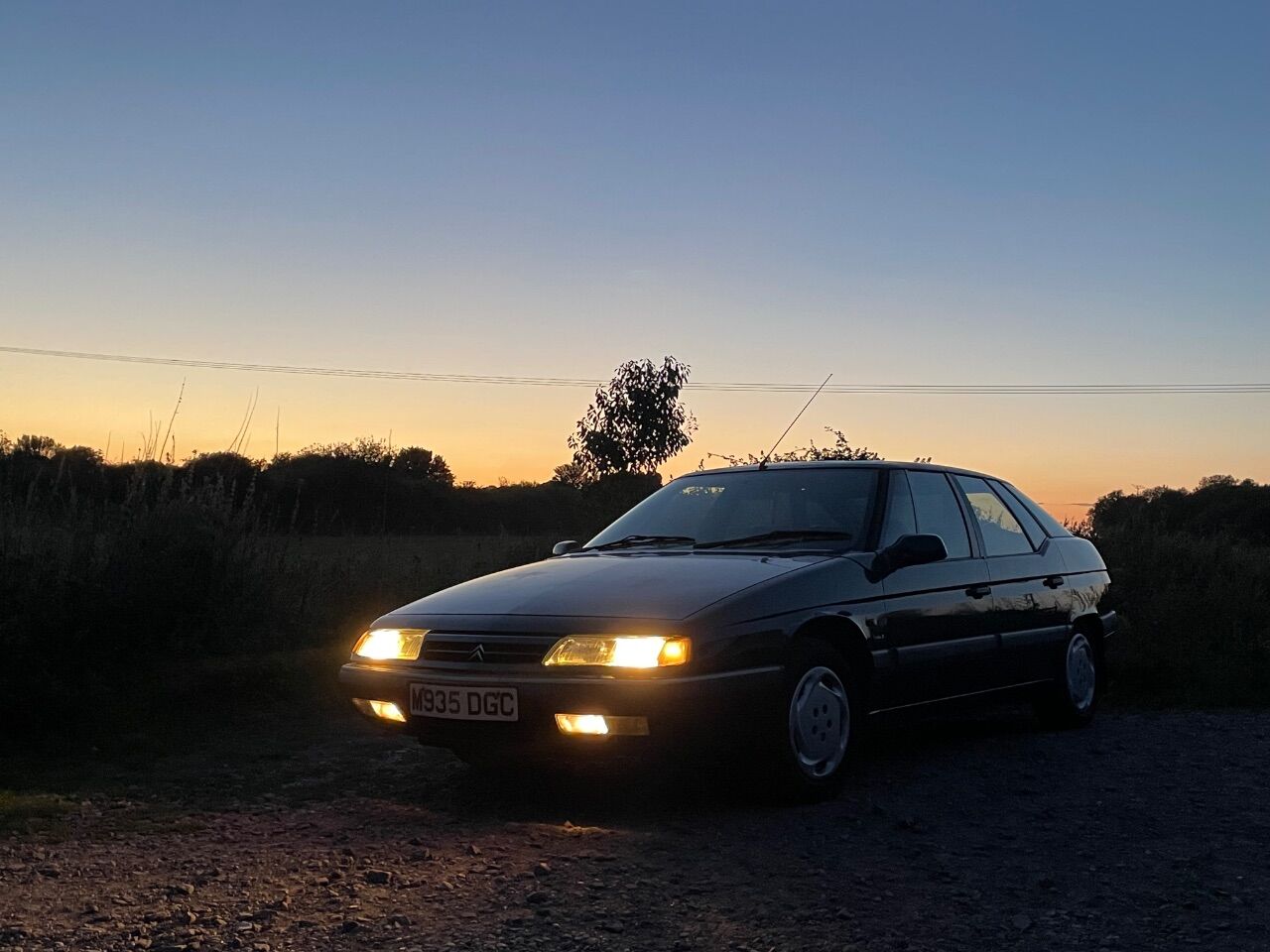

I’d tried to do something nice for the XM. Since the radiator the last few months have provided nearly 5,000 trouble free* (ok, low level trouble) miles. The exhaust is blowing, but I’ve failed to rustle up the right parts, so instead I thought I’d address its propensity to understeer and ABS at quite low speeds. To whit I purchased for fitment two very fine Michelins as is proper for a proper hydropneumatic Citroen. These are replacing the Sport Chaser and the Comfort Glide or whatever the other one was.
Here it is enjoying winter sunrises, fields and lakes in its near nonstop use.
Being a bit of a character, after so long being dependable, the day(!) before its appointment with new premium front rubbers it has decided to go all break down on me.
I made the appointment by bringing just the wheels and when I was asked for the keys I simply explained the tyres are for an old Citroen and it didn’t feel like coming today. They understood.

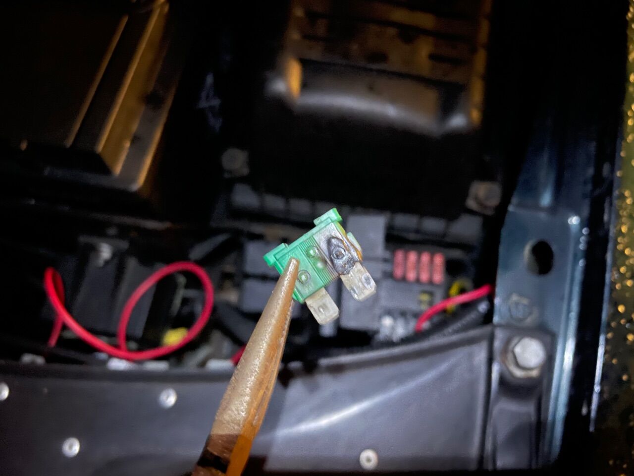

How the fault presents is that the charge light is on, fairly dimly at idle but will brighten with rpm and/or with electrical load. At certain “amounts of electricity” the passenger glovebox fusebox is singing. The rear de-mister, which is on a timer I think, unlatches when revs or electrical load increase. The heater blower is in-operative.
Interesting facts and observations on the run up to this fault include the fact that the blower was inoperative for about a minute or so on cold mornings for a few days leading up to this. I didn’t think too much of it at the time as it did always come on eventually, but now it’s completely dead. Also the key start where this first happened (the main charge problem, not the fan problem) was after locking my dogs in the car so I could pop in a shop. I never lock the car, shhh, don’t tell. It has a baffling alarm that makes no noise and it does strange things I’ve never really understood. Finally, I have had the charge light before and with some missing electricals, but that’s usually sorted by taking the key out and hokey-cokeying it.
Tests I’ve conducted this evening show while idling the battery voltage is ~14.3V, and 12.somethingV with the engine off. It was a well recorded test... So there is some level of charging actually occurring.
Also, to the blower circuit, I consulted some wiring diagrams, forums and friends and pulled engine bay fuse F2 which should be protecting the blower motor.
The fuse has done an excellent job of not blowing yet trying to catch fire.
That helps with that fault, perhaps, but with it pulled I still have this weird charge light and humming fusebox.
My instinct tells me the humming is some sort of manic-discoing-relay, as yet to be discovered. Sadly Life(tm) has only given a short time on this and in the dark and rain, a classic for the winter commuter.

I got another 20 mins on the XM this evening to try and gather more info. With my head in the footwell, this is what I’m greeted with. Even the photo was upside down! [photo uploader is being a pillock]
I checked the local earth under the A-pillar trim and it looked pretty good to be honest, thinking there might be leakage somewhere with multiple strange symptoms. Still there might be I suppose.
if I’m reading my diagram correctly then the noisy relay when everything is loaded up is “848 engine running”. That does feature in the circuit diagram for Charging, so I may be on to something - but I’m not sure if it is a symptom or a cause... With it removed I was amazed to find the engine runs just fine albeit with the charge light still illuminating, just the buzzing is gone with the relay out.
Hoping it’s ok to share the Charge system wiring digram. I didn’t make this, so credit to whoever did.
EDIT: on this diagram I also have F2 out still... In my diagnosing head that was to discount the blower motor, but I see it runs into relay 848. Maybe I should try a new 30A fuse and hope it finally succeeds in burning itself to the ground.
