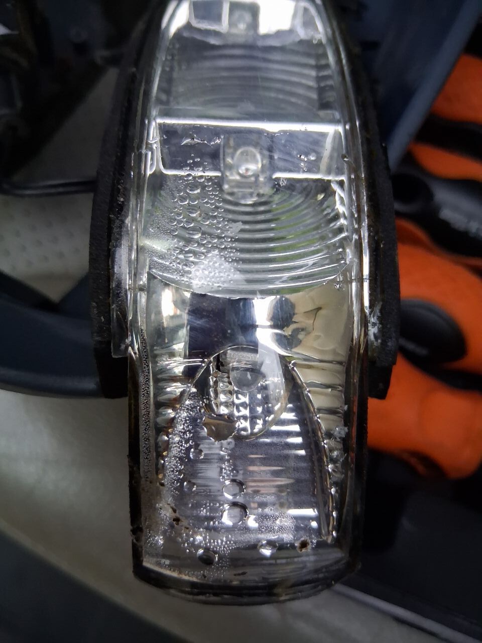

Definately water inside the light.

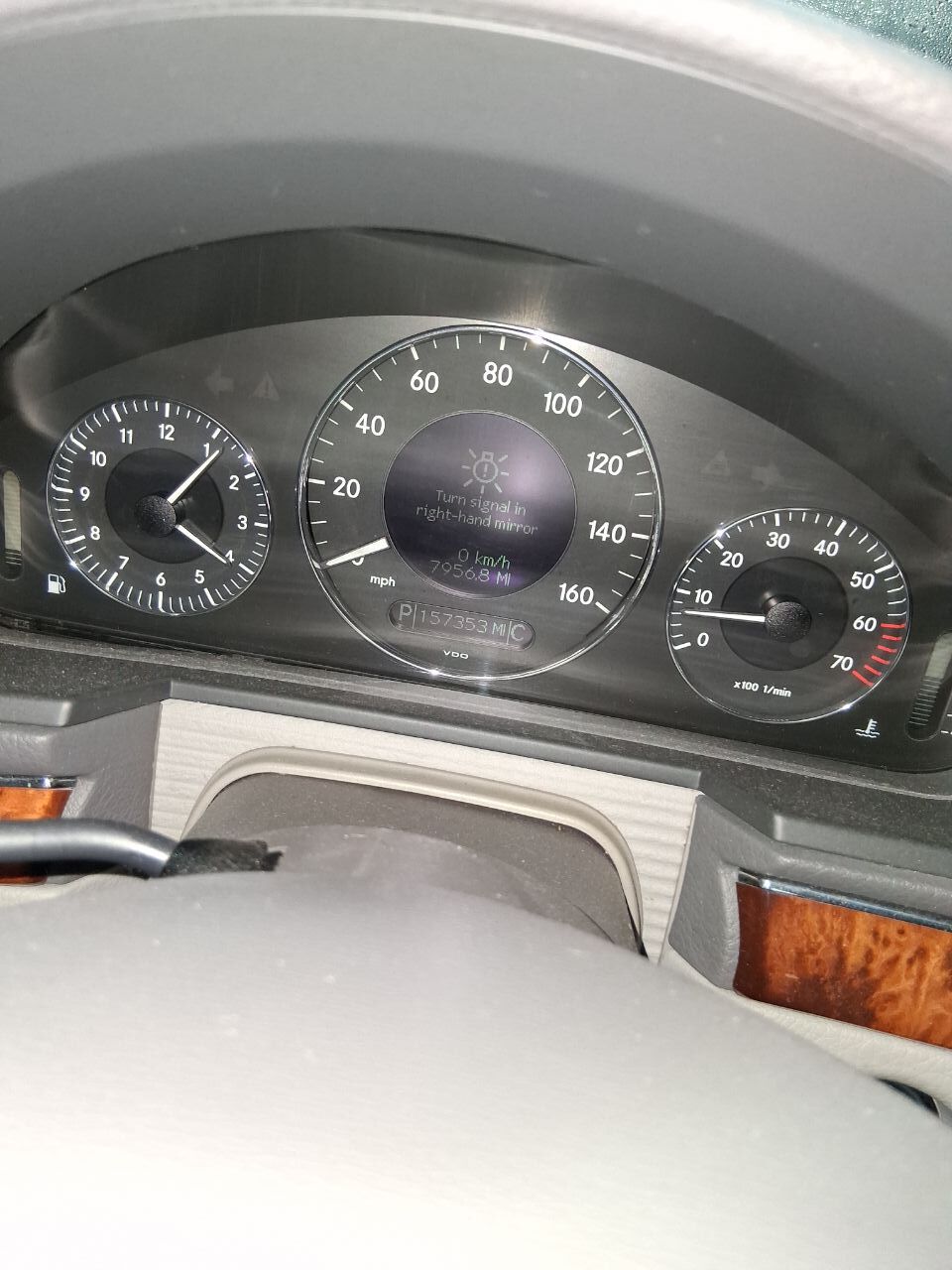

Once it was off, got a warning for the indicator being disconnected.
But the battery protection warning had gone !!
Either a co-incidence, as I had had the engine running and may have charged the auxillary battery. But a long drive this morning hadn't done that, so I dont believe that. I think the indicator had a short that was f*cking up the electrics.

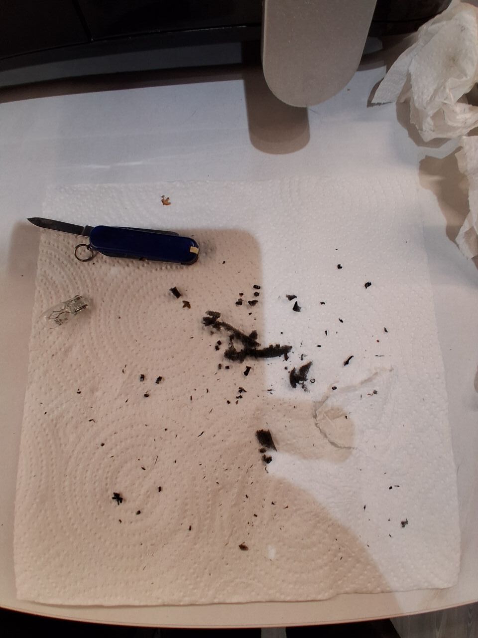

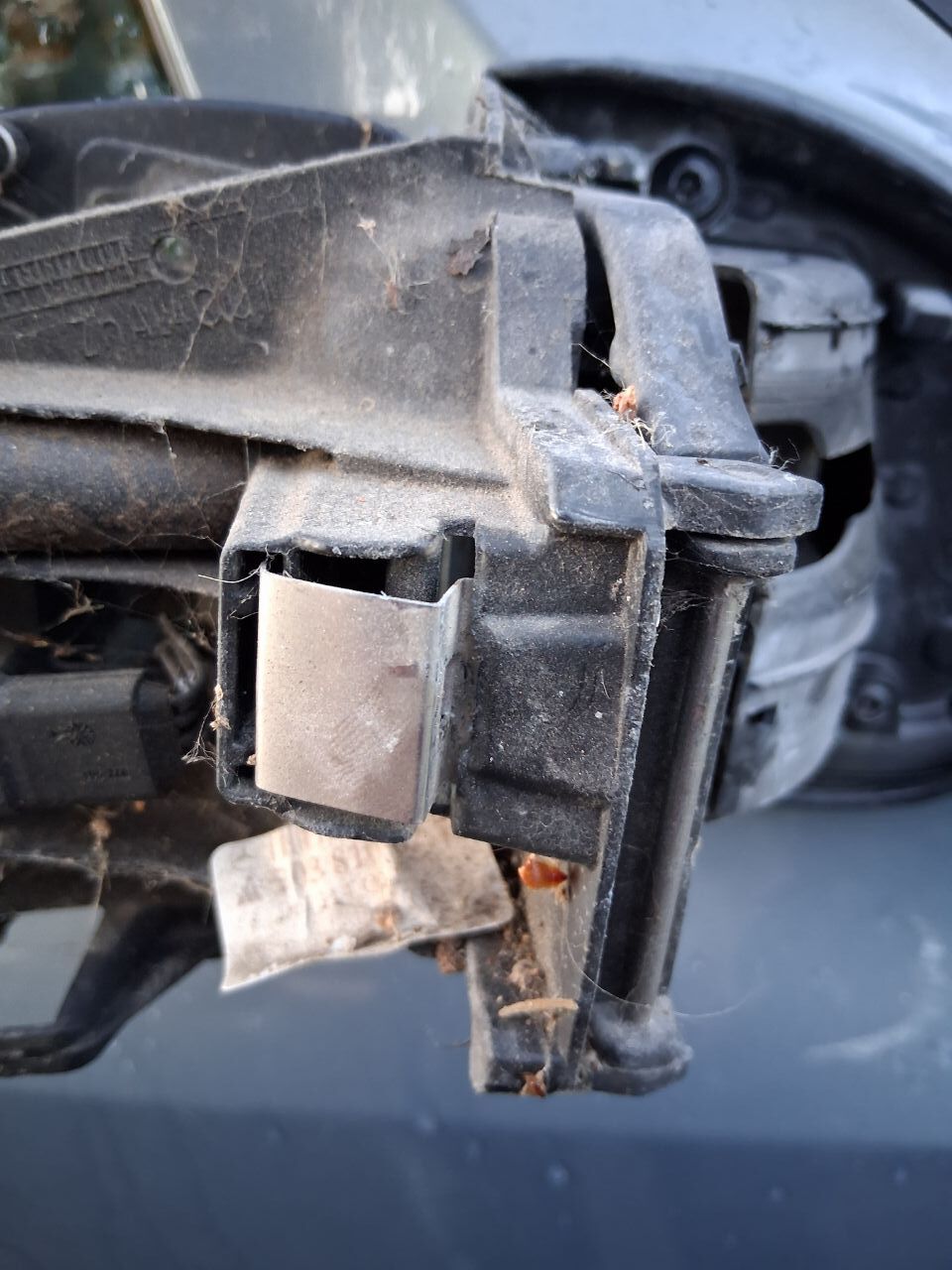

The new indicator was shit and wouldnt fit. As if the chinese engineers had seen an original but hadnt bothered measuring it or even test fitting.
I dont have a dremmel but I do have a pen knife :)
After about 45 mins of whittling plastic, it fits. Kind of. I also had to enlarge one of the screw holes.
This is how much I took off, from various places.

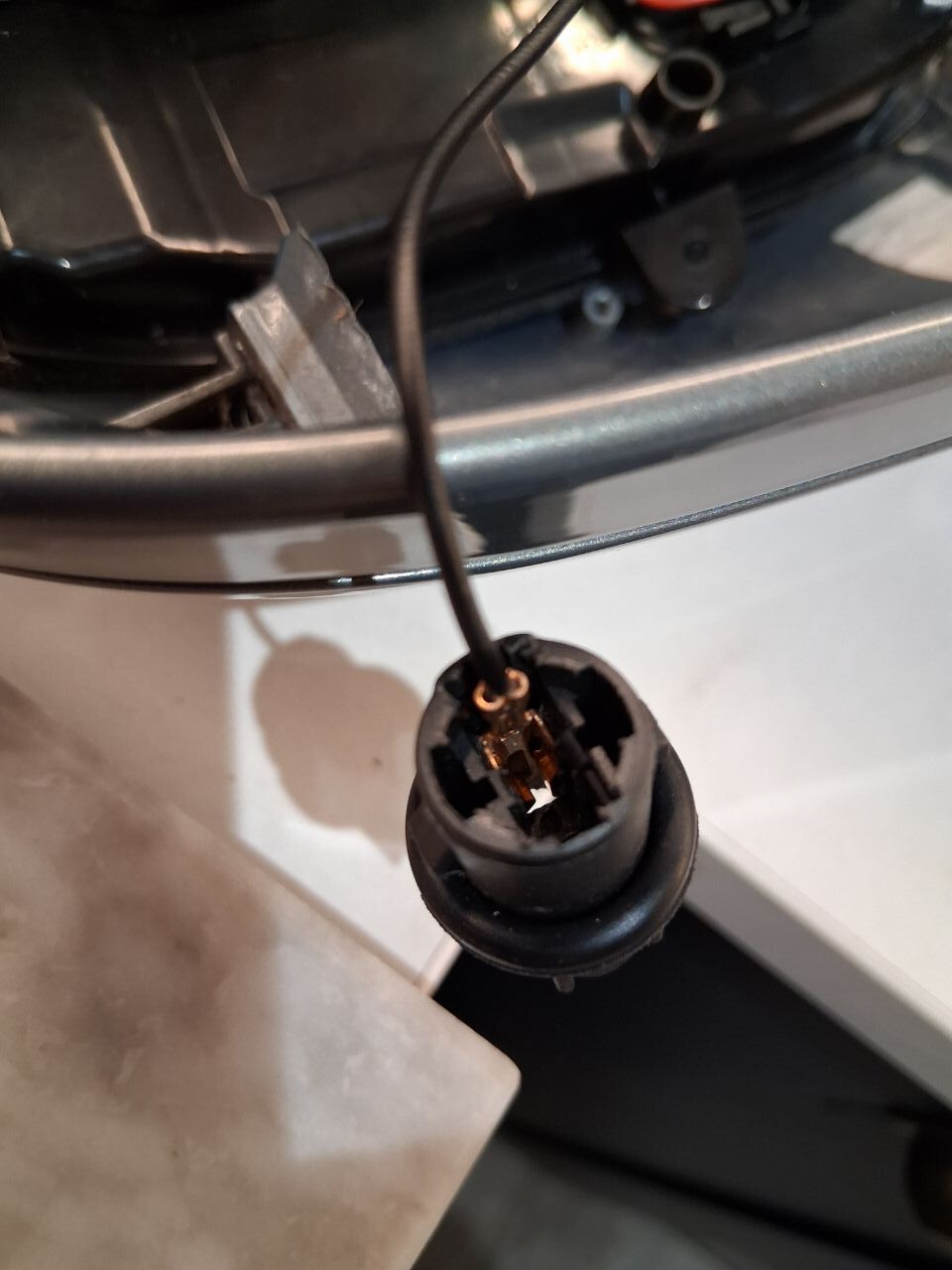

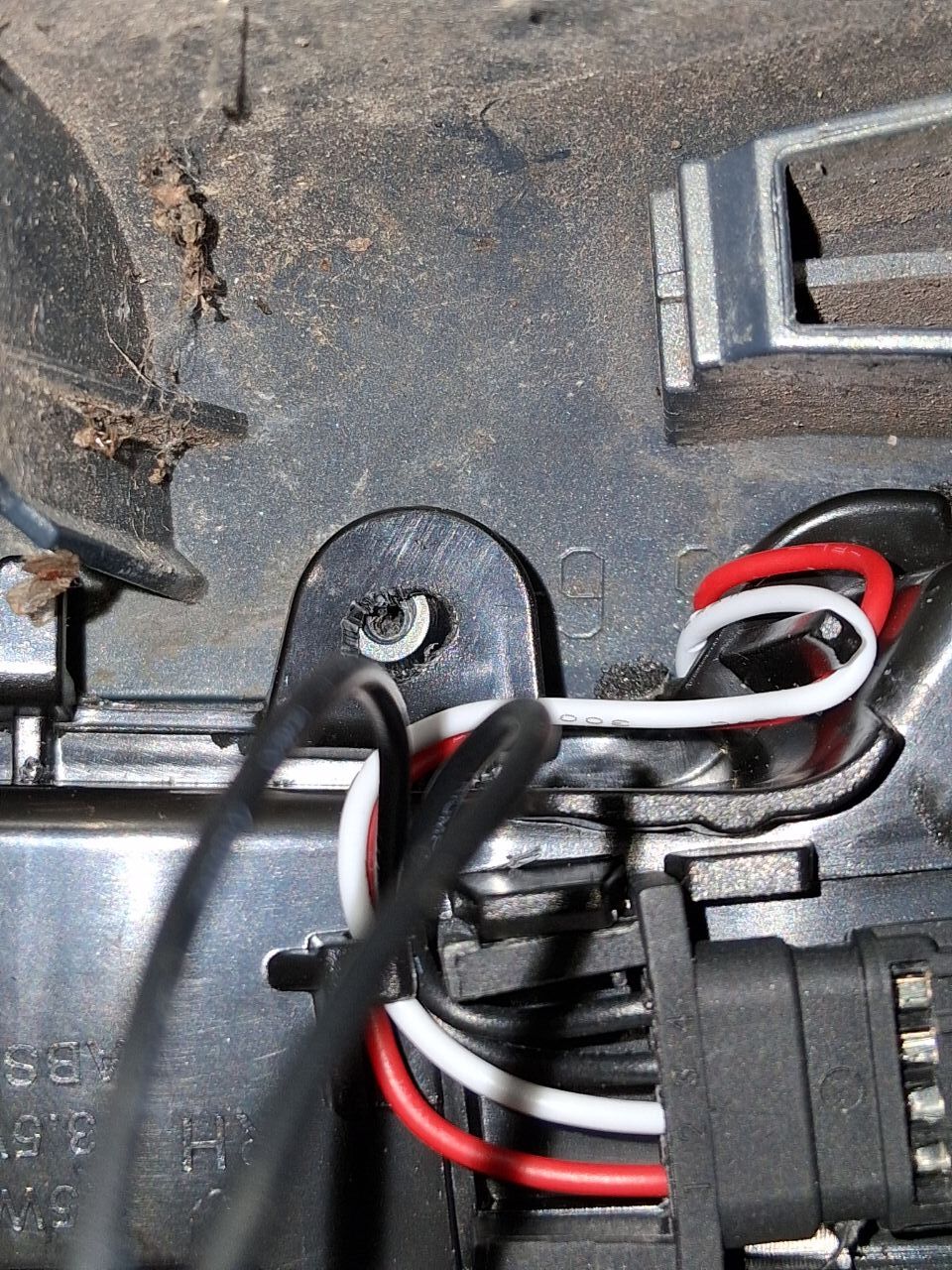

The puddle lamp connector is also wrong and wont fit.
Old correct one on left. New wrong one on right.
So I tried getting the pins out and swapping the connector.
I did but pressed the pin into the new connector the wrong way and now its stuck fast.
So I will need to sort that at some point.
When it stops pishing down, I will refit and see if error comes back.
