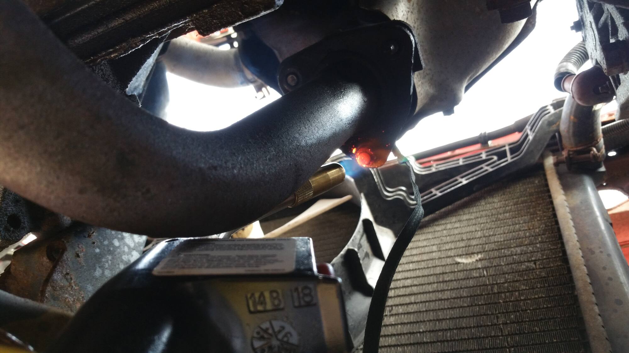

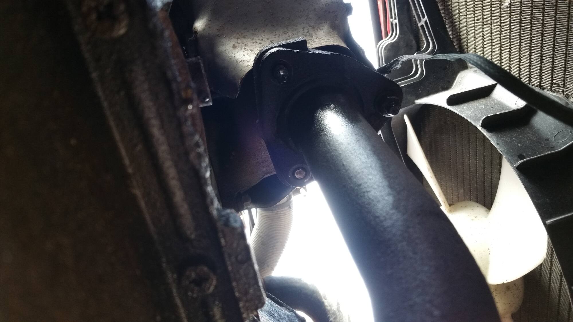

spartacus Posted March 22, 2020 Author Posted March 22, 2020 The exhaust down pipe/front box on this has steadily been blowing more and more since I bought it. It's had plenty of sparkly stick action and a fair dose of exhaust putty too. After trying local factors with no success I hit eBay up for a new section, £32 delivered, with only a slight delay. I had chance to have a bash at it today, so popped the car up on the ramps on the drive, in a cruel twist of irony, while I was grovelling around on my back in the gravel, gallantly aiming a blowtorch at the seized nuts on the downpipe, Mrs Spart was clearing the garage, with the aim of being able to use the pit... Sigh. Despite being old enough to know better I still managed to snap one off the stuffs in the manifold by leaning on it too much, TBF to me though it was very soft. I reckon I'll make do with two, we'll see. After the above mentioned blowtorch action the other two came off OK. I just sliced the two bolts to the centre section, they're easily replaced. Pictures below for your delectation, bonus pic of Mrs Sparts biggest horse who decided he needed to come into the man cave and check out the contents. Dick Cheeseburger and Tickman 2
spartacus Posted March 22, 2020 Author Posted March 22, 2020 Tomoz I'll pick up a couple of suitable gaskets, or make some out of the exhaust gasket material I have, and then set about refitting it. Watch this space for the next exciting* installment.

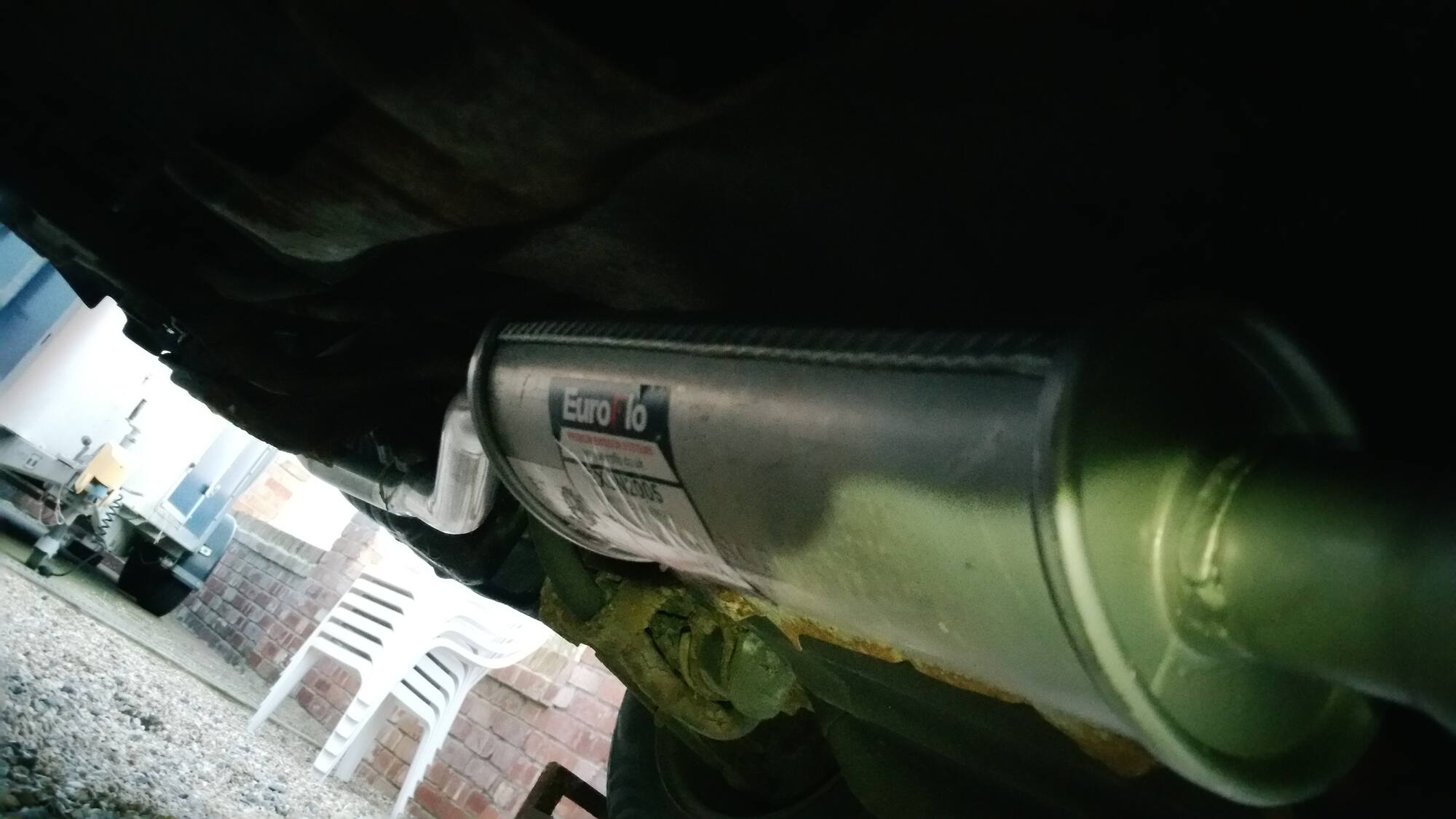

spartacus Posted March 23, 2020 Author Posted March 23, 2020 I fitted the exhaust tonight, probably the easiest I have done. The correct gaskets were in stock at my local factors. I managed a quick test run before the curfew, it's amazing what a difference to the driving enjoyment a silent exhaust makes! The engine is very smooth for a four cylinder unit and I'm now looking forward to getting out in it when circumstances allow. The next task will be to sort out the maze of vacuum pipes on the carb/manifold/airbox, and also try and cure the occasional very slight 'hiccup', which I think may be an HT lead issue. Behold the crappy pic of the new exhaust in place. Tickman, LightBulbFun, UltraWomble and 1 other 4
