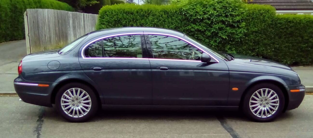

My mate has a 2.7TDV6 S Type. £1300. Very good car! Runs as sweet as a nut.
Grey with Grey/Black Interior.
05 plate, around 103k.
Stunning Motor.
