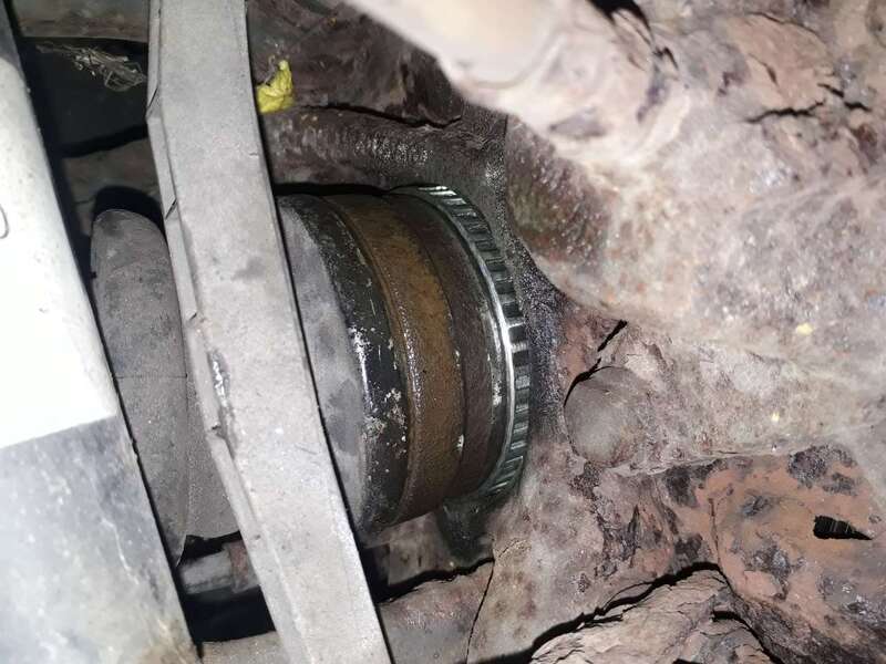

This week the SLK that belongs to a mates partner came over for me to have a look at the rear ABS rings. A few weeks back it kept throwing a hissy fit, kicking into limp mode and the gearbox going into a bad mood.
Plugged a reader in and it flagged the EML as a wheel speed fault.
Up on the lift i suggested we check the rings having had faults like this on the freeland and combo previously on this thread.
Sure enough the rings had expanded and caught the housing and making the air gap too small im assuming.
Hmmmmm mercedes crust.
Unbolted from the diff and the crown nut being ugga dugga like an absolute bastrd. The shafts came out

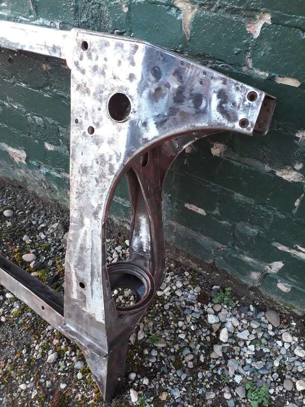

Next up is this panel. By far the worst and getting the very thick underseal off showed previous repairs hidden from the MOT man.
Tackled a smaller bit
I cut away to gain access then made a new piece for the side structure and base plate. I have another two smaller repairs like this but will approach them differently.
While i had the welder out i zapped a little section in where there was a rusted crack..
The flip side of the repair above was done today.

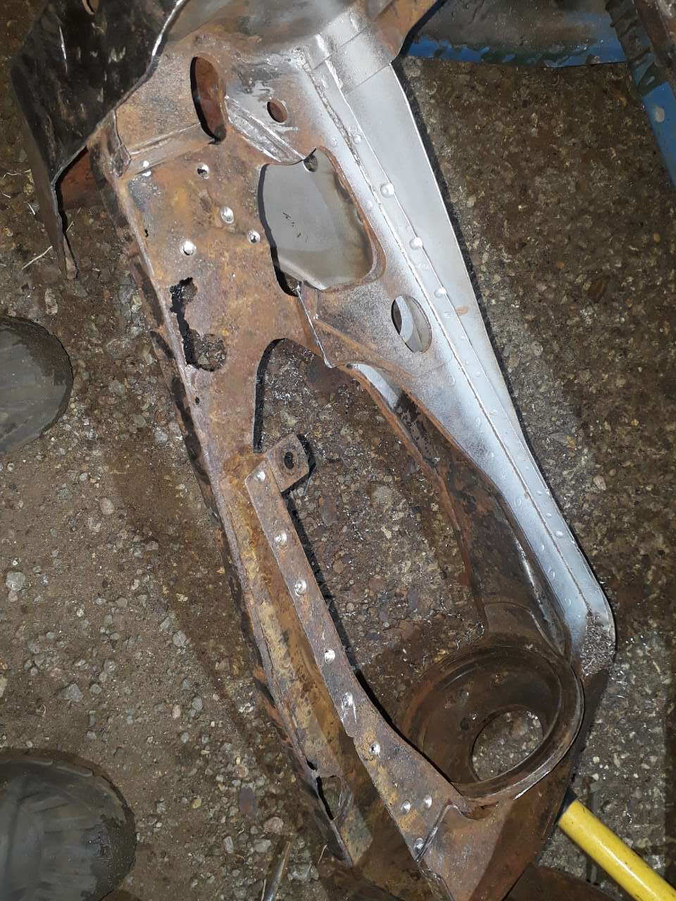

Time to get a bit serious
Finally we address the worst area. With the previously patched up panel removed the grot is pretty substantial.
All the corrosion problems on this frame have been from moisture in between the layers. Near the axle mount all three parts come together and have swollen between spotwelds. The First small outter skin layer was removed. Then the larger section below it could be chopped out.
Tomorrow ill will make the outter skin and the little part and zap that in. its a case of repeating with the other skin seen in this pic, The sides of the centre section the join to also need repair , Then produce a new out panel to cap the lot off.
That is certainly a lot of work! When these rot, they don't do it by half do they? Good on you for persevering with it. At least now, once it's done you can smother it in underseal and stop it from rusting quite so quickly again.
Today i made two new parts and zapped them in. Folding the return for the displacer area took some time but came out okay in the end

A late start on this today but tackled the panel that will be the last piece of the puzzle as that felt like something that could be done within the time allowed.
Basically a reversed copy of this.
Not as simple as it looks, the return on the radius is easy but with a fold merging into it a little heat and some shrinking/stretching got us there in the end.
The swaged hole was drilled with a large hole cutter then put in the press using an old timing belt pulley as the female side.  Slight fold added along the base and a 90° return for the joint at the end of the panel.  All thats left if plug weld holes and holes for the bolts.
