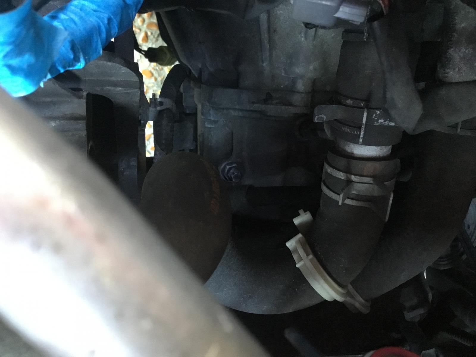

Vince70 Posted February 23, 2019 Posted February 23, 2019 Well today I decided to drain a bit of engine oil out as I overfilled the car last week and was in a bit hurry and drained the wrong sump on the daihatsui and now it needs some more automatic transmission fluid I wondered is two litres enough as I might of just drained the wrong sump last week lol and about a litre and a half came out. In my defence it was dark when I was doing the oil change or should I say automatic transmission fluid change but I’ve got to say that So I’ve ordered Dextron 3 so should that be ok and is it ok just to get a funnel and pour it in here.

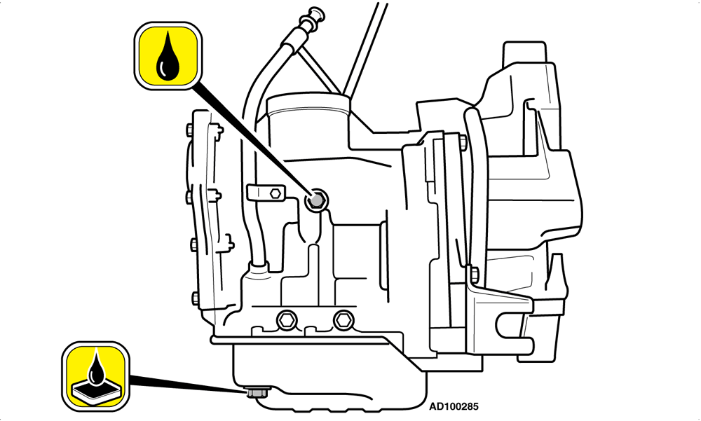

red5 Posted February 23, 2019 Posted February 23, 2019 Automatic transmission fluid Type Dexron III Automatic transmission (drain & refill) litres 1,7Automatic transmission (dry fill) litres 4,0 Engine code: EJ-VE(03-07)43 kW (58hp) 6000 rpmR-Cat (2003-2007) chaseracer 1

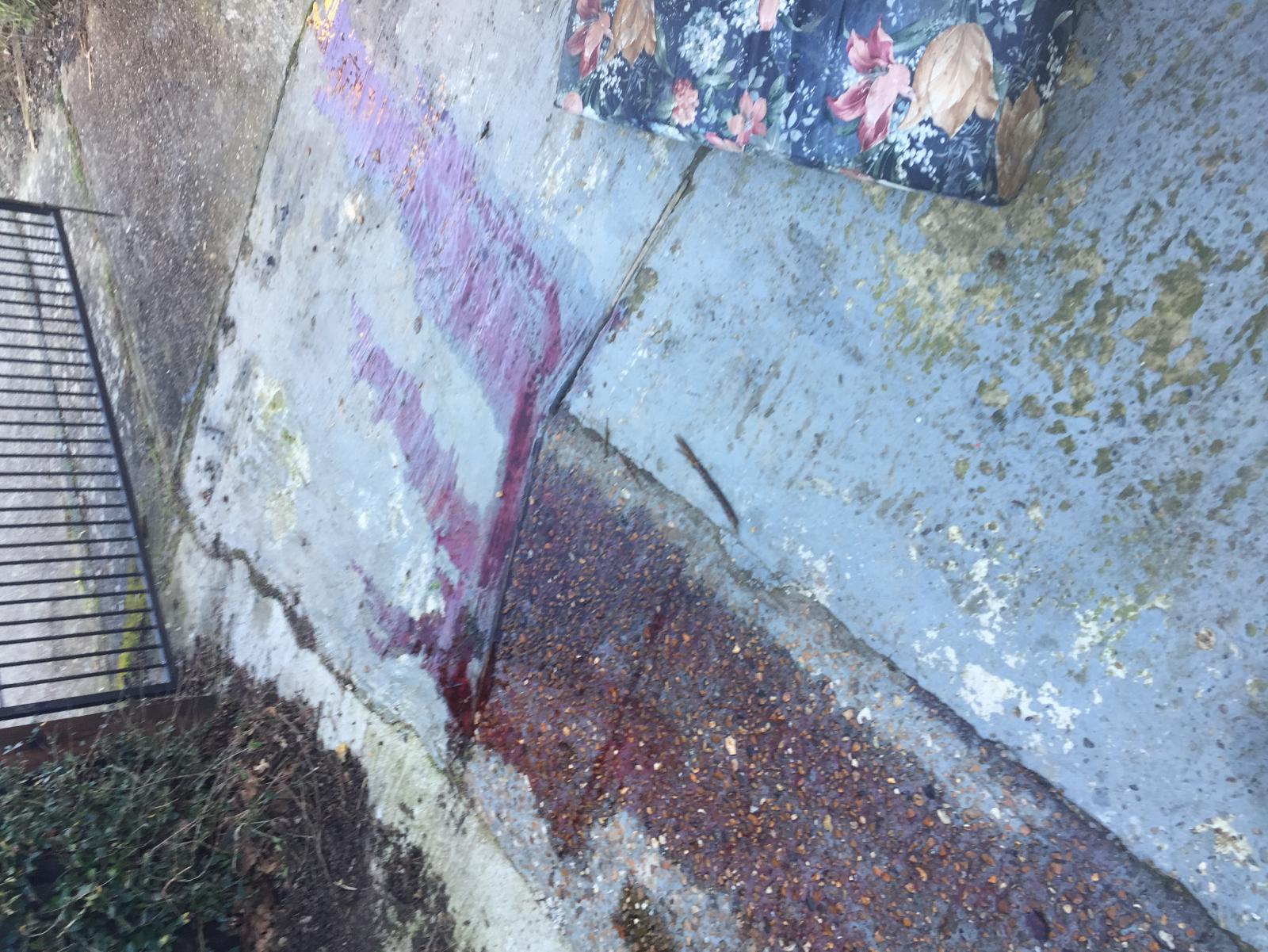

Vince70 Posted February 23, 2019 Author Posted February 23, 2019 Well it looks like I got away with it as the gearbox is changing gear perfect again but I have a nice slippery drive now as my E36 had trouble getting on the drive and had a few good wheel spins getting it back on.As red said I managed to lose a fair bit.In mathematical terms how much fluid is this amount I’m hoping it’s 0.3 of a litre lol. Lacquer Peel, paulscavalier, Christine and 2 others 5
