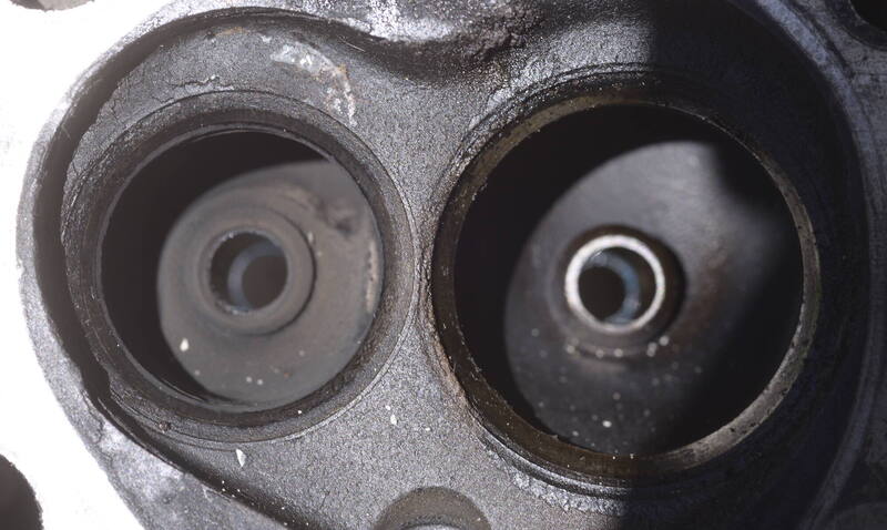

Well, I got impatient on the overdrive and decided to drop it off with my trusted mechanic for an install.
He drove it before tearing into it and said something felt "off" about it. He did some basic diagnostics(compression, leak down) then pulled the engine and started tearing into it. I stopped by a few weeks ago and he said "I'm glad you're here because I was dreading calling you. Let's walk over and have a chat."
Short answer is that the problem starts here...
_DSC4788.thumb.JPG.291695710d765f974efbd71b145df4d2.JPG966032845__DSC4788copy.thumb.jpg.e919f0989c30949e07f26e6a16441817.jpg
And keeps going on deeper into the engine.
Short answer is that once the machine shops get back up, we're looking at a complete rebuild. Parts availability now means that I'm probably going to end up doing it 30 or 40 over-it would probably clean up at 20, but those pistons are out of stock.

its amazing how its such a small crack, almost looks like its just a scratch or something, im curious how deep does it go into the casting?

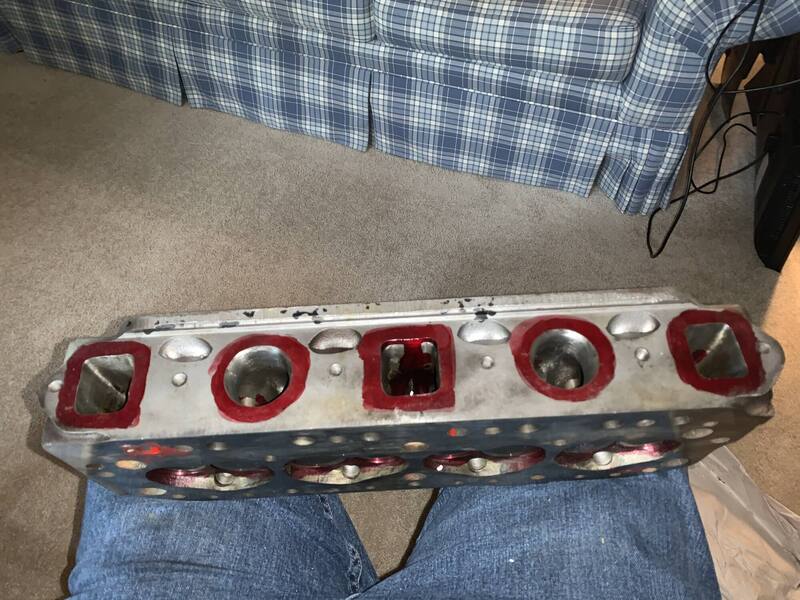

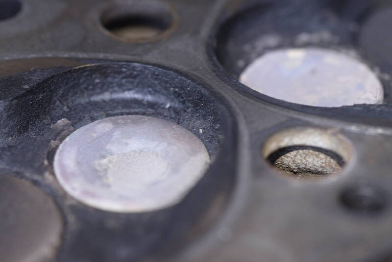

I started digging into the head today.
First of all, the fancy valve spring compressor I bought was utterly useless. What did work well was a trick a friend relayed to me-use one socket to support the valve from the bottom, put another on the cap, and smack the top one with a BFH. Sure enough, a smack or two and the retainers popped right out.
Unfortunately, what I found didn't make me any happier. Aside, again, from the really deep seats,  my "big valve" head seems to have its "big valves" either been measured by a fisherman or a guy on Tinder.
I should have really pushed back when I saw things not right on this head 3 years ago.
