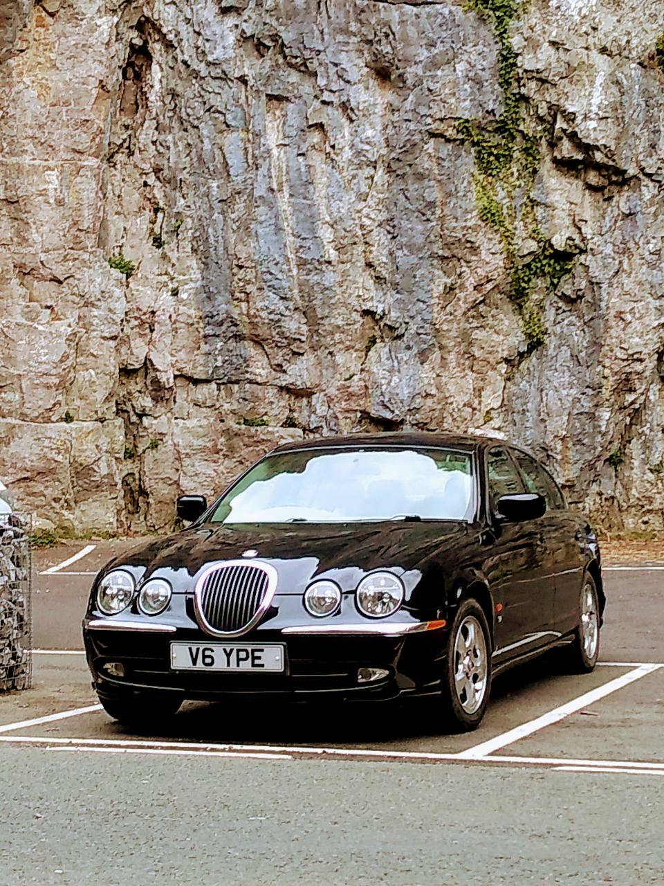

It's been a while, so just in case you was wondering about one of the ex forum bikes...
It's still chewing the tarmac. If Carlsberg made cars... Probably the best car I've ever owned.
