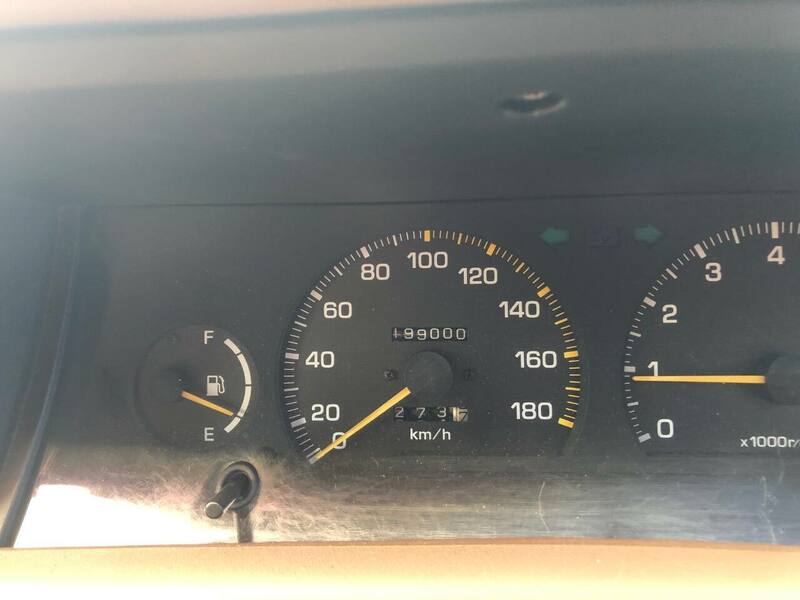

I  completely forgot to record the last proper milestone, 190,000Km. That’s 30,000Km since purchase and 10,000Km since the replacement gearbox.
In fact, it’s actually gone a bit further since. This was today’s reading and the reason I realised I’d never posted the previous one.

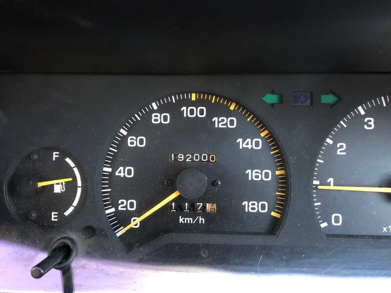

2000 more kilometres covered, only thing of note was a flat tyre thanks to a rock rolling onto the road as I was going along.
A service will be coming soon, hopefully some further improvement work which has been sorely lacking of late.
33,000 Kilometres in my ownership, and counting.

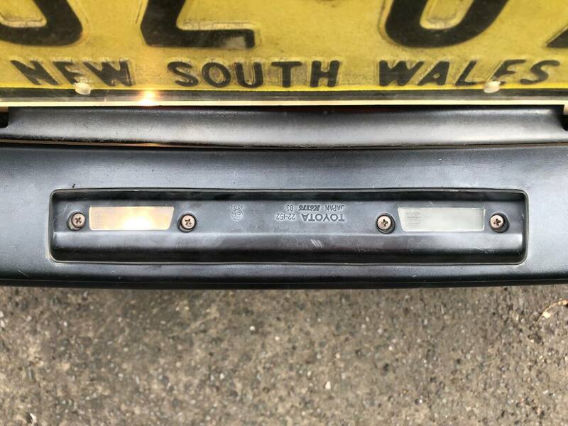

Bulb check!
Room for improvement there.
Much better.

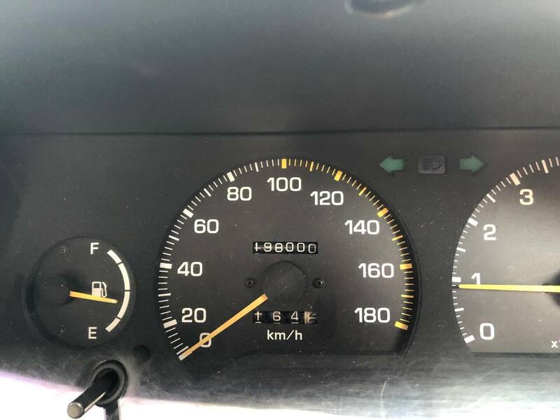

Firstly, a mileage update.
