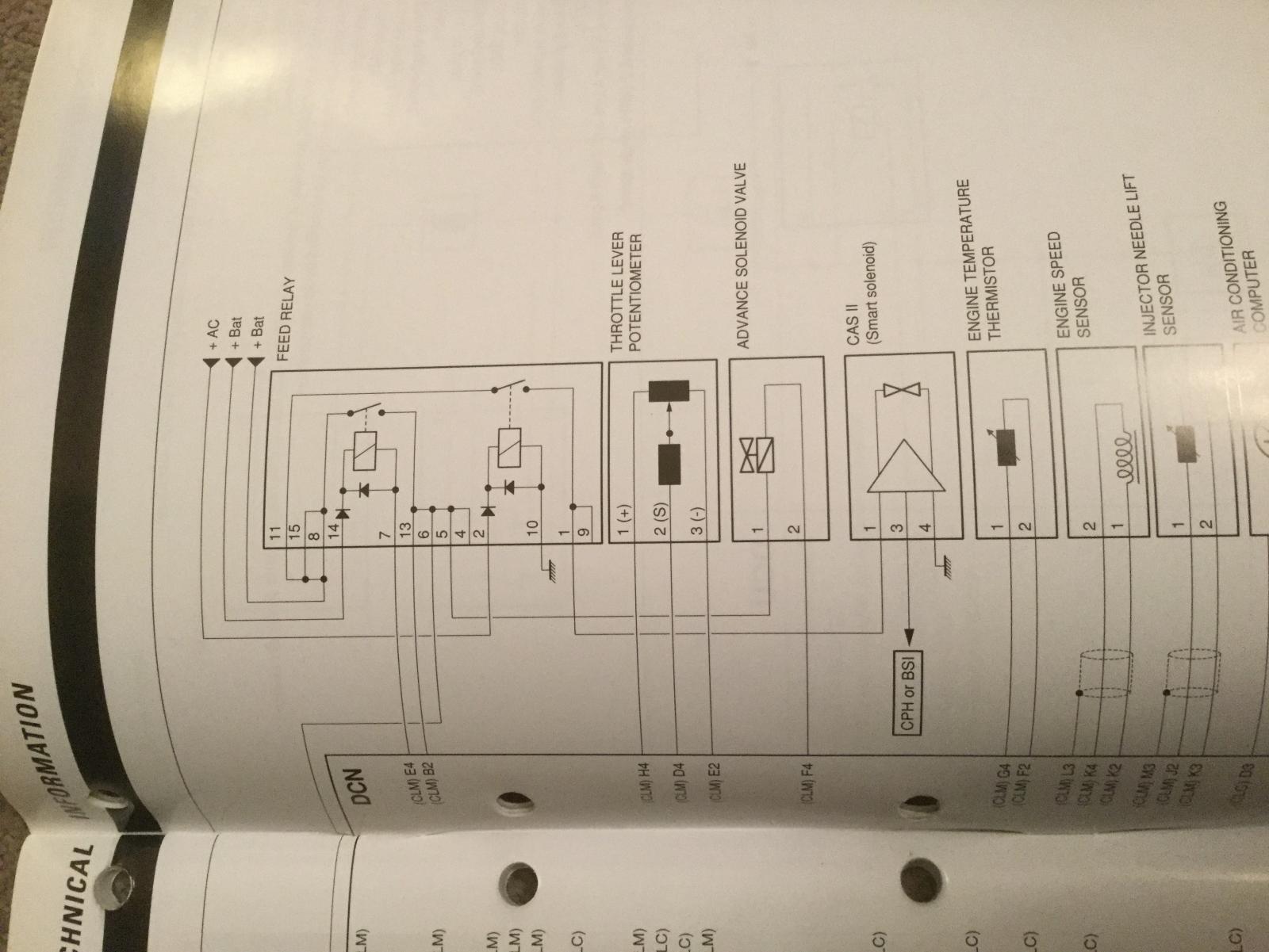

I’ve dug the DELPHI DPCN manual out and you can see ECU pin designation and the wiring diagram for the Advance Valve. It is fed voltage from the double relay and has a switched ground through the ECU at pin F4 (CLM) by PWM signal (or duty cycle). Good luck with the diagnosis.
