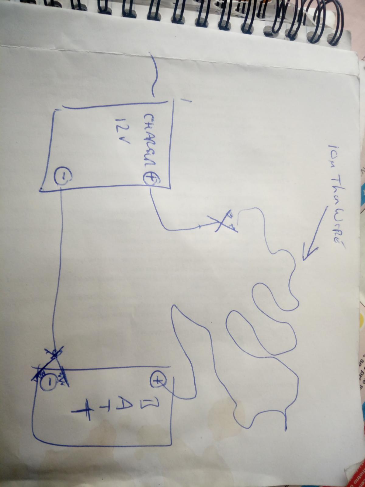

Do you have a long thin piece of wire, maybe a roll of bell wire?   Your battery is taking more current than the charger is rated for so it trips out. Convert your charger into a "smart charger" which will not over-current trip. At highish current the long thin wire's resistance will drop some of the voltage and get warm, being long and thin the heat will dissipate (ie don't leave it on the reel) - as the battery charges the current will decrease so the voltage drop over the thin wire will decrease till eventually the voltage at the battery is the same as the voltage at the charger.
Headlight bulb in place of wire . it will glow till the battery starts charging up
