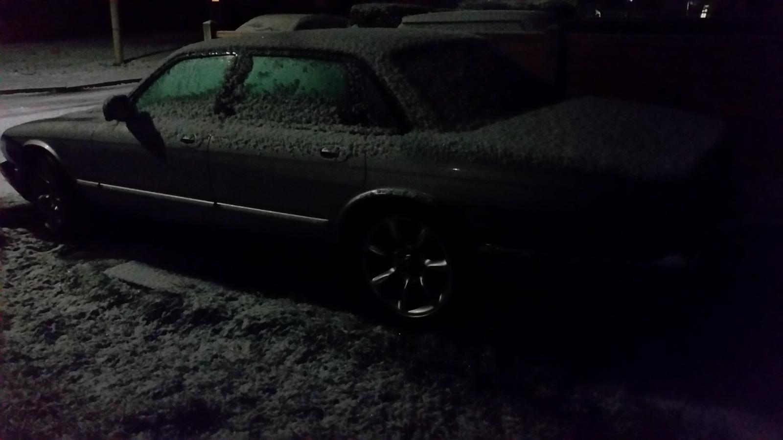

I think this was running better on the way to work this morning but it's hard to tell when all but one attempt to move from a standing start triggered the traction control. It did feel even smoother than normal which has to be a good sign.
There was snow that half melted & refroze here last night, so although there wasn't much of it it's got ice under it. Ideal* weather to test a torquey RWD auto...
